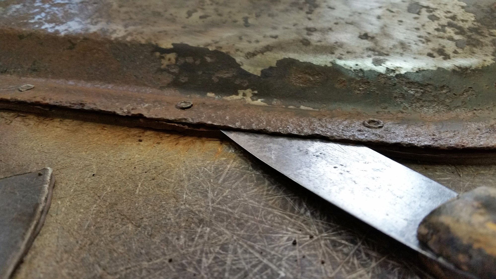

I actually ground the rivets down last night and pulled off the header bar. It was in remarkably good shape for nearing 50 years old.i spent the day cleaning it of what rust was there and coating it in POR-15 along with the front support bar which I plan on leaving attached to the car.
I had planned on using the existing rivet holes to locate exactly where the header bar goes. And later using VPA to fill in the rivet holes in the fiberglass. Or do you suggest glossing in the rivet holes while the header bar is off?
When I took mine off, I left the bonding strip in place, then dug the rivets out of it. When I put the metal header back in, I filled the holes with extra adhesive.... per Willcox Corvette instructions. Then I clamped the header with boards on top. (The boards helped push the bumps down, and distribute the force of the clamps.)
Willcox's tech sheet on this is a good reference.
I do a few things a bit differently and that is.
When use my Dremel tool with my small router bit on it with a sleeve on it so I can control the amount of DEPTH of my cut...I go around the rivets and get them out. I do not go as large of a hole as what Willcox does. I keep it to what it needs....about the diameter of a nickel ...most of the time.
I then heat up the fiberglass and get the 'bump' to go back down before I bond the beam in place IF I am using the same beam with the rivet holes in it. The method of doing this depends on if the car is painted or bare fiberglass and going through the body work stage.
I also use the SEM adhesive that Willcox uses...but what I do know about it...and you can call SEM and confirm it is that the metal needs to be ROUGH and BARE STEEL. Due to this adhesive begin epoxy based...as long as when you apply it you make sure that you cover ALL of the BARE STEEL...it will not rust. So...I think that POR-15 needs to come off you you might not actually get a good bond. Call SEM and verify.
And hopefully when you used the POR-15...you used there MARINE CLEAN and then the ACID ETCH as is required before you apply the POR-15.
I honestly would not worry about using VPA to fill in the holes where the rivets were located....BUT..I would get each of then CLAN and ready so you can apply some of the SEM adhesive prior to installing the beam. You can use the VPA if you like due to all of the holes you have to fill in can make this a bit challenging. And TRUST ME...when you are clamping the beam in and the SEM is oozing out of the holes where the rivets were...it can get quite messy.
Before you get to far ahead of yourself...due to you will be loosing the area where the rivets were so you know where to put the beam back correctly..I would install it again and make pencil marks or tape marks so you know where it will go back.
DUB
I get what you all are saying now. I had thought you guys meant to remove the rivet out of the outer surface of the nose, hence my question about filling the holes with vpa. I see now you guys meant dig them out from below. That will happen very soon, just have to run to the store for some dremel bits.
I am glad that you understood what was written...becasue...if you cut holes in your exterior surface and posted a photo of it...that would have been TRAGIC on a level that I can not comment on.
And I will throw this one at you. When you are using whatever tool to cut the bonding strip away to get the rivet out...take the time to make a jig/template that you can clamp in place and CENTER over the shaft of the rivet...so when you run your router tool around it...you have to not worry how big to make it and how deep to set it at once you figure that out. Due to having so many rivets...TRUST ME...taking the time to make a template is worth it....or do it freehand....whatever makes you happy.
DUB
