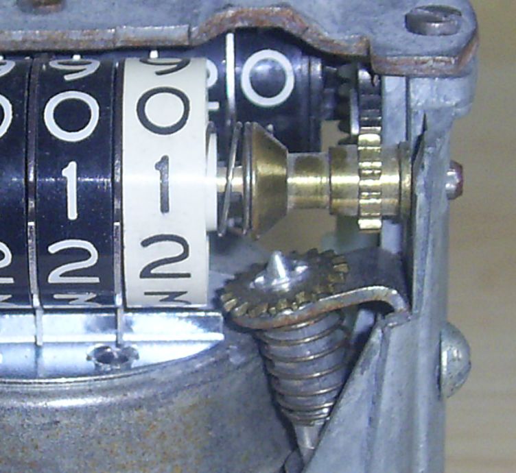

Here are a couple of pictures of what the reset mechanism looks like and how it works. When the cable is pushed in it forces that brass gear away from the drive gear and at the same time engages the gear on the end of the reset cable. You need to turn the cable clockwise to reset the trip. I have had a few of these speedometers apart and the reason that some trips do not work is that the little brass gear gets dirty on the shaft and the spring is not strong enough to push the gear back to mesh with the main drive gear. Also if the reset cable does not fully release, the gear will not drop back to mesh with the main drive gear. If the main odometer is working and your trip is not then you have one of the problems I have mentioned above. I have never seen any of the trip gears stripped, it has always been a cable problem or a barss gear that no longer slides properly.

Originally Posted by Binnie77
Great pic Binnie. Now we know how it's supposed to work
To Does your trip odometer actually work?
