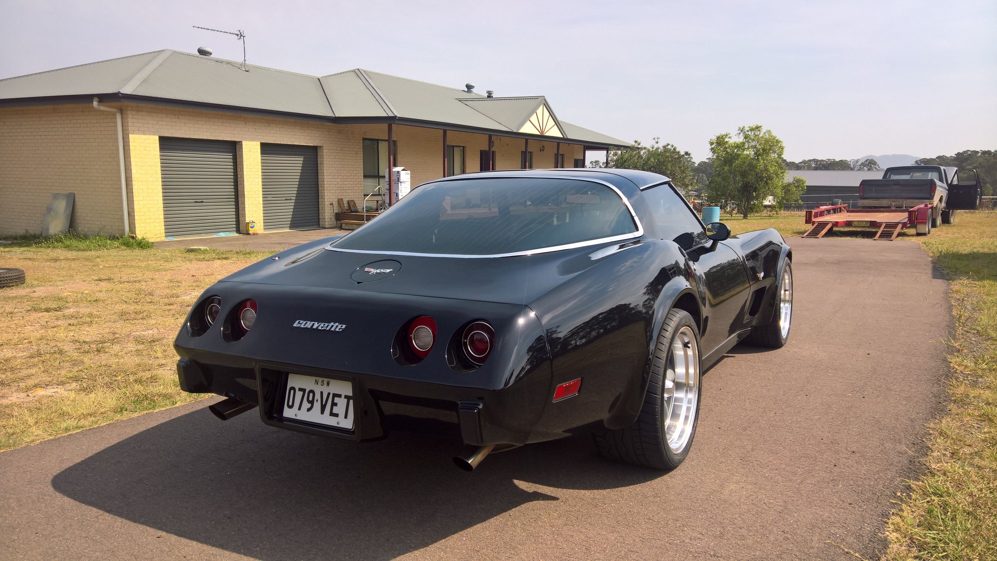

C3 of Year Finalist (track prepared) 2019
295/30R18 on an 18x10, 5.54" effective backspace (5.74" backspace with a 0.200" spacer). I prefer the look of my 17"s but wanted the 18"s for affordable wide semi slicks - this is my set of competition wheels/tyres. I previously relocated the handbrake cable on top of the trailing arm, shortened the main leaf, and re-bent the swaybar to fit my normal 17x9.5 wheels. These do rub the rails/swaybar at the front at full lock, no other rubbing. Identical wheels/tyres/spacers on all four corners. Fit comfortably within or flush with the wheel arches.
