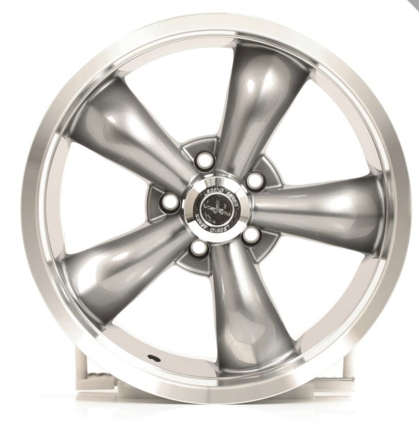

I’m going with this 18x8.5, 4.5” bs wheel with Michelin 255/45-18 tires on my ‘69 coupe.
Should be here and tires mounted in two weeks.
Let us know how they fit, what if any mods you had to do to make them fit, and pictures would be great.
FYI.....I was looking at these wheels, and discovered the pictures found on the Summit website show the color of the Gunmetal to be much lighter than they really are. If you look at the Vision website, you will find that gunmetal is actually very dark compared to the above picture, and not too far from being black. I confirmed this with Summit, who contacted Vision. The pictures below is off the Vision website and is what the real wheel looks like.
