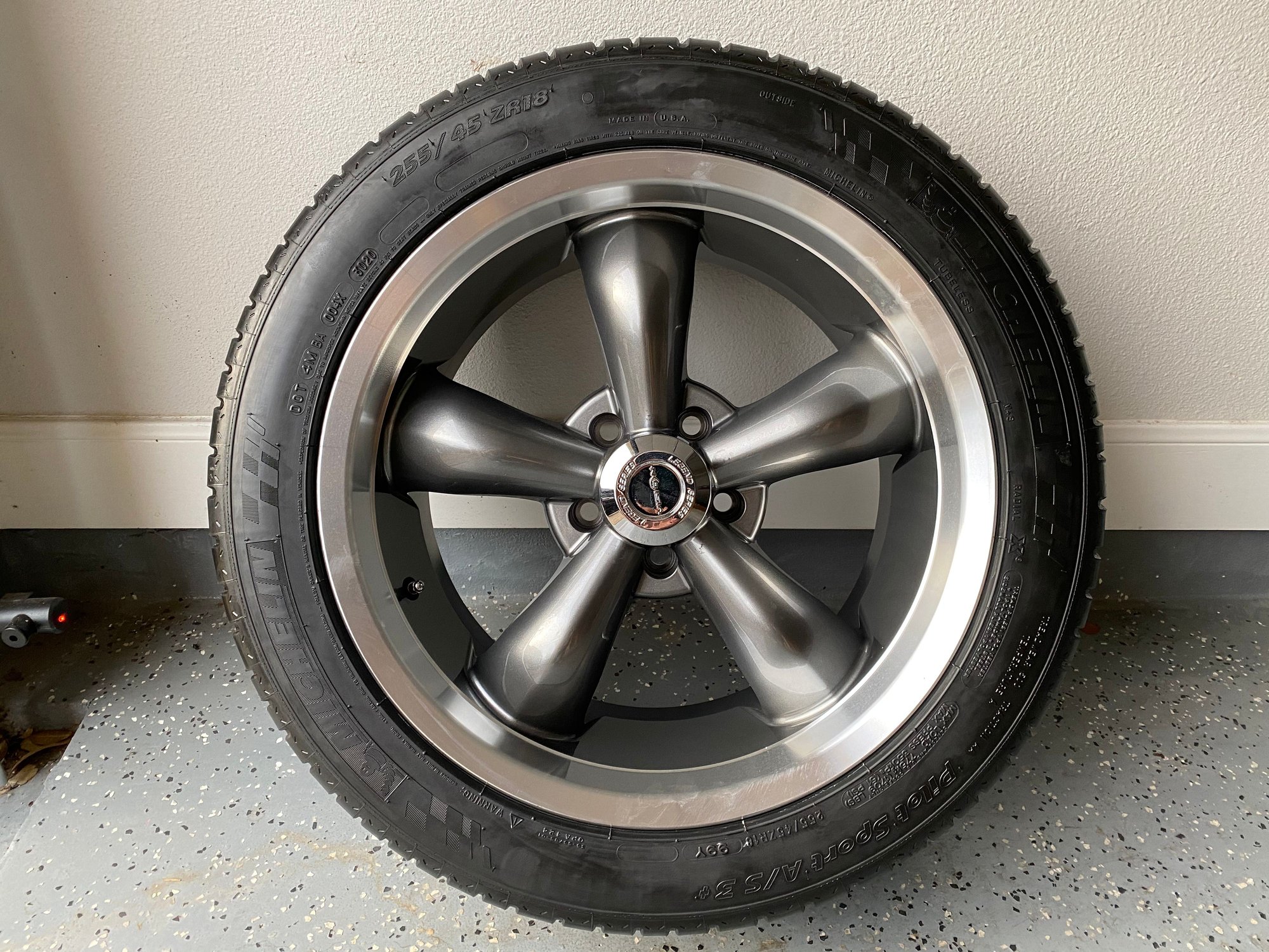

Got my wheels and I think they are perfect! My ‘69 is a dark royal blue and I think these will look great. I get the Michelin 255/45-18 tires mounted tomorrow.
They are a little darker than the Summit picture, but not as dark as the website picture.

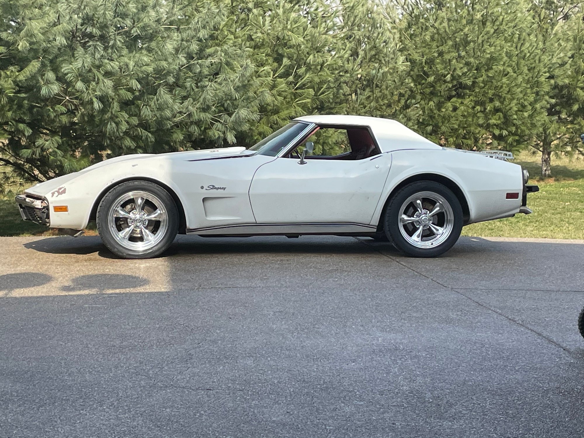

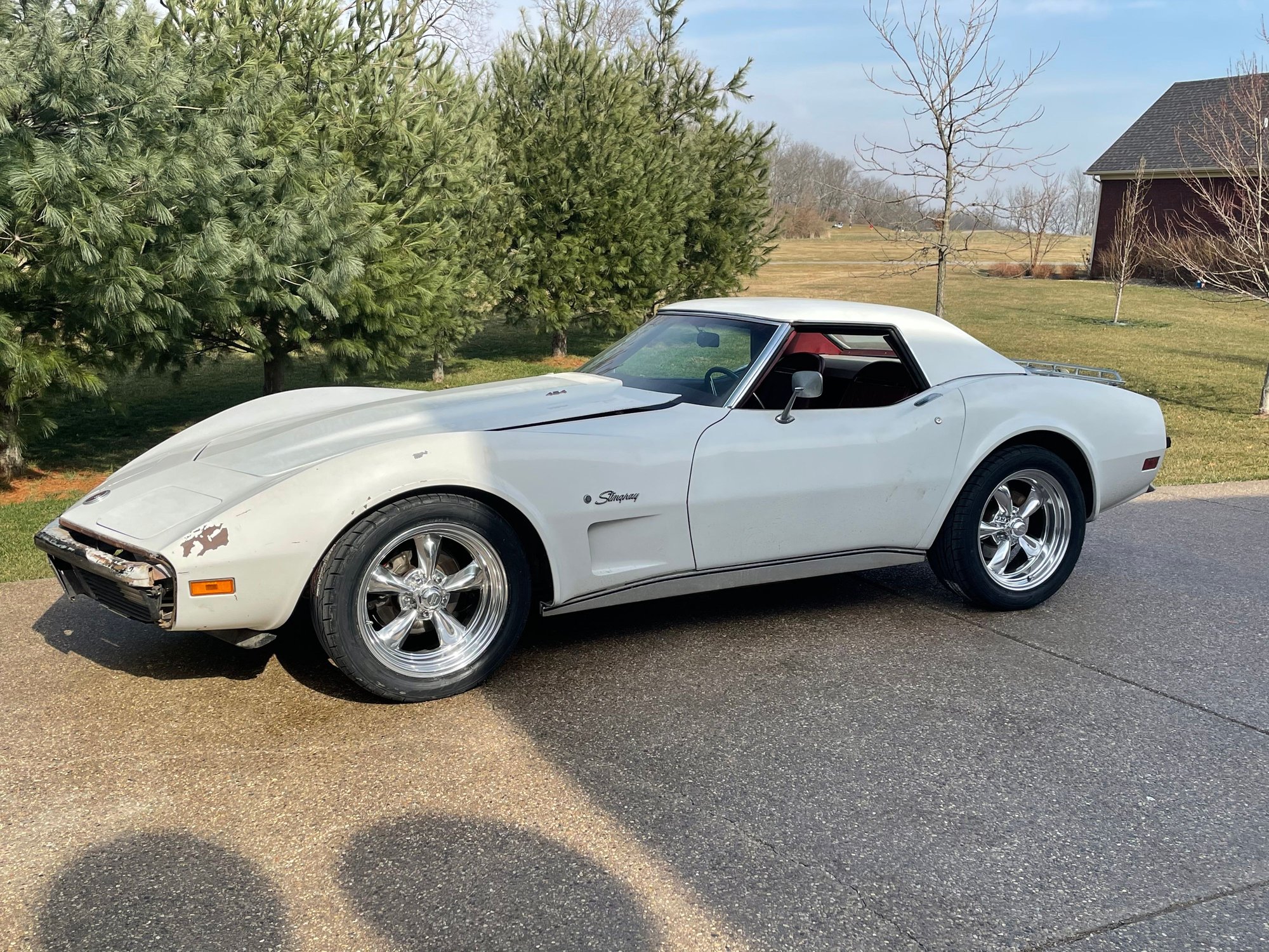

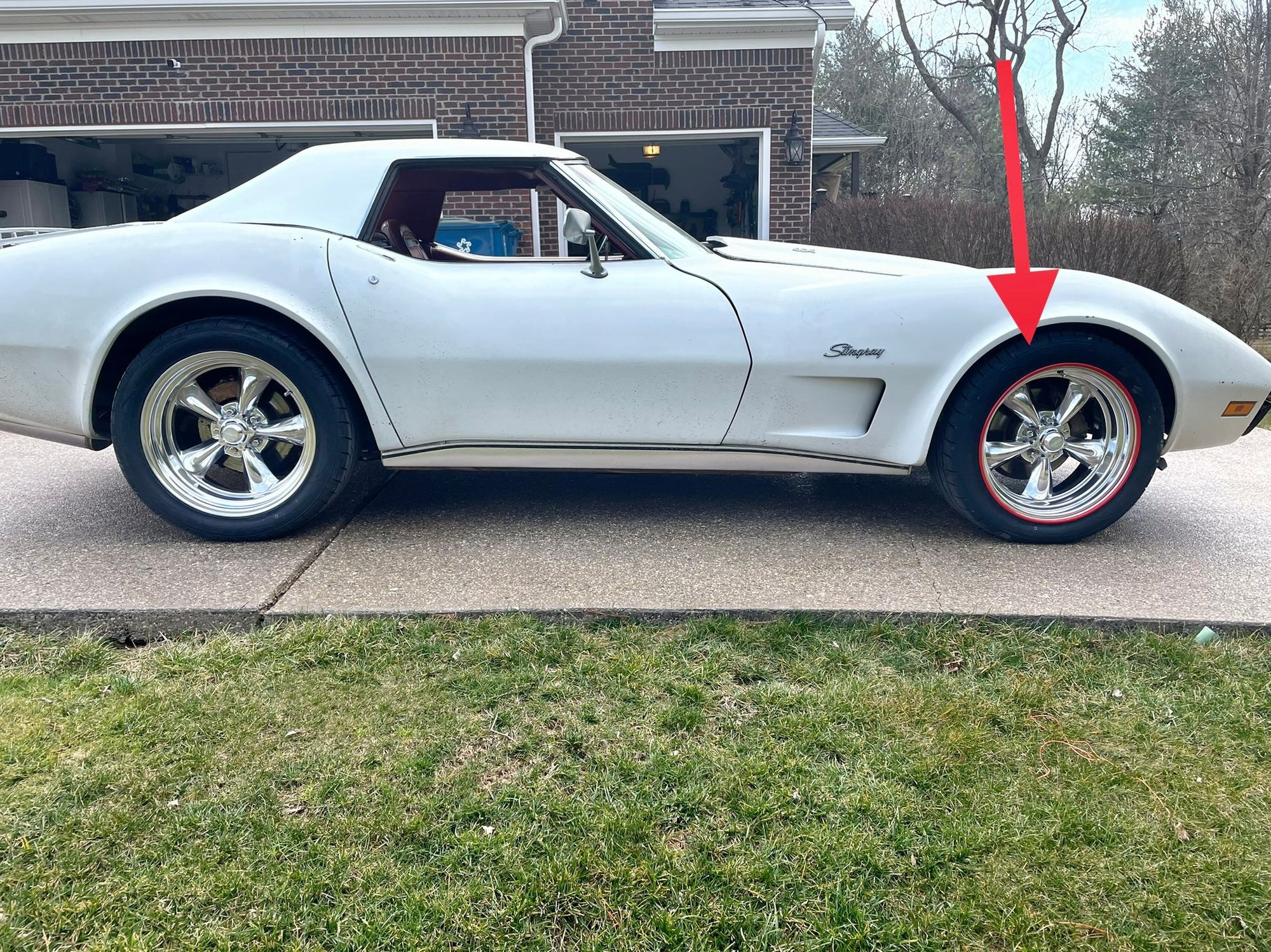

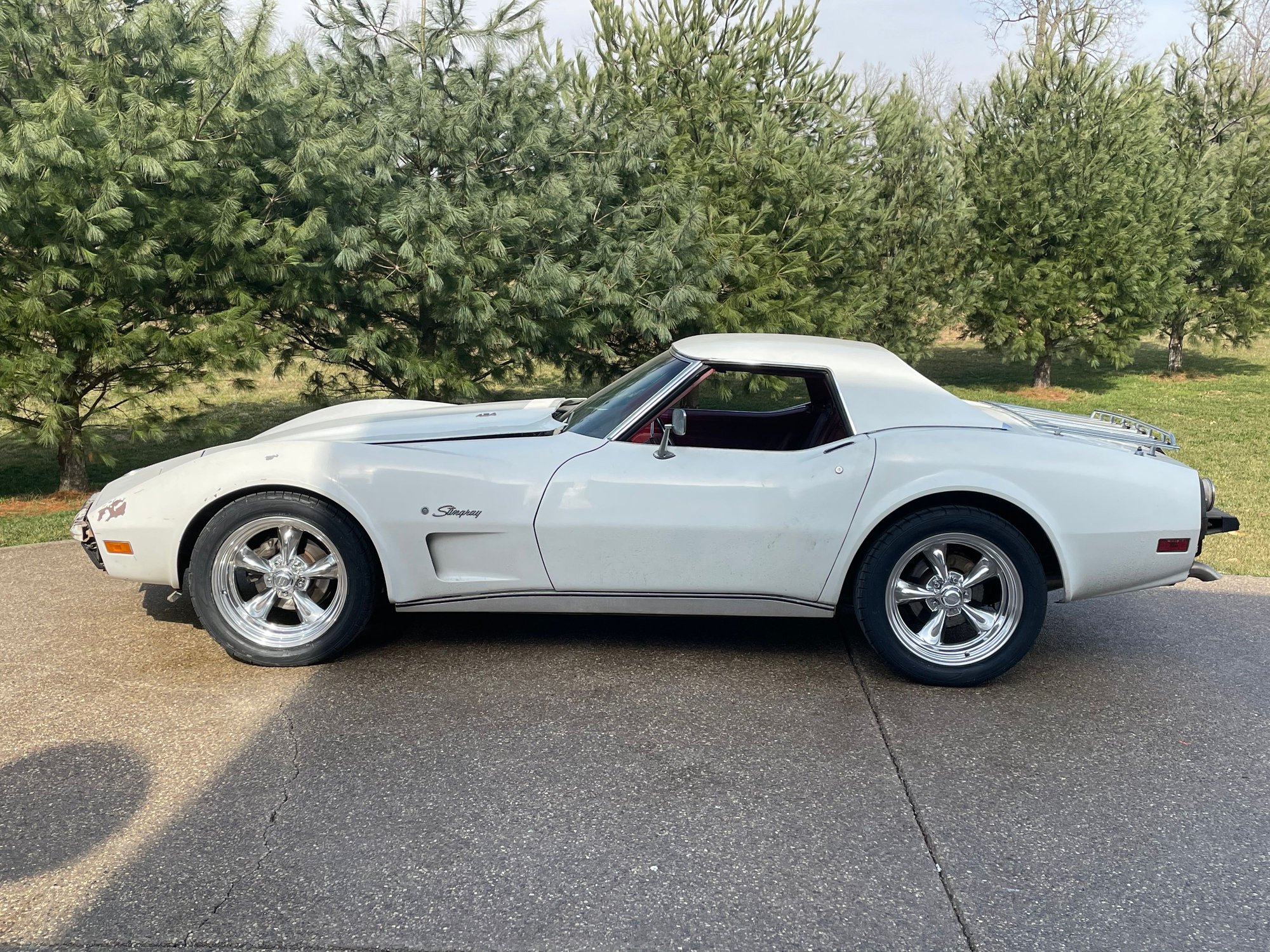

I just decided to not use them....
here my 1st outside photos of my 74 wearing the 18’ TT2’s
Looks great! Any rubbing or interference issues?
Remind me of your wheel dimensions and tire size?

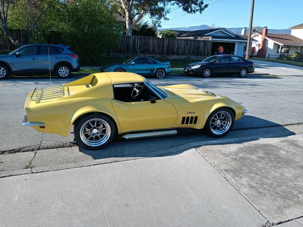

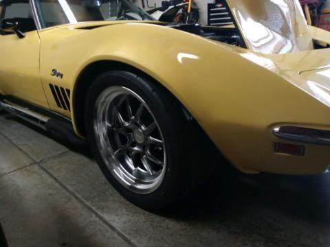

Default my 69 fronts
I got my front 18'' wheel tire combo on and lowered car.The pics do not show how wide the tires are but there a 305/35/18 I will go with a 315/30/18 next time.
18x 8 all around Torq Thrust II’s polished aluminum wheels with Nitto NT555G2 255/45R18 tires. This combo is the diameter of Wheel & tire of 27.1 inches...

Originally Posted by jimco84x
Like the Rocket Attacks. How wide are the wheels? I did 18x10 with 285/35, but my fenders are stock.
I did 18 by 10 5'' back space front and rear .The car has some big flares on it .

Got the tires mounted yesterday 255/45-18 Michelin’s. Hope to get them on the car this weekend.
Any suggestions for a more Corvette appropriate center cap? May have to use JB Weld to bond an emblem to the existing cap.
I like the color of the wheel, just right . as far as the center cap goes I think it looks fine .

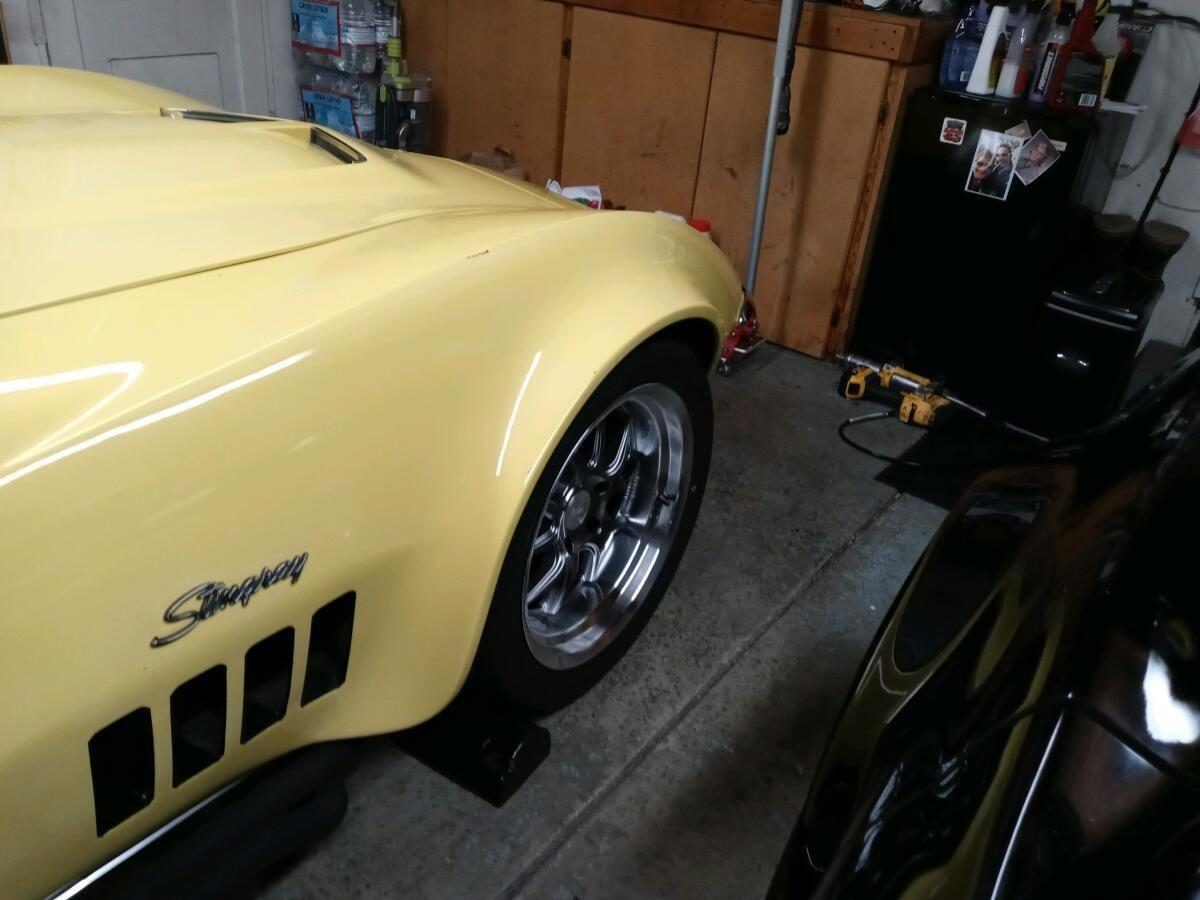

Default new wheels and tires
I got my wheels mounted I am now playing with the ride height .
