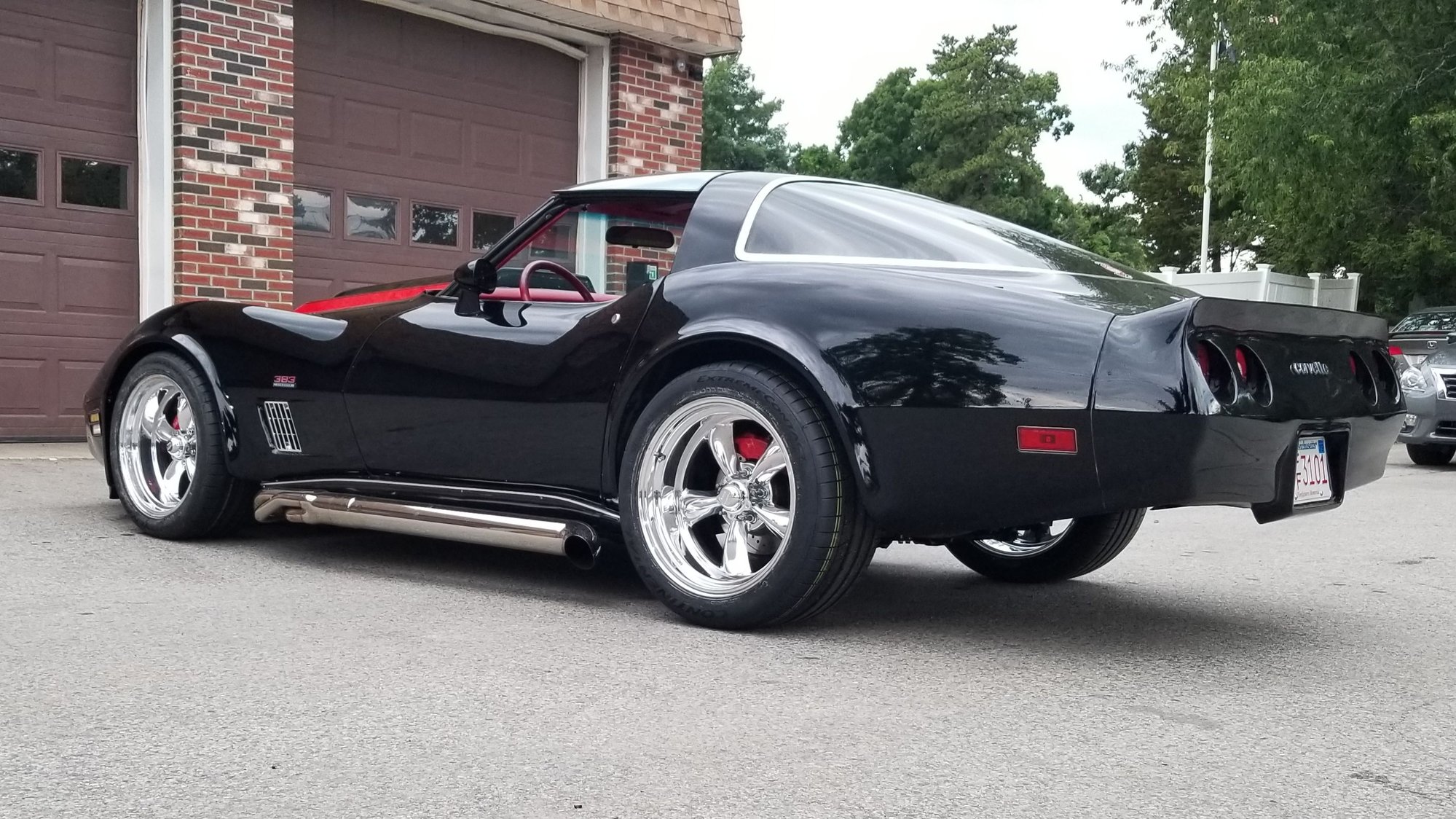

Originally Posted by 80vette21

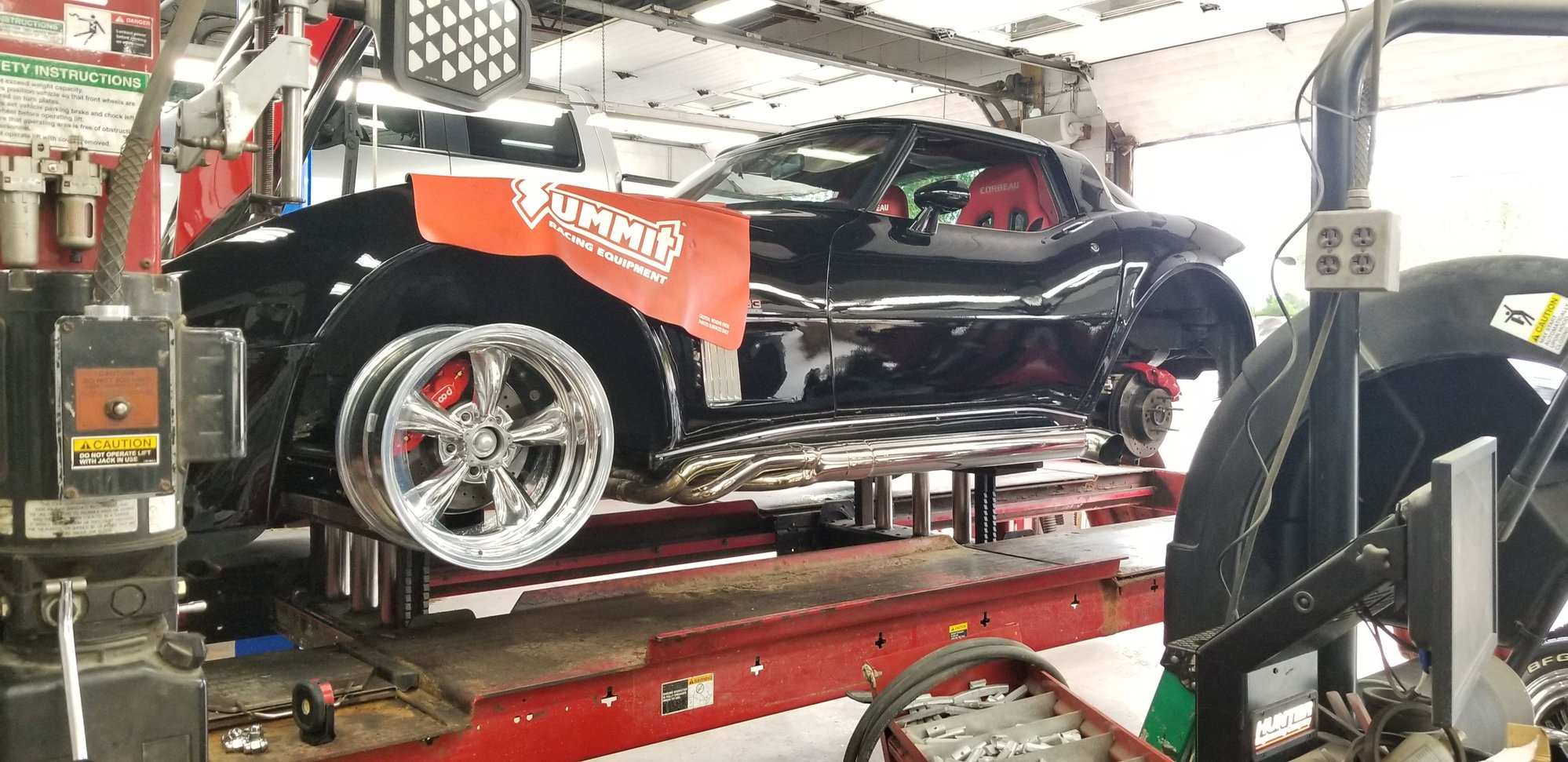

Finally got my new 18s in. Brought them up to work and installed them today. Everything went pretty well, except one wheel that didn't want to cooperate balancing. We have a really high end Hunter balancer, and I was roadforce balancing them. One wheel kept showing a possible bent assembly and was showing extremely excessive road force numbers. I was able to get the roadforce down to a slightly high, but acceptable level, and get it balanced, but it took a good amount of weight. I'm thinking this may actually be a bad wheel, I may have to push for a replacement.
As far as fitment, my painstaking/OCD measuring paid off, the wheels fit great. Here's what I went with:
Front: 18x9.5 with 4.75" BS
Rear: 18x10 with 5.25" BS
Tires are Continental Extreme Contact sport
Front: 275/40
Rear: 285/40
Front suspension is Vansteel coilover, rear is VBP mono spring with offset trailing arms.
Check out my previous posts for my calculations on how I chose these sizes. I was pretty precise and it paid off, they fit perfect. Thanks to everyone who helped figuring it out!

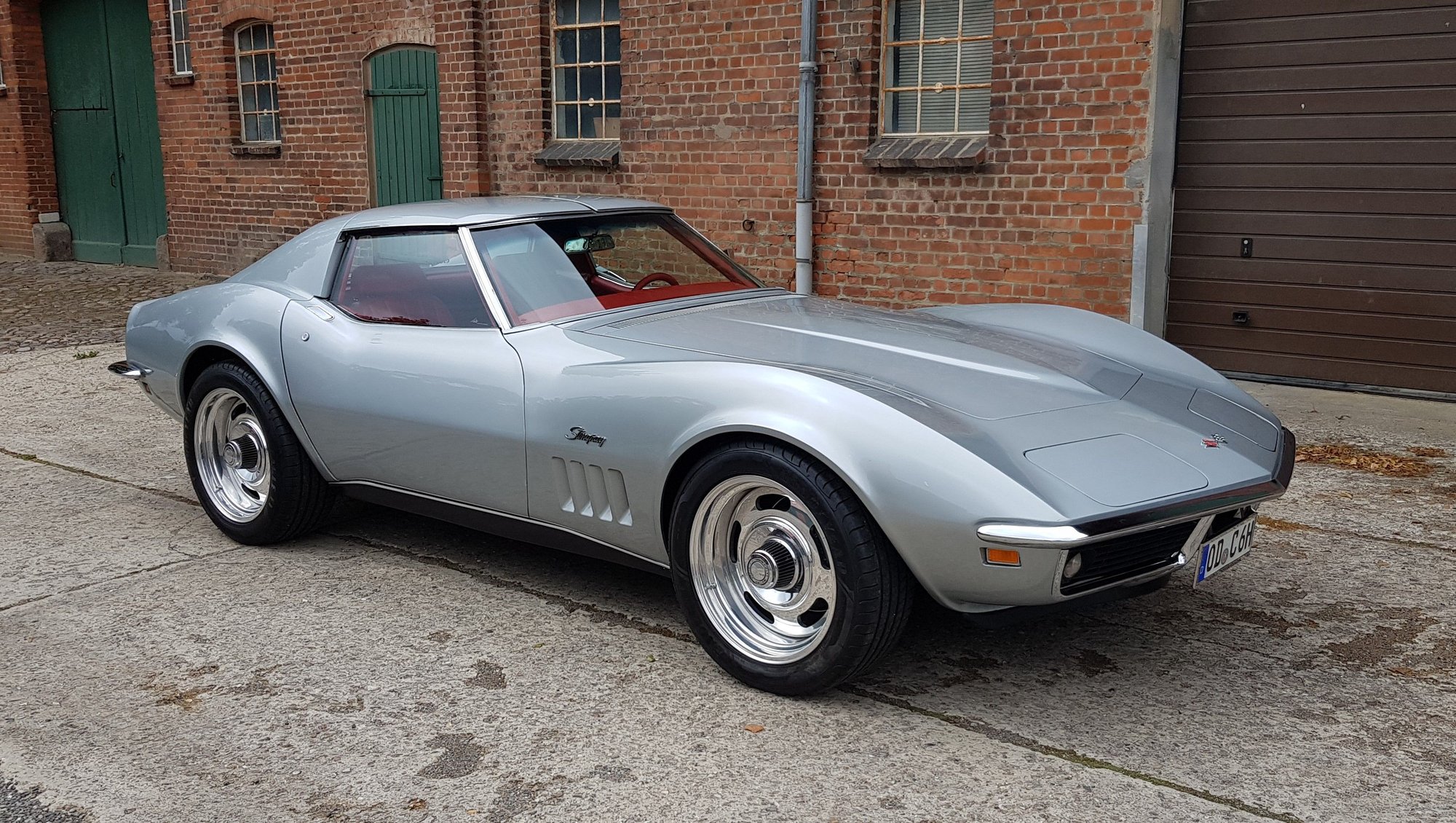

Front and Rear: 18x8.0 with 4.00" BS
Tires are Goodyear Eagle F1 235/50
who makes them in 18x8” with a 4” backspace. I have only seen 4.5” backspace so am interested.
What are those wheels !!!!! WOW, that's the best looking Ralley (looking) wheel I have ever seen.... The center caps with the wheel are a perfect size......

The same wheels on my previous 69 427.
Beautiful wheel - beautiful car....May I ask where you purchased them and if you had to modify anything to get them to fit?

The rims came from Circle Racing. Fit without modify.

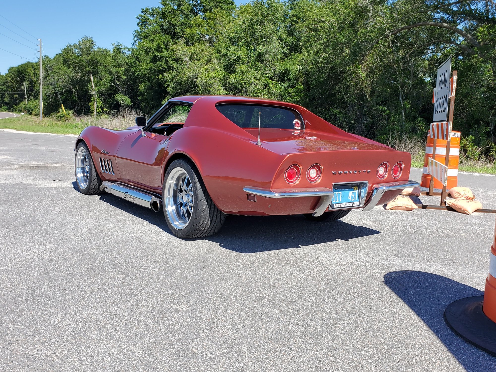

Originally Posted by jimco84x
I can confirm based on my car. I did a test fit with 18x10, 5.5 bs. Totally stock front end had no issues other than if you really crank the steering, the 285/35s will rub. I tried in the rear with the VB&P dual mount spring and stock sway bar. The wheel cleared the spring(barely) but did lightly hit the sway bar. The parking brake tab would need to be relocated as others have said. I then changed to Van Steel's front and rear coil over set up, but I did the test fit with the above suspension. There is probably room for another 1/8-1/4 inch of front side but I didn't want to push it and risk fiberglass interference. The pic below is with -1.0*front camber and -0.7* rear camber. Due to production tolerance, the passenger side front is about 1/8 close to the tire than the driver. It's like the body needs to move about 1/16" to the right. Remember, these cars are 50 years old and ancient production tolerances, combined with wear, tear and unknown repairs over the years might make yours fit slightly different than mine.
I like your wheels and tires! what are they?
Thanks. They are Rocket Racing wheels. Rocket Attacks. 18x10 The tires are Nankang N2-SR's. 285/35r18. The tires are pretty sticky 200TW tires. Phil's Tire Service is the best place I found for them.
