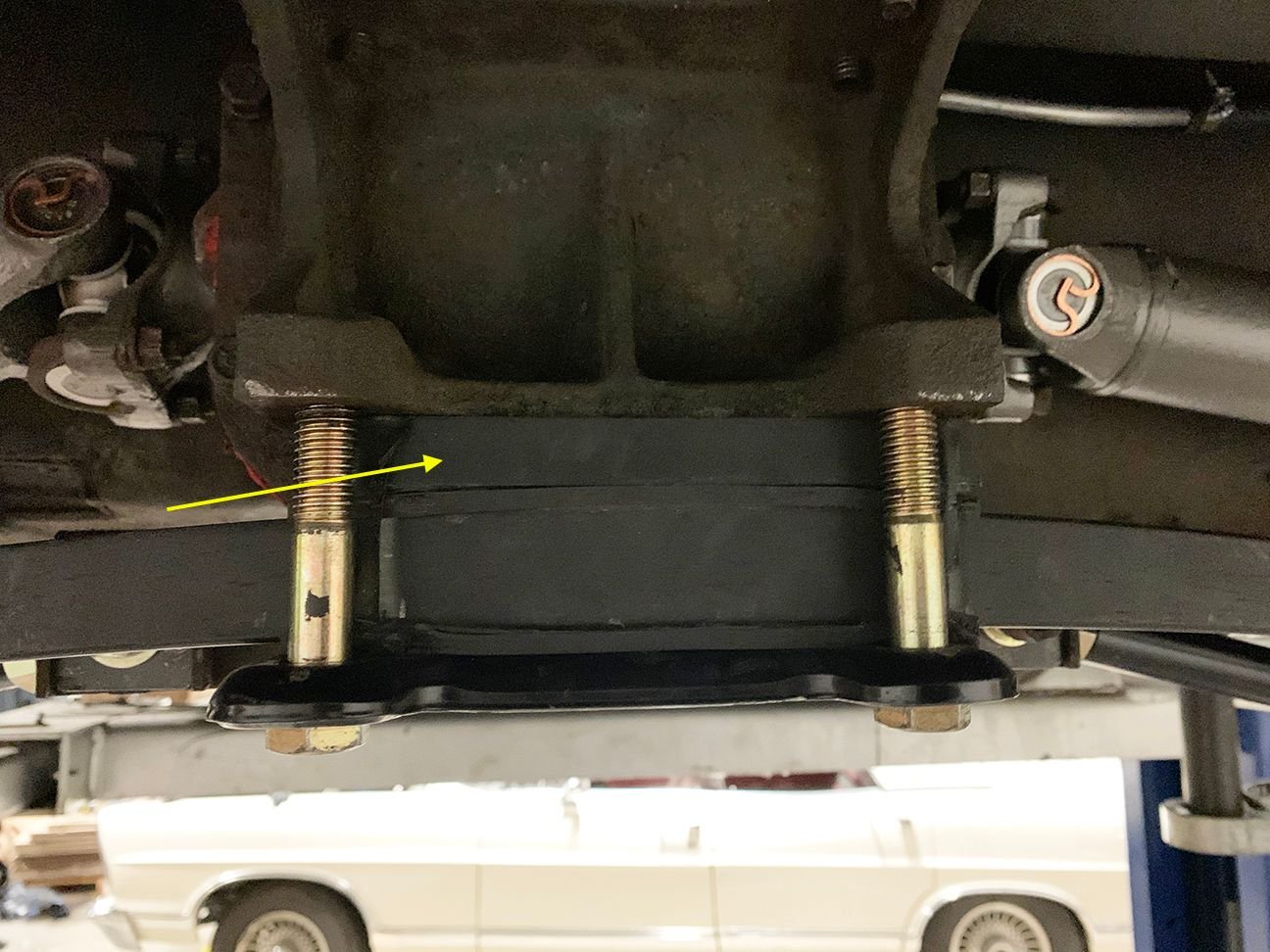

Its a VBP? Fiberglass spring. I did some nutsing around and noticed that the other side has a lot of clearance. the spring was mounted off... to the drivers side.
I centered the spring and it is a lot c loser. I have not aligned the suspensioin yet... everything is new. I think when the camber is correct it will fit.
Note: is it possible to reduce the size of the spacer between the glass spring and the frame. It looks to be about 1" thick. If there is a clearance issue, I think a 1/2" spacer would be solve it. see image

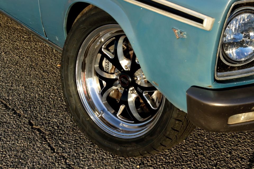

Looking for some input. After 16yrs, I've decided to step up to 18's for my '80 so I can get some better rubber on the ground. I just spent the last week gradually going through this entire thread! I saved all the pictures and info I liked and have been going through it. I think I've pretty much decided on 18x8 with a 4" backspacing for the front, and either 18x9.5 with 5" backspacing or 18x10 with 5.5" with 285/40s in the rear. I do have 2" offset trailing arms.
The input I'm looking for is on my wheel choice. I really like the Weld S76, but for the most part I only see them used on late model cars. I did find one article with them on an old Plymouth Belvedere though. I'm curious how you guys think they will look on my 80. I like the polished/black combo to go with my black car and stainless pipes. Here's some pictures of them, and a picture of my car currently.

I'm not a fan of black on wheels, but it is a nice accent on your black corvette and wheel choice is in the eyes of guy emptying his wallet, and Weld wheels a pretty cool.
As far a size goes, if you decide to opt for the 10s for the rear, 5.0 B/S will not stick out, in fact that is the size I'm running on a 69 and 80 has much better wheel well flares.
Also you can run 9" wheels up front with 4.5 B/S with a totally stock suspension. T

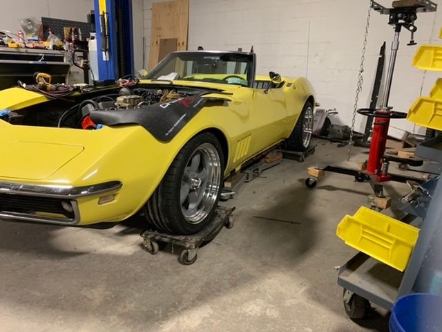

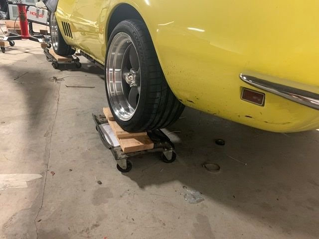

I think you are close to the limit. Just put 18x8 front 18x10 rear. tires are 245/40 275/35
My next set or rears will be 275/40.
You may run into inner fender clearance issues going much wider.
Note: you will need to get a narrow rear sway bar or modified what you have. I have a 68 and needed about 1/2” a side.
the 275s look good and correct as far as width for the car and you really don’t want anything sticking out.
i did offset rear, adjustable front a-arms, Borgeson and a Holley Sniper system. Just getting everything finished up. Ben a winter long project....
she’s still sitting a bit high in the rear. I have not setup the suspension yet.

10s are 5.75 BS 8s are 4.5BS
These are the wheels:
Amazon Amazon
Amazon Amazon
Note rear is sitting high as I have not yet setup suspension it will be about 1.5" lower

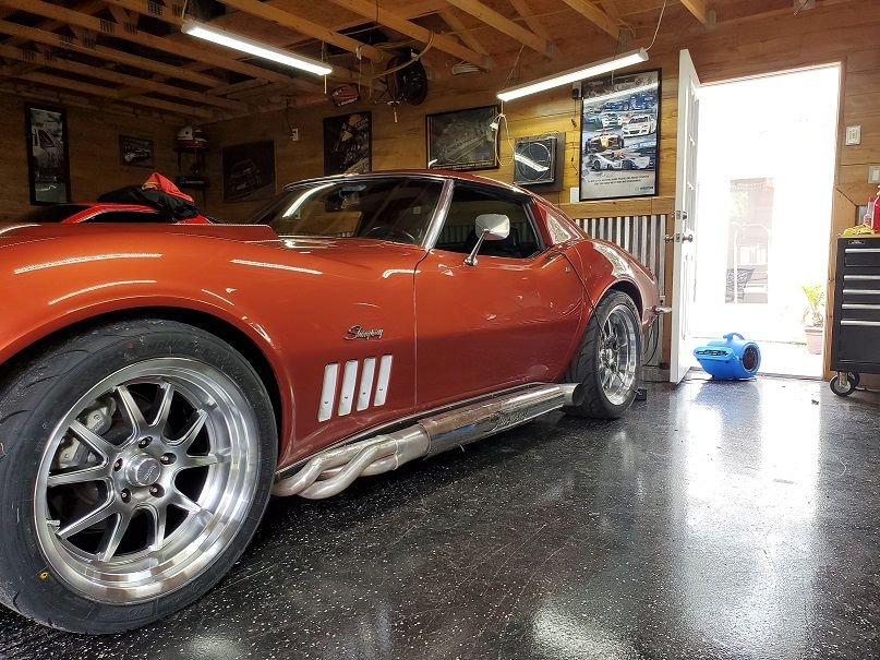

18x10 with 5.5 BS 285/35r18 front and rear. I don't think I could fit much more on there.
Looks great, I love the paint
Any rubbing up front lock to lock?
Also, the fenders on an 80 are a little wider right? I thought they have a little more of a flare. Or is it the same as the chrome bumper cars?

I'm pretty sure fronts will rub at lock. That doesn't bother me as long as they don't hit fiberglass.
These 285s are a little wider than normal..11 inches of tread and 11.4 sidewall to sidewall. Ride height is 26.5 front and 27.0 rear.
