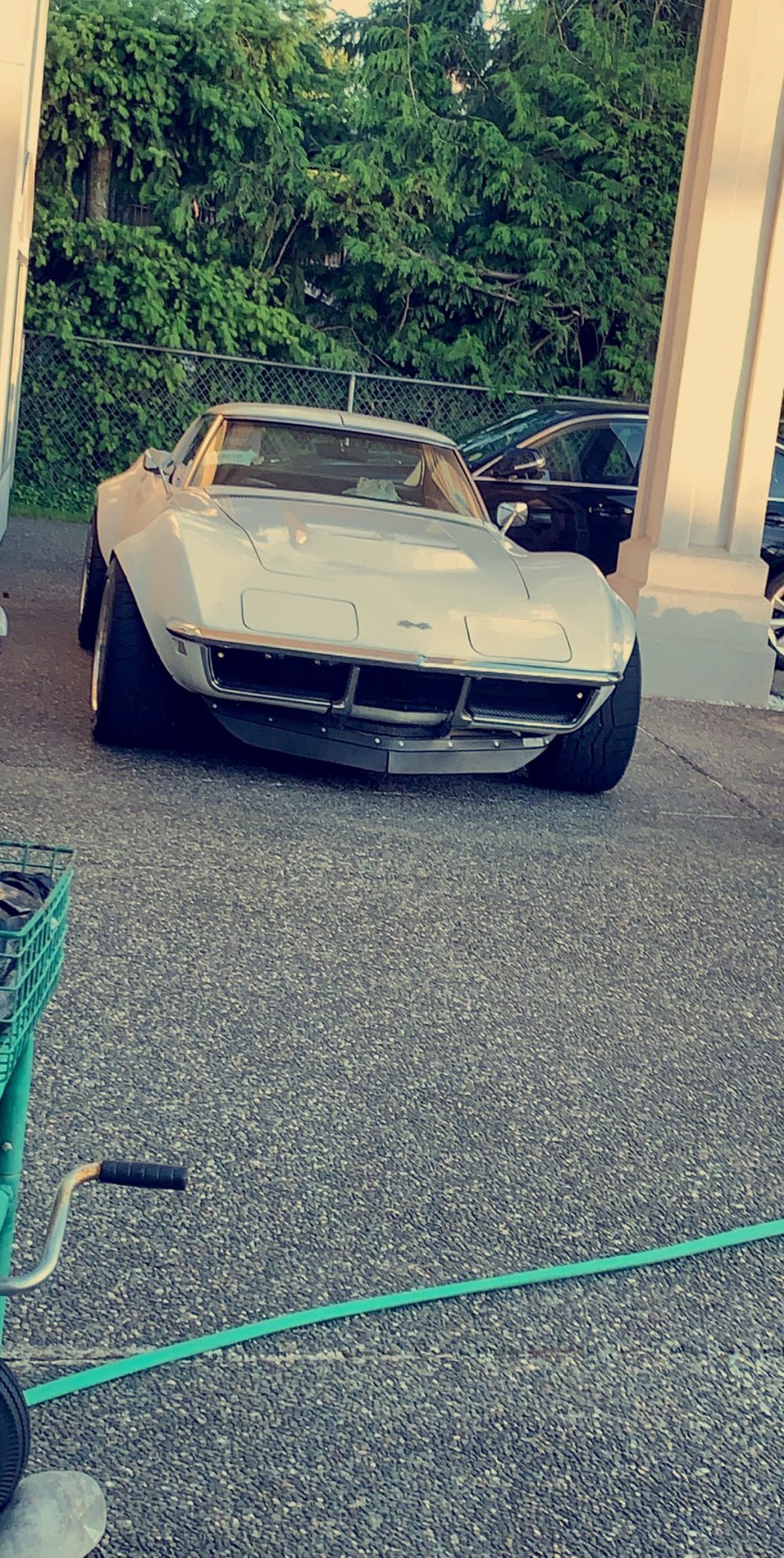

Here’s my 68 with 18x11 front and rear with 295-40-18 falken azenis 4.00” backspace. 1” adapter front and 1.5” adapter rear. With the huge L88 flares.
