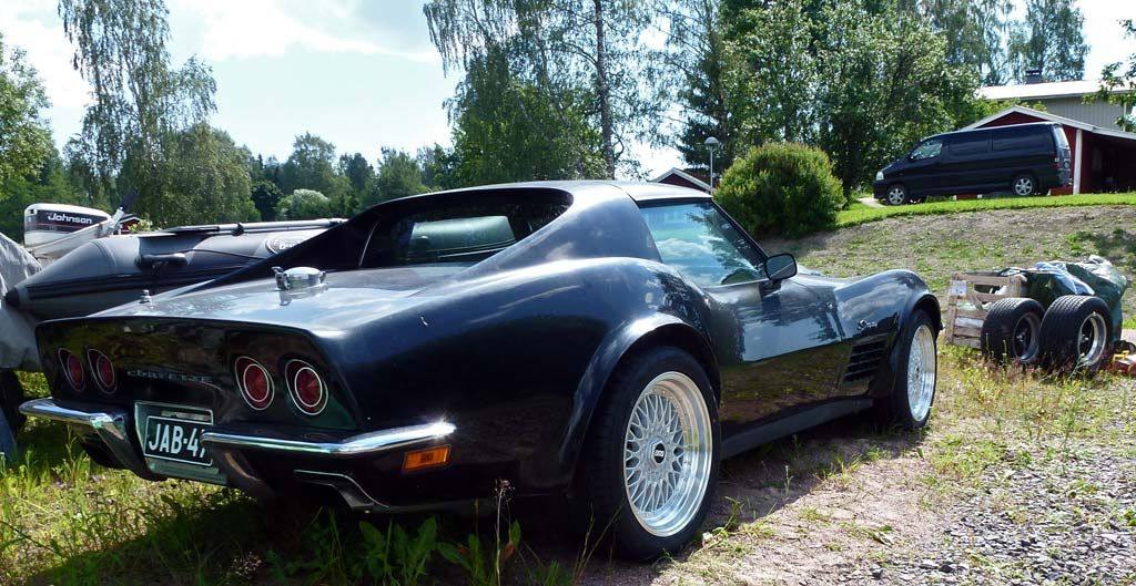

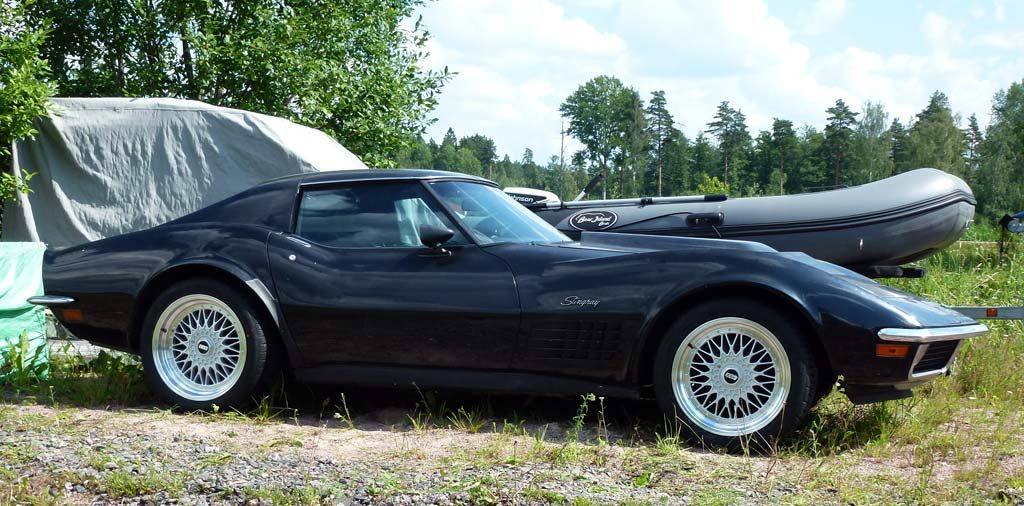

Then something different, C3 goes Euro
Note: the car is straight out of jack and has 0 driving so the suspension is still a bit high until it settles. And I have new shorter front springs and new A-arms waiting for installation.
Wheel size, rear 18x9.5 and front 18x8.5
Tire size, rear 275-40-18 and front 245-45-18
They are still bit inside the fender edge, could come out with thicker adapters maybe 1/2". Note: I have fender flares in back.

Beautiful car ToniH! But I must say, you're going to give her a complex parking her out there in the weeds.

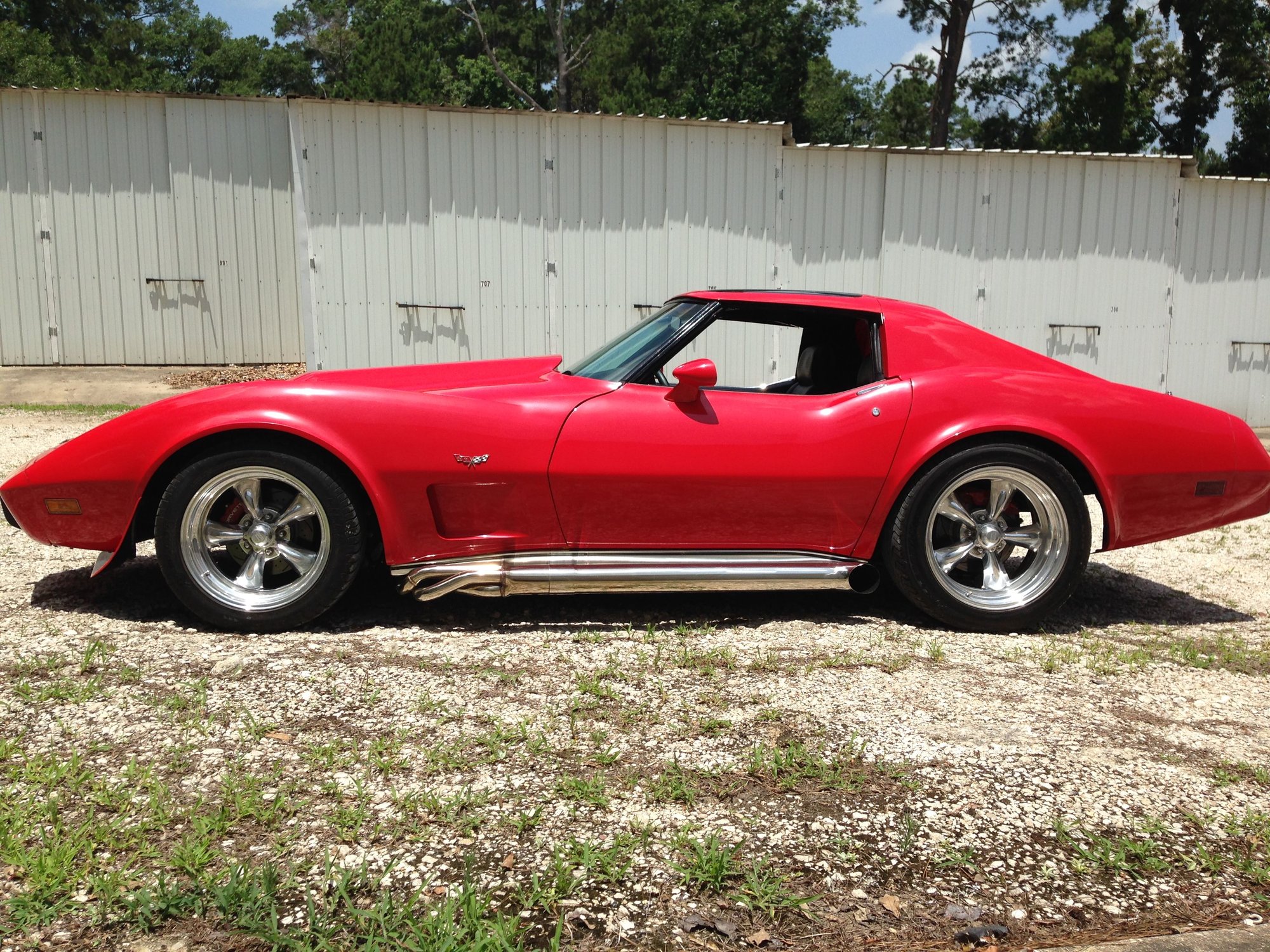

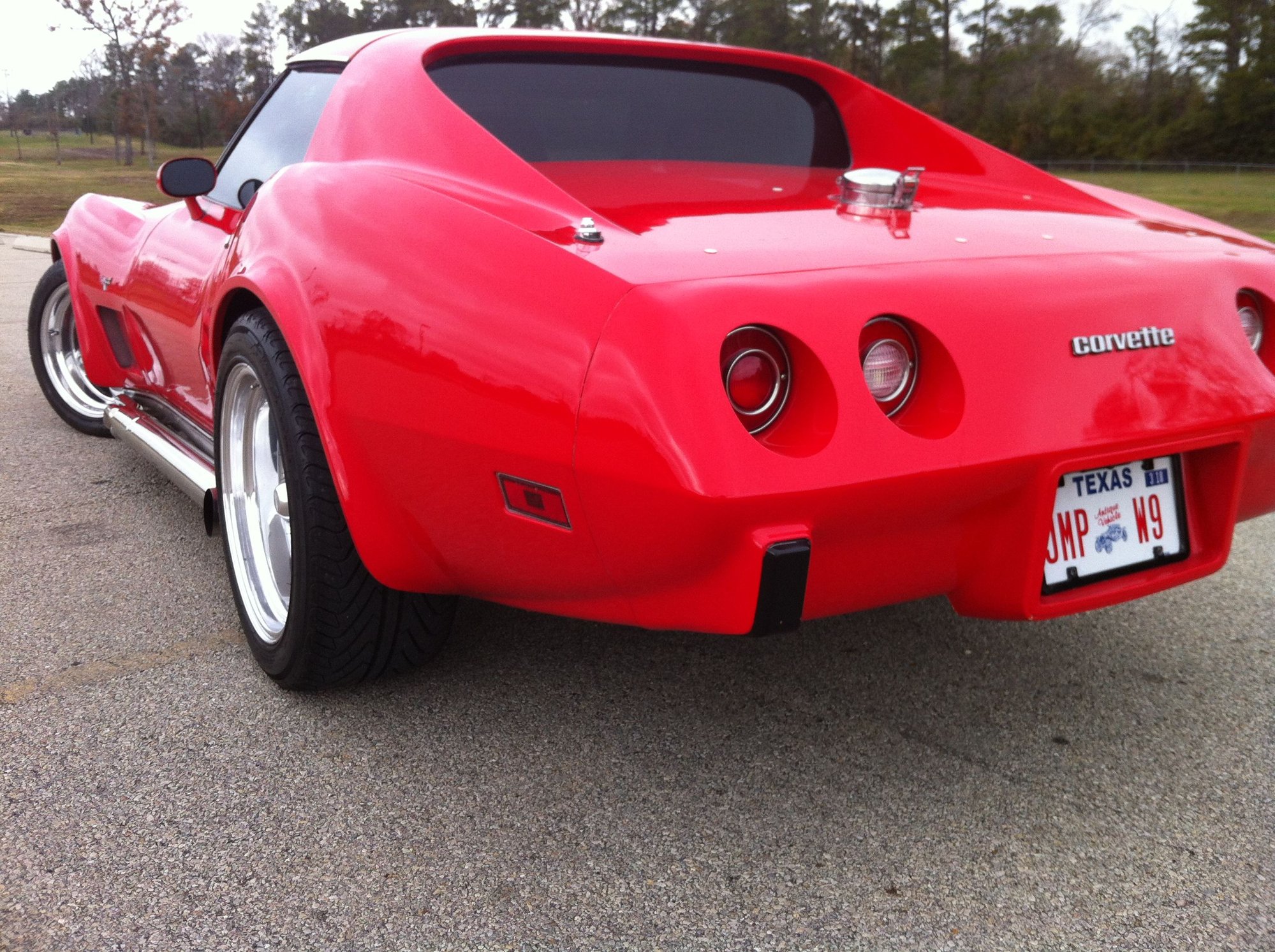

The fronts are 17x8 with 4" backspace. The rears are 18x9.5 with 5.25 backspace. I had to relocate the parking brake brackets to the top of the trailing arms. I also have a 1/4" spacer in the rear.
