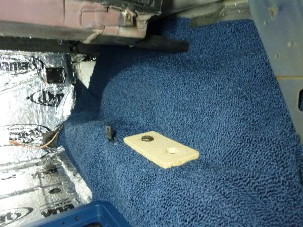

Then it was back onto the carpets.
Finished the rear drivers side.
Put center carpet in and used a soldering iron to make the holes for the rubber plugs. A chop stick down the plug gets them in fairly easily.
Tested with storage frame and all edges trimmed.
Courtesy light fitted.
Rear window storage shelf back in
Started on the panel behind the seats now.
