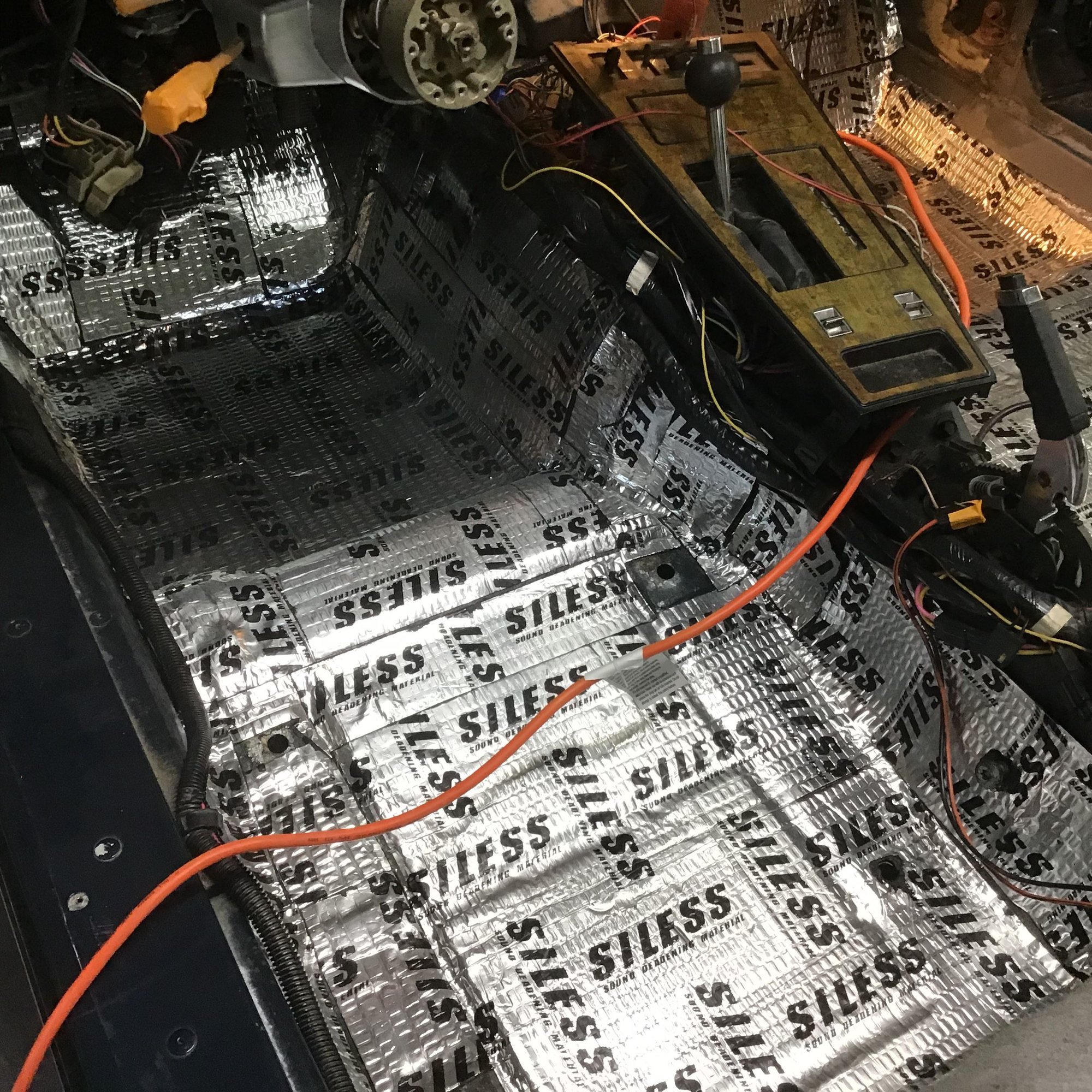

I want to hear more about the valve to cut off from heater core,I’m in the process of redoing interior on my 1981,new carpet,seat covers,painting all pieces including dash,and replacing my heater core,I am adding a sound deadner and a layer of reflex on top of that,then carpet,so would like to be able to control supply going through cab. Thanks for any help.
Now,will put reflex on top,for a roll from Lowe’s is only $25 and weights nothing.
