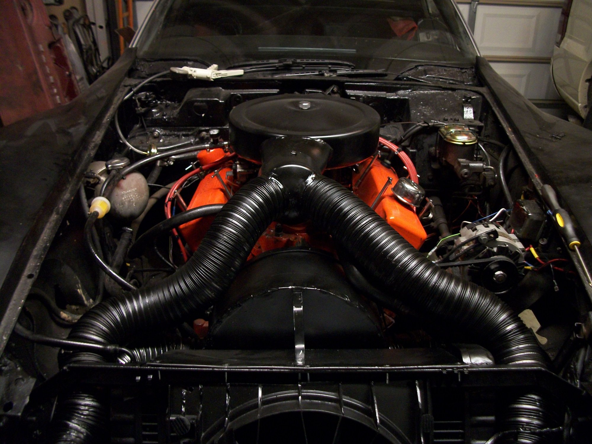

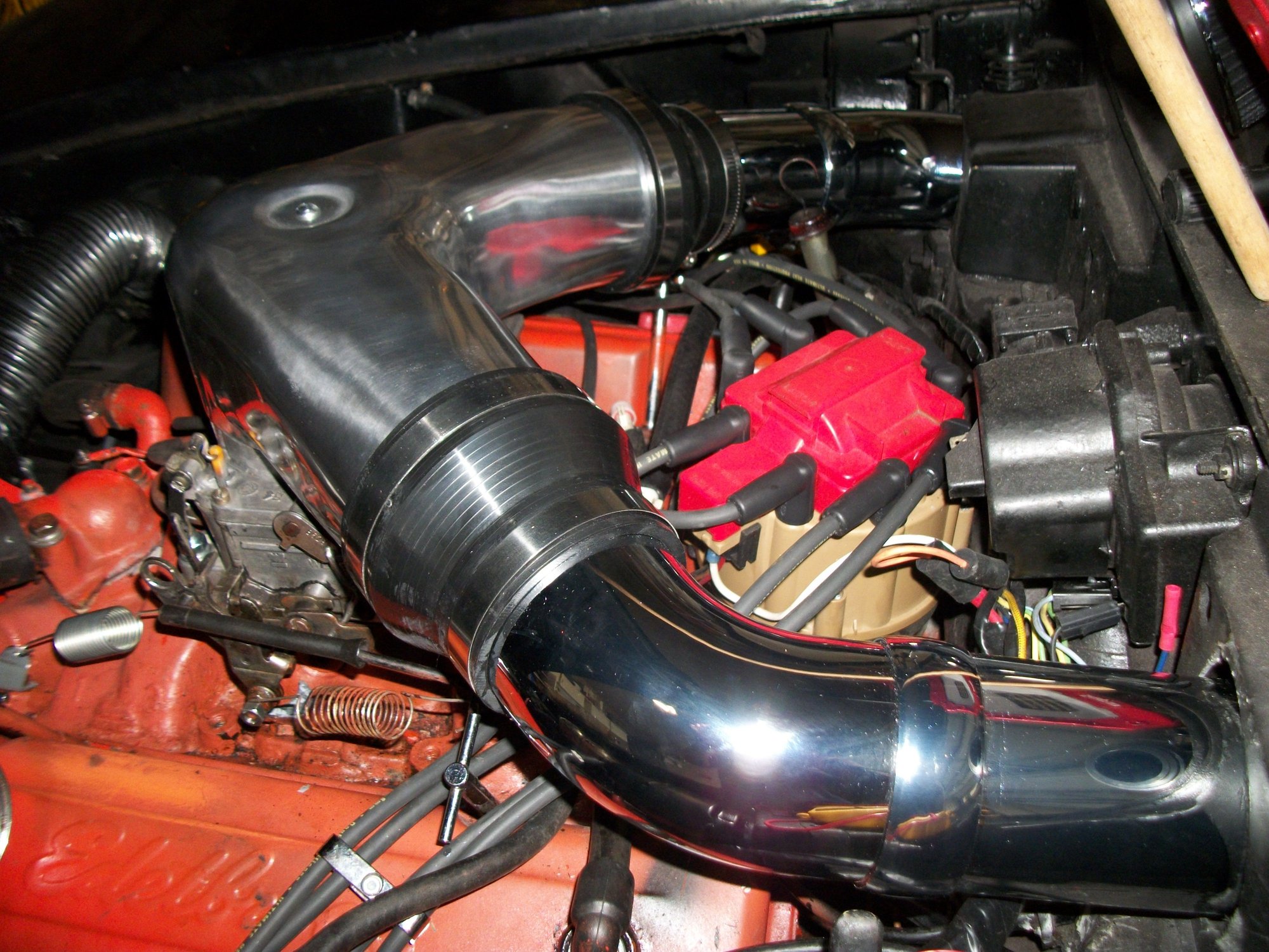

There is a little bit of good news though......."R2D2 CAI" has been replaced in the last year................
Thanks to the idea from Forum Member AddBaller...........He installed a long tapered cone filter in each duct that draws air from the wiper tray (I think I stated that correctly)..........
I also added a belt-driven 2000 CFM flex-fan with it's own separate CAI to force ambient air onto and around the engine/exhaust manifolds/steering box/etc.
NO radiator exhaust-air enters the engine bay......it exits under the car through a 30" wide by 6" deep by 24" high duct...........
(As I always state......I would NEVER do such mods to a decent C3)

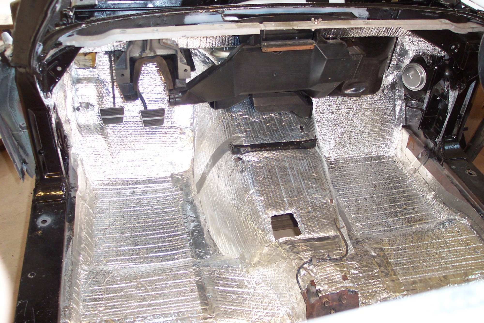

1 valve still allows hot water to the heater core, it just does not flow thru.
double valve will completely isolate the heater core.
if you run 2 vales you can shut off the core in case of a leak.
with only 1 valve you cannot shut water off from leaking heater core.
picture of my insulation job, I take it all the way up the firewall.
