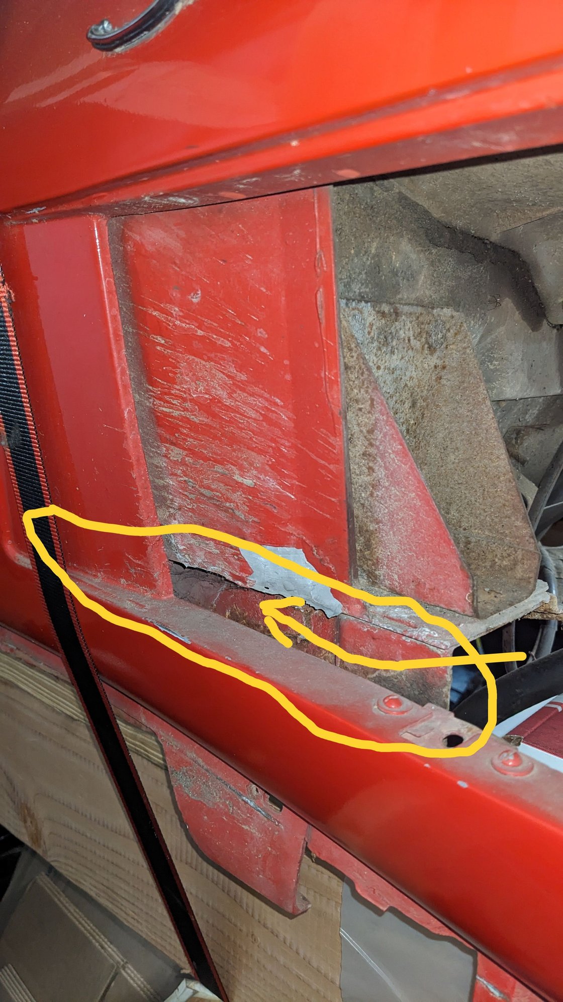

Woah!
I wandered around our local Corvette graveyard today and found this!
The.upper area (blue) was again not bonded, and a hot air leak! That makes at least two like this. Might just be a pattern as to where the factory put the bonding
And the lower area (pink) has a HUGE SQUARE CUT HOLE! Looks OEM. For water drainage I guess, but unnecessarily large, that will let huge amounts of hot air in.
Plug those bad boys up!

Let's think about this: the square hole at the bottom is too large for me also, but they probably made it that way for leaves and acorns to fall thru. Replacing the screen that covers the top of that area should prevent leaves from clogging the hole which means you could patch that square and drill a 1/2" or 3/4" drain hole there.
The designed air pressure flow that goes to the vent door should keep dust and water blowing out the new hole you make.
You could clean recalk the entire area once you have made all the repairs.
Think about it.
