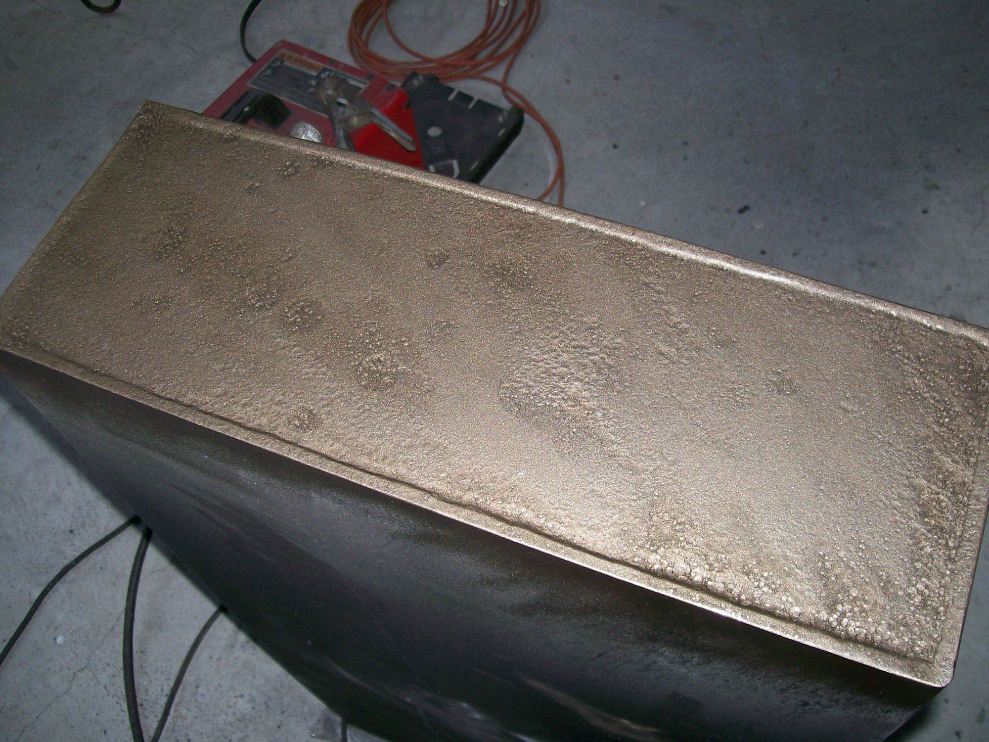

I finally located a metal supplier that would sell me a single piece rather than a 4' by 8' sheet of carbon steel......
I laid out the measurements and cut out the section..........
I tapped the piece in place and welded it......(Not "pretty"...but solid)
I ground/sanded the welds and sprayed the end to prevent rust....naturally I was out of black primer and only had hammered bronze spraypaint ..............
I'll pressure test it tomorrow.

I have found that on metal less than 1/4"thick a 4 1/2" side grinder with a 1/16" cut-off wheel does a good/fast job.

The day was over but I started testing the tank weld for leaks......
The first pic is a visual as to what pinholes look like when sprayed with soapy water while the tank is pressurized to 5-7 psi.......
The next two pics show bubbles coming from two separate pinholes in the new side that I welded into place last week (two pinholes for a rookie welder is a good thing....LOL).............
I welded those pinholes closed and re-pressurized the tank to check my repair.....no leaks....
so I went to the opposite end of the tanks and checked the welds.....three pinholes on that end which I re-welded and retested.......
Tomorrow I will test the long welds across the front of the tank and do any touch-up welds if needed.
A "pinhole" in a welded seam can be "plugged shut" with a human hair because the hole is so small (of course the hair would disintergrate). Fuel tank coating would easily seal a leak that small, but I may as well repair them before coating the inside of the tank with a sealer.
