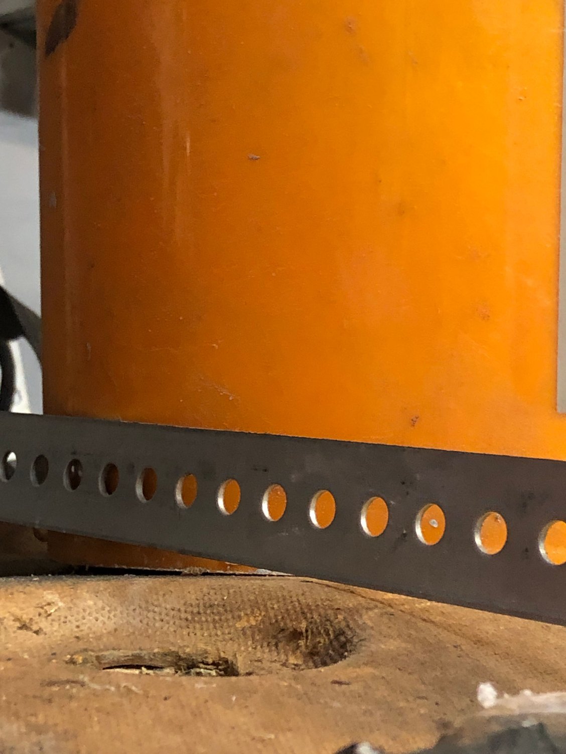

The "Final Assault" on the door glass fit has begun. A month of hanging on the pegboard has the top wrinkled again
The front-top of the glass has a 5/8" gap and 1/4" gap oat the top rear of the glass. The entire front edge of the glass needs to move rearward 1/8".
The Blue tape is a guide for adjusting the glass upward.......
While I am adjusting the door glass I have the door panel on saw horses with 50 lbs. bucket on it to remove the arch which prevents the panel from sitting flat against the metal part of the door. I want a 1/2" concave arch on the panel which will be pulled flush by long "Resto-mod" panel screws.
Right now there is only 1/16" concave arch which will not allow the panel to lay flat....
