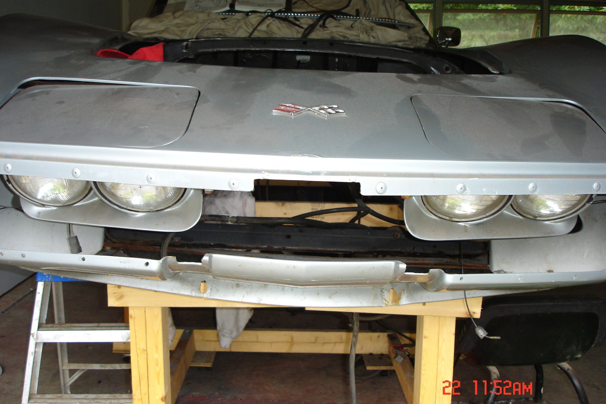

Originally Posted by Brack c
Looking Good Tony ,
Nice work you got going on with the grill .
Thanks....I've been reading modification threads for the last year and finally have the courage to give it a try. Members are giving me some great advice about making the process as simple as possible (good news for my PTSD brain).
So far..............pre-modification to present progress..........
I'll try to rough in the passenger-side grill and the center grill tomorrow.....the 2 chrome lower trim pieces should be here.

Here are a few different angles Tony. Something specific and close up let me know and I will go down and take a picture. Hope these help.
ZIO

ZIO replied: Here are a few different angles Tony. Something specific and close up let me know and I will go down and take a picture. Hope these help.
ZIO
YOU DA' MAN!
Now I'll be able to do the final trimming before re-fiberglassing!
