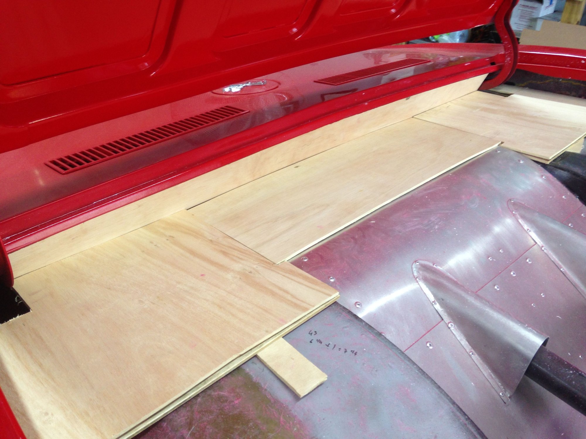

working on the "trunk" interior panels...creating as I go. Going to leave the center alum portion exposed (either polishing it or brushing it) and the side panels will be covered (vinyl or leather don't know yet).
Another good use of the steam rollers: panel shaping
fitting some interior panels
Cut some stand offs for the panels to attach to.

more work done in the trunk. Also fabricated and installed the stand offs for the panels on the pass side.

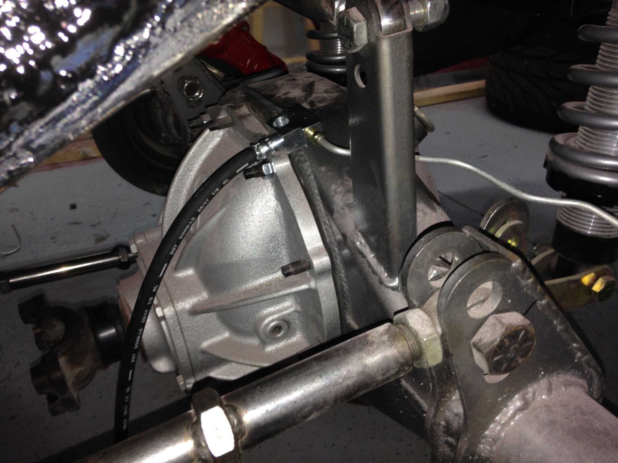

Today, made some brake lines for the rear and fitted the main brake line (front to back). The driver side is a stock line, I adjusted some bends. The pass side is actually the cross over line, which I cut and added some bends
Bracket for the hose is drying on the bench, it will attach to the third member. The rubber line worked out perfectly: the main line ends where it can reach with some slack. All I have to do is add an adapter and make a bracket where the rubber line will attach too. Talk about the luck of the draw and that one!

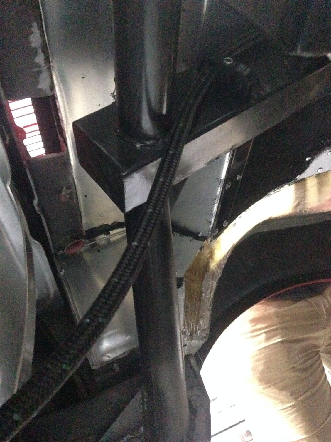

Fuel line clip
Fuel line clip installed
fuel filter installed, this would be the back of the tank. I used the support bar and riveted a mounting plate to hold the assembly

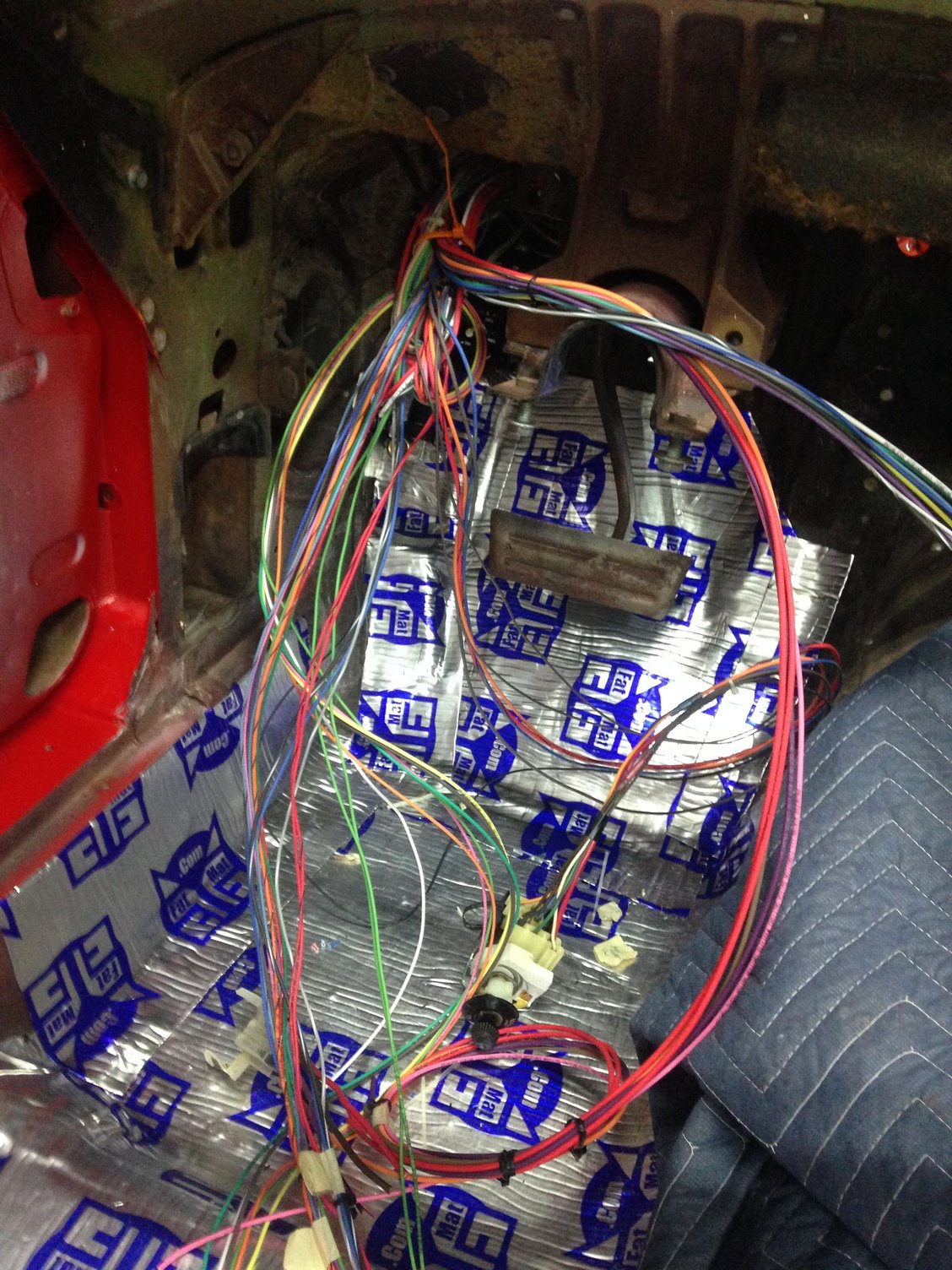

One step at a time they say...
Master/booster is on, and all the brake lines are in hand tight for now (need rubber lines for the front still)
More wiring done today: dimmer switch installed and wired, headlight switch wired. Tail lights are all wired in, front lights have been run, cut and sockets put on, as well as the wiring for the electric actuators. Alternator 12v and harness ran to it (still need to do the pigtail) as well as the maxifuse wired in and perm installed.
Started FatMat installation, as the carpet arrived as well.
It's a little bit of everything but since I'm just a one man show, I tend to work on a couple different things at a time to avoid loosing my mind... such as today, wired in the dim switch and headlight switch (that was the goal for today) and started looking at the ignition switch, then my mind shut down, so I moved on the brake lines (little less tricky-ish)

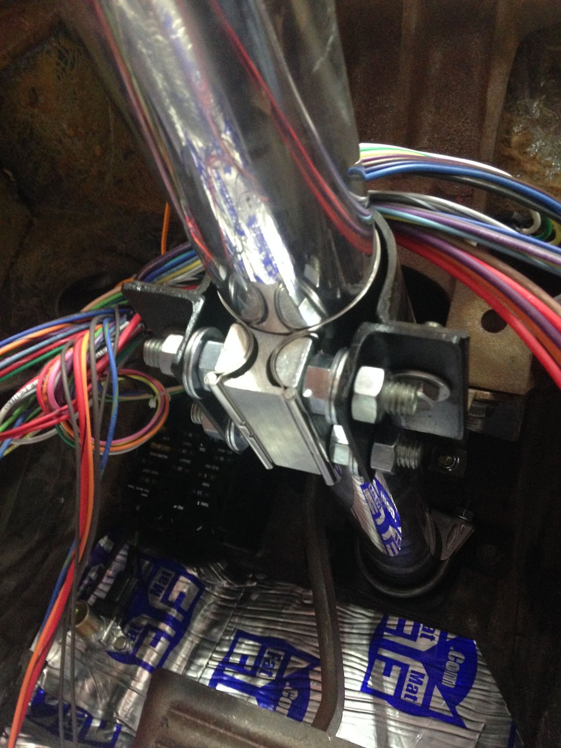

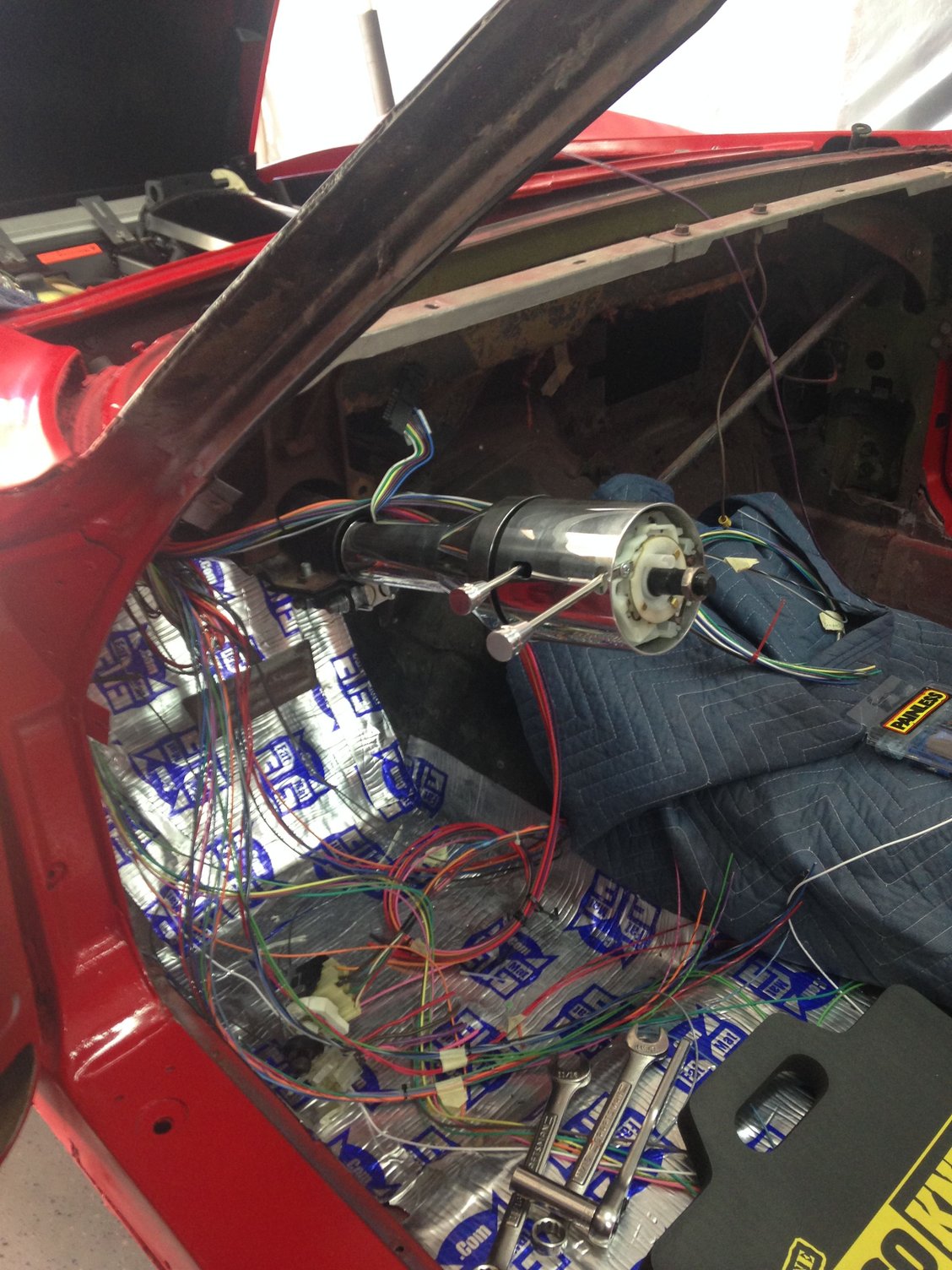

and just like that, the car has a tilt column

it is an Ididit universal aluminum column, 2.25" diameter and 32" long
here are a couple pics of the custom mounts:
