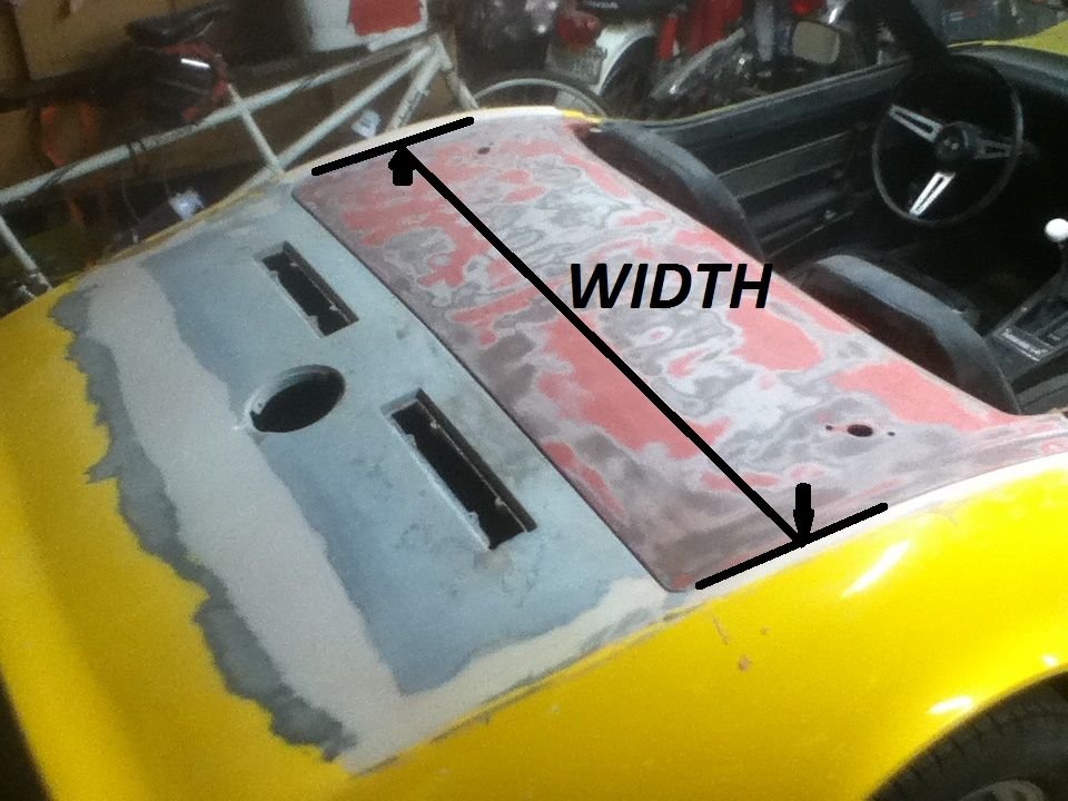

lowbuck72.......can you post the two measurements in the pics below, and also the radius of the lid rear corners? The previous owner fiberglassed over the gap/the deck lid will not open. I will be able to cut out the filler and make the lid usable again.....................

Hey DG, the width of the decklid just behind the seats is about 55 1/2", but tapers down to about 53 1/4" just before the radius. The radius is about 1 3/16" which is one half of the diameter I measured at 2 3/8".The center length of the decklid to the first front crease is about 20 9/16". I hope that helps. Too bad it wasn't just bonded in or you could just take the handy heat gun to it. Good luck

You guys ......... keep an eye on me! I didn't even think about the heat gun.
I'll mark the area and use the heat gun first/maybe I can dig out the filler if the gap isn't fiberglassed shut!
