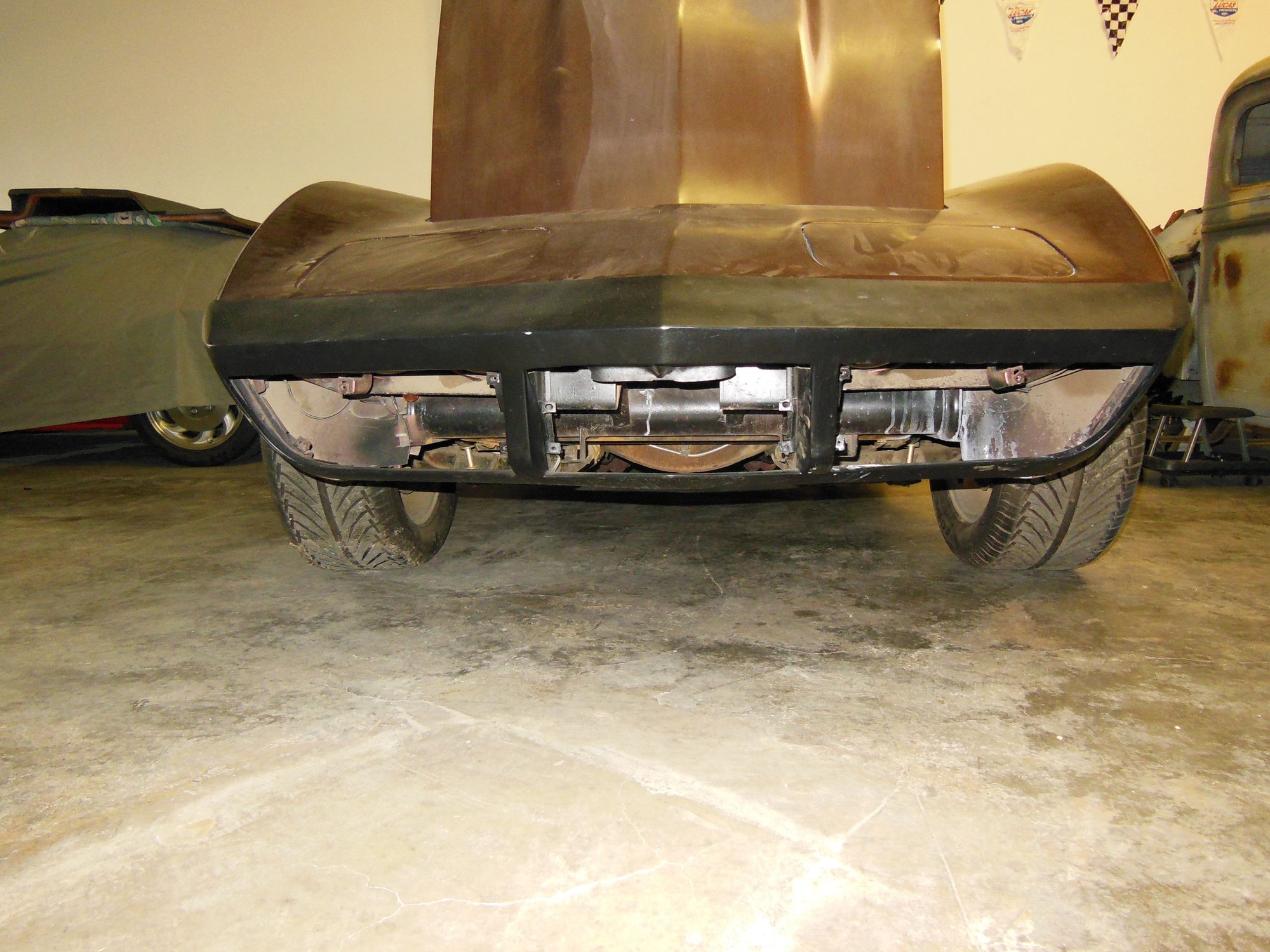

Inspect the front end carefully. Take a close look at the frame and see if both sides look 'even' or at least straight. Take a look at frames before you even go, so you have an idea of what the frame should look like. So you'll know if you see distorted sections or welded up stuff. Look too, at the A-arms, their shape and relation to the frame.
Check the front clip, where it bonds to the firewall and see if the entire clip got replaced. Mine was done pretty well, but there was a little bit of sloppy seam, nothing structural, it just had to be ground down to look good. Stick your head inside the inner fenders and look with a flashlight there too.
Mine was completely missing the grills, the bottom pan, had turn signal lights dangling, headlights had cheesy repairs and on and on. It all got fixed in due time. Perfection it is not, but I got it looking halfway decent.
Before: When I just got the car, three years ago...
After: Still has fiberglass nose in unpainted black, but I kind of like it that way and it's my Corvette, flaws and all and l love her for what she is.

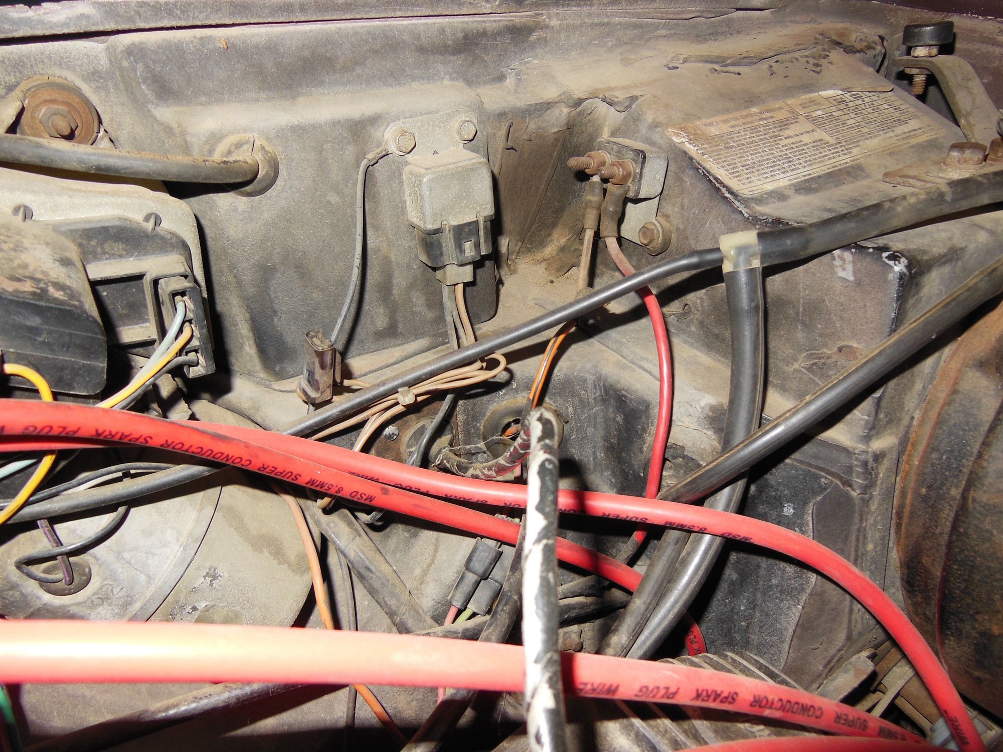

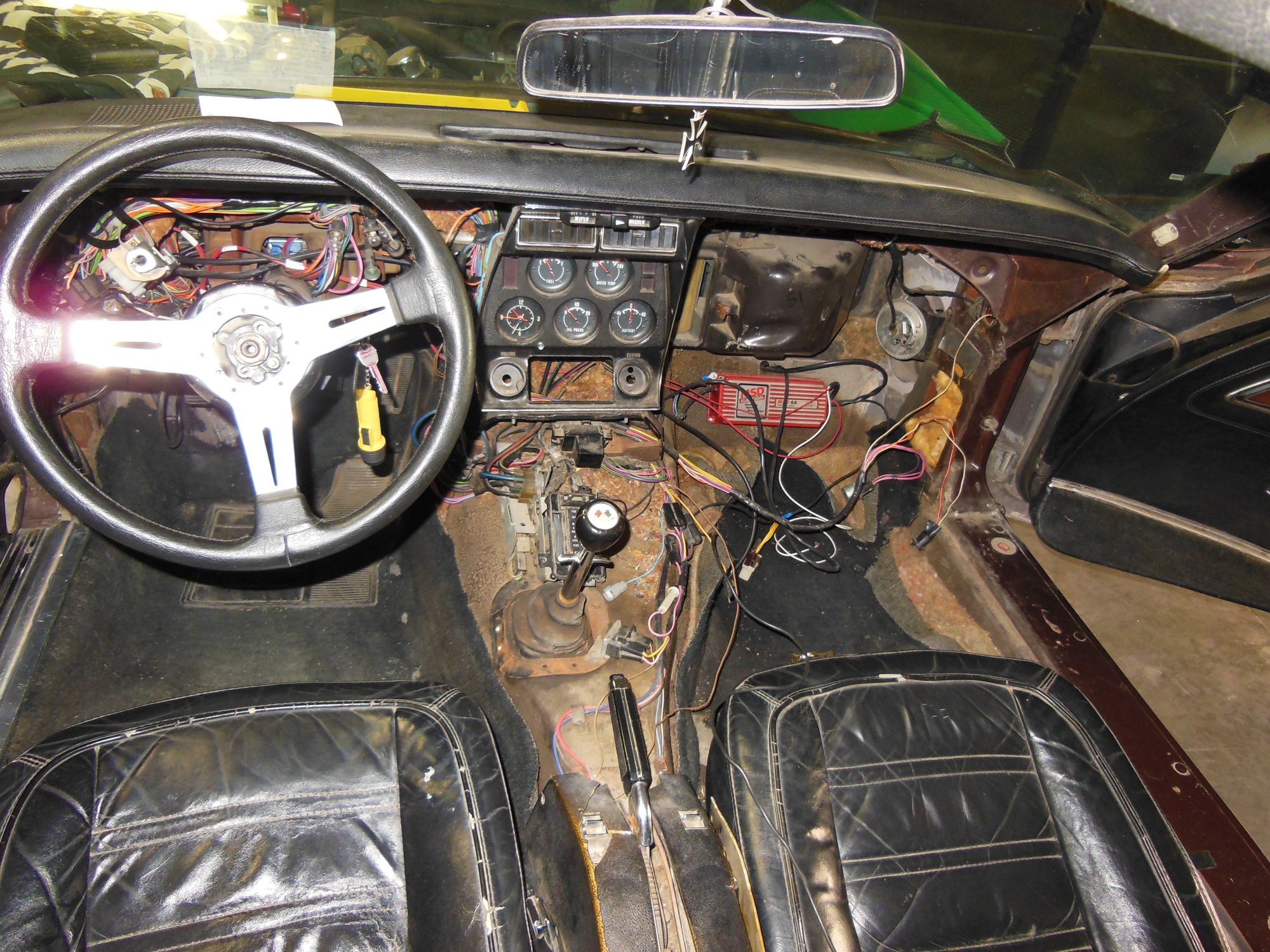

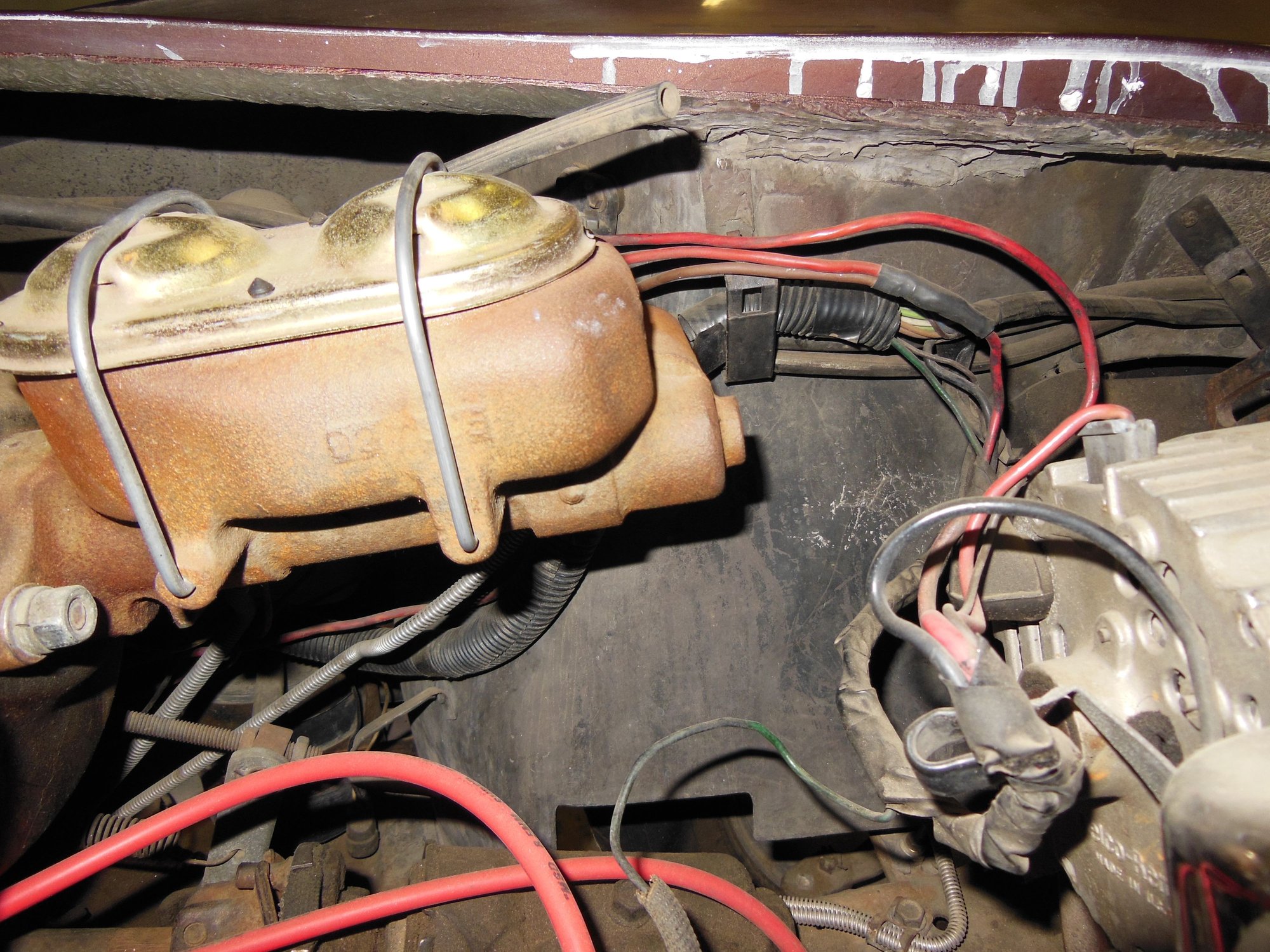

I have no doubt at all the car was wrecked in the right front. It's not just the grills I'm looking at. It's a combination of items.
Nose support bar bent. Just left of the left headlight.
Right front wheel is set back.
Right front fender is too high in the middle of the wheel well. The side grill is pointing slightly downward.
Nose is high in the middle but low on the corners.
Lower valance is too far forward on right side. Since it is bonded to the fenders it cannot be out of adjustment.
Door hinge bushing are bad on both doors. Both doors are low in the front because of the bushings. The driver door, and probably the passenger door, was adjusted at the lower hinge.
The doors are low, the beauty lines don't line up, but the door gaps are perfect. The rear gap should be wider towards the top of the door.
The beauty line of the door does not line up with the line on the quarter just in front of the rear tire.
The large warp in the nose just above the right headlight doesn't usually happen on a 72 because it is riveted to the support bar. Unless it has been wrecked, support bar completely rotted out, or has been separated from the support bar.
The ends of the front bumper have been bent upwards to line up with the body. They should be level.
The right side of the front bumper is bolted thru the fender but is way too high. Either the bolt hole has been reamed out or the bolt is missing.
Right side rocker cover lines up with body but not with front fender.
Other observations:
Very cheap imported windshield. Technically not legal in Texas.
Passenger rear door jam. Bodywork was not done by a shop familiar with Corvettes.
Many incorrect screws in interior.
Parking brake slide missing.
As mentioned before, center gauge cluster installed very badly.
Wiper door does not work at all. In one pic it shows the engine running and the door still up.
Evap hoses missing.
Vac hoses are a mess.
Hose retainer behind booster missing. This may sound like I'm being way too picky but why was it removed in the first place?
Wrong bolts in ignition shielding. Should have wing bolts. Once again a very minor detail but it does shows the mindset of the person that owns it.
Radiator seals missing.
Spray can detail job in engine compartment.
When you add all this together it's not a pretty picture. It's not so much the actual imperfections but how the imperfections got there.
Unless there is a sticker inside the fender saying it came from Ecklers or any other vendors, it's very hard for me to tell you how to look for body repairs. Sometimes it comes down to the color of the bonding adhesive, cracks in the original adhesive, bonding strips that are missing or too many of them, and even the two dimples on the inside of the front fender lip.
You also have to look at the money spent. Paint jobs and interiors cost big money but the little inexpensive parts were not purchased. With the doors sitting low in the front, are the door seals making full contact. If not what will it take to make them seal? If the doors need to be raised the door gaps will have to be recut. This is why I would like to see pics before the paint job. Everybody takes pics of their vette when they first bring it home.
Mike
