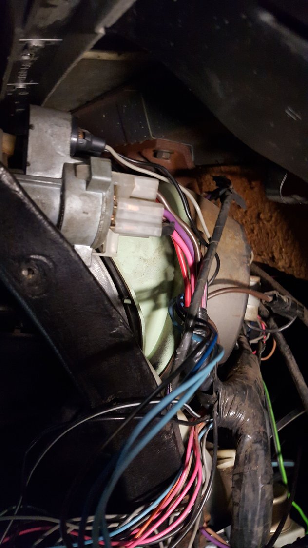

My ignition switch (1968) has a light socket and bulb, they look in age to be original. I thought the same thing....how does this bulb light anything?

Now I'm curious what the light socket that's part of the harness looks like?
Regards,
Alan
Old Jan 18, 2016 | 06:53 PM
Staylor63's Avatar
Staylor63
Joined: Oct 2015
Posts: 1,088
Likes: 98
From: Roselle Illinois
Originally Posted by Alan 71
Hi,
Regards,
Alan
i will take some pics when I get home!
Here is what I see...
Going right into the main harness.
