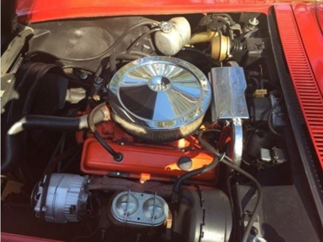

Hi C3 lovers,
I'm still on the hunt for my dream car. Can some of the 71 experts take a look a this motor and evaluate it for originality? It is numbers matching but I'm not sure of the small details of what should and should not be under the hood.
Sorry but this is the only angle I currently have. I've asked for more and will add them once received.
Thanks again.

Shouldn't you have a dual snorkel breather? Also, shouldn't there be a hose from the vapor canister to a T connector at the PCV?
Waiting for Alan to comment, but until he does here's a picture of your '71 engine:
Here's 2 pictures of Alan's '71 engine:

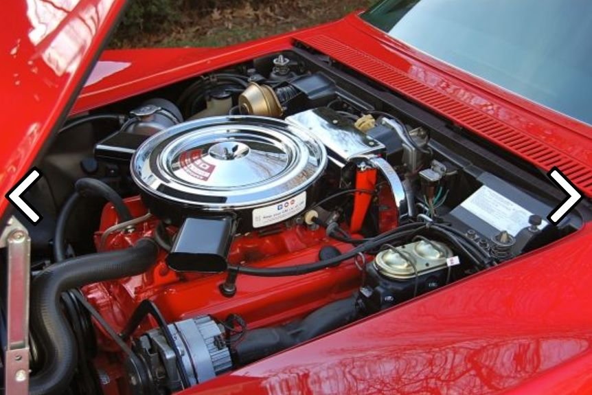

Old Jul 1, 2016 | 02:00 PM
Thanks! This is a beautiful engine!

Hi,
Actually the closed base, duel snorkel air cleaner appeared on late 70 model year base and 454 engines after approximately serial no. 12000.
The open base continued into 71-72 on LT-! and LS6 engines.
Looks like a pretty nice compartment based on 1 photo.
Regards,
Alan
Curious what this is?
Similar view.

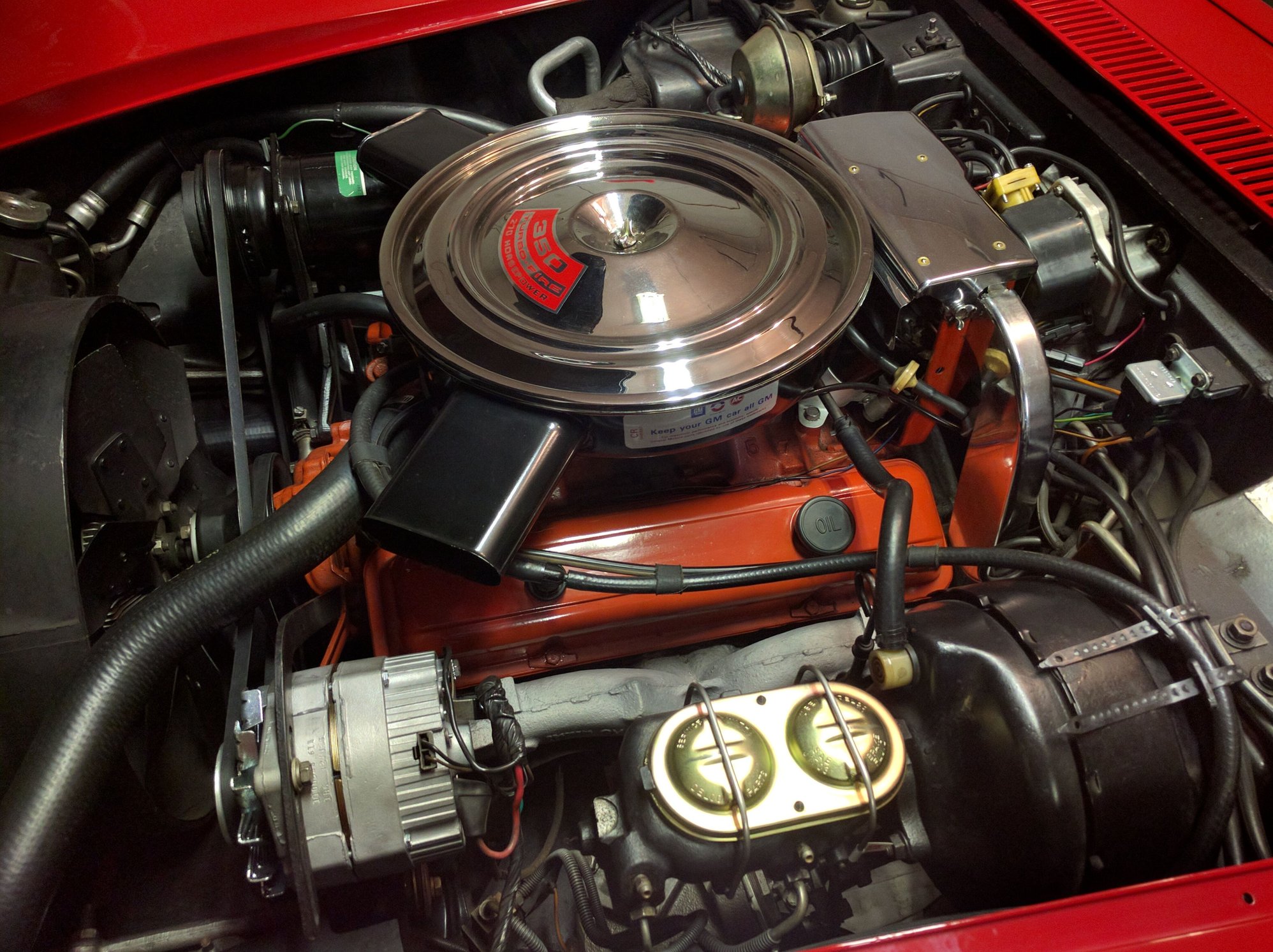

A quick glance reveals: Missing emissions sticker (behind the brake booster), Wrong air cleaner and air cleaner lid, Vacuum hose routing re PCV valve
This is my 71 base motor, automatic, AC car (I think your fan shroud is right, mine is for an AC car only I believe)
Look for your CEC solenoid too, as that is a 71 specific part which was frequently removed/disabled.

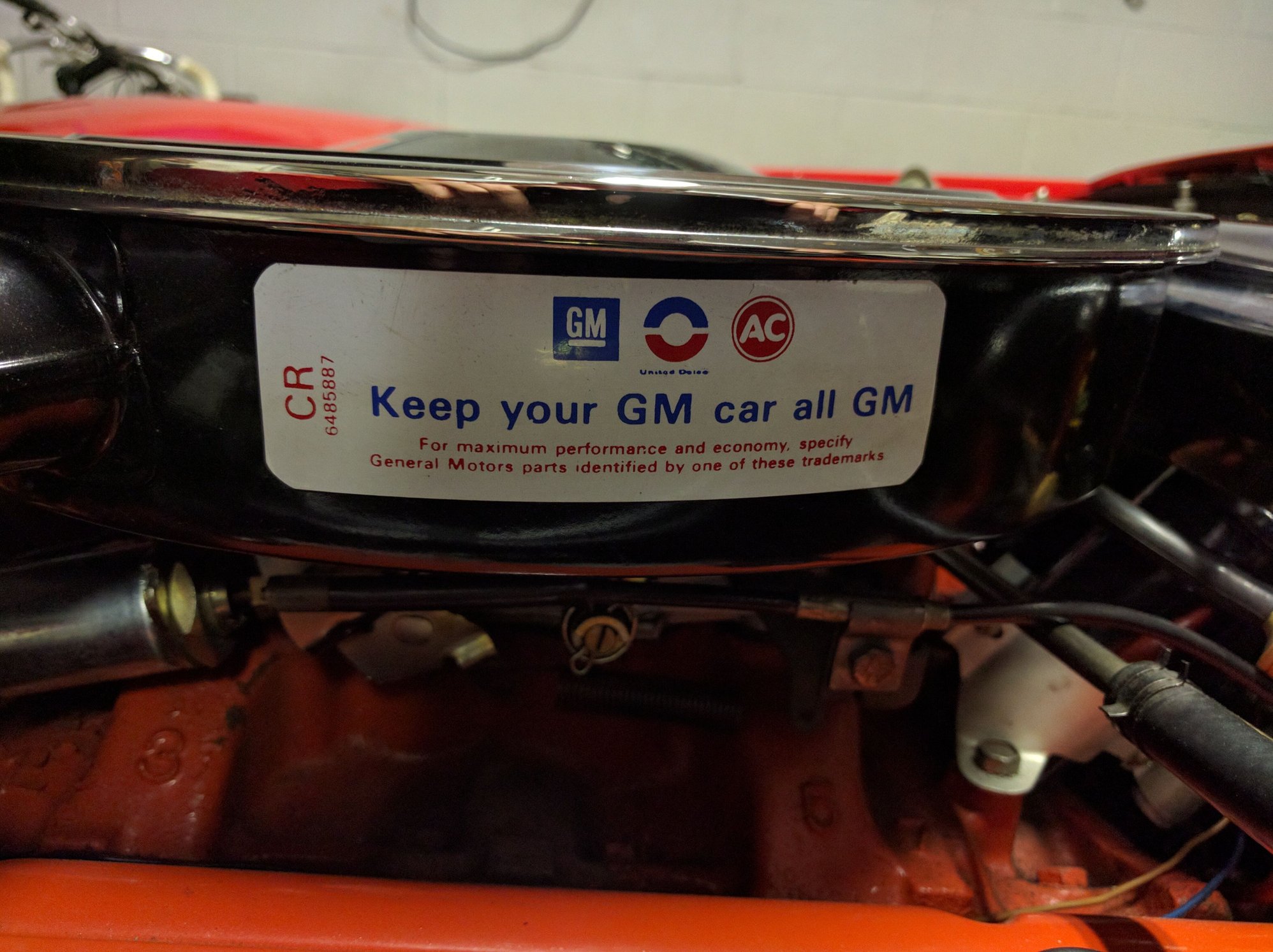

Do you think the air cleaner base filter advisory is original?
If I may; what's the sequence #?

Originally Posted by Alan 71
Hi TL7,
Nice looking compartment!
Lot's of details to notice.
Regards,
Alan
If I had to guess I would say its a repro. My reasoning being that in the box-o-parts I got with the car had my original air cleaner lid in it (albeit in rough shape, and this air cleaner base is in pristine shape). I don't doubt that its a high quality repro though because when I got it judged no one said anything, and I haven't seen any marks on the PO's judging sheets either.

Hi TL7,
Thanks for the close up!
Regards,
Alan
