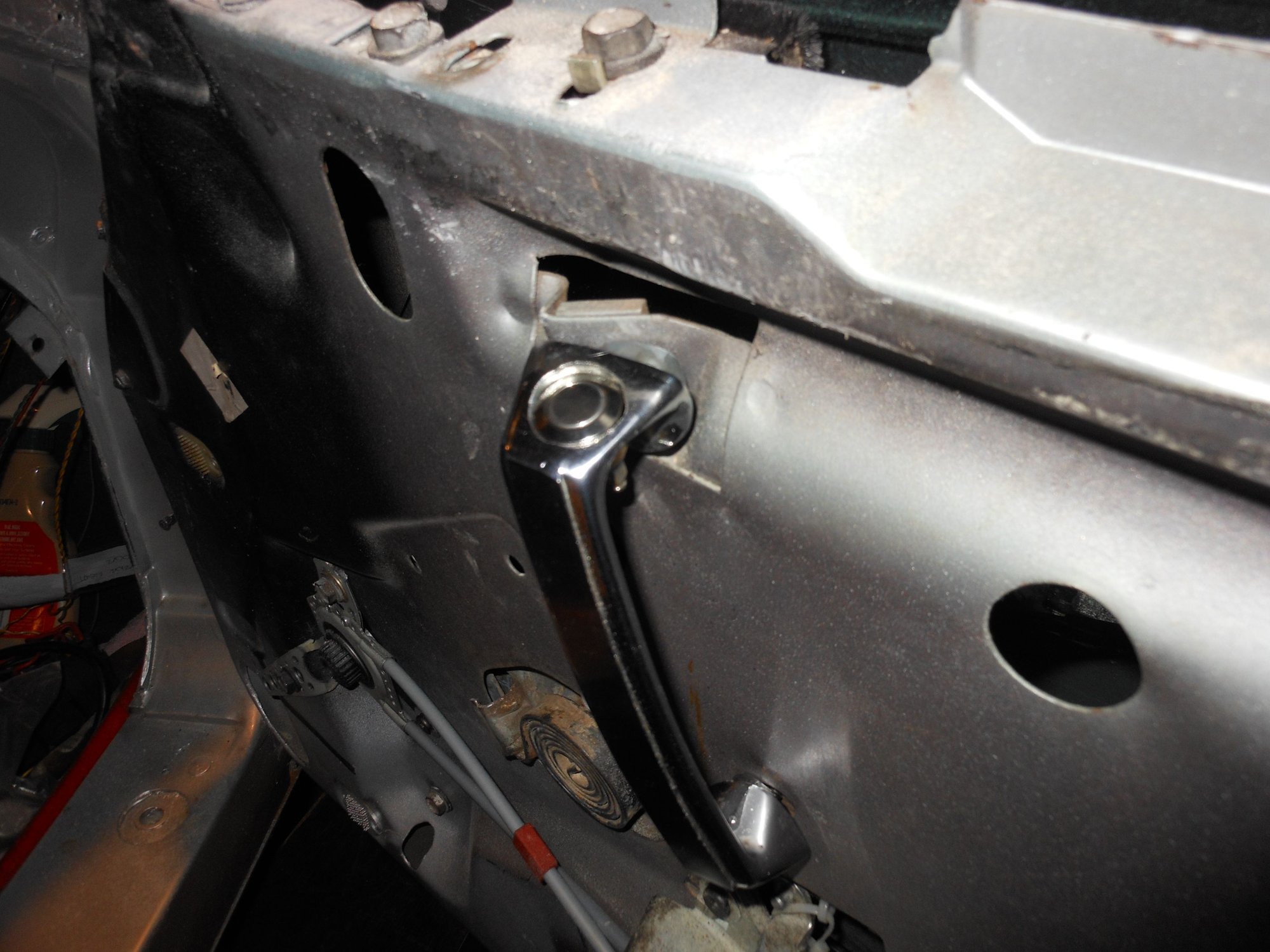

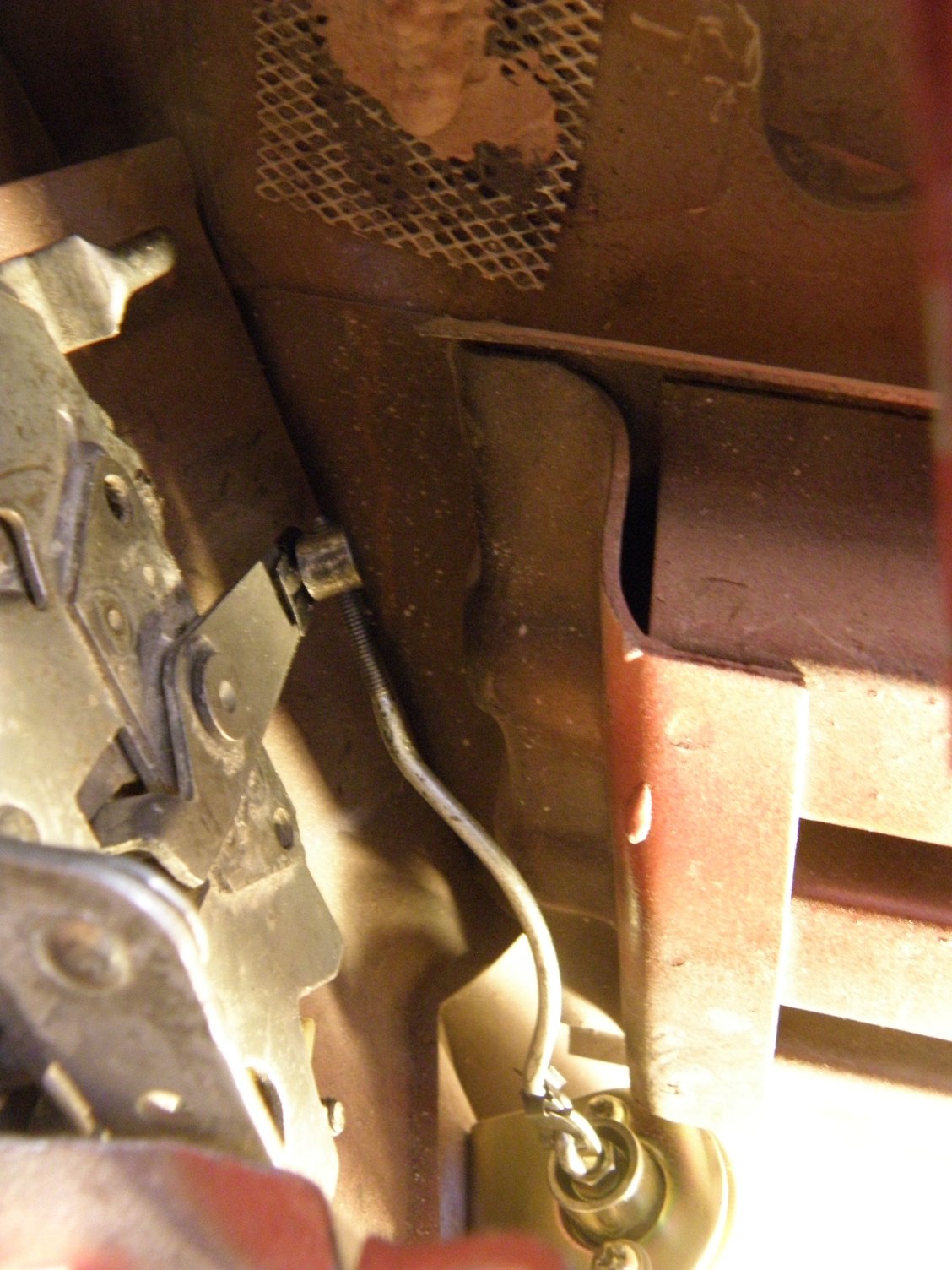

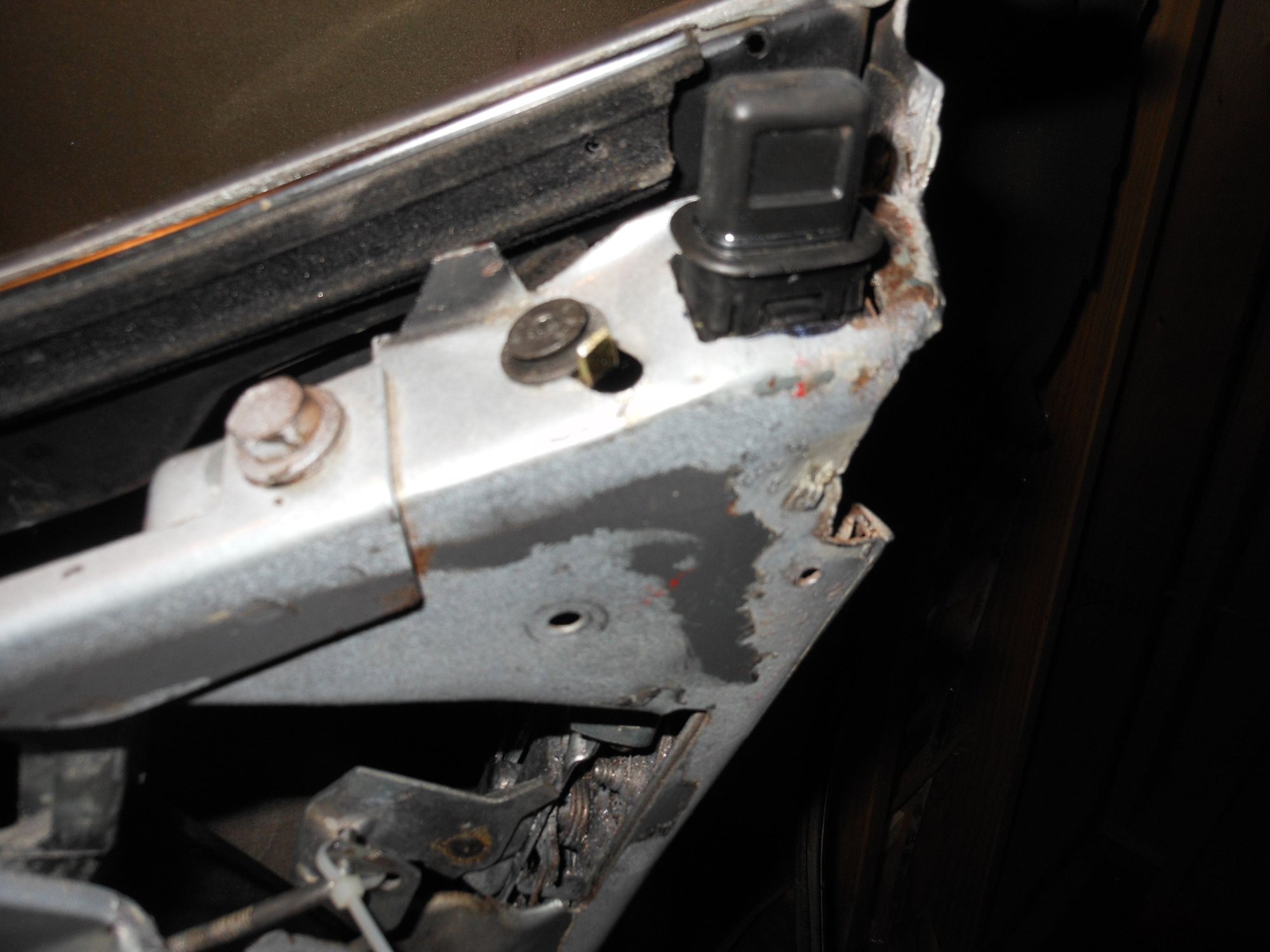

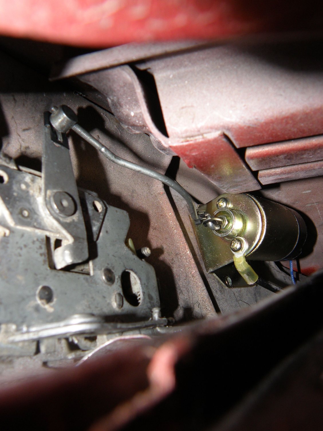

Attempting to install door solenoid to pop open door with remote switch.
I want to use the original linkage it seems stronger. Has anyone tried this, what was outcome? ANd the position is in question but it seems the only place.

I normally have this on any of my personal cars, my 66 was tricky, I had a small cable around a pulley to the stock latch to get the solenoid in a good spot, on the 66 I shaved the sticking out door handles but on my 69 will leave the handles as they do not stick out from the car,
I also had to add a spring to pop the door about an inch to be able to have something to grab to open it.
the key to it working right and for very long is the solenoid has to pull straight, if the pull where you have it is straight then it should work okay.

I'm in the midst of doing mine...mainly because I am modding the interior door panel - I wanted to clean it up. I used the factory linkage all the way to where the pull is- and mounted the solenoid on the bottom of the door. The handle requires a lot of force so I made a bracket linkage that I could take advantage of the leverage.
Not at the car now- but will post some pics later.
Oh- go to the junkyard and look at the emergency cable pull trunk release set-ups. There's so really neat pieces you can scavenge off the inside of the trunk .
I moved the door lock as well-Used a M-B door lock pull-
And here's the button to release the door- and yes -I have it wired so driving down the road the door will not unlock... the brakes or e-brake has to be on.
I am letting the Solenoid hang free for not to get that straight pull you talk about.
