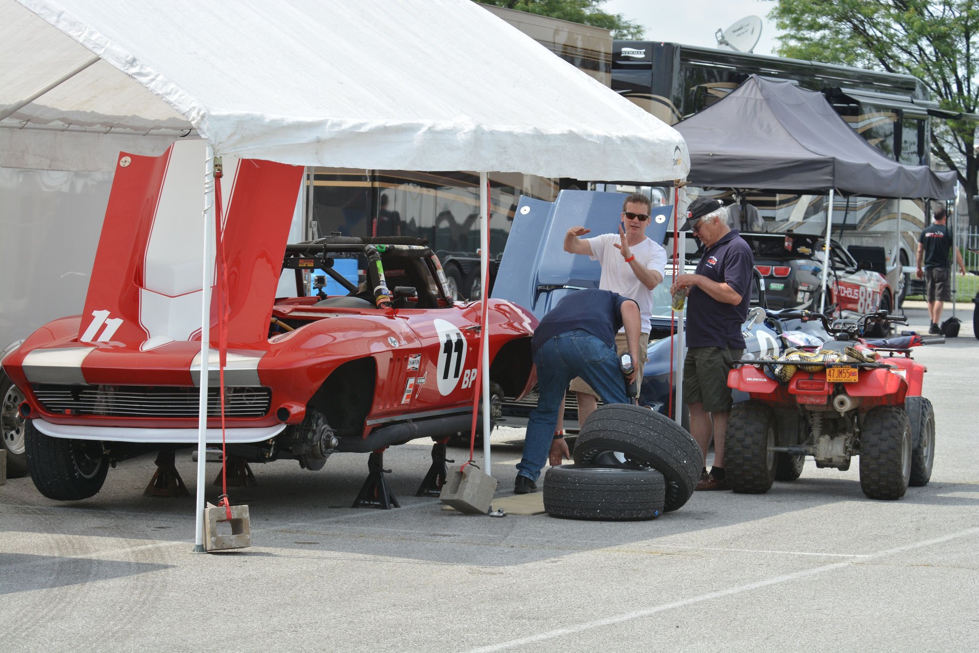

I don't like jack stands, but at the race track, we have to use them. We put the car up on stands, between every session. If we're just checking brakes or switching tires, we'll only use the jack stands, but if we're going under the car, we'll leave the 3 ton floor jacks, under the car too.
We place the stands just aft of the number one body mount, and below the number 3 mount. We actually have four 6" long, 1" deep tabs, welded on the frame. Our stands have a dip in the center of the pads, that the frame tabs fit securely in.
