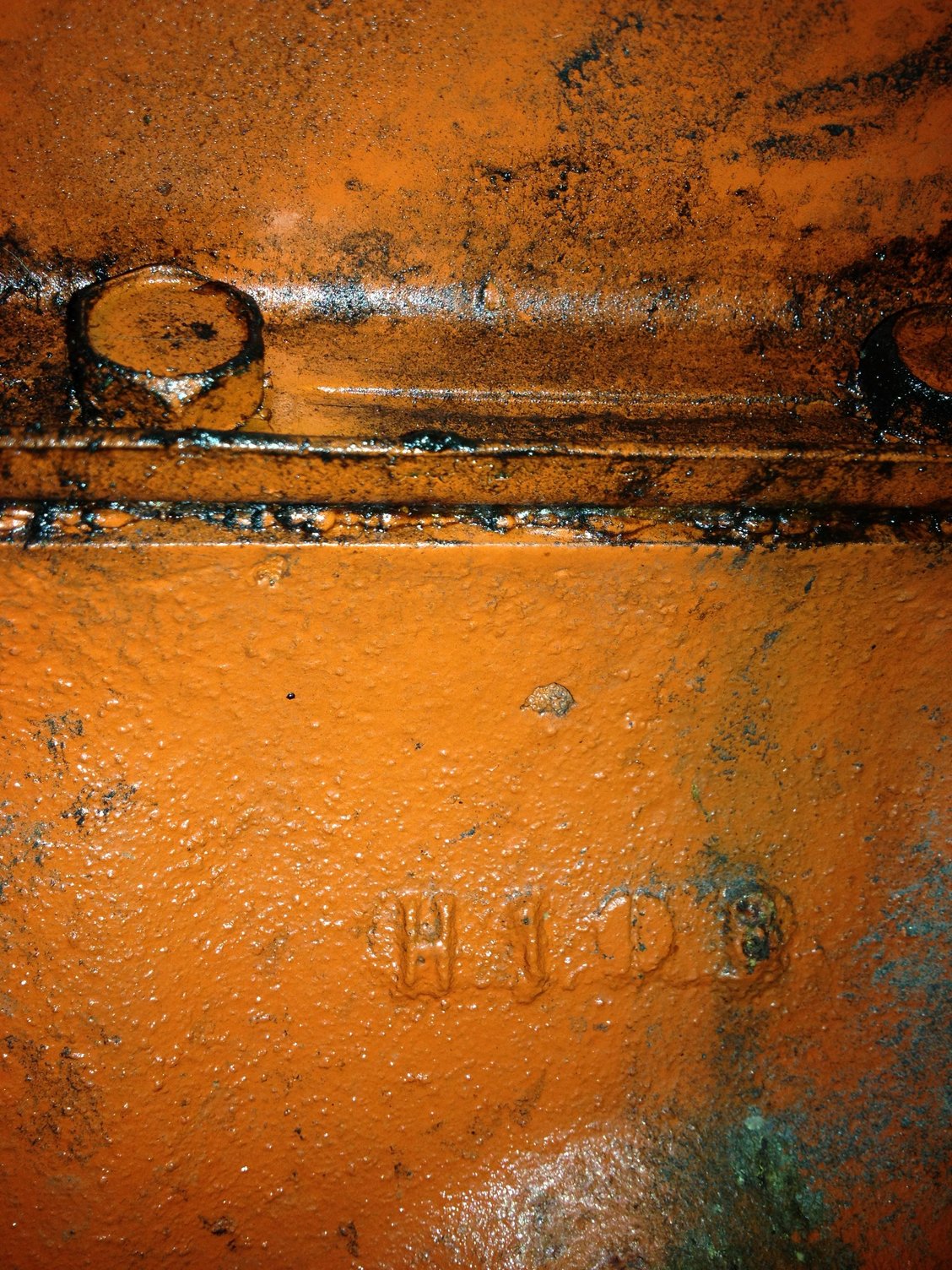

Default 69 block cast date
What do you guys think about this?, what does it mean, is it genuine?.

Your picture is upside down, but date code looks like G 5 8 to me. That would put it cast on July 5th, 1968. That should be correct for an early 69 production car. What is the build date of the car?

The G is a bit hard to read but it couldn't be much else. My 69 BB cast date is the same style with the weird raised cast where the second number for the day if it was double digit would go. My guess is the same. July 5th, 68.

I am trying to understand block casting numbers and casting dates. I've got a couple of pictures of some casting dates.
According to this website below, the 1969 big blocks had an early, mid and late casting number. In what months of production would you expect to see an early, mid or late block in a 1969 Corvette?.
http://corvettec3.ca/casting.htm

No idea about dates when casting designation/placement changes were made. My 69 casting date is not on the side above the oil pan. It's on the back of the block just above the bell housing and below the distributor. Oct 8, 1969 cast date on a 3963512 block. Engine was built Oct 20th in an Oct 24th build car.

Alan Colvin's book Chevrolet by the Numbers is an excellent reference for casting number and dates. He gives approximate dates when the blocks were being cast.
He has the 3935439 block first being used after Jan. 1968. It was used for late 1968s and for very early 1969s.
The mid year 3955270 block only had a very short casting run of Aug. to Oct. 1968.
The 3963512 block began being cast in Oct. 1968 and was used for the rest of the model year. At first the casting date was on the side of the block but was moved to the bell housing flange in late 1969. Colvin has the casting date move as Nov. 1969, but since Grant reports his Oct. car with it in the new location, it must have occurred a little earlier then he states.

Hi CC,
When looking at casting numbers and dates on parts that have been painted it's important to not use ANYTHING abrasive, sharp, or hard in an attempt to expose them.
It's wise to use some kind of liquid or gel to remove the paint. That will also help remove the paint in the crevices that make it difficult to differentiate 3s, 6s, 8s and 9s, and also letters like Cs and Gs.
So be careful not to remove any material other than paint at this point.
John
Colvin is wrong. The move to the bell housing flange occurred at least as early as March 12, 1969.
Dennis

Originally Posted by Faster Rat
John
Dennis
Dennis
Yeah, he was way off. Looking at a second source, the NCRS judging guide, it says date was moved to flange at approximately SN 20,000. Your car seems to confirm they are correct.
John
