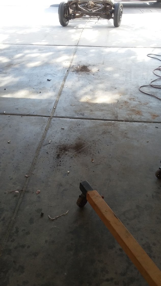

Frame rolled out from under body, and parked
Amazingly little debris on garage floor. At this point the body is on the dolly, and has been rolled around to the RV parking I have behind a gate

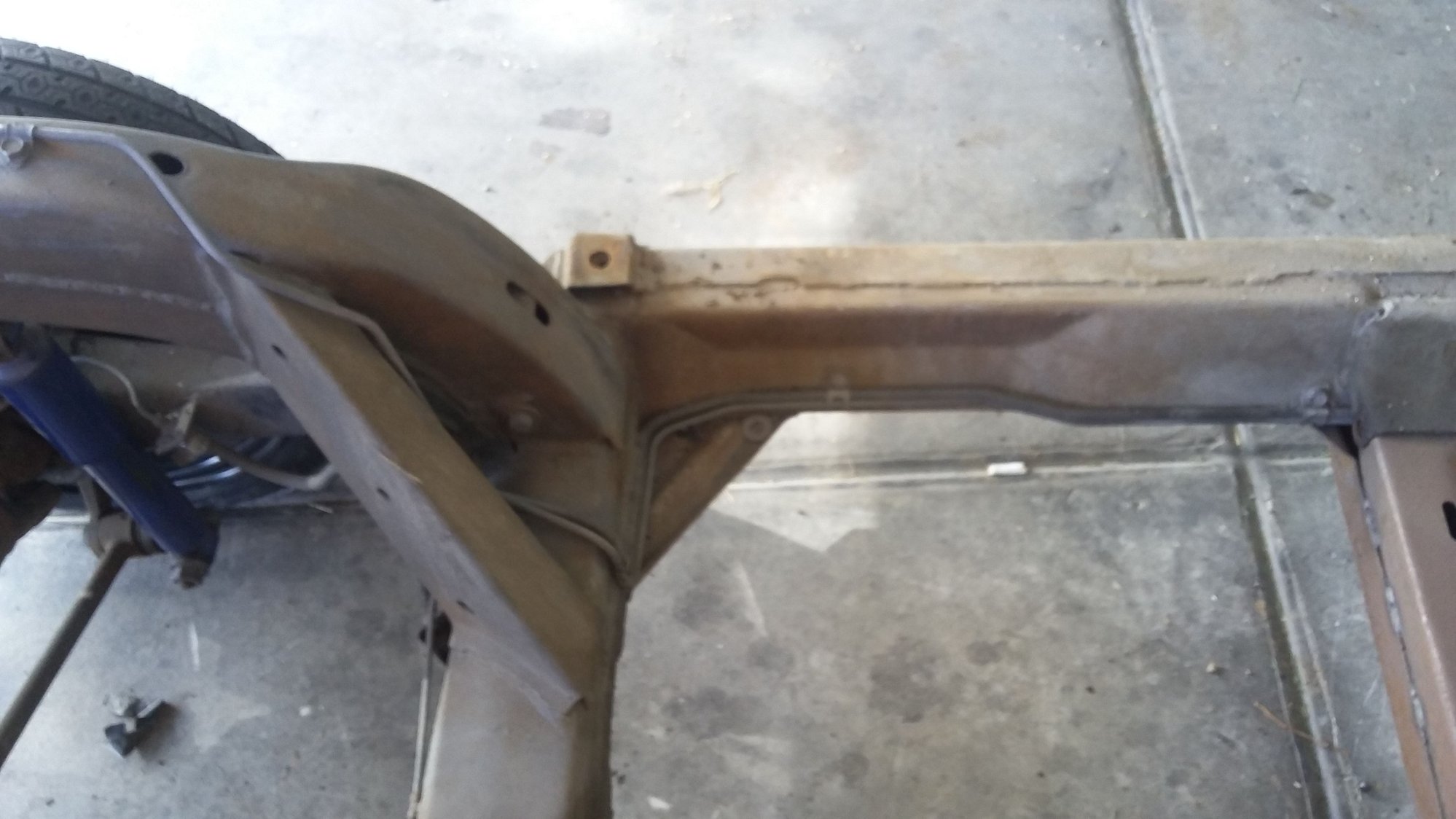

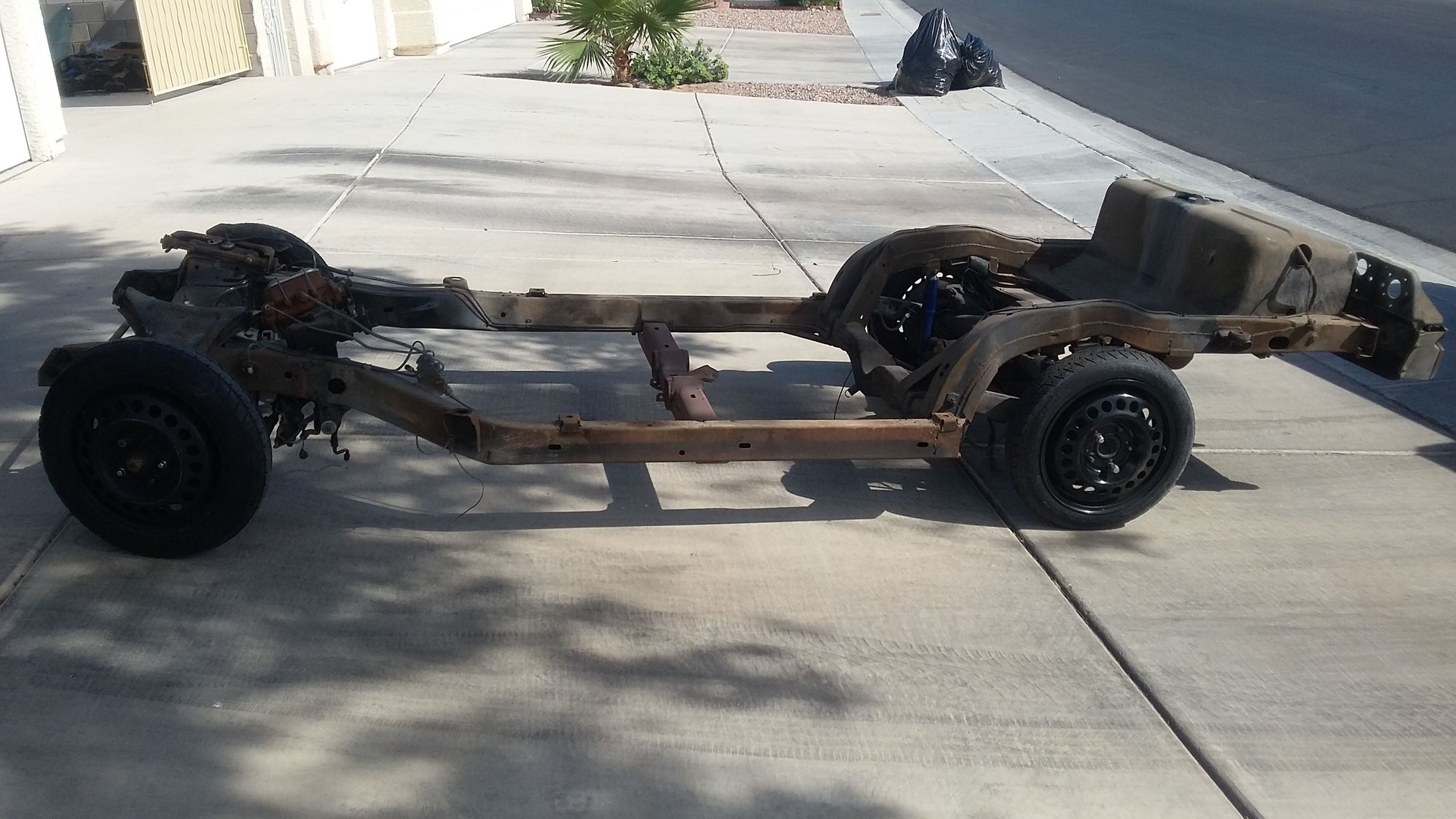

Just some frame pics
I am really curious about this. This is a pic of the cross member with the holes for the exhaust to go thru. both sides have what appear to be missing bolts. I've looked at a lot of other's pics, but can't find a good one. Is there supposed to be a bolt here?
Old Mar 26, 2017 | 08:55 PM
  #40
bazza77's Avatar
bazza77
Joined: Jul 2010
Posts: 3,176
Likes: 633
From: perth western australia
yes a long bolt goes right through , you just have to be careful ,obviously it will go in any side now but when the body is back on it can only come out one way . You have to choose wisely. Same as top shock mount bolt at back and trailing arm to frame bolt .
