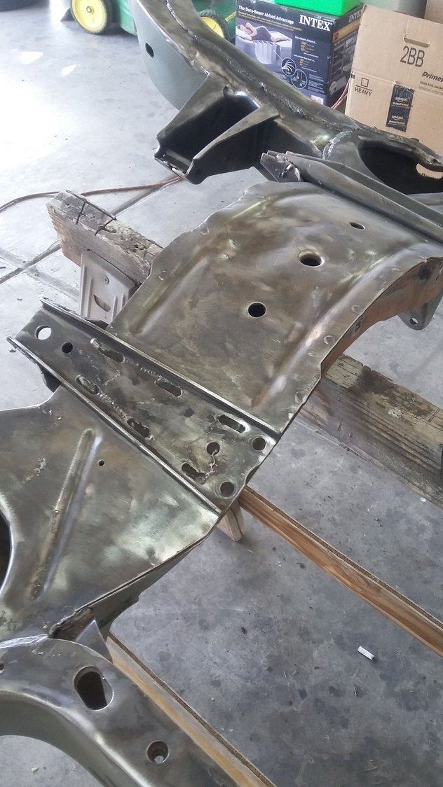

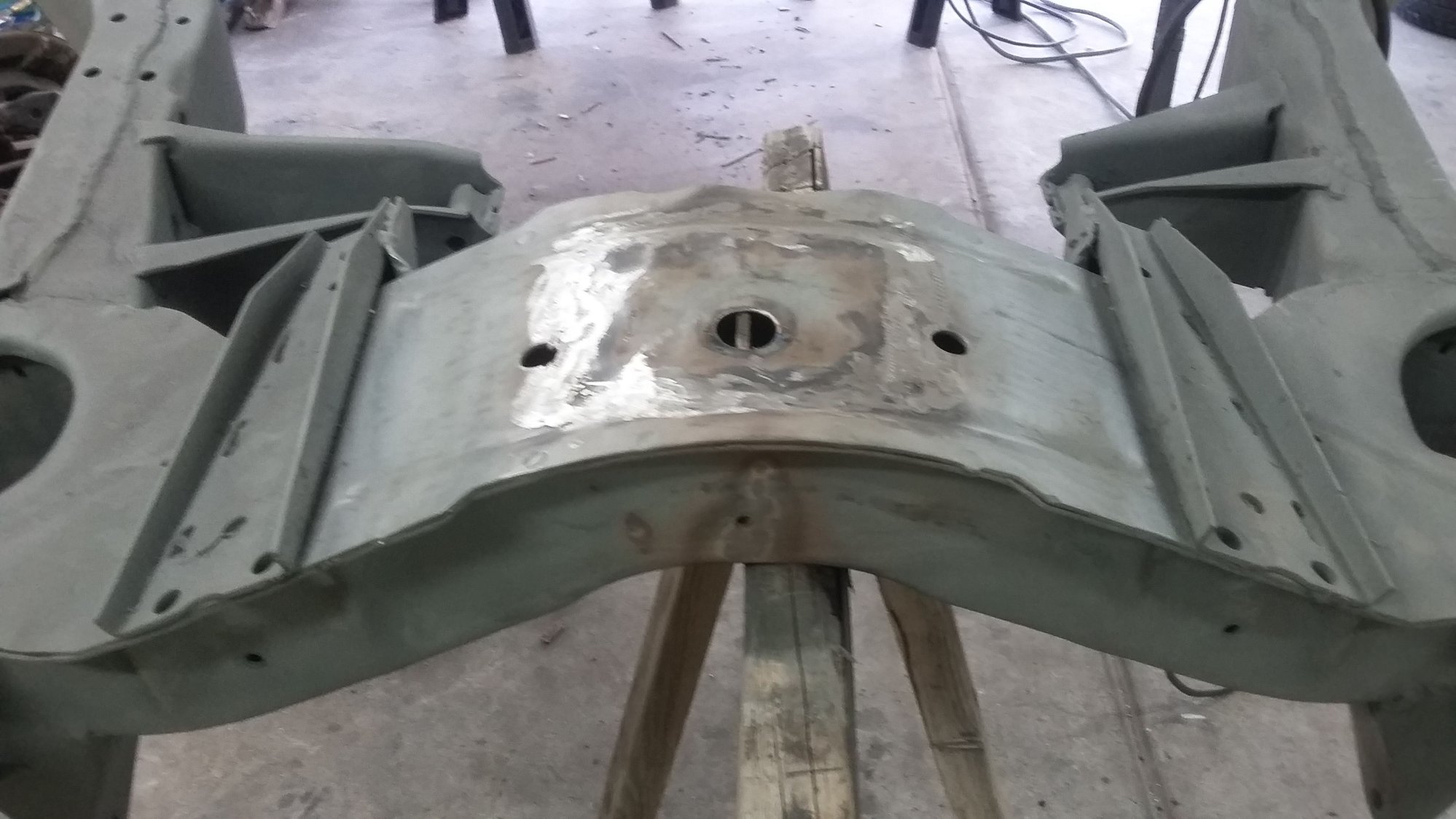

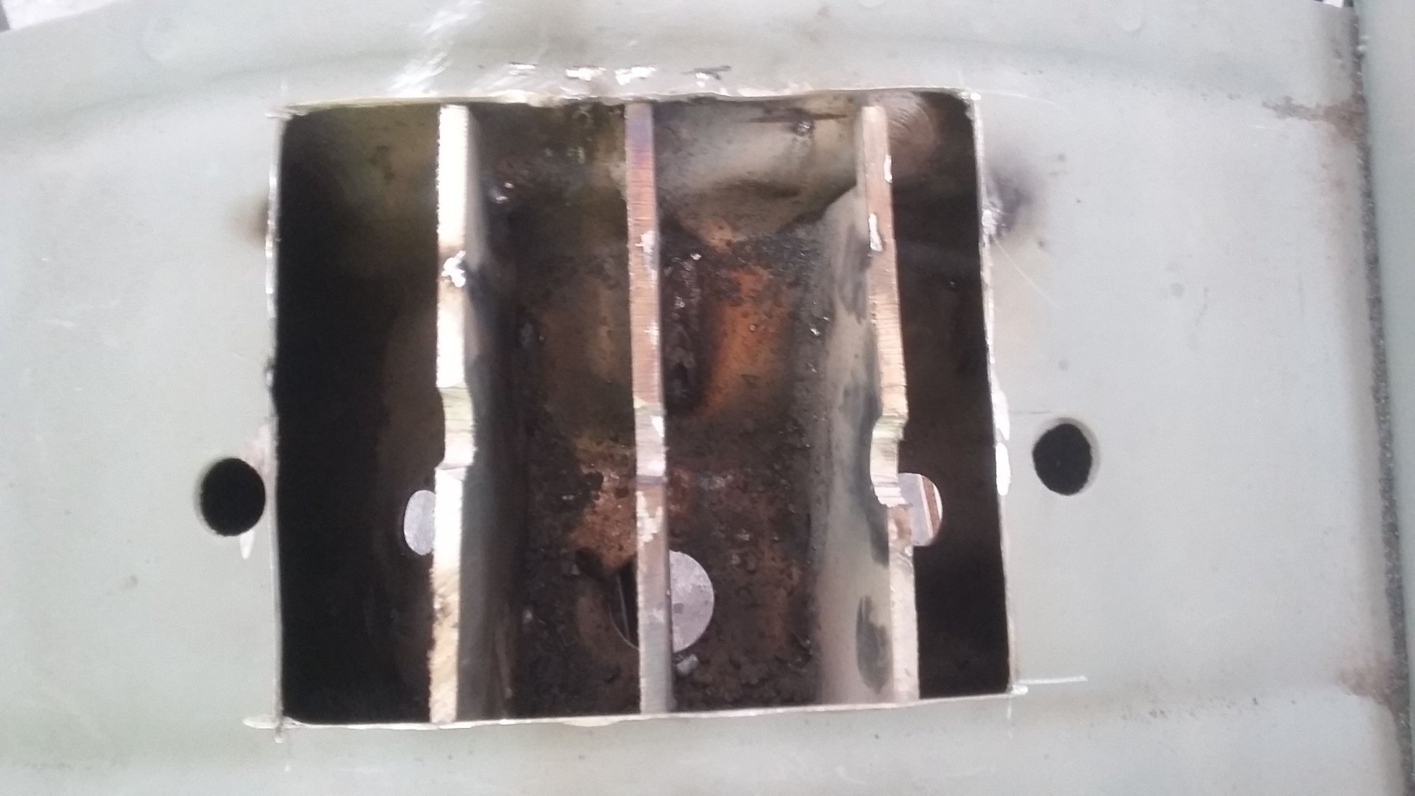

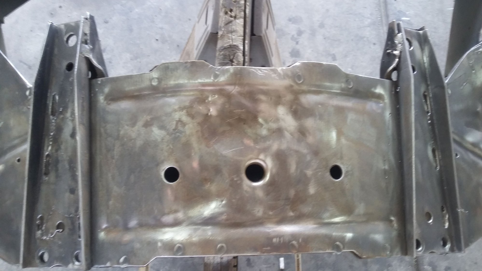

The frame box weld out is complete, now time to fix the front frame where it always gets jacked up
I finished the primer coat for the whole frame before I started. Here is the damaged section cut out.

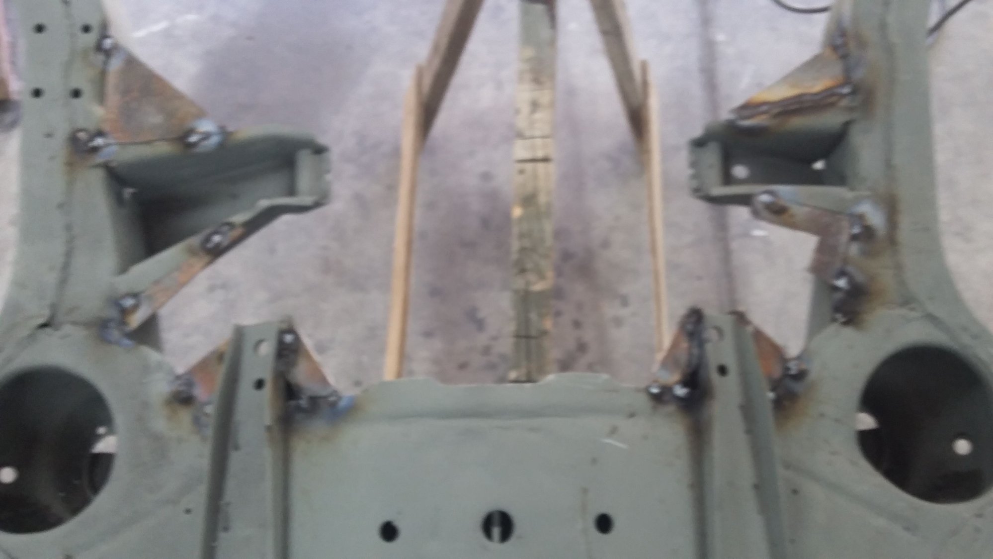

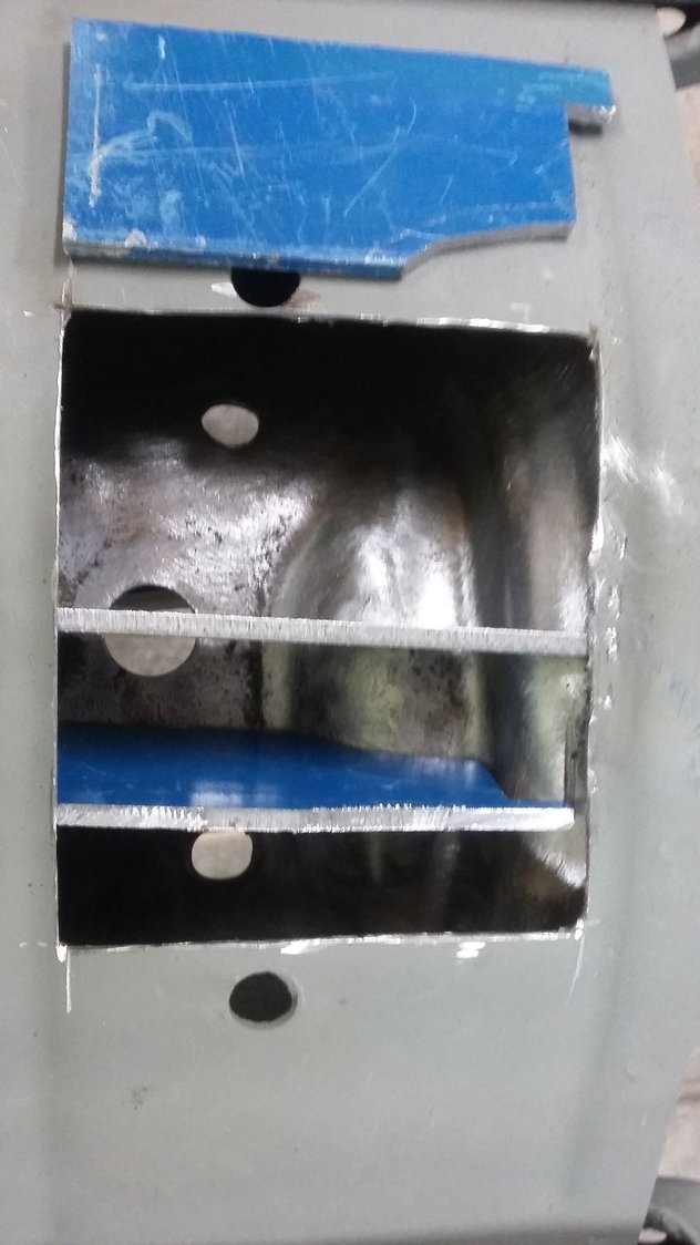

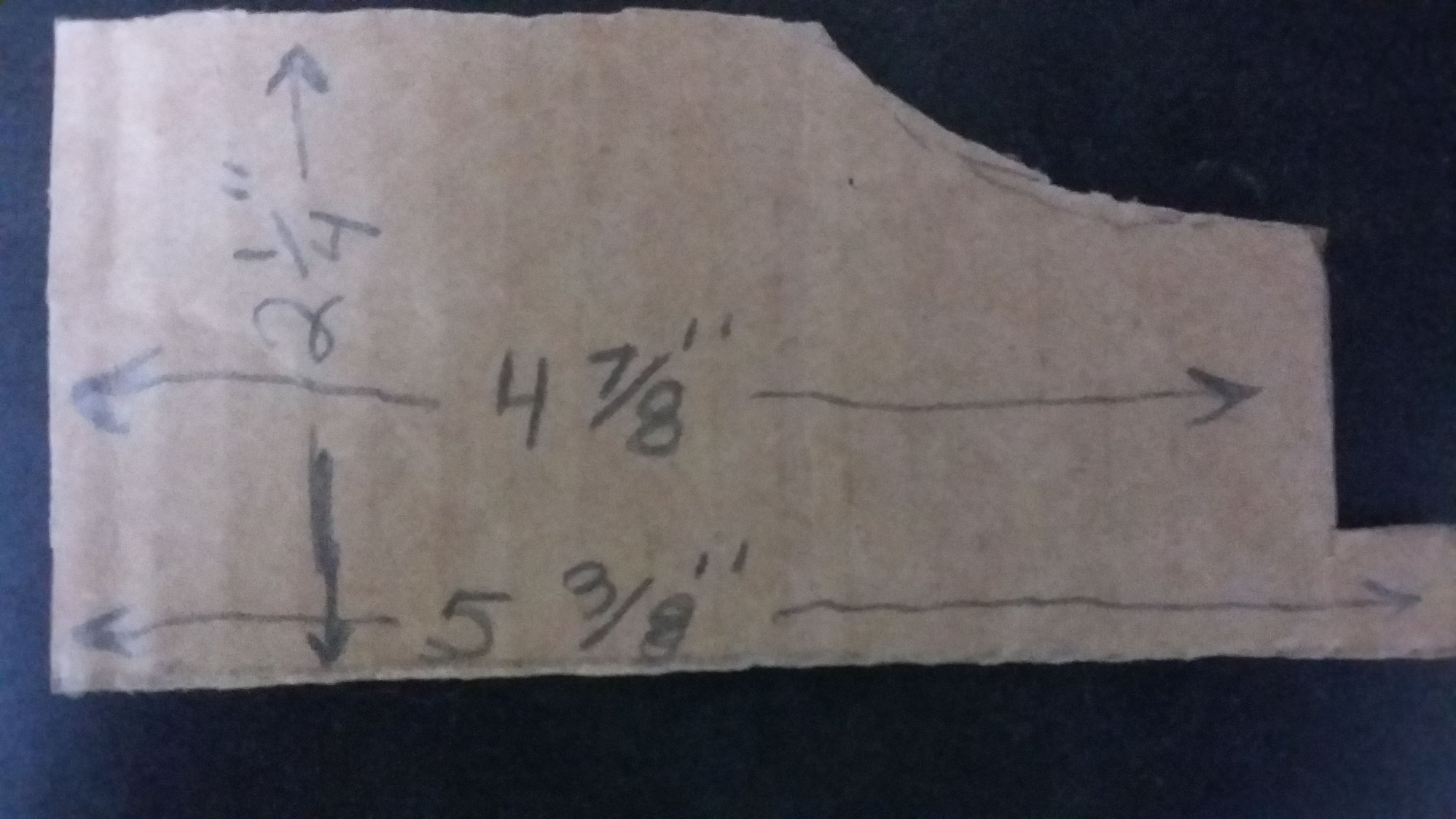

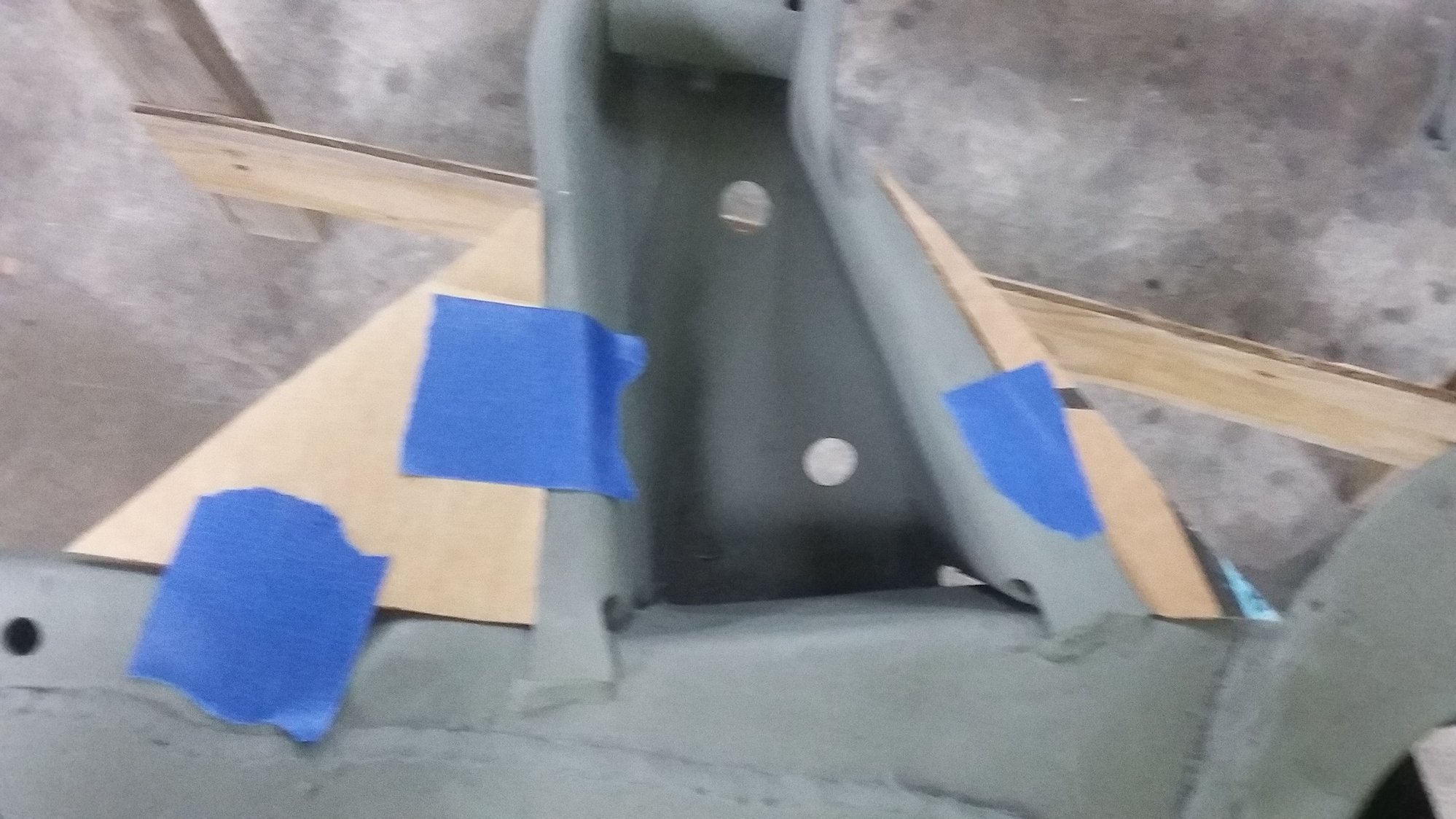

I cut a rough cardboard template to fit the inside frame for gussets.
I then traced the template onto some 5/32" plate I had. Grind to fit
After welding them in place, I ground a 1/2' drainage channel into each on the bottom side of the frame.

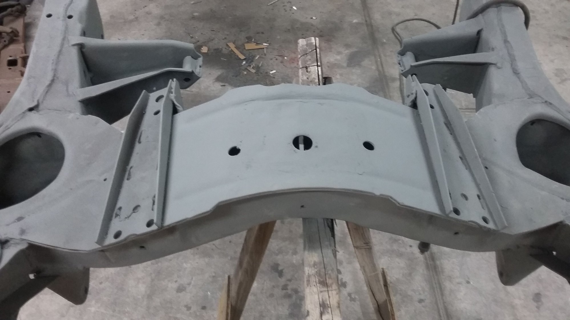

Finished gussets.

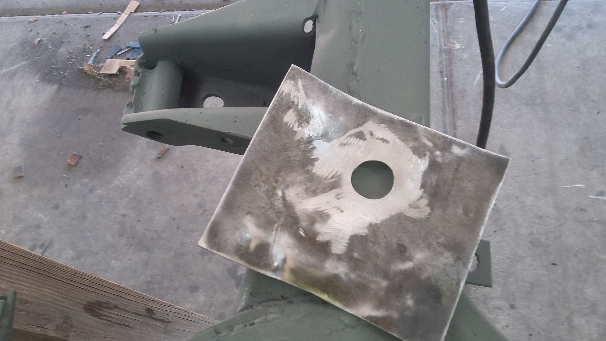

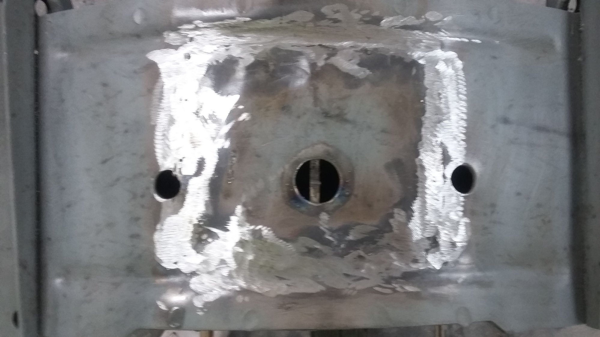

The original piece I cut out had a factory drain hole that was punched. This left about 1/4" of material raised inside the frame. This seemed to me to just be a place for water to accumulate, waiting to evaporate. I ground down the raised portion to help drainage.
Ready to be welded back

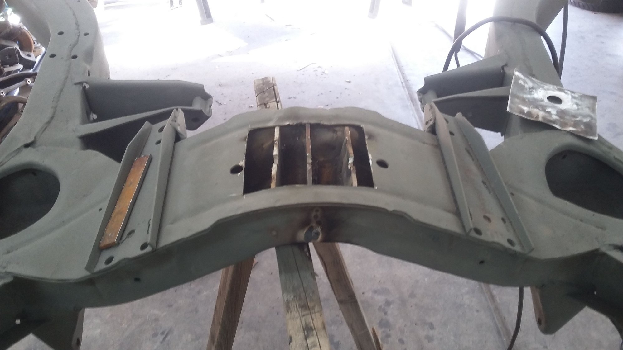

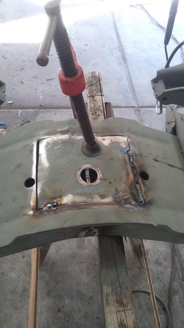

Using c clamps, and hot tacking, I slowly worked the original piece back. ( hot tacking is when you tack weld, then while its still hot, hit it with a hammer to mold it. Sometimes take multiple attempts.)
Welded out, and done
A bit of advice here: This is very thin material, and you need to be careful when welding. If, like most, your using a wire feed, or MIG, make incrementally closer tacks, till there all about 1/2" apart before trying a full seam weld. If, like me, using stick rod, be very careful. It's so thin, you'll blow a hole just firing up a rod. I broke the flux off a 5p rod, and used it as a filler rod to gain more metal to work with.

Finished repair in primer

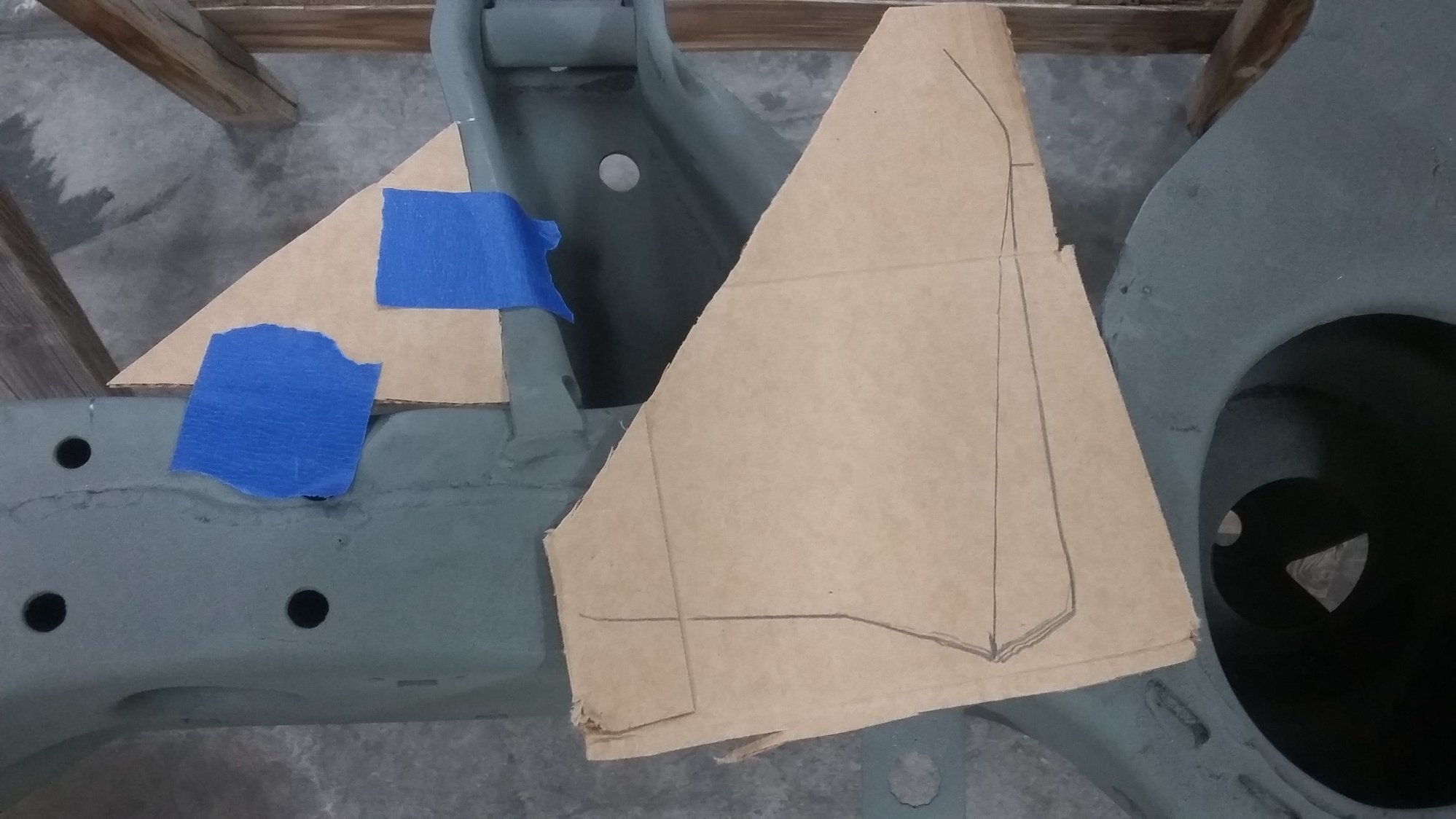

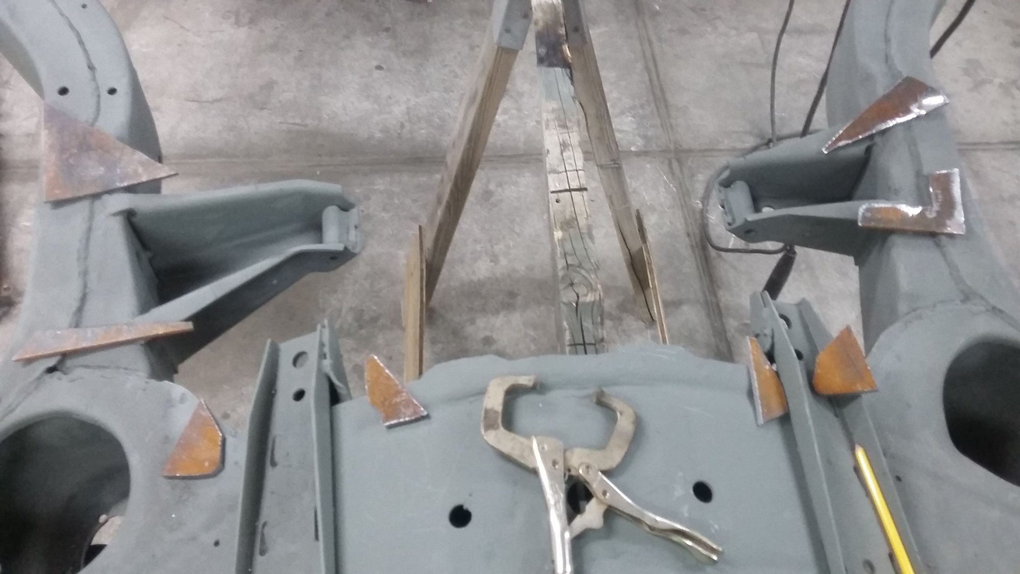

Next up was gussets. Again, I made a rough cardboard template, and then grinded to fit.
Here are the rough gussets cut and ready

All tacked up
Welded out, and in primer. WOO HOOOO

A little shiny black paint, Just need some new parts to go on it now.

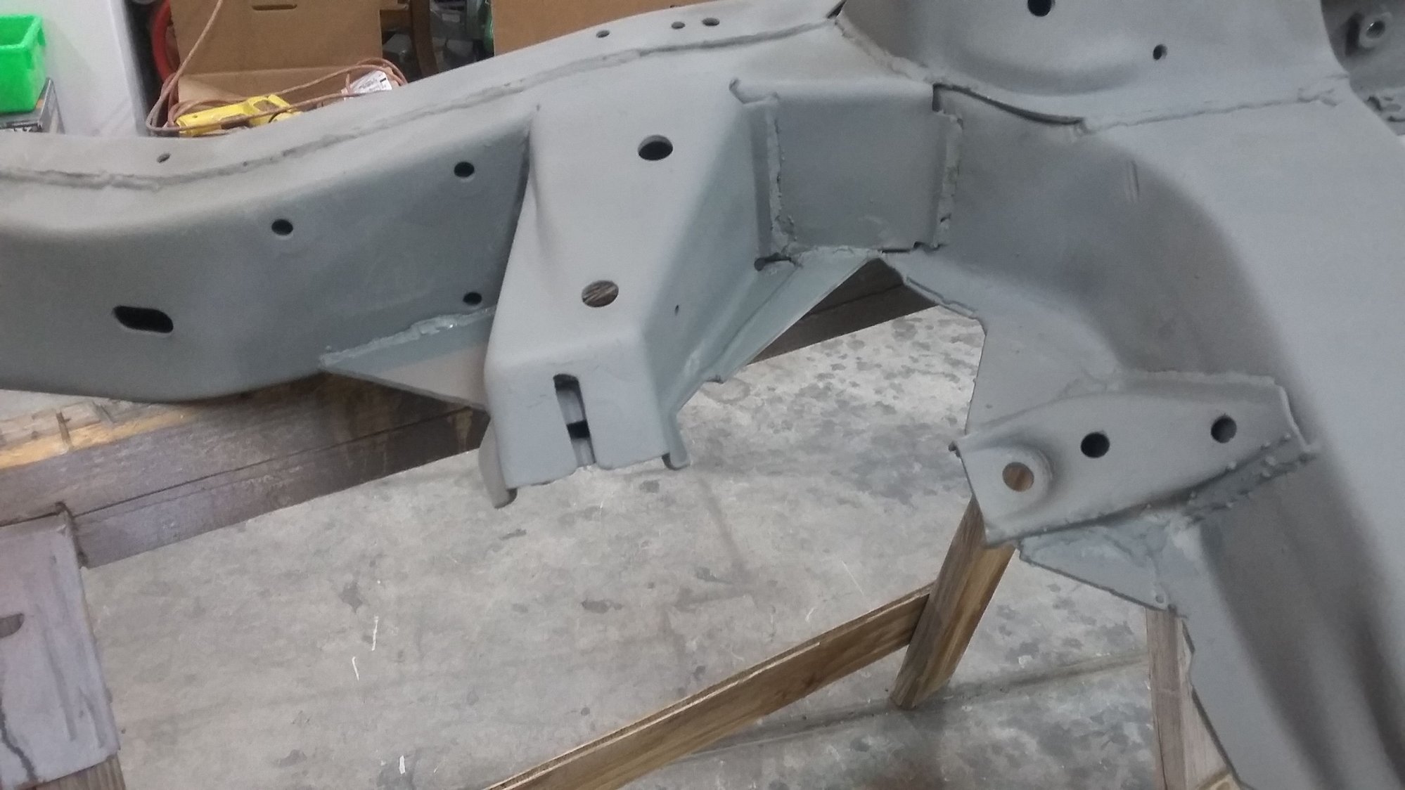

Old May 6, 2017 | 10:15 PM

Old May 7, 2017 | 09:04 PM
  #72
M A Fry's Avatar
M A Fry
Joined: Aug 2009
Posts: 1,037
Likes: 103
From: Brisbane Queensland
Hi badapplegolf,
Wish I had read this post earlier I would have advised you not to have sharp corners in your
gussets as you have in the front gusset for your right engine mount. Sharp corners like that
become areas of concentrated stress and are the first points where cracks appear, much
better to have radius which will help dissipate the stresses, the larger the better.
Mark

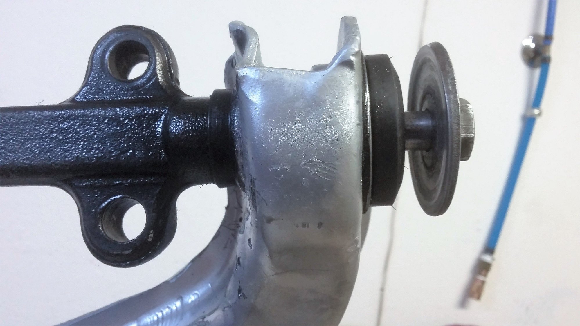

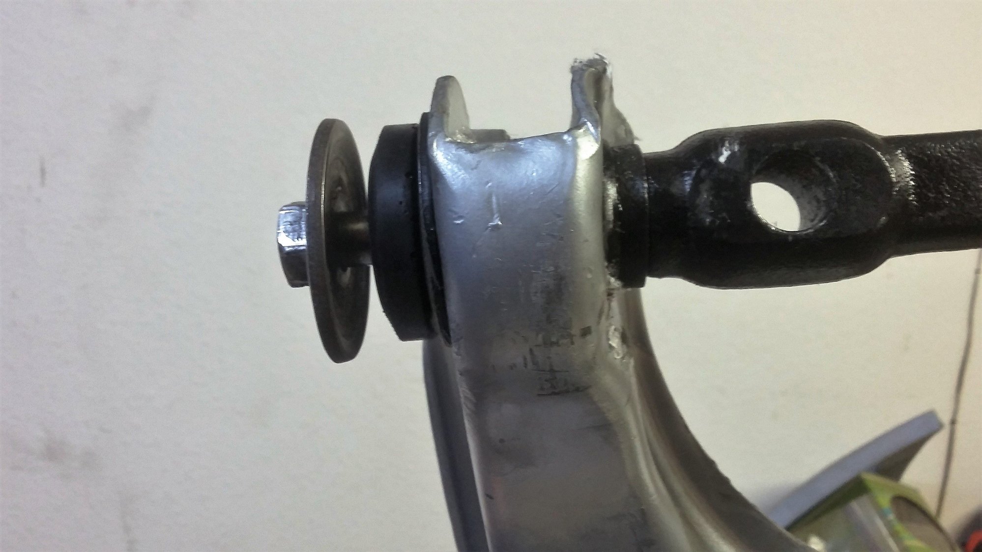

So I need help please. I finally got some parts in, and have the whole weekend to the car. First up was to put new poly bushings in the lower a arms. Problem was the the bolts that came out, don't want to go back in. they are 7/16" x 1 3/4". Am I missing something???
Both bolts are torqued to about 50 lbs at this point.

From: Las Vegas
I have extra 7/16 x 7/8 bolts from the upper arms that will fit, but I'm totally confused about why these don't fit anymore. I've spent all day on this, and everything I read says these bolts are supposed to be 1 3/4" long.
Any help is greatly appreciated.
