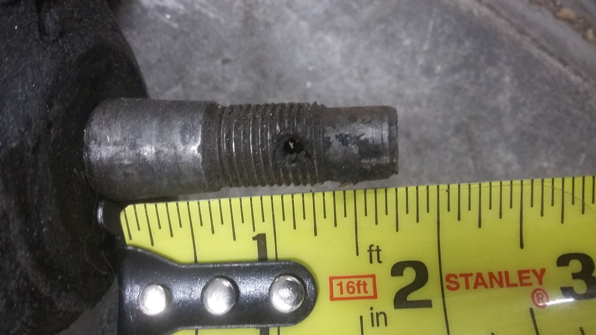

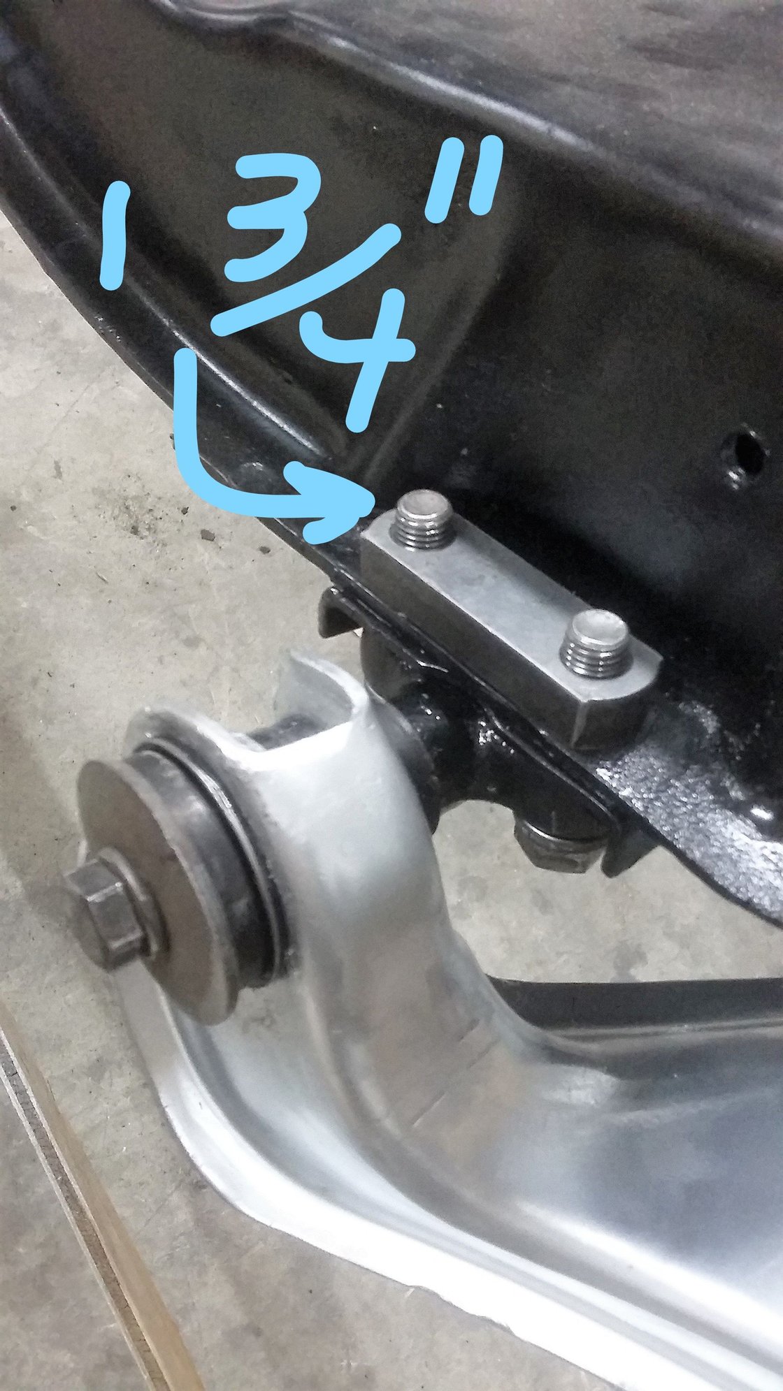

I have extra 7/16 x 7/8 bolts from the upper arms that will fit, but I'm totally confused about why these don't fit anymore. I've spent all day on this, and everything I read says these bolts are supposed to be 1 3/4" long.
Any help is greatly appreciated.
If the 1-3/4" long bolts are the ones that came out, they should definitely go back in. My suggestion would be to remove the bolts and measure the depth of the holes to confirm that some foreign material hasn't gotten in there. A thread chase bolt or tap may clear out any obstructions.

The cross shafts are straight, and true. Both of them accept the bolts exactly the same depth on all four ends. A small rod inserted into the ends show the depth to be the same as the bolts, It just feels like the threads stop. I could understand foreign material in one, or two, but all four? and exactly the same? I had both sets bagged separately to begin with, but they got mixed up yesterday as I was trying to figure this out.
After drinking on it, it occurred to me to just completely reassemble both sets, minus the bushing bolts, and just see what bolts are left over. After a little more coffee I'll get to it, and let you know the results. Funny thing is, there are only 8 shoulder bolts total, and 4 of those are the wrong thread size, only leaving the four 1 3/4" as a possible mate. Pretty sure these bolts should be shoulder bolts. Every pic I see shows them to be.

So I've learned quite a few things this morning. First off, you can't trust everything you see on the innerweb. Who knew I wonder???
Next discovery was to learn that the triangle shape plastic tumbler media that is supposed to be good for cleaning nuts and bolts, without damaging the threads, leaves an incredibly hard to remove plastic film inside the threads on both nut and bolt.
I didn't take nearly enough pics.
I also just learned how to use the marker thing on photos. I could have labeled the bolts right on the pics so this would not have even been an issue. Live and learn I guess.
So anyway, the bushing bolts are deffinatly the 7/8" long bolts. The 1 3/4" bolts are the only ones that will bolt the cross shaft to the frame. Simple enough. Still not sure why they are not shoulder bolts, to try and keep the flow correct, I'll post the pics and stuff of the bushing removel, etc. before posting pics of the completed control arms.

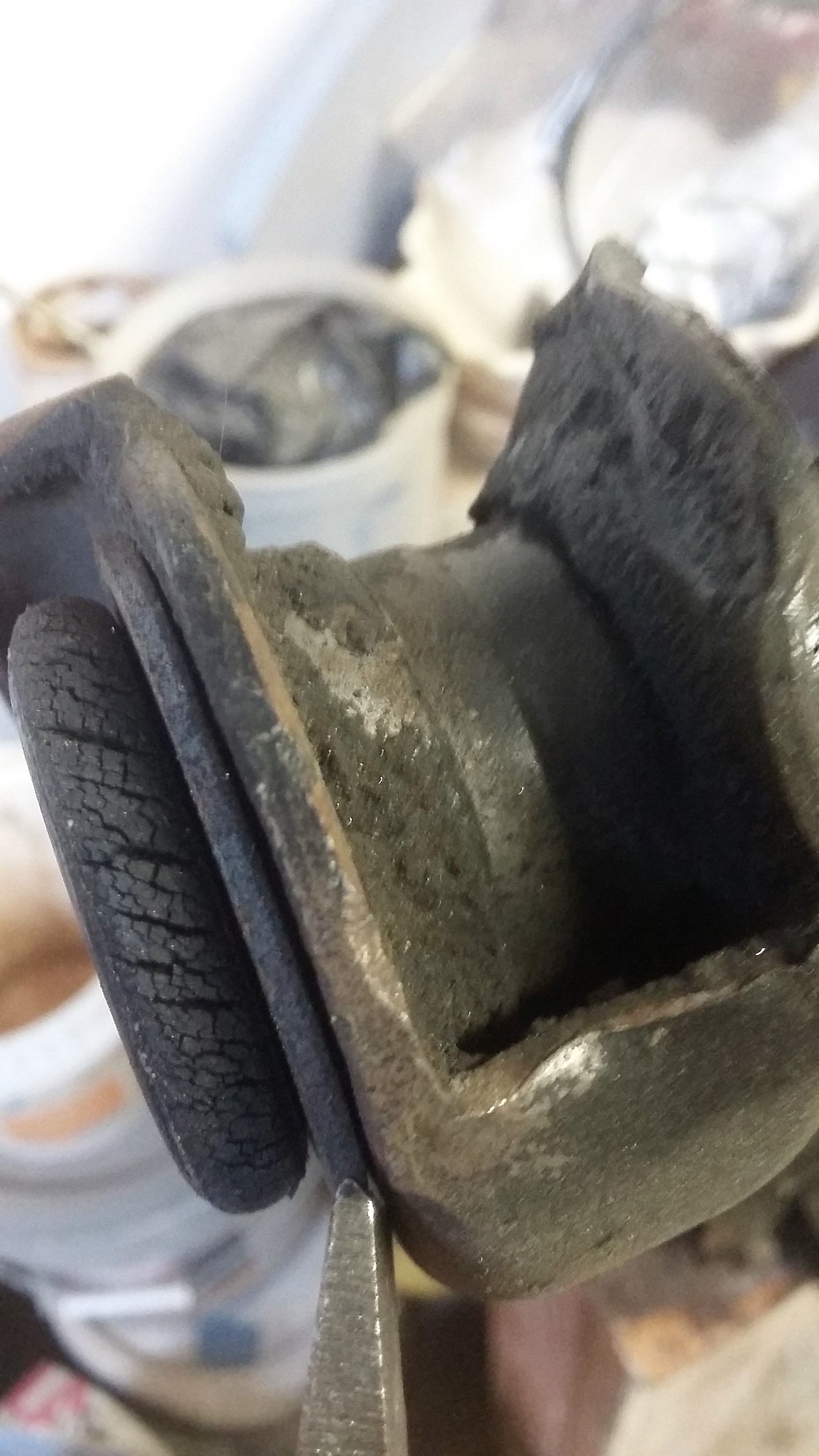

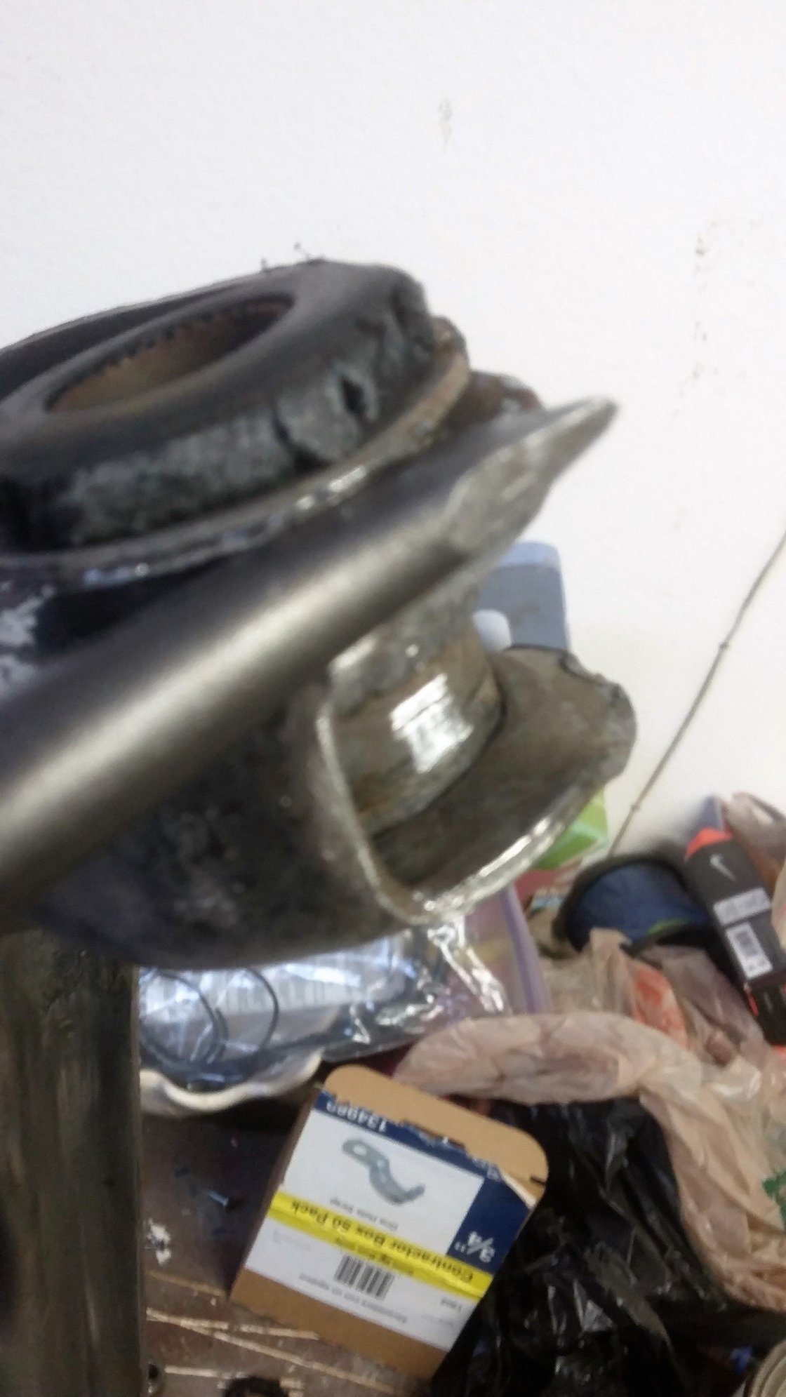

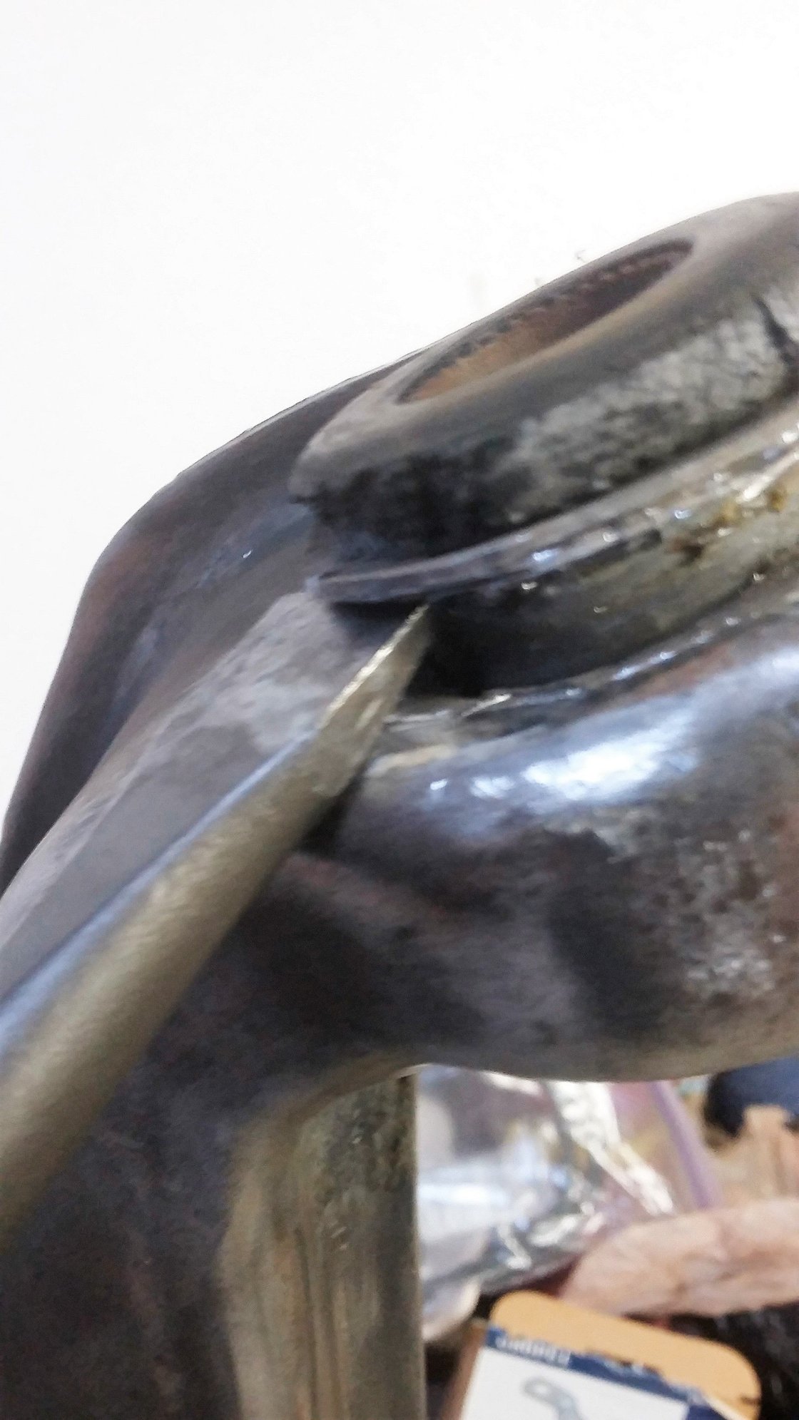

After reading countless tips on removing bushings, and watching a ton of utube vids. I decided to try the air chisel method. I started with a sharp chisel, and just slowly worked my way around the bushing flange.
As the bushing came out, I used the shank of the chisel to get the most out of it..
My first plan was to use shims between the control arm and the bushing flange once I had maxed out the thichness of the chisel, But it wasn't needed. At this point, just a little upward pressure, and they popped out.

Posts: 219
Likes: 16
From: Las Vegas
The most popular utube vid shows a quy dimpling, and smashing in the inner part of the bushings before trying to remove them, I didn't need to do this at all. The first one took me about 2 minutes to remove, the other three took about 30 seconds each. I bought the air chisel from Harbor Freight for less than $10.00 Even if the tool never works again, It was money well spent.

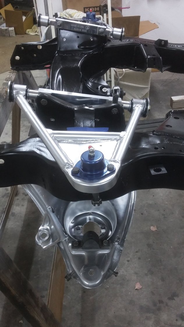

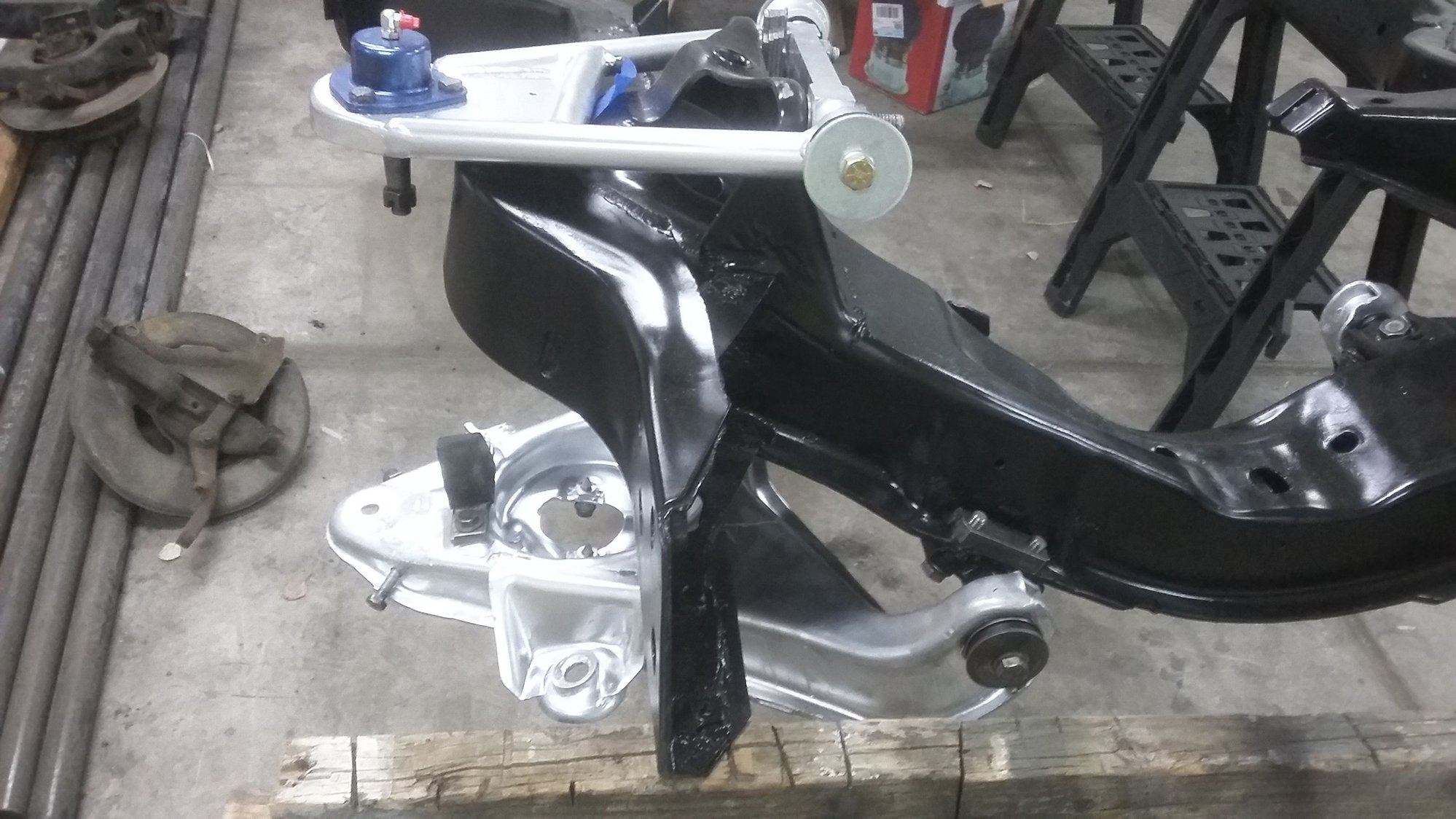

My new offset tubular uppers came with bushings installed, so I just reinstalled using the old shims.
Finally have both uppers and lowers installed

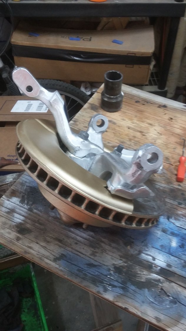

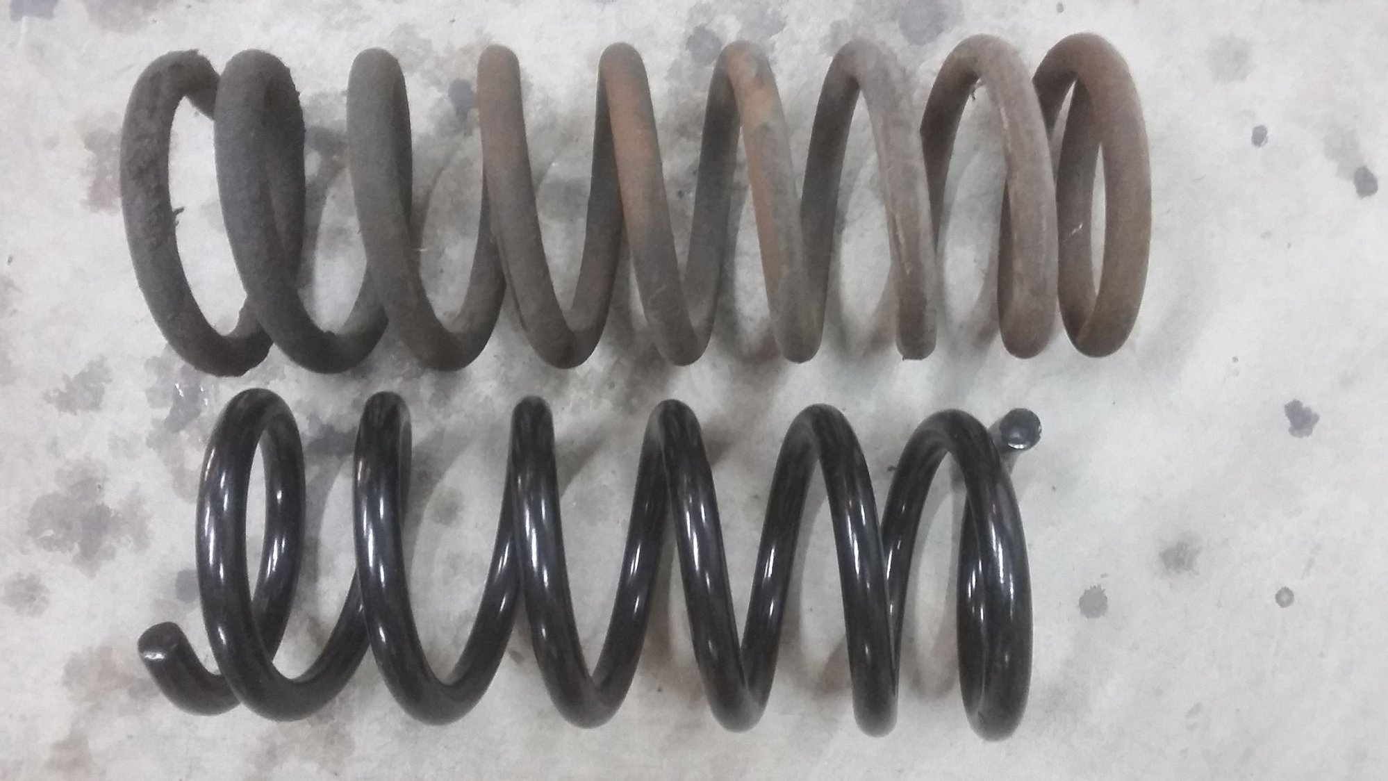

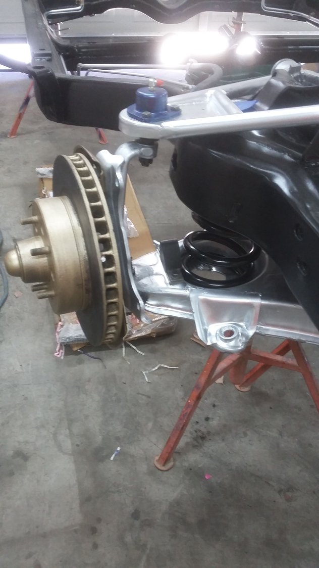

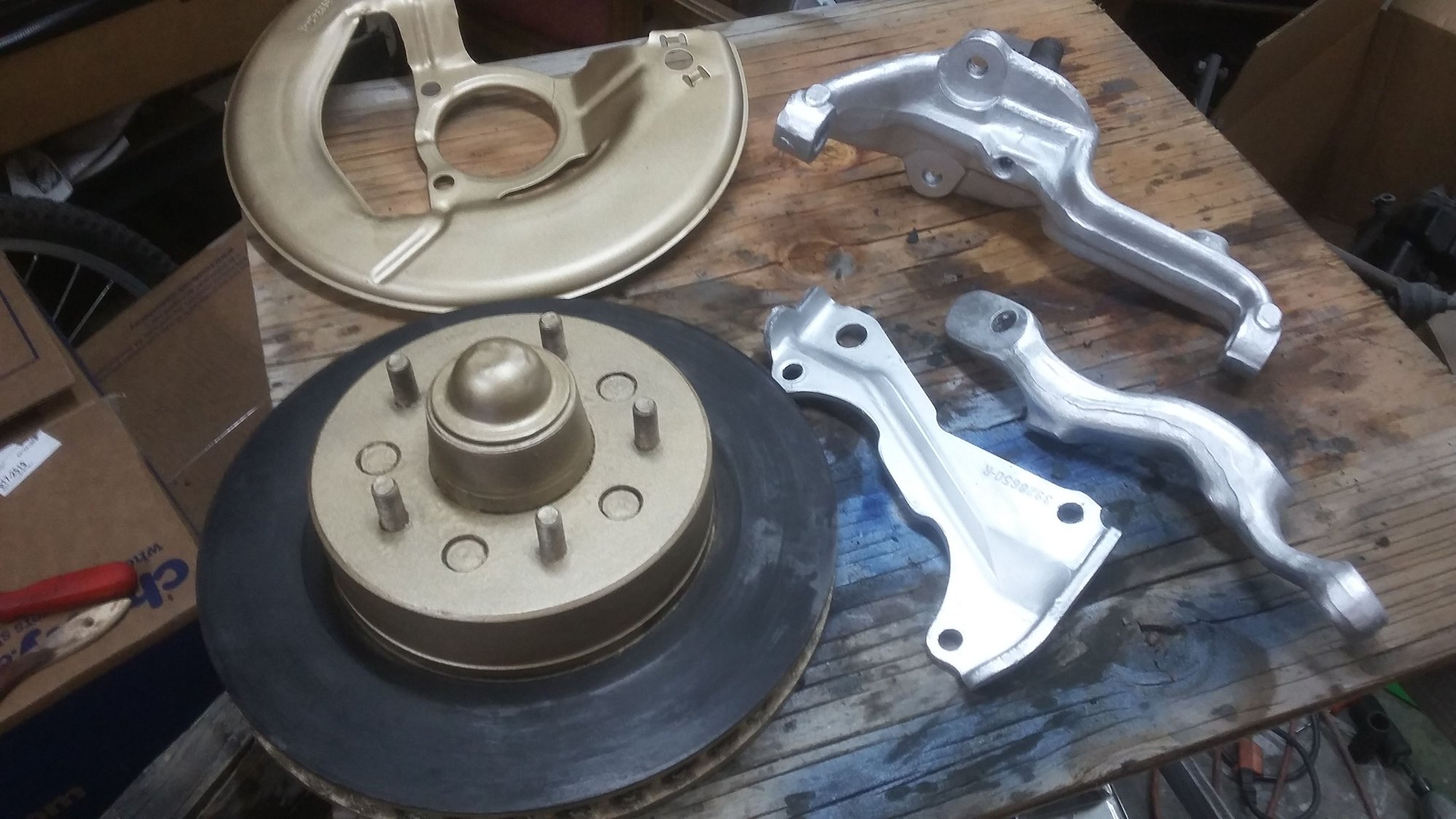

I decided to go with the 474 lb. springs in the front. I never could find a definitive answer on the differences between the heavy, and light load springs, vs bb, and sb motors. So I just went with my own thoughts, bigger is better. To get ready to install the new springs, I cleaned up the spindles.
I got a little paint in the ball joint sleeves on the spindles.

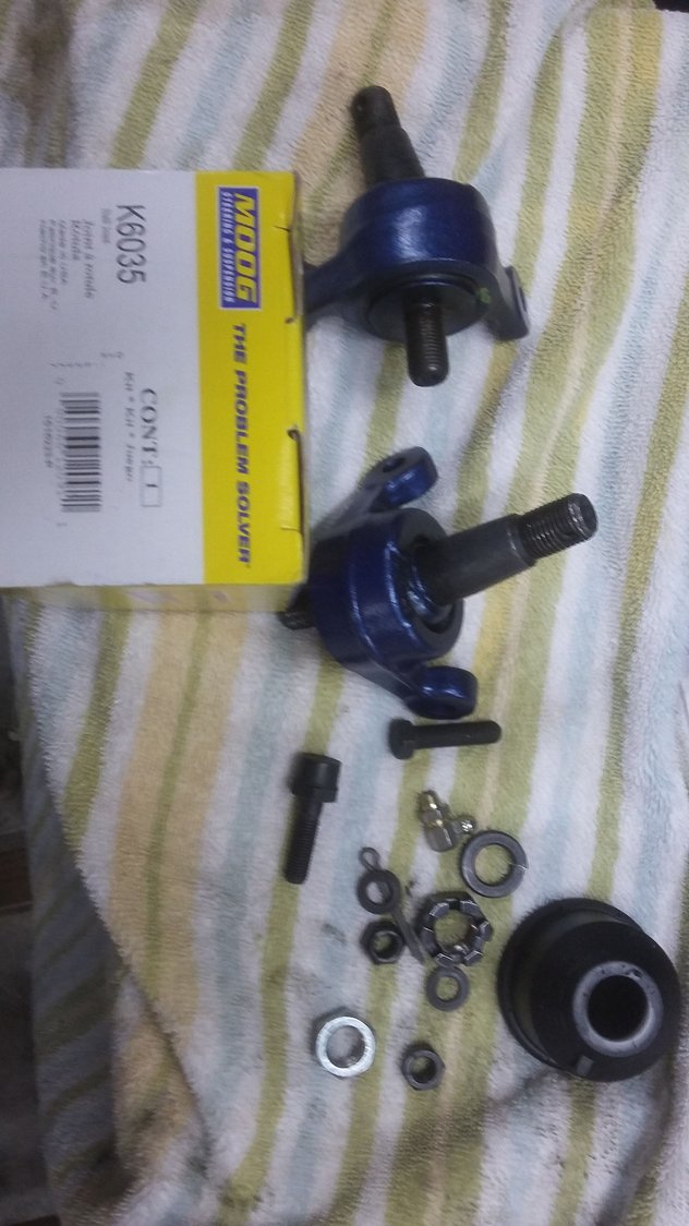

So used a 1/2" copper fitting brush to clean them out before install.
New Moog ball joints
Old vs new springs

Completed assembly of the Passenger side.

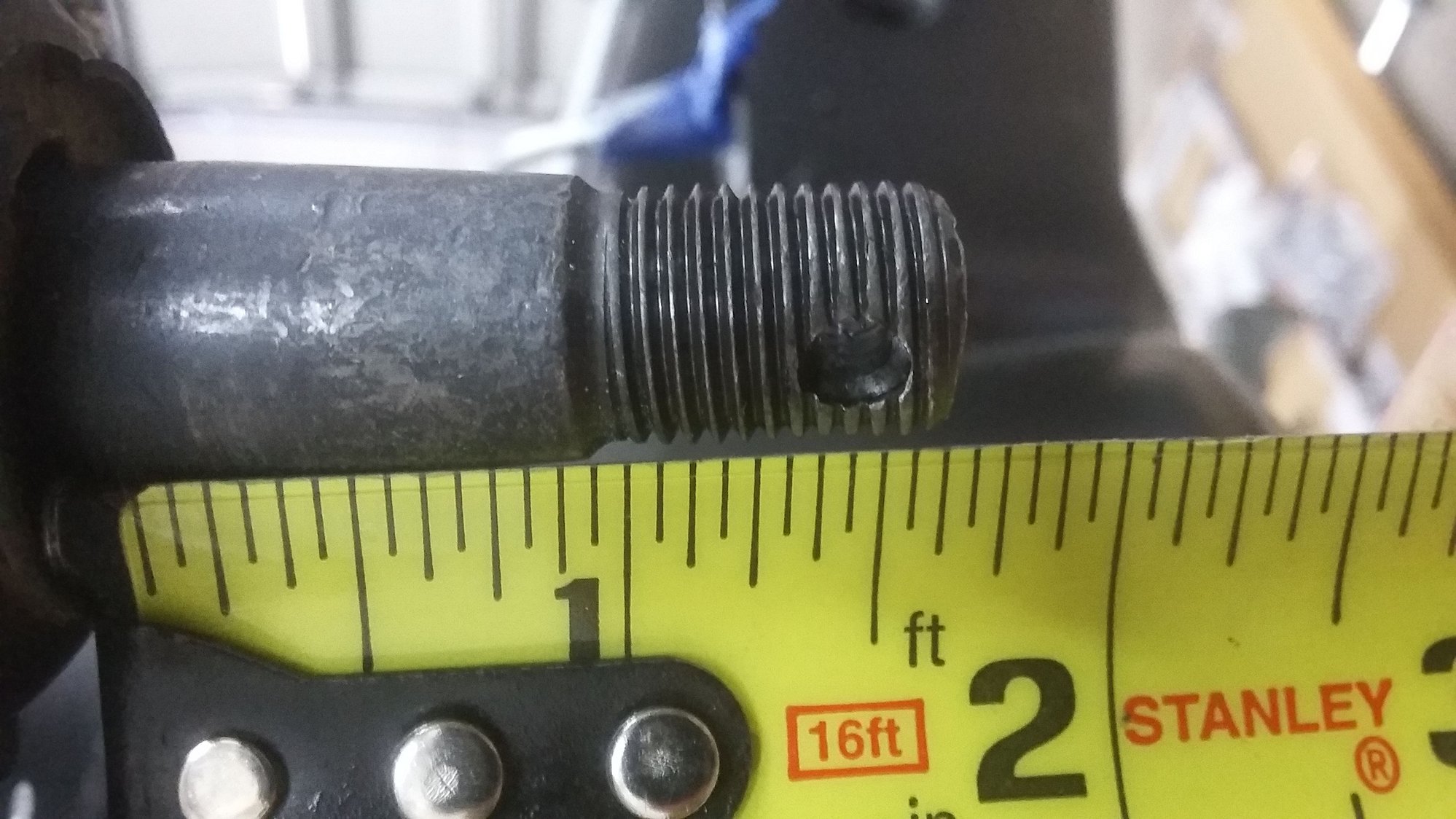

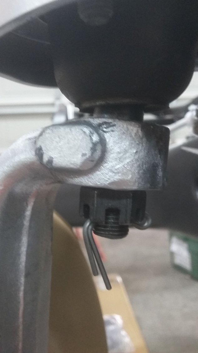

This pic is of the upper ball joint after install. I'm worried that maybe this is not the correct ball joint. The nut is completely run up and no threads are left, but the spindle arm isn't even touching the boot yet.
These are new offset tubular uppers from VB&P, which came with the ball joints installed.
Anyone had any experience with these? Does the offset a arm make a difference? I'm thinking I'll just buy a new upper ball joint for a stock 77 and compare the two, but I don't wanna screw it up if the new a arms are meant to have slack there, plus there's no weight on them yet, I don't know, it just don't seem right. Once the front end is loaded with a motor, seems like there will be about a half inch of play between the upper spindle, and the ball joint nut.
Any help is appreciated.

The shafts are clearly differant.
pic of old original
new ball joint

It looks like you need to add some shims/washers under the nut to take up the space so you can draw it tight.

Or is it tight already and you just don't like the way it looks?
