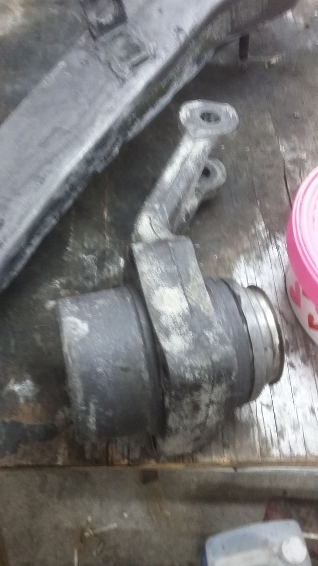

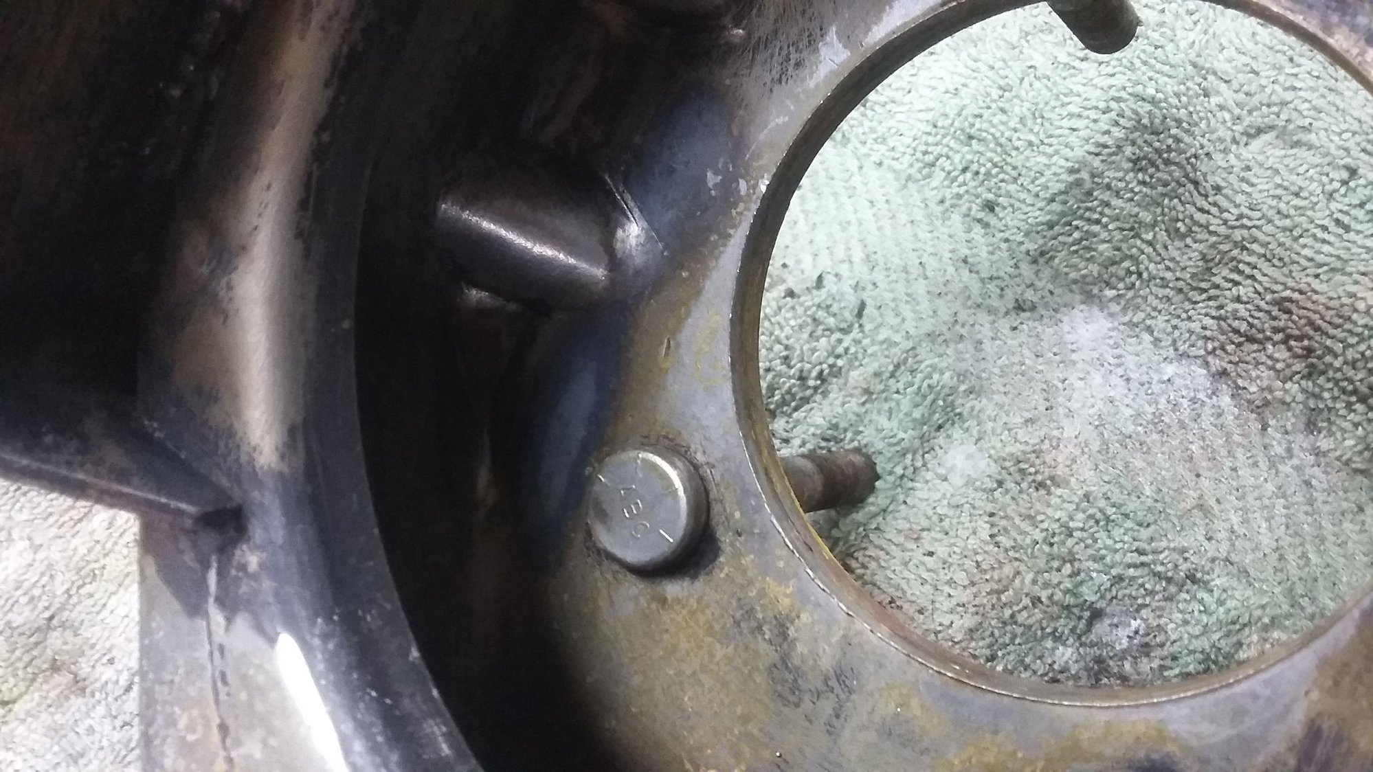

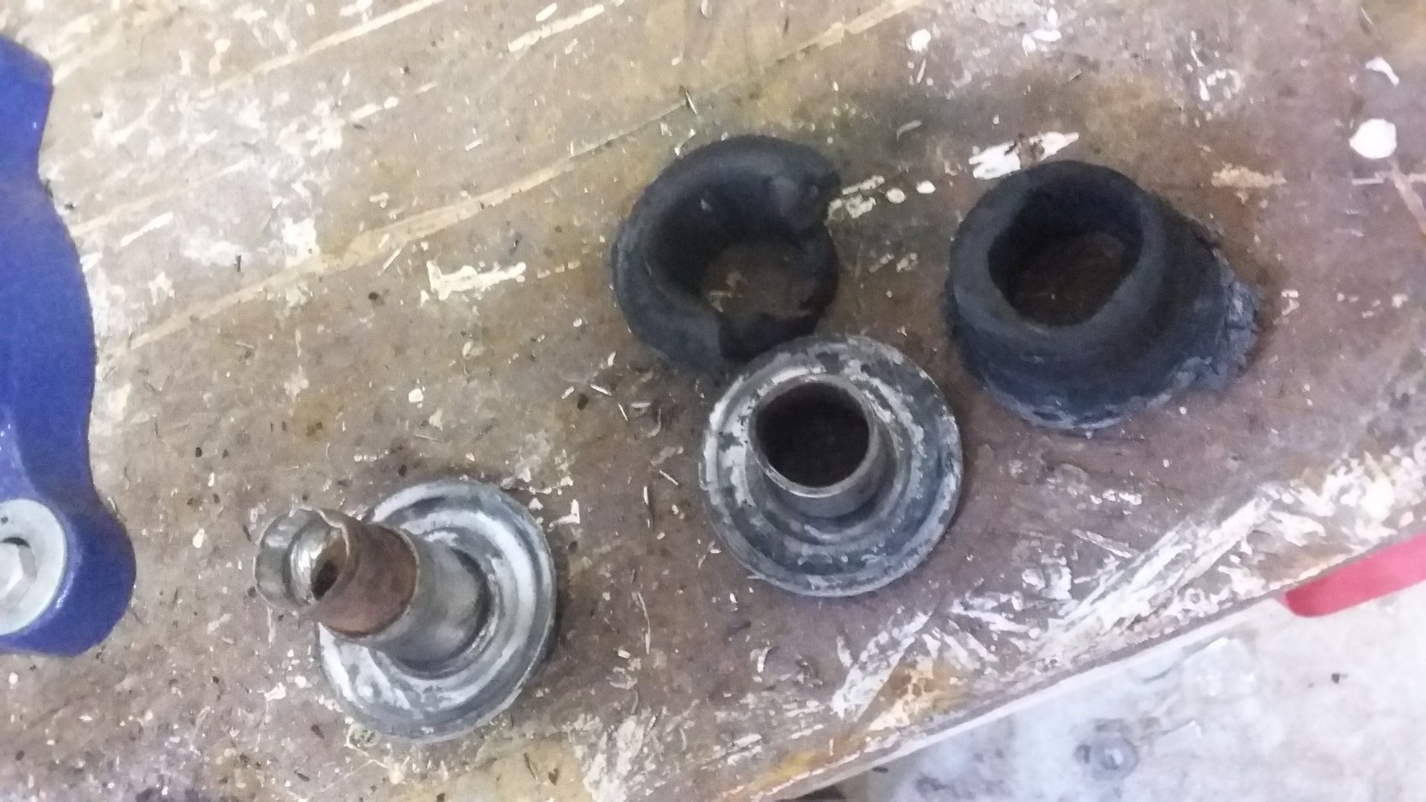

So the Drivers side T/A had the original flared insert bushing. The Pass. side had a newer, rubber bushing, minus the flared insert. I remember one of the t/a's was really loose, must have been the one missing the insert.

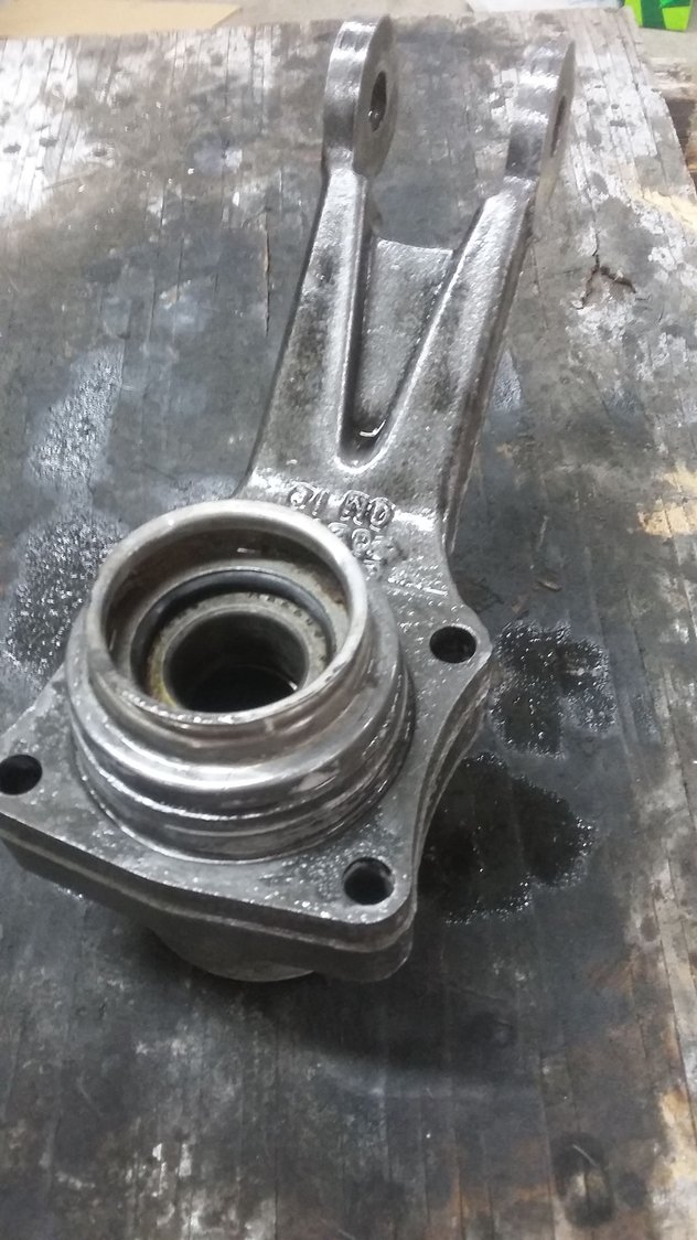

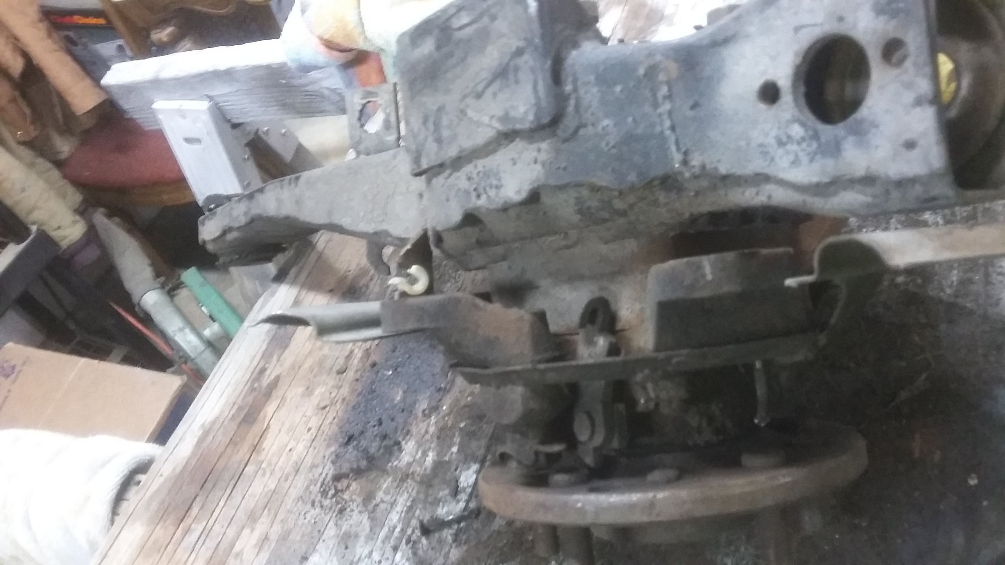

Cleaning up one of the T/A's

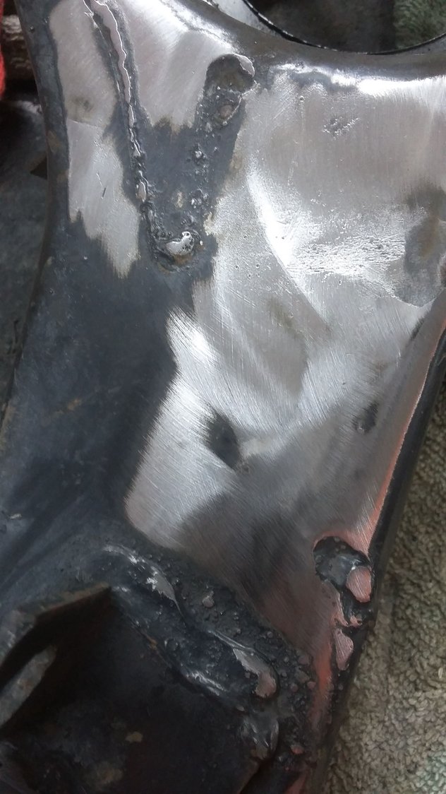

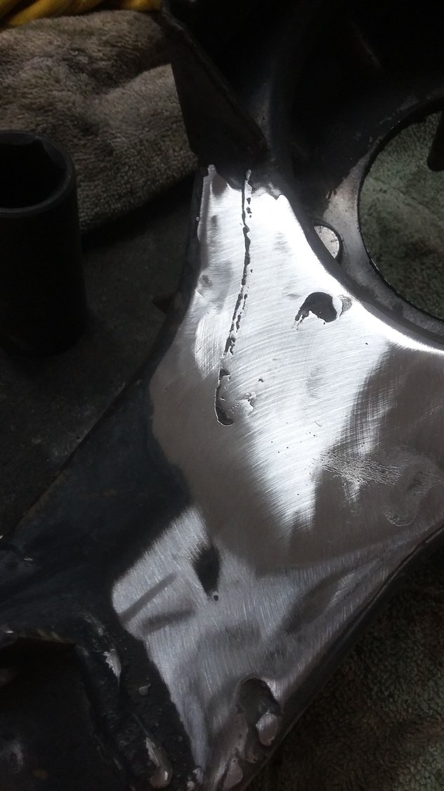

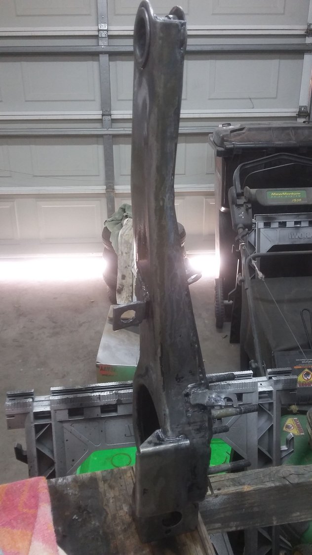

More evidence of the speed welding done at GM. They never stopped, just drag the gun with wire spitting out from the end of one weld, to the start of the next. I used a flapper wheel to sand off the weld spatter that was above the surface, but the gouges will forever remain. Only thing they're hurting is my feeling. ( I only have the one )
Yes...they put just enough weld on those trailing arms to make them passable/not sturdy.....I filled in all the unwelded areas with my wire welder before I painted the arms....it doesn't have that "tin can sound" when you tap the arm with a hammer now.
Heavy sigh, I Really had the urge to weld out the arms, but I was afraid of warping them, I knew the frame could take the heat, but, oh well,,, they are ready for rebuild now, so they are what they are. Lesson learned, pay more attention to what others have already done, and gone thru. I spent a year reading every post i could find prepping myself for this build, but then I found the car, started on it, and forgot that I'm not an expert on everything. This build is going too slow, but that's on me, You have reminded me to step back, and research before being committed. Hope your build is going well, I haven't looked at it in prolly 8 months. But I promise to check it out again soon.

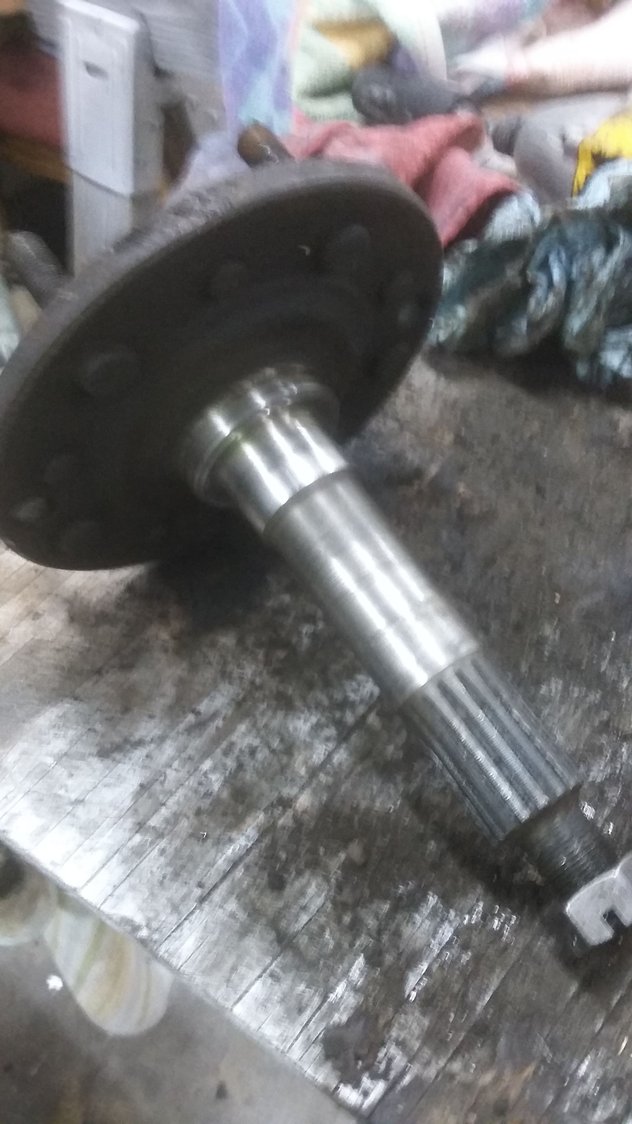

Been awhile it feels like. The T/A's have been sitting in boxes all shined up and ready to be put back together for a couple weeks now. Silly me didn't anticipate a back order on the parking brakes, so I've been waiting on them. I'm not positive, but it looks like the new brake parts are required to go in as the trailing arm is rebuilt. If not required, then certainly would be easier I think. They shipped yesterday!! Woo Hoo!! My new mono spring is also backordered, no ship date yet. I have been putting off the cleaning of the rear end because, I'm just plain tired of cleaning the 40 year old road grime. I'll be alot happier once I get this thing sitting on wheels again. So I finally pulled all the u-joints, and broke down the entire differential to begin cleaning process. My plan is to pre clean the diff before removing the cover. There is no sign of anything leaking to date, but I'm curious about the vent tube. Is there a check valve built into it? When I flip the diff over to work on it, I expected fluid to come out of the vent, but none does. The gears feel good by hand when spinning, with only the slightest bit of play at the side yokes. I hope to just clean and replace the fluid, and cover gasket and be done, but I'm wondering if I'm in for a big rust surprise when I open the cover. Anyone have any advise before I go any farther? BTW. It's 2017. Can't we make a better u-joint system?
Also, in order to save a little money on the build, I'm reusing the existing parts that seem to be easy to get to after the car is complete. For example the rear strut rods, I'm sure I'll prolly need new adjustable ones for alignment, but for the build out I'll use these. I do have new bushings for all. Also, the brake rotors, pretty sure they will have to be replaced too. But those things can be done on a finished car later. Anything someone see's that I haven't replaced, that is hard to get to or do later,, please let me know.

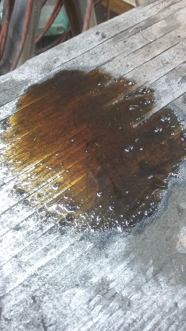

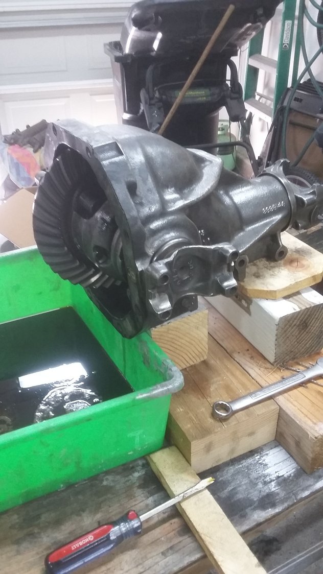

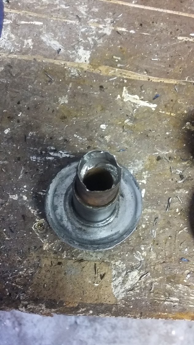

Sweet! After last post, I cont. cleaning, only this time, the vent does start leaking a little fluid. So maybe it hasn't been clogged for the last 40 yrs. The oil actually looks pretty good, although it's hard to see against the dirty plywood table I'm working on.
It doesn't even stink too bad.

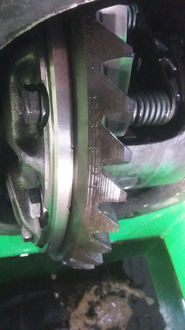

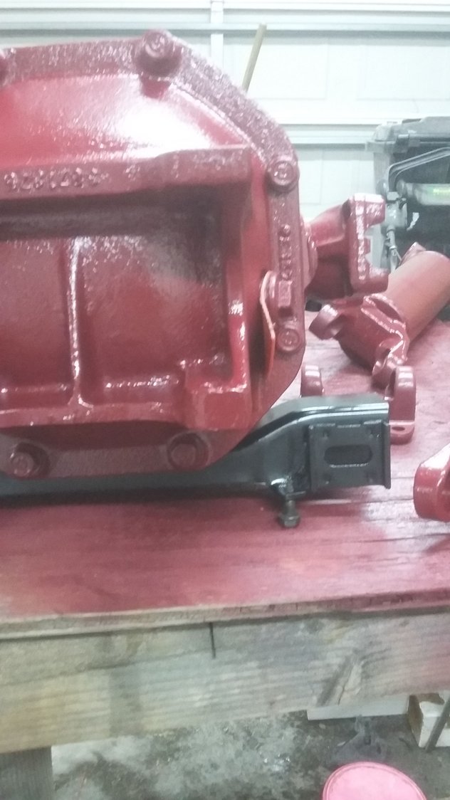

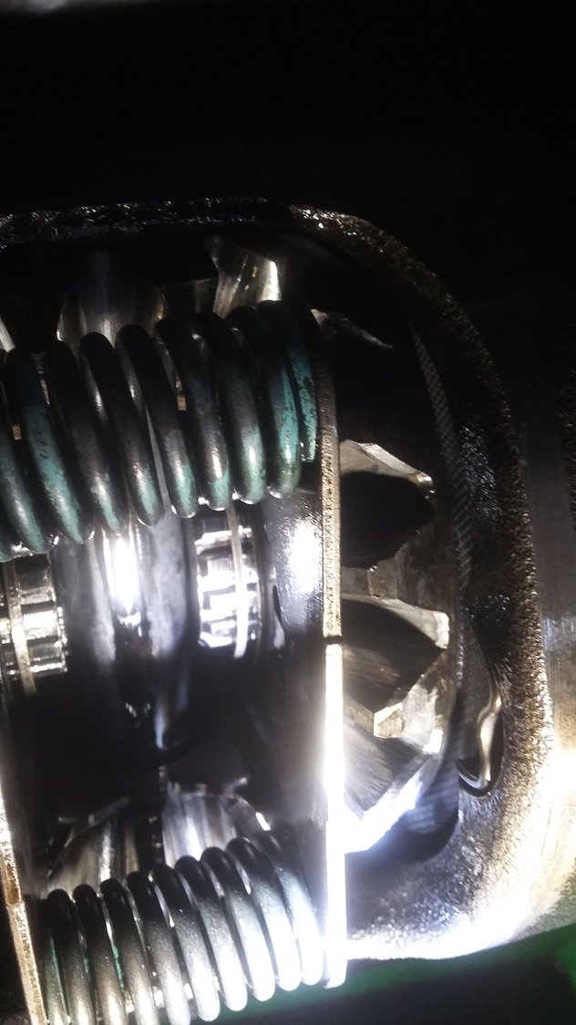

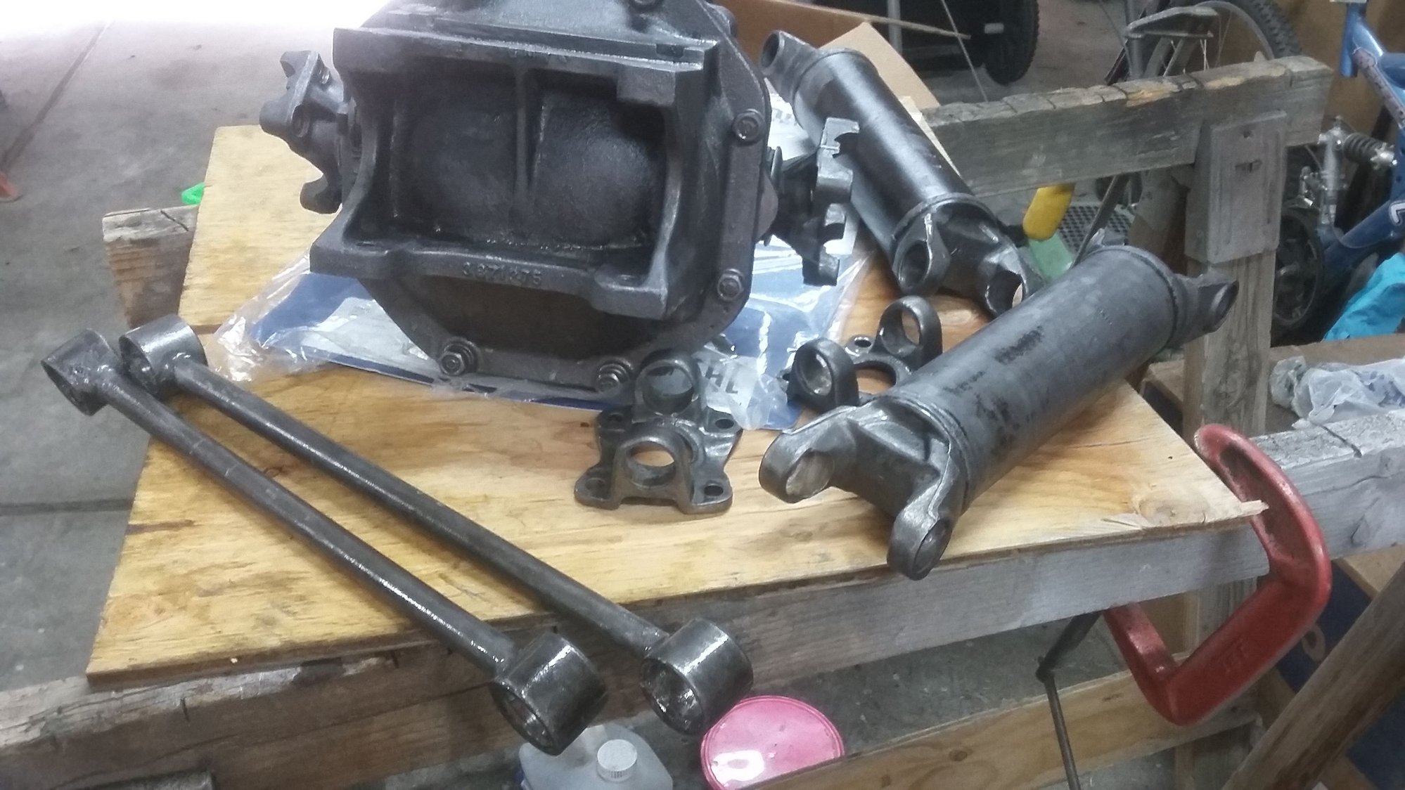

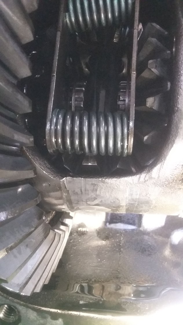

I got the diff pretty well cleaned up this afternoon and then split the cover off
Kinda hard to see, but it's 12 37. Base package 3:08 gears.
All in all I'm pretty happy with the shape it's in. Speedo says 60,000 miles, but I don't know if it was always hooked up, from the sharp teeth, I'm now convinced that the mileage is correct.

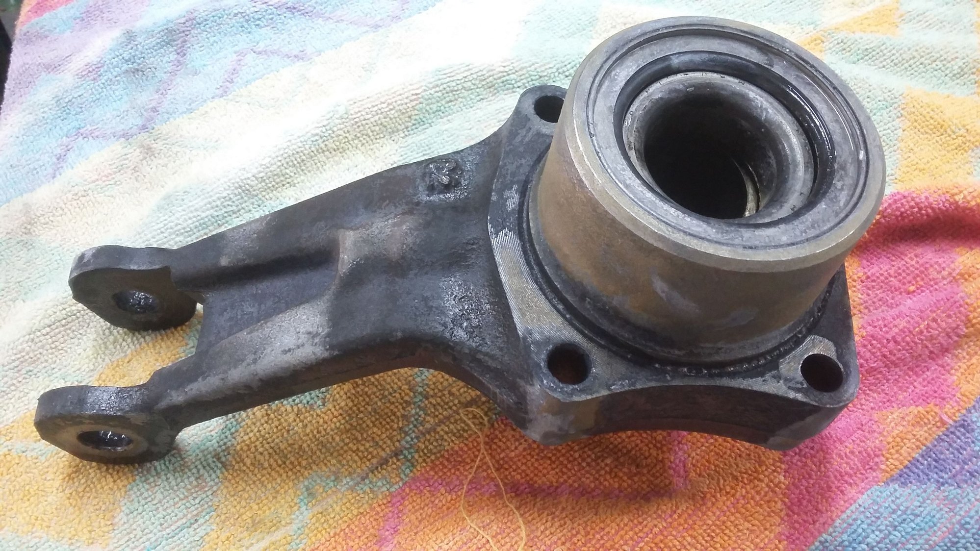

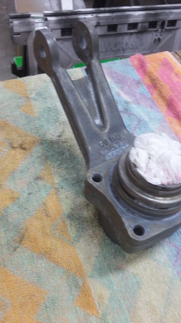

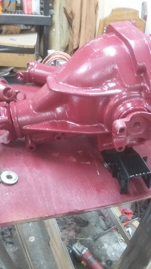

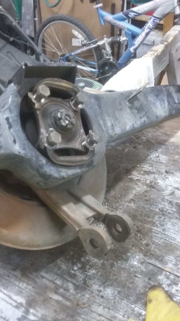

copper fitting brush cut off and put in a drill for cleaning up inside of sleeves prior to new bushing install.
I didn't get a good pic of the direction this bracket needs to be installed in. One side has the sheet metal screw vertical,
The other end has a sheet metal screw horizontal. Anyone know if I have it in the correct position?

bazza77
Joined: Jul 2010
Posts: 3,176
Likes: 633
From: perth western australia
if it went on no trouble then you got it right , if you look closer one of the bolt holes is out of square with the other three .
Or , only one way it will go on
I like that colour as well , coming along nicely

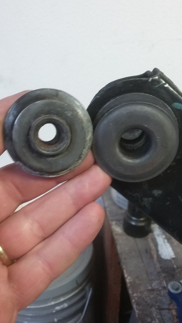

I mounted the Diff. over the weekend, and found another partial bushing in the complete bushing kit I bought. The diff carrier bushing did not come with the needed inner sleeve for the upper half. This kit came with all kinds of metal sleeves for bushings that fit other models, which I don't need, but the ones I do need in the kit I bought for this particular model car are not supplied? Ok, I'll just buy the sleeves I need right? Nope, can't buy em that way, gotta buy the whole new single bushing kit to get the sleeve. Are you kidding me??? While I don't think I lost money buying the kit, I certainly lost time, and gained alot of frustration trying to figure out which bushings were for what application. And when I went to the Prothane website for info on part numbers like the vbandp vendor said I should, because they are only a parts distributor, what happens? Yep,, I got a timely reply back from some company I have never heard of saying they can't help, they only distribute the parts. So at the very least, I'm paying third party vendors for custom made parts. No wonder this craps so expensive. And alot of it won't even work as delivered!! Gotta buy it again.
On a positive note, I finally dropped off the trailing arms for rebuild, and they should be ready by the weekend. While talking to Jim from Tucker GM Collision shop, I mentioned the bushing issue, he gave me a part number for just the upper half of the bushing including the metal sleeve from Ecklers Corvette. Thanks Jim, got one coming. As an afterthought, I searched Ecklers website for the same part I just ordered, without the part number, I was unable to find just that part, all that came up in searches were full kits. If he hadn't given me that part number, I would have had to pay 3 times as much, and only used one part out of another kit. Alot of venting here, sorry, but maybe the next guys can save some money, or at least be forewarned that all is not included when you buy a "Complete" kit.
