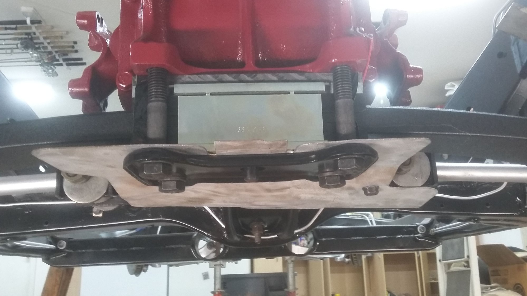

Abbreviated version of Mono spring install.
This is easy with the frame off, and nothing else in the way. I installed the two front of car bolts thru the bottom bracket and alum. heat shield, just barely
getting the threads to catch. This leaves just enough room to slide the new spring into position, insure that the dowel rod thru the center mates up with the holes in the bottom of differential, and the new hole drilled in alum heat shield.
This is the new 1/2" I.D. hole drilled thru original heat shield. You will know where to drill it because it will already be dimbled from being smashed up tight against the original spring thru bolt, The new mono spring has a dowel rod in the same place, just a little longer. If you use the new heat shield that comes with the mono spring, then this hole is pre drilled.

I also had to straighten out the U bend in the back of the original heat shield.
This curled U bend was straightened out.
After you insure the dowel is seated correctly, I then started the two back bolts. Hand tightened until the spring was snug. Then had to loosen it all back up because I forgot to align the two holes where the original heat shield bolts to the lower diff bracket. If you use the new shield, these will not be used. So after the second try, and all bolts are started, and hand tight, I started the torque sequence. Although there was nothing in the directions about pre loading full car wieght before final torgue, I've read several horrer storys about the ears breaking off the diff due to torqueing the spring with no weight on it. So I only went as far as flatening out the lock washers, about 10 lbs. I will finish the rest of the torgue along with all the other suspension parts after car is finished.

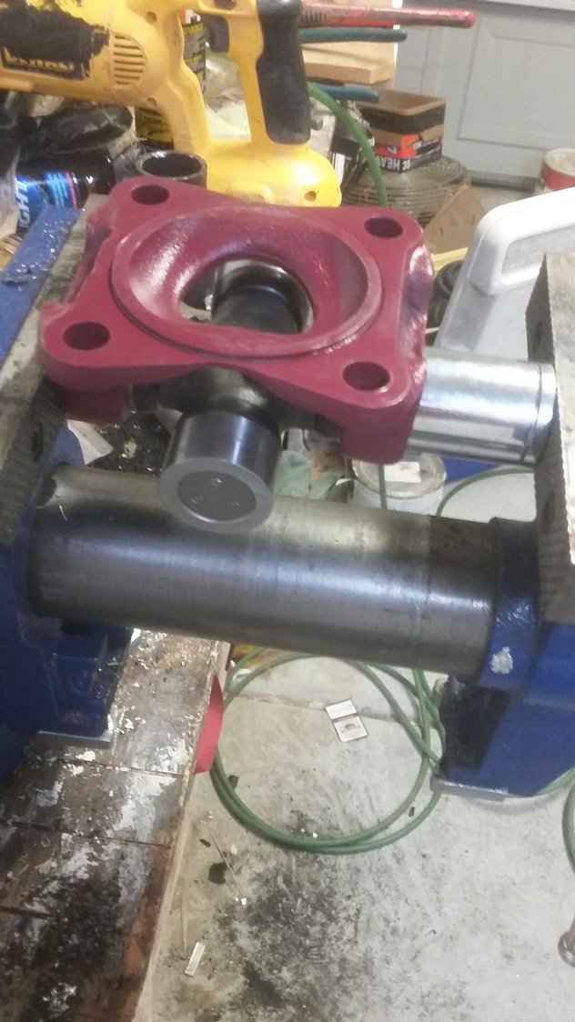

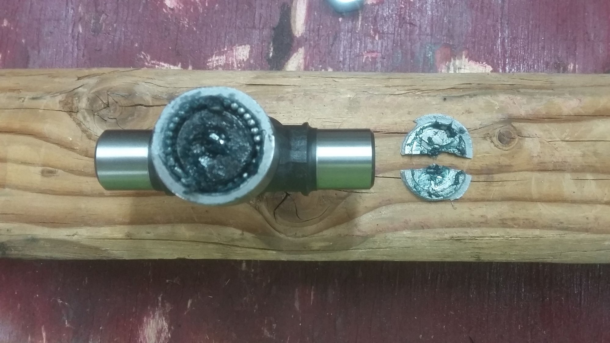

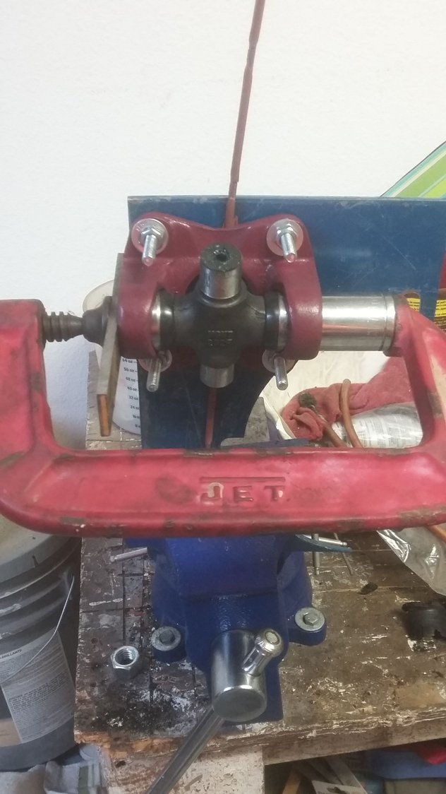

Oh, the pain and missery I put myself thru. U joints are easy right, sure their a pita, but the install of new ones is pretty simple. Oh, wait, it's a Corvette U joint. Silly me, I forgot that part for a little while. The first one I installed actually went pretty good, until I tried to install the second end clip. Won't fit. It appeared that the new u joint was just a tad too long to allow the retainer clip to fit into it's slot. I wasn't too concerned to discover this, because when I broke the car down, one of the u joints was missing a clip, and the end cap had worked it's way partially out of the carrier. I just figured the stress had deformed the groove that the clip is supposed to seat in, and set that one aside to work on later. So then I start on the second one.
Everything looked straight and tru, so I put the squeeze on it, thinking happy thoughts. Didn't work out so well tho.

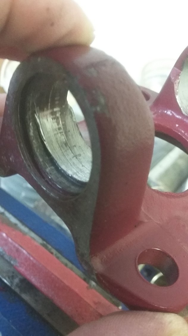

Because of the crooked angle, the end cap gouged into the carrier creating a big burr that had to be removed, and cleaned up. Just trying to remove the u joint so I could fix the gouge problem resulted in this.

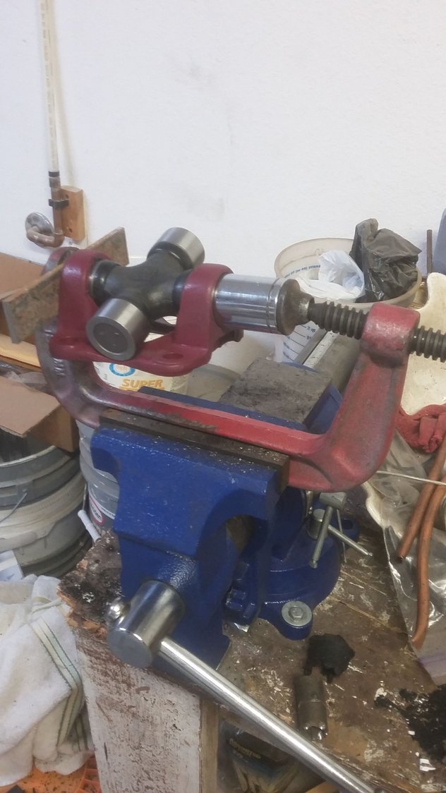

My vise won't open up enough to start the joints, so I used a C clamp. As you can see in the pic, it's not pressing in straight.
I thought my c clamp was flexing, so I stopped using it, and went with the vise.
While pressing out the joint, the end cap was stuck so hard that I actually drove the spindle thru the end cap.

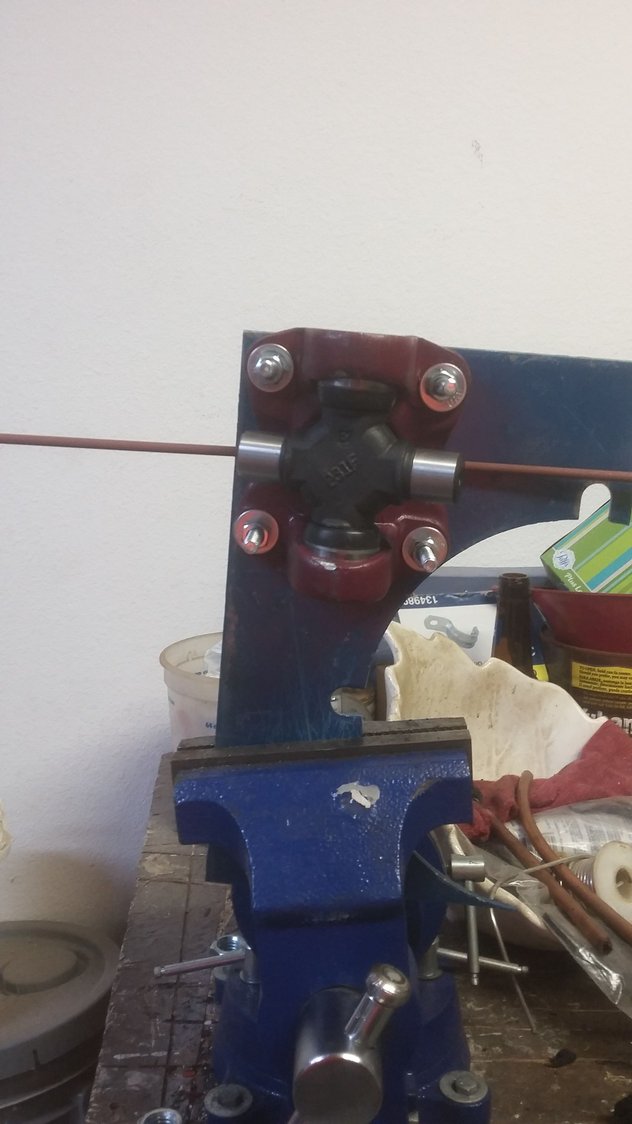

After deburring the gouge in the flange, I tried again to install the new joint, being extremely careful to keep it straight. I got it in, but the same problem showed up. I could not get the second retainer clip in.
This is when I went back to the forum to search for help. LO AND BEHOLD, This has been an issue for lot's of us. Turns out, the flange has quite a lot of flex in it, which exasperates any misalignment in the end caps tremendously. Which caused the gouging effect. This flex also seems to be what is making it appear that the new u joints a slightly too long to fit.
The fix is to either bolt the flanges up to the control arms, or fabricate a heavy metal plate to bolt them to. This will effectively force the flanges into the correct position which should allow the u joints to fit properly. Since I don't have my control arms back yet, maybe tomro I'll try to drill out some plate steel and go that route. As anyone who has a news channel knows, It's been a long, rough day here in Las Vegas, and I'm done.

This morining before work, I decided that I would try lag bolts into a 4x6 instead of fabricating a piece of metal to take the deflection out of the half shaft flanges. I wasted a couple hours with the lag bolts and then various c clamps trying to straighten them out.
What ended up working really well, is exactly what other members on the forum said they did, with only slight modifications.

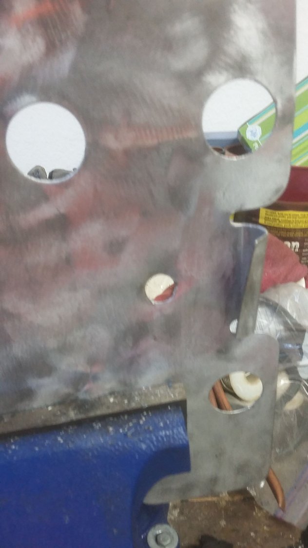

I took a piece of the steel plate I used for the gussets on the frame, and laid out the bolt hole pattern, then drilled the holes at 5/16". I used some old 1/4" machine bolts I had for the bolts. I placed a 1/8" welding rod in the center of the flange, between the flange face, and the plate steel. The plate steel is only about 5/32" thick, and I figured it would probably flex a little, so the welding rod spacer was to accommodate any give in the plate. I slowly snugged two sides of the flange, not taking it all the way against the plate, then began torquing on the other side. It took alot more force than I thought it would, but I was only using a 1/4" drive ratchet, and a screwdriver on the machine bolts. Once the flange was in what appeared to be the tru and straight position, I put the c clamp back on to get the extra little squeeze I was needing to fit the clips in. It took just a little bit more bending, but then, Ahaa. There was definitely a sweet spot where the u joint began moving like melted butter. This is the position it wants to live in for sure. I gave the c clamp just a little squeeze more, and removed it. Sure enough, the clip easily snapped into place. So this was a 3 hour process, with half of it being wasted trying stuff that didn't work, and all the time I had already wasted trying on my own to install these things. And I've only installed Half of two u joints. I still have to fit the half shafts onto them.
Just goes to show, just because you've installed something before and it went well, Always do a little research before you start, and pay attention to what problems other's have ran into. I figure I wasted about 4 hours, which is two days build time for me currently.

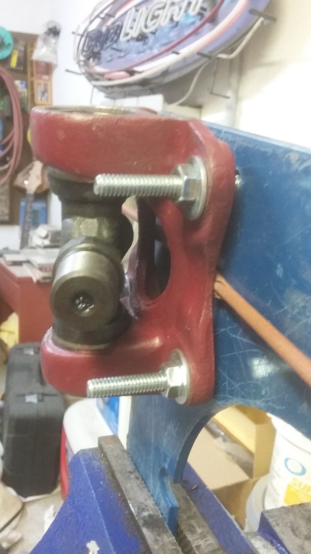

Flange bolted to the plate steel
Found the sweet spot where the u joint is loving it.

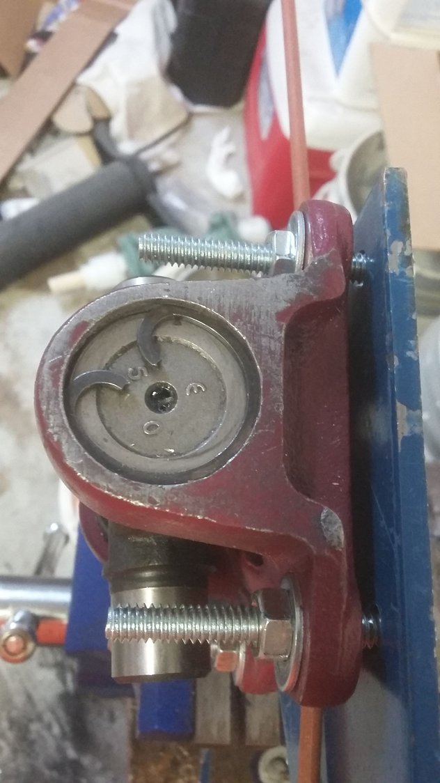

I gave it just a little more huggin before trying the clips

Success!! the clips popped right into place.
