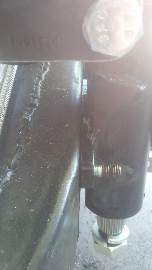

I've had the new Borg. steering sitting in a box for a while now, time to install it.
I used the original box to mock up the placement. As mentioned in early thread by bazza77, and iwasmenowhesgone, I needed to trim the gussets to make room for the steering box, and idler arm.
Idler arm gusset trimmed.
Old Apr 25, 2018 | 08:33 PM
  #194
badapplegolf's Avatar
badapplegolf
Joined: Mar 2017
Posts: 219
Likes: 16
From: Las Vegas
The original box fit with just a little hole saw work. But the new Borgeson unit was bigger all around. It required almost the entire gusset to be removed.
I wound up with about a half inch of added gusset. Big waste of time, but oh well. If your gonna run the original steering box, then the gussets are prolly worth the effort. If your gonna change to a larger steering box, then do your homework first, or just be prepared to cut most of it out. I figure any gain is worth it.
new Borg box sitting flush with frame.
You can plainly see whats left of the gusset in this pic.
