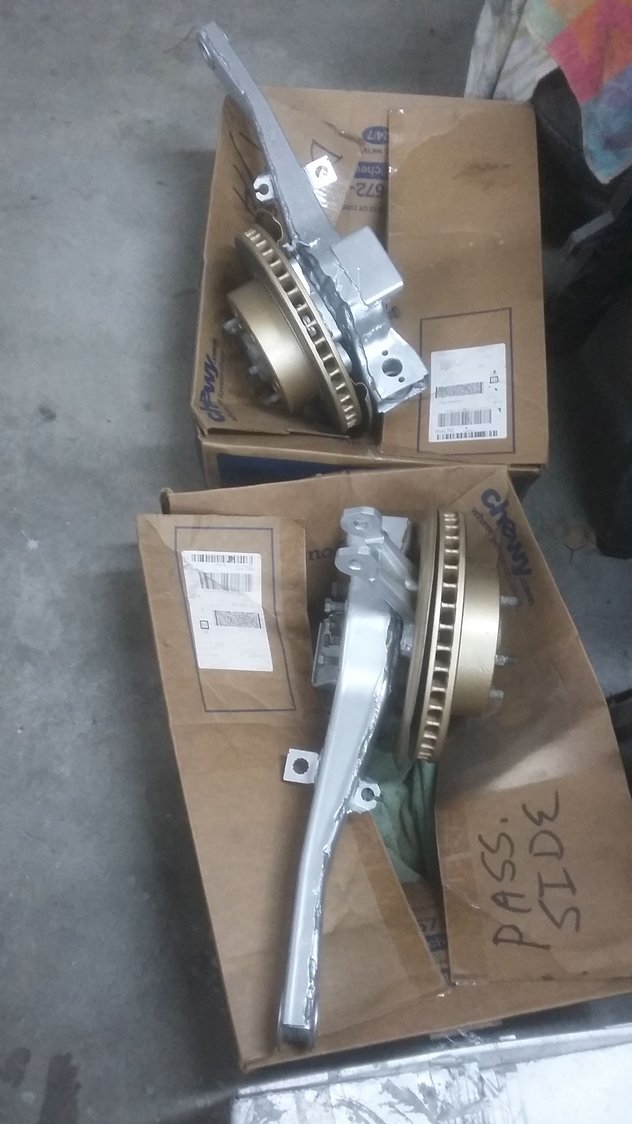

Yeah!! My trailing arms are back. New SS park brake, rotors dialed in. WOO HOO
So I opened up the new poly bushing box. Been looking forward to getting these arms installed. Hmm, notice something missing? Yep, box is short one half, of one bushing. Gotta laugh about it at this point.

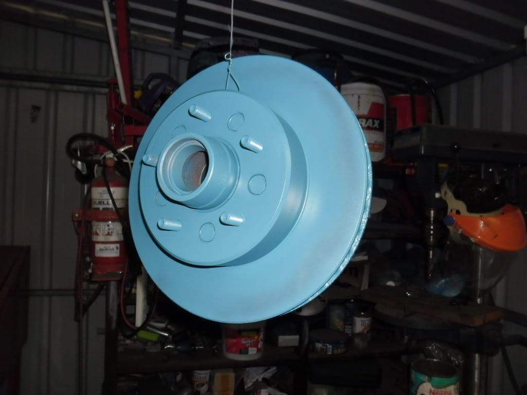

Is that gold anodizing or paint on those rotors ? they look too nice to use

I painted my rotors similar to what you have done thinking the paint would do that as well , well they squealed and chattered and generally performed crap until I sanded it all off and I think I threw away the pads and put new ones on . But I was using a heat proof ceramic (rattle can ) paint .lol

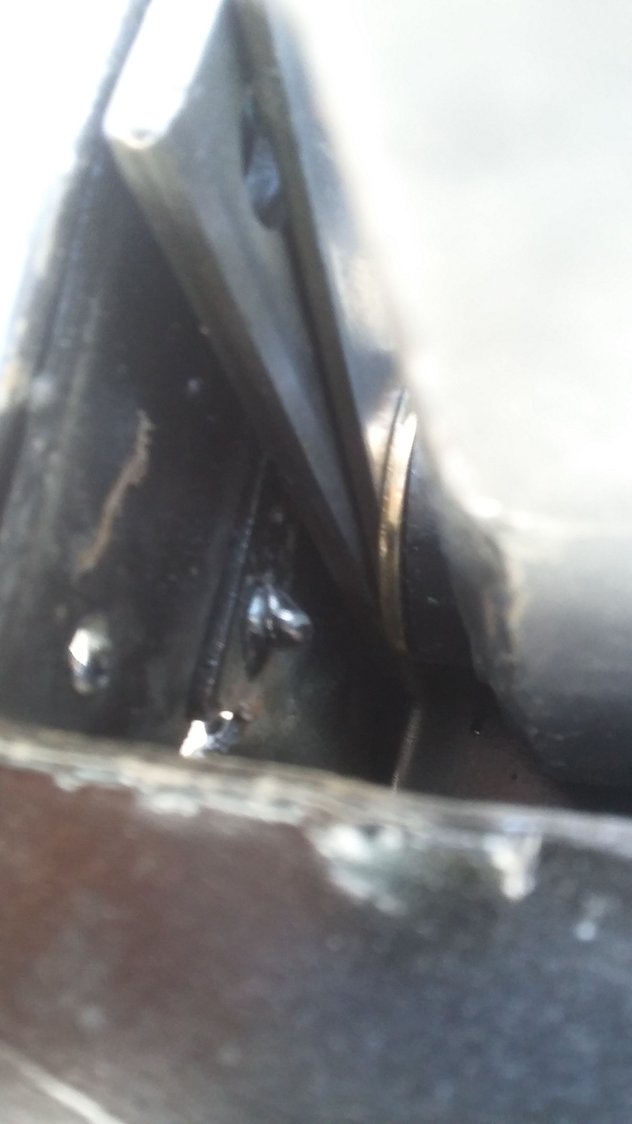

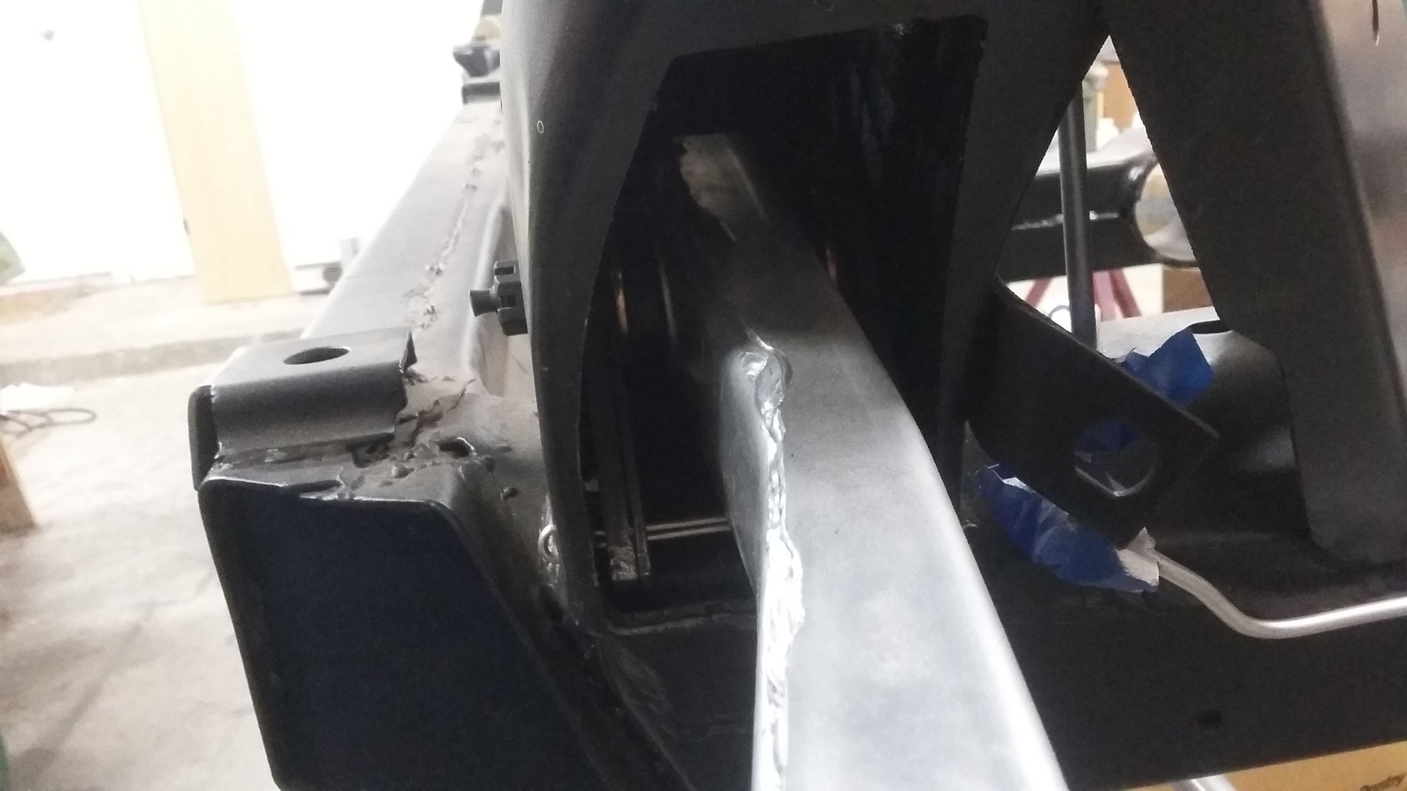

So the place I left off at was with the new trailing arms bolted to the car, the shims were reinstalled the same way they came out originally. Only difference was the the new bushings required slightly less shims. I was lucky that I had the same small shim on the outboard side of each, and It was exactly the right amount to exclude. Close enough to get an alignment done later. Bigger problem was I couldn't get the drivers side shims to all slip down into channel for the cotter pin to secure them. I spent several hours tweaking, jerking, shaking, and cussing at it trying to get them to pivot down. Aghh! Once I finally got my head where I could look in to the nook, here is what I found.
During the frame weld out, I let a dingle berry happen at a very bad location. This bit of droppy metal kept the shims from being able to slip down into their niche.

A sharp chisel cut it right off, and fixed the problem.
TA installed and cotter pin thru the shims.
Now, let me say, installing these are almost as hard as removing them. One person can get the arm, and the pivot bolt engaged, but to get all the shims in required alot of muscle, and a second pair of hands. While I held the roter and twisted, pulled, shaked, etc, my daughter was able to slip the final shims into place. It would be easier if you had three people. there are several ways you can use a pry bar to help slip them in, but the TA is heavy, you'll get tired, and holding it with one hand while prying with the other is a chore.

The strut rods were no easier. Not a physical tough, but an alignment tough. I first installed them to the diff bracket. With the new bushings, you really got to work them to get the bolt holes aligned. They fit tight. Then to hook up the other ends, It's a matter of jacking the roter up or down so that the pitch, angle, camber, toe, and rotation of the earth, are all aligned. Again, with the new bushings, it's tight. Once it's all started straight, you will then need to keep adjusting because as you push the rod into the spindle bracket, the angles change, so keep adjusting. I used the floor jack and 12" 4x4 to brace the bottom of the strut rod, while using my body weight to manhandle the TA around trying to get it to slip into place. Alot of frustration, time, and effort went into this, but in the end, both sides finally slipped into place. There is prolly alot easier way to do this, but I'm pretty hard headed, and maybe not so smart. Do some research before trying it the way I did.

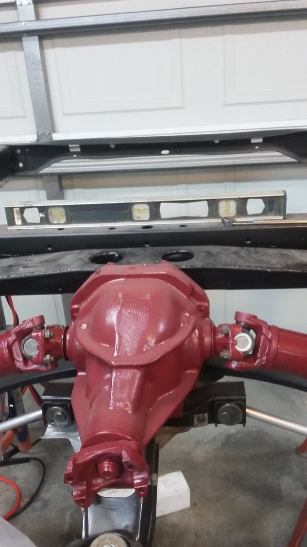

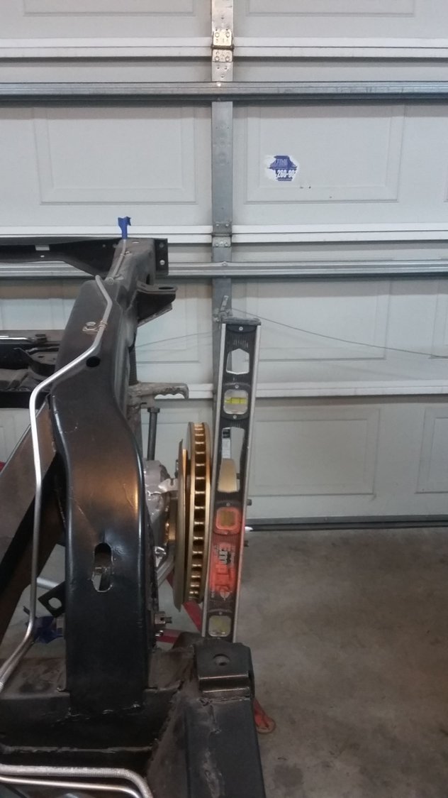

For a rough alignment on the strut rods, I leveled the frame on the jackstands, and then just plumbed the rotors to match.
I leveled the frame at the rear crosmember
Then turned the cambolt on the strut until the roter was plumb.
