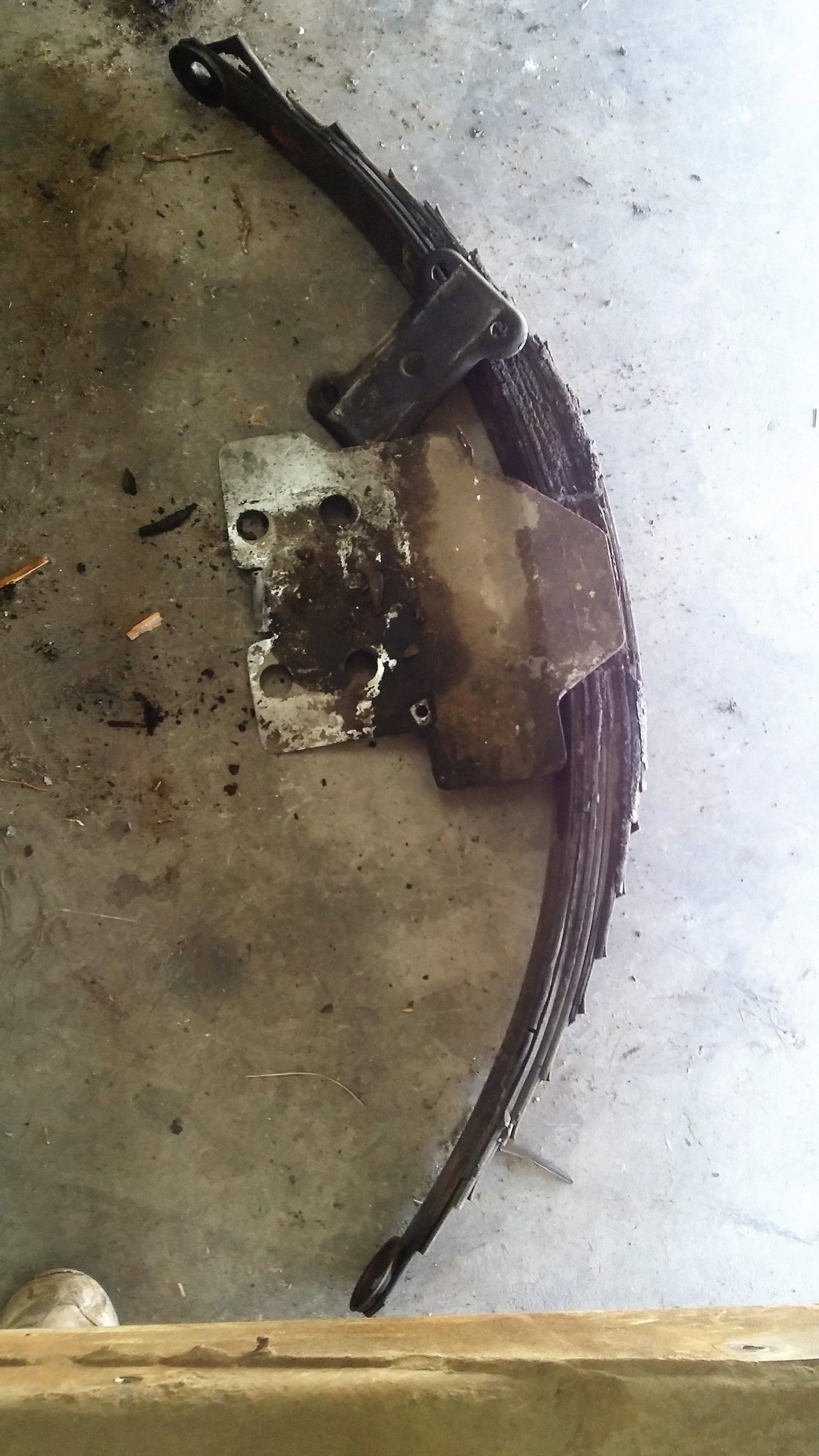

So I've got the back half stripped down to bare frame, Still need to finish the front end. Apparently some of my pics would prefer to float around on a cloud, instead of coming home. Maybe they'll get hungry and show up later. Anyway, I'll post what I've got for now.
Removed rear leaf spring using a c-clamp, and floor jack.

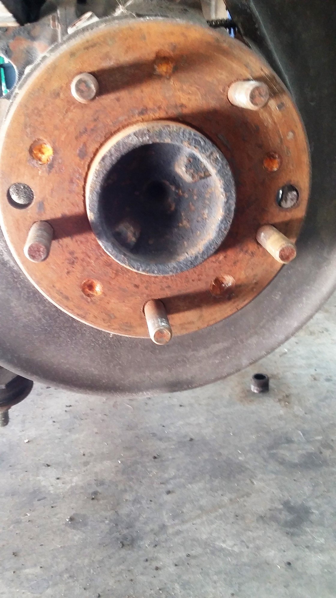

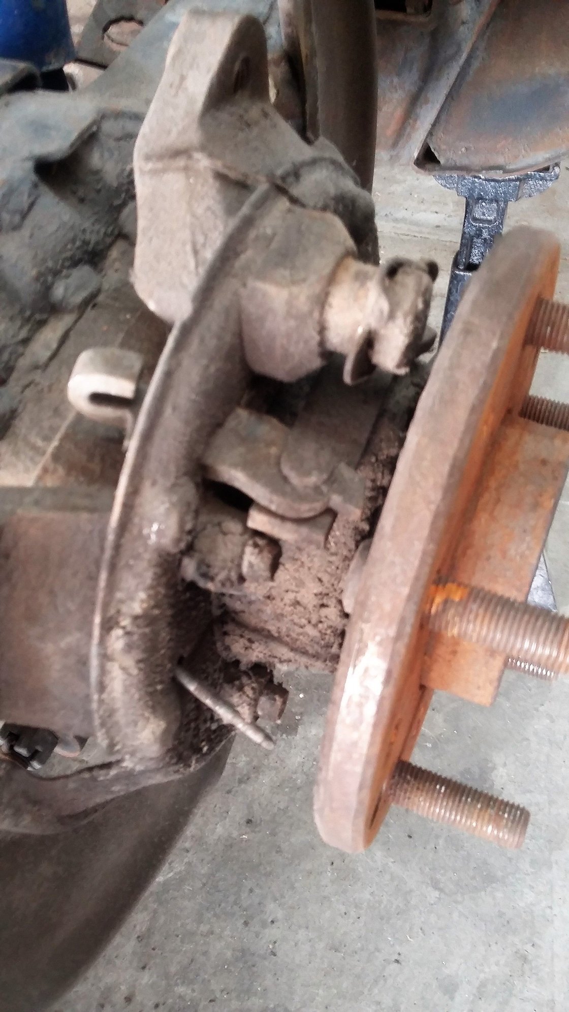

Someone has already drilled out the rear pass. side rotor rivits.
And the parking brake is MIA

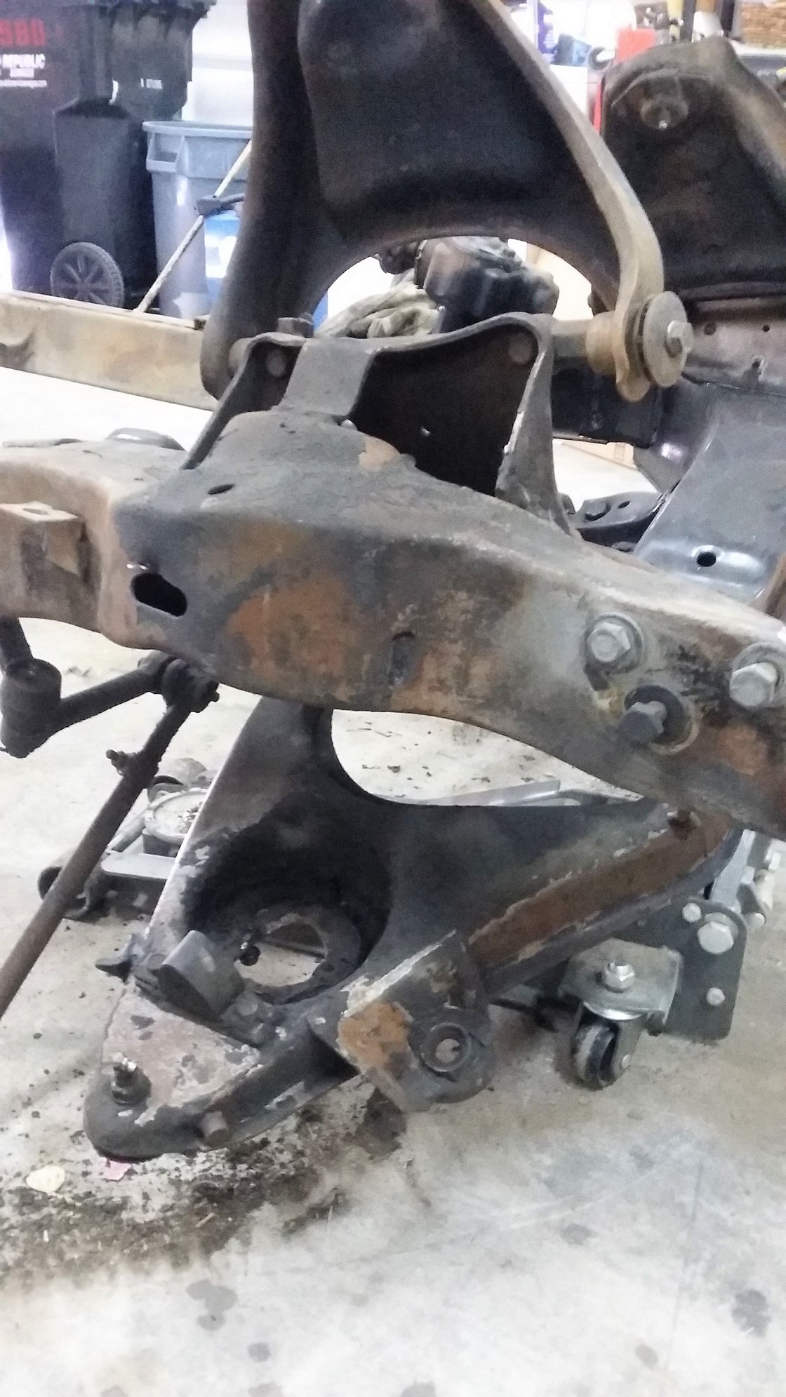

I'll have to look into options concerning the rear rotors. I was able to save the fronts. I just pulled the entire spindle assy.
Rear trailing arms!!!!!!!!!!!!!!!!! Even with a body off, they are a pita. I couldnt even imagine pulling them from a complete car.
To recap, the rear end is broke down to frame. All brake, fuel lines are gone. Front springs are gone, and spindles have been removed with the brake rotors.
The only things left on the frame are the control arms, and steering. Then its time to start the frame work.

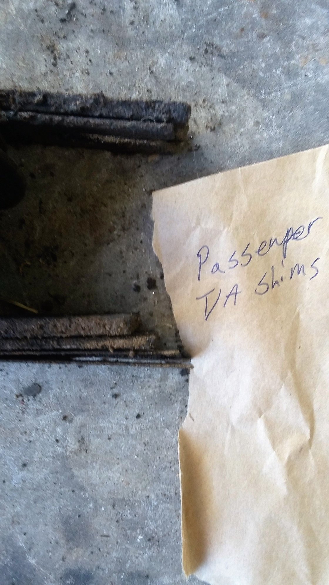

A few pics that wandered home finally.

Your passenger side parking brake looks just like mine did when I restored it.
I'm starting to believe that this was a common fix back in the day when "Bubba" had problems with the parking brake system.

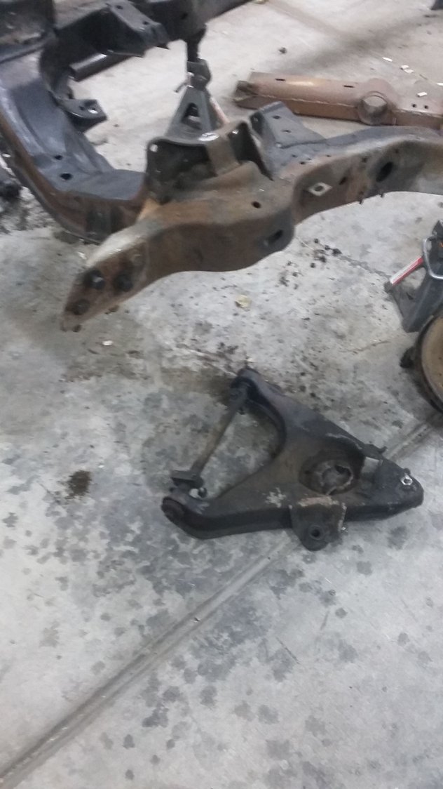

The frame is finally stripped down. All suspension, and steering are off.
Cleanup of frame begins.

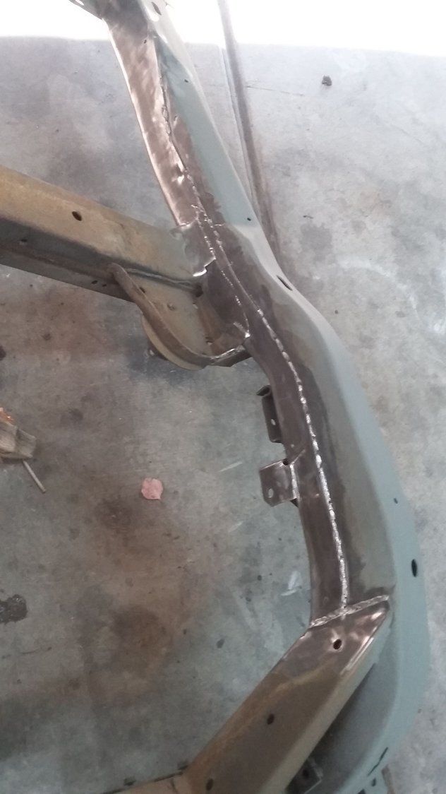

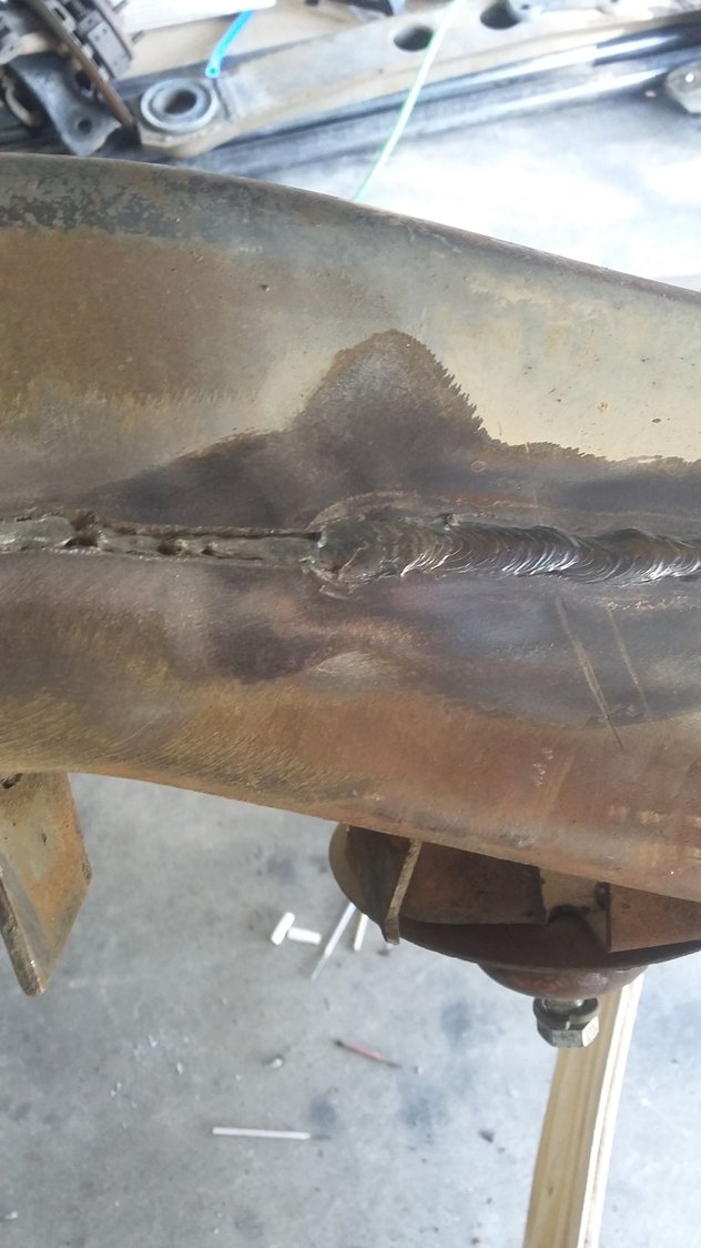

My process for cleaning frame is pretty much trial and error. I'm wire wheeling everything that I can get to, with weld joints being the priority.
So I've gotta vent some disappointment at this point. I've inspected the entire frame, and I can't see any problem with it's current original welds, and bracing. Sure, they "skip" (quote from the chevy power manual) welded, and most of it is pretty ugly, but I have no doubt about it's strength. The recommended gussets can't hurt, and will probably help, but I don't see any benefit to the full box weld on the frame itself. Wishing now I had just done a full bushing job with the body on, and skipped this.
However, since I committed to it, I'll finish it. Also there's those two rear control arms, LOL. Still can't get over how hard they were to remove.

So I'm not as steady as I once was, but not bad. Especially next to the factory welds.

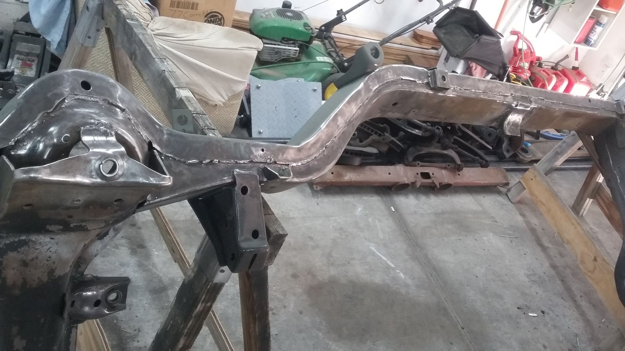

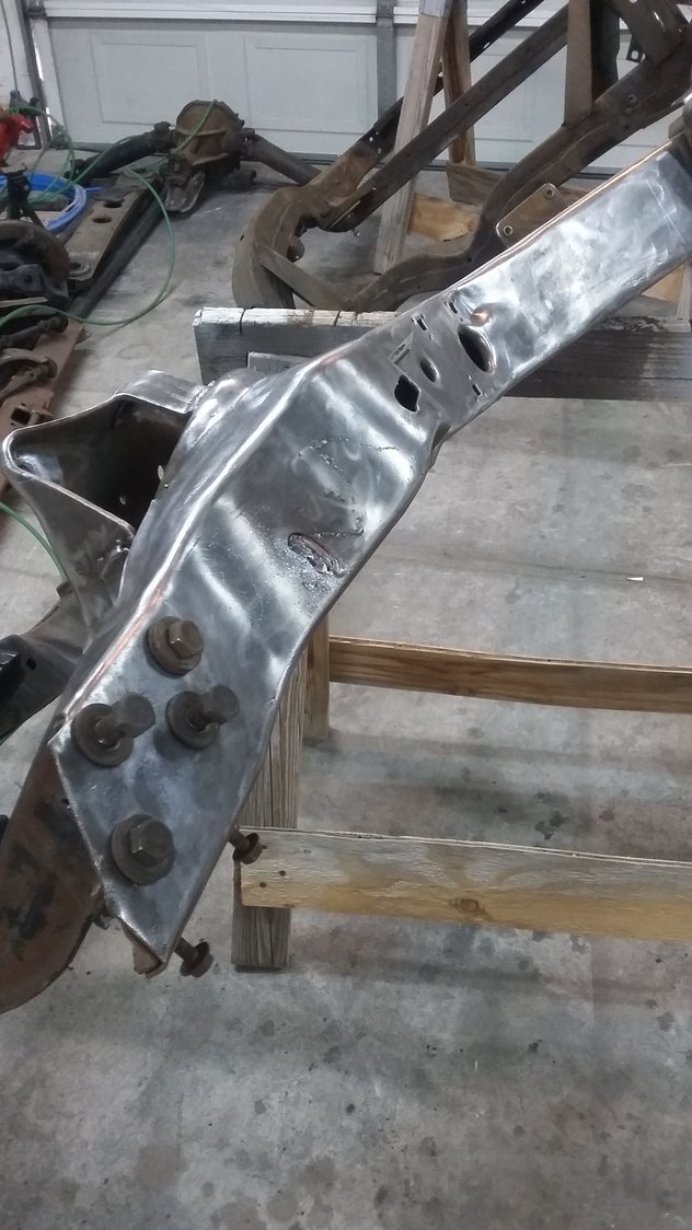

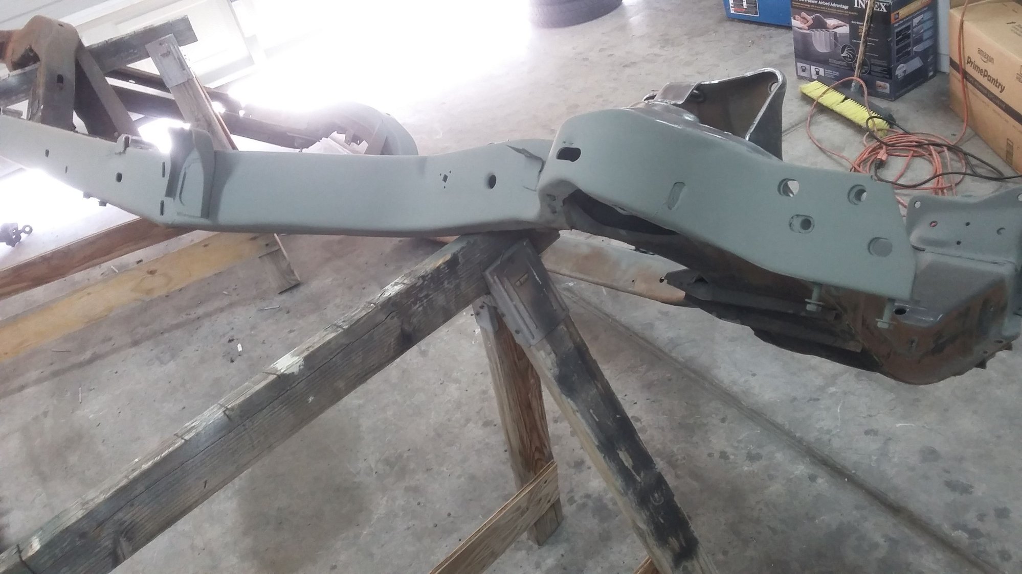

I'm about halfway through the frame weld out. I'm putting it in primer as I go, just to prevent any surface rust that my swamp cooler would cause. Probably a waste of time, cause I seem to remove nearly as much as I put on each time I clean a new section for welding. However, it does make me feel much better about progress. Seeing that nice clean frame in primer is exciting.
A few random pics of the progress below.
