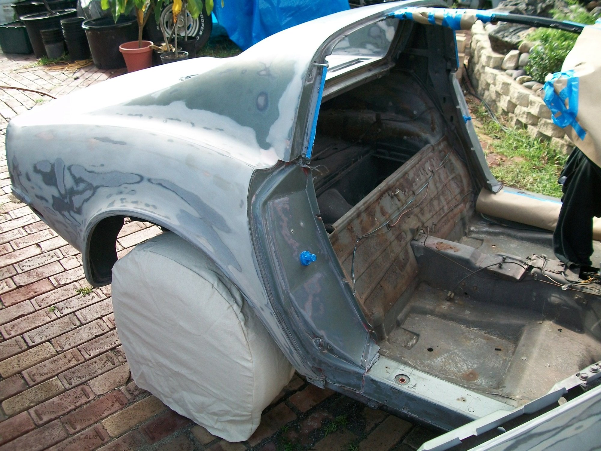

Regarding the t top roof locating wedge inner mount base. When I loosen the screws the mount base under the body is loose, all I know is that thing falls that’s going to be a royal pain to put it back up there. So my question is is that base in a cage where it will not fall?

It's caged, it will move around but not fall.

Hi,
It 'might' fall.
If a lot of pressure has been put on the cage by trying to get a rusty triangular stud out of the threaded plate, the cage may have been damaged…. allowing the plate to drop.
Hopefully you'll be o.k.

Originally Posted by Alan 71
It 'might' fall.
I`ve heard people say theirs dropped.... so I used a long bolt to eliminate the possibility. Take one bolt out, put your long one in, then take out the other. It didn`t interfere with painting at all.

if it falls it will go to a very hard spot to get at , but it can be done . If you pull the trim off you can visual to see if there's any damage to avoid the frustration of picking it out .
Also if you have snapped off the bolts in the steel block it is possible to cut open the "retaining area" and remove the block to fix .
edit , or do what oldgto has done ^^^^

As someone stated above, use another bolt in the in the hole, or a piece of threaded rod to be sure that it will not drop. I had the bolts on one side come out easy and the driver side were so rusted that I ruined the caging of the caged nut plate, and it would have dropped if I had not used another bolt to hold it. Lou.

oldgto has it right! Use that method so you don't take the risk of it dropping into the "BLACK HOLE OF DEATH".
