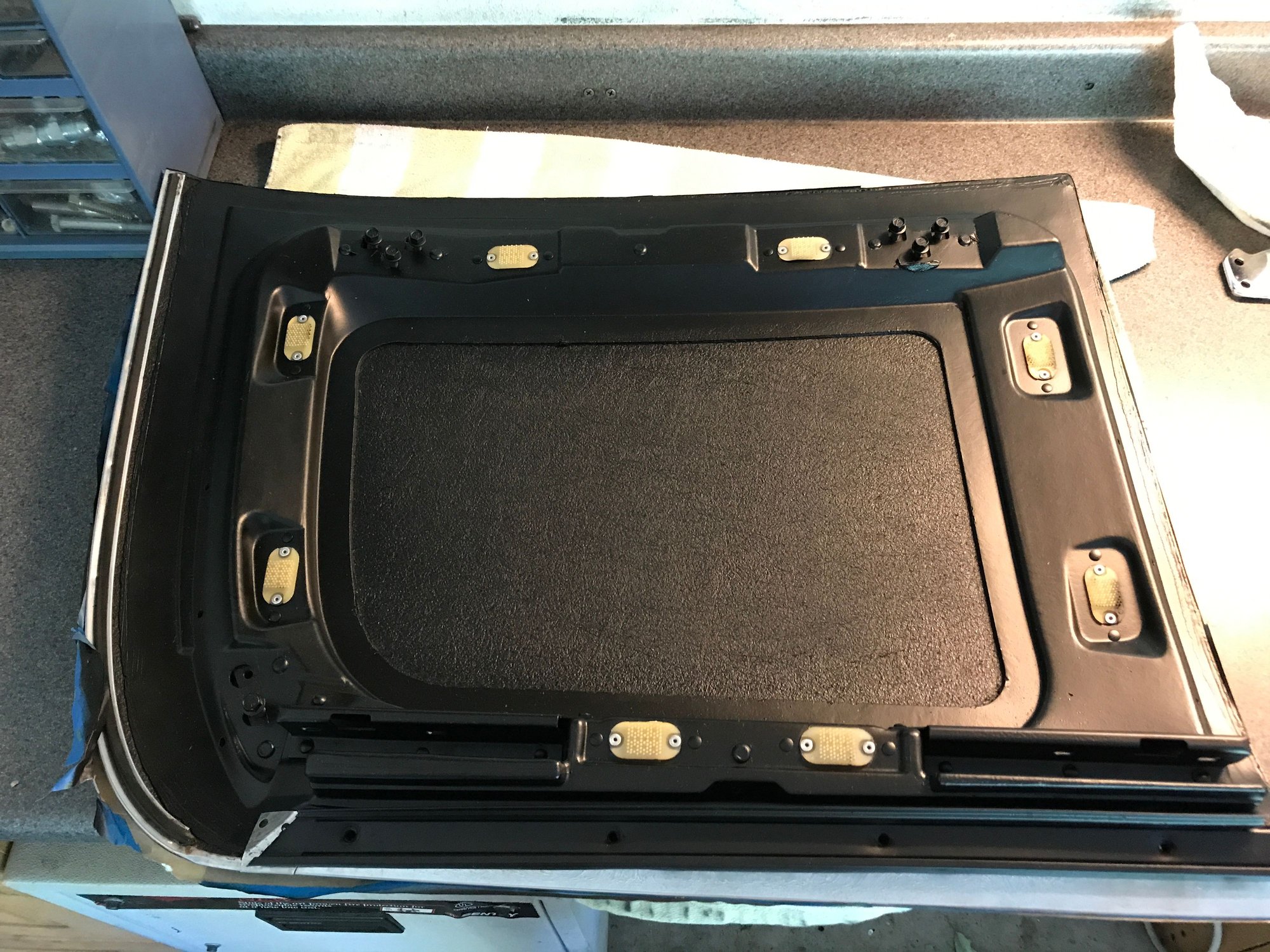

Old May 7, 2017 | 10:19 AM
gr8t73's Avatar
gr8t73
Joined: Dec 2003
Posts: 676
Likes: 36
From: Usa
Originally Posted by gr8t73
I am replacing my t-top weatherstripping and would like to repaint the bottom side of the t-top while I am at it. What spay can paint should I use to get as close to the original black paint as possible. I don't think the Krylon semi-gloss is still available so I was thinking john deere blitz black. Any thoughts.
I finished passenger side yesterday will complete drivers side today. I used the JD blitz black paint as Alan suggested and am very happy with the results.
Old May 7, 2017 | 10:49 AM
Alan 71's Avatar
Alan 71
Joined: Sep 2006
Posts: 31,270
Likes: 4,362
From: Westminster Maryland
Hi gr8,
You work looks very good!
Regards,
Alan
