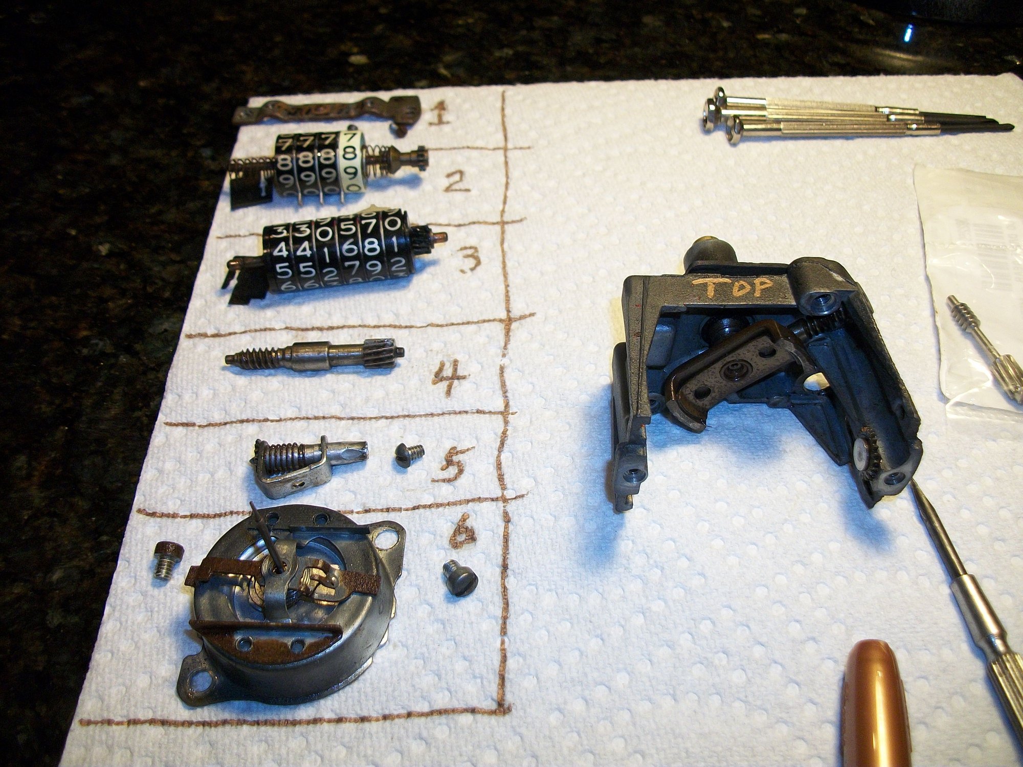

I bought the replacement parts from Willcox.......it was a learning experience, to say the least!

Which parts did you buy? I have done everything on my car and I'm definitely not opposed to doing this but this is definitely new to me. I wouldn't even know where to start.

The speedo is actually fairly straight forward. Once you take it apart it's obvious how it works. There's a trick in removing the speedo needle. Most people try pulling it straight off which is very hard and can bend internal parts. Instead twist it counter clockwise while gently pulling it and it comes right off.
Also, when you put the needle back on, put a piece of masking tape on it and then tap it on all the way with a small hammer. It has a beefy stop inside so you won't damage it as long as you don't whack it hard.
You will probably find the magnet is weak and needs to be re-magnetized. I posted how to DIY this not long ago. Search for "re-magnetizing speedo" and it should pop up.
