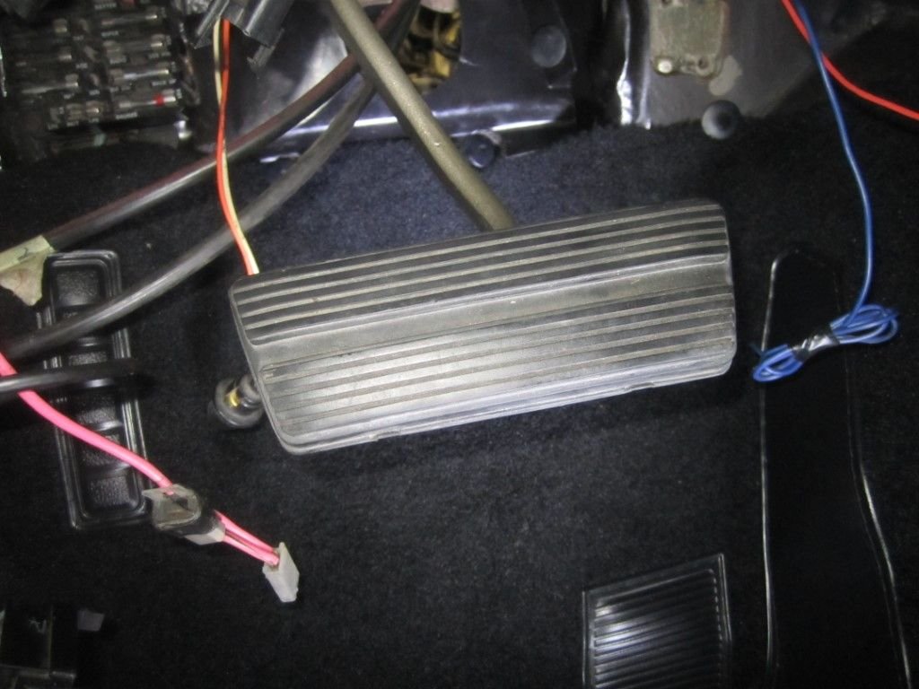

Probably won't help but it's upside down in your picture there.
Two plugs holding the thin in are tucked under the edge of the fuse panel and over towards the go pedal
The two slots in it just clear the two plugs holding the carpet

You can half see it in the background of this picture, the plug over on the right is one of the two really holding it

Thanks Mooser, that helps a lot.
