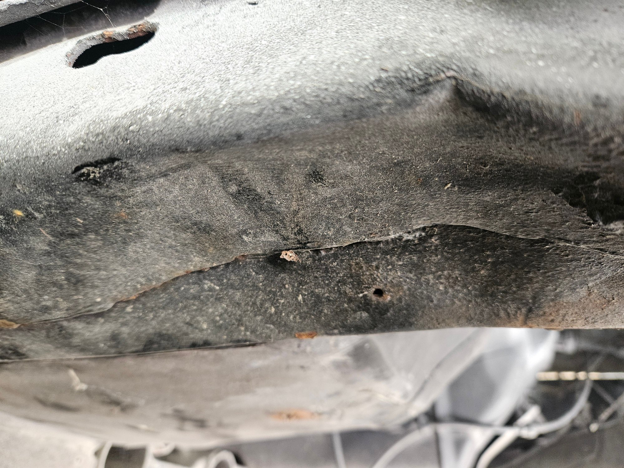

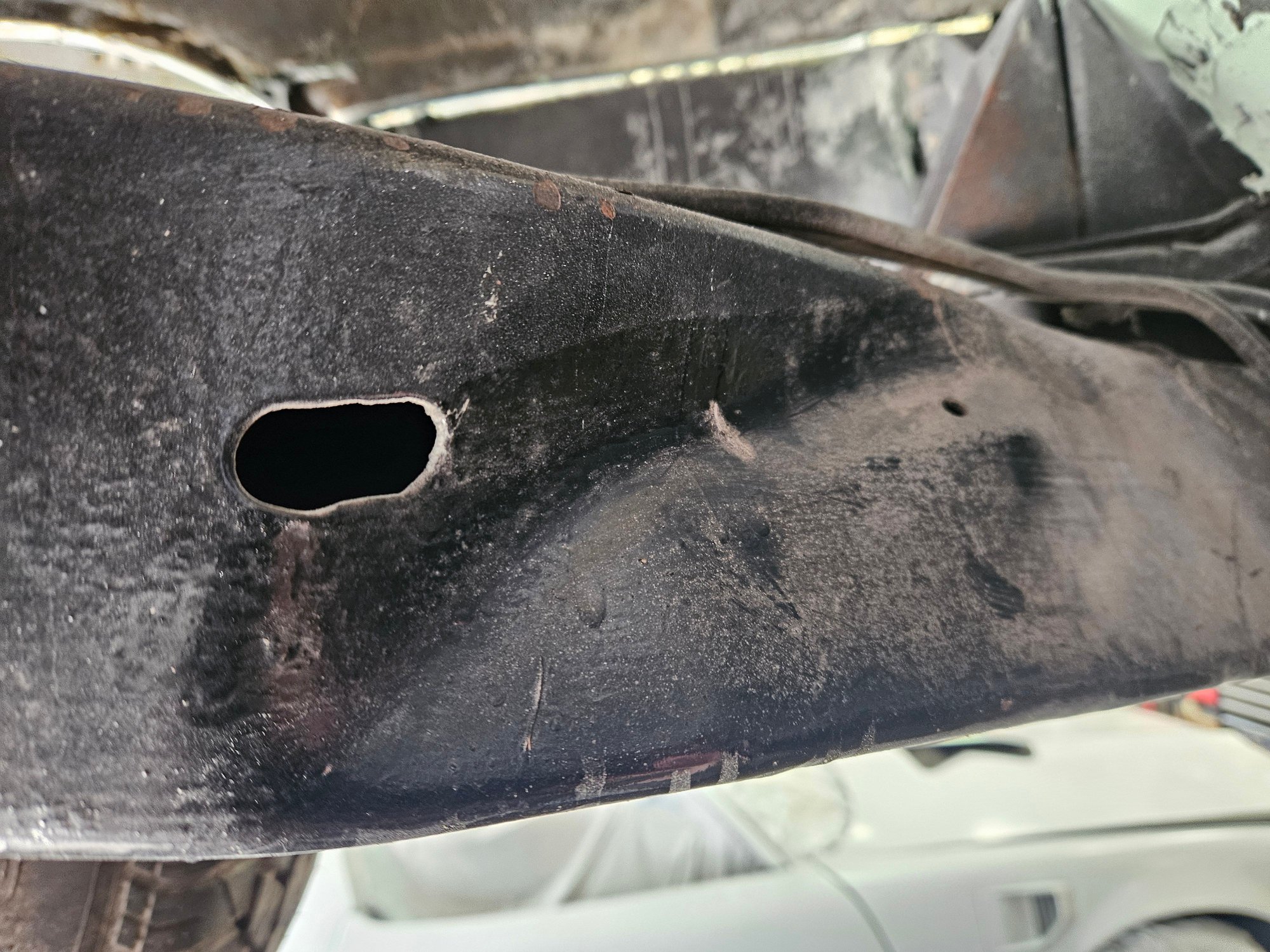

It has a good kink in it. I measured it out for square and level, and it is, but it bothers me. I'll grab a pic of the frame so you guys can see it.

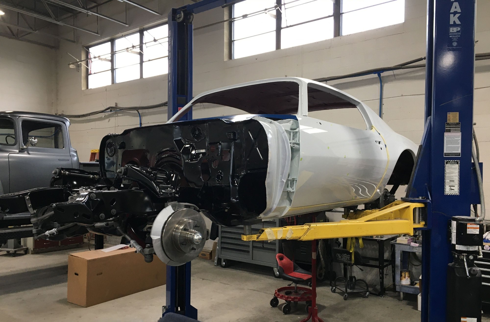

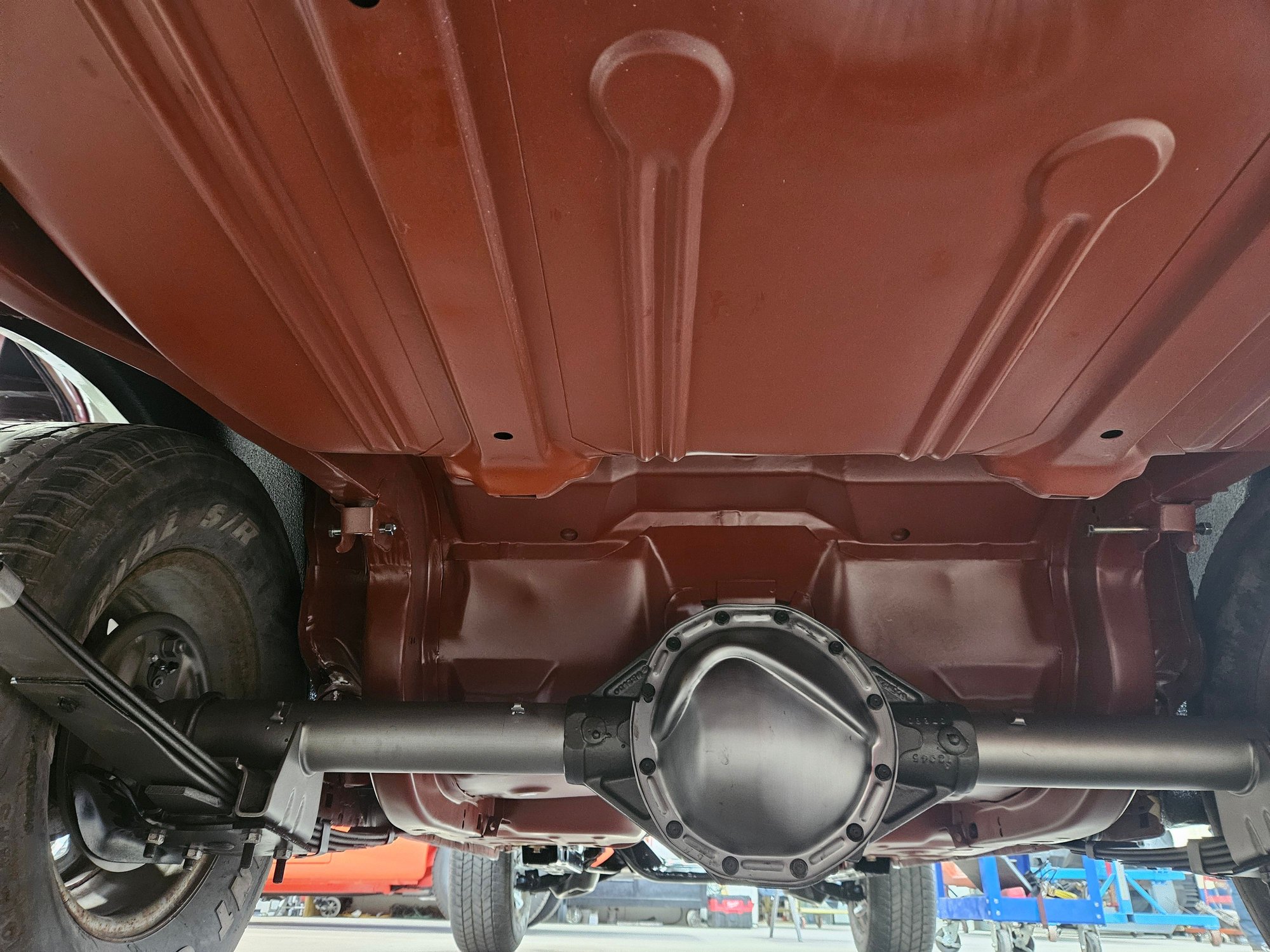

I grabbed a few pics of the frame. She's straight, but ugly as a ****. Also figured I'd give you guys a few pics of the TA progress...

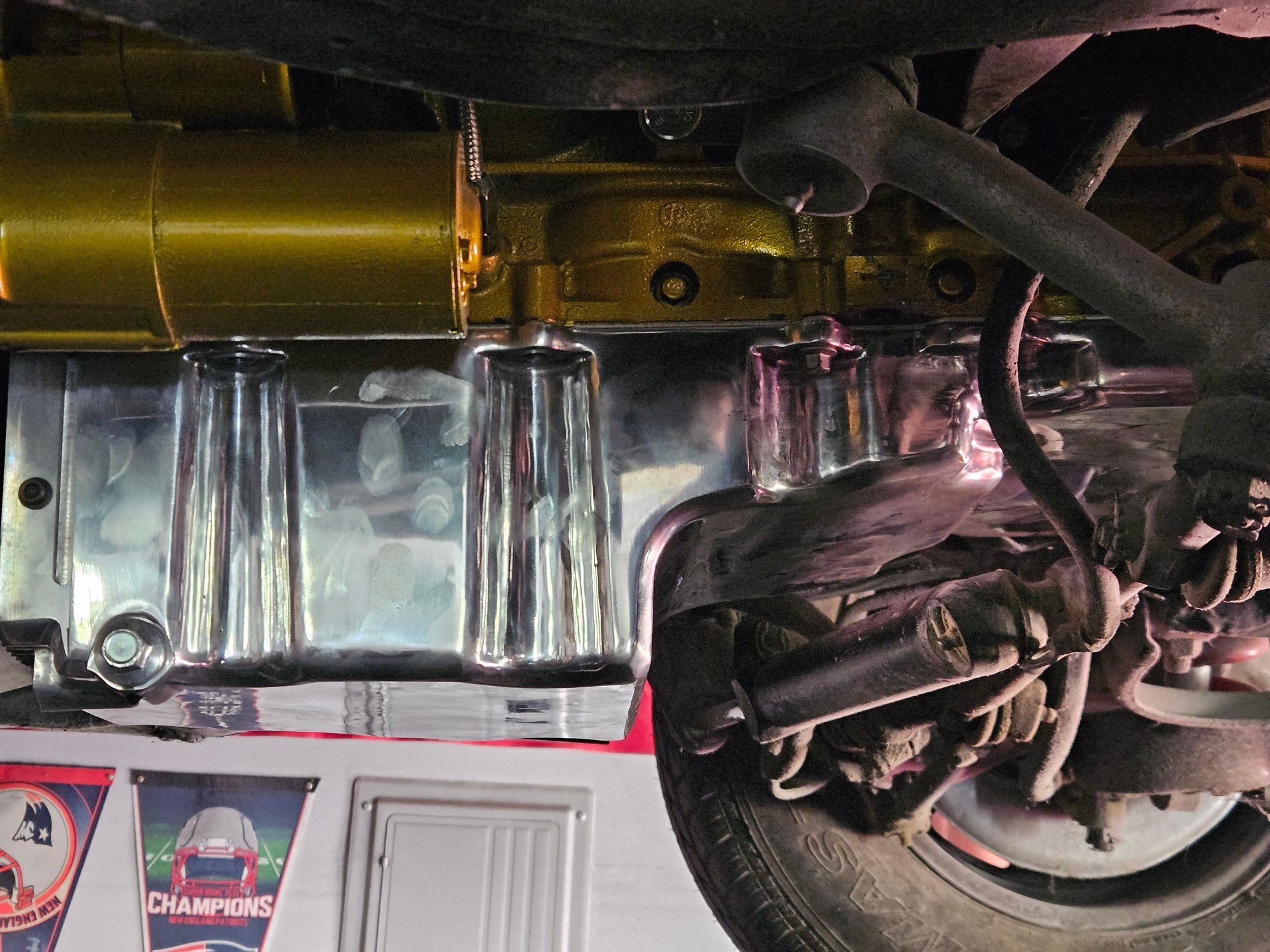

I threw the LS6 and TH400 in it to check various clearances. Looks like everything is gonna clear no problem. I was slightly worried about the alternator placement, but it tucks right in nicely. The hood has more than enough clearance (obviously lol).
Next step is to break it all down and remove the frame. This one is kinda mangled, although measures straight and isnt rusty. That said, I can't build a car like this and have the frame looking like that.

I haven't fully decided on the side pipes. I keep flip flopping back and forth. On one hand, I have the mercury tube fins and heat shields already made (hand built and look awesome), but they'll only allow for a maximum tube diameter of 3", which doesn't give much room for a decent flowing muffler setup. In reality it would probably be breathing thru a 2" hole, which sucks.
Making the fenders exit headers wouldn't be too bad, but being committed to running a 3" collector sucks when the Hooker setup uses a 4" collector and side tube. That allows all sorts of options for free flowing muffler inserts.
