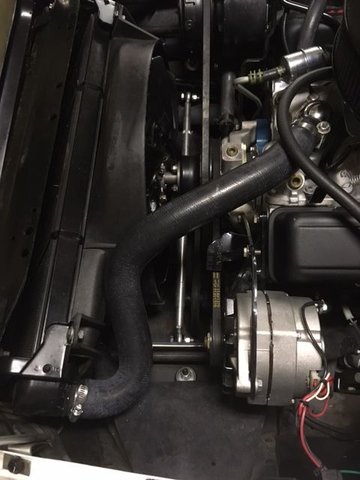

I have the spreader bar from Speed Direct in my '79 with mechanical fan & clutch and A/C. It fits fine. If I can find a photo I will post it later.

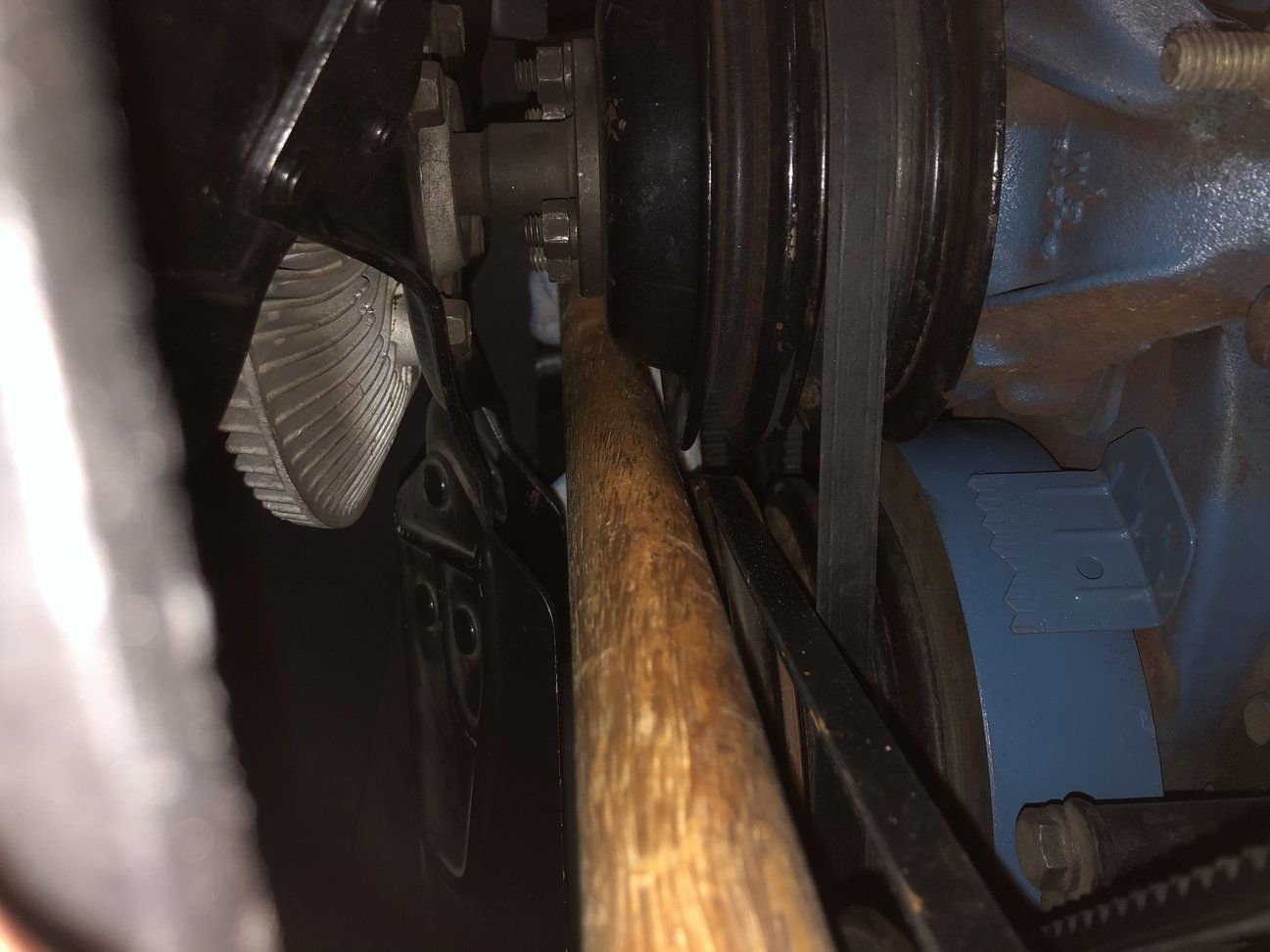

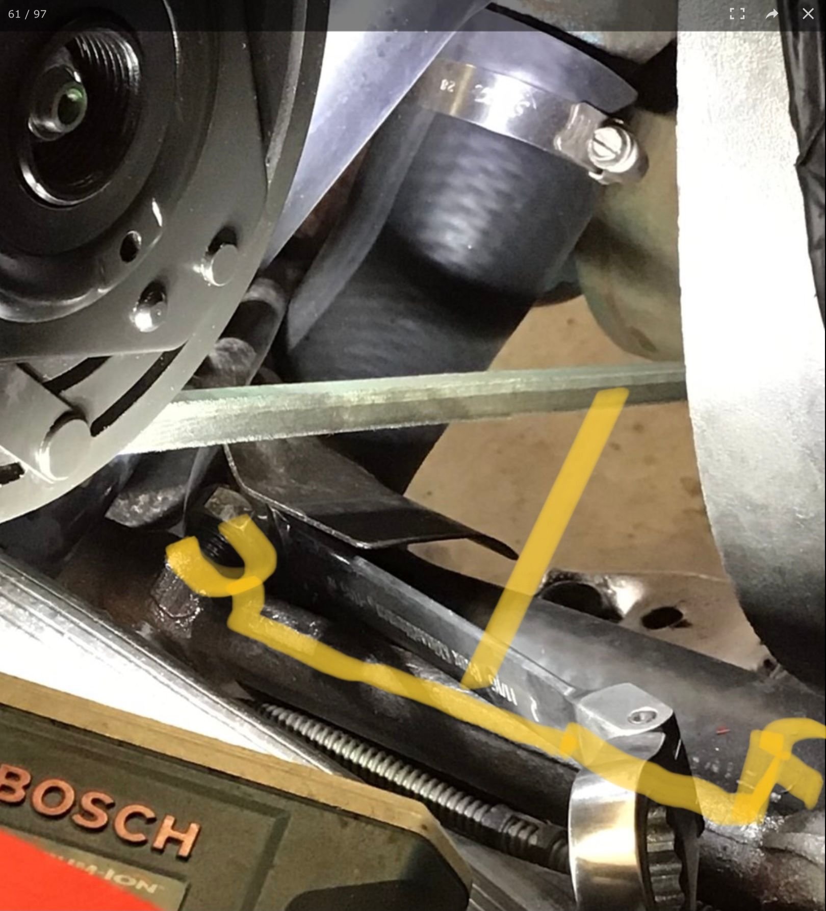

i just ordered from this thread @Richard454 posted.. 40 bucks shipped.. and complete build list.. Speedway Motors..never bought from before but best price and 10% sign up email first order says Sunday delivery ordered last night!
edit...one inch broom stick fits but it is lower than the brace..very tight..added pics...if the bar is inline with bar itwill not fit
i'm thinking i like the u shaped channel to slip into the belt shield side and round hole for other.. then fabbing bracket to clear fan and pulleys best?
@drwet pic may be very helpful on all areas..
ya its tight in there @Bikespace but do not have comparison...the drivers side though should be easier..i really like the idea of NOT using the nuts and just top loading another but.....

Here you go. Speed Direct spreader bar on a '79 with stock fan clutch and A/C:

[QUOTE=drwet;1603349559]Here you go. Speed Direct spreader bar on a '79 with stock fan clutch and A/C:
Thanks!
well hells bells...fabbing my own would not be advisable
may i ask
is belt guard in place?
I have extra pulley for air pump..is yours still there?

[QUOTE=interpon;1603349991]
Thanks!
may i ask
My car did not have an AIR pump and what do you mean by a belt guard?

You have the pulley for the AIR pump, but you aren't using it. Take the pulley off!

The air pump or pulley is not effected anyway from the spreader bar

Thanks all..
belt guard cover the lower rad hose on rear passenger side stud.
good to hear pulley not issue..
tried removing pulley cannot do it fan doesn’t sit right, unless im missing something .
Debating diy or buyng..i like idea of slotting rear side of bracket for easy removal/ install as it is a pita reach

I see the belt guard now in one of your photos. I guess mine is long gone.
