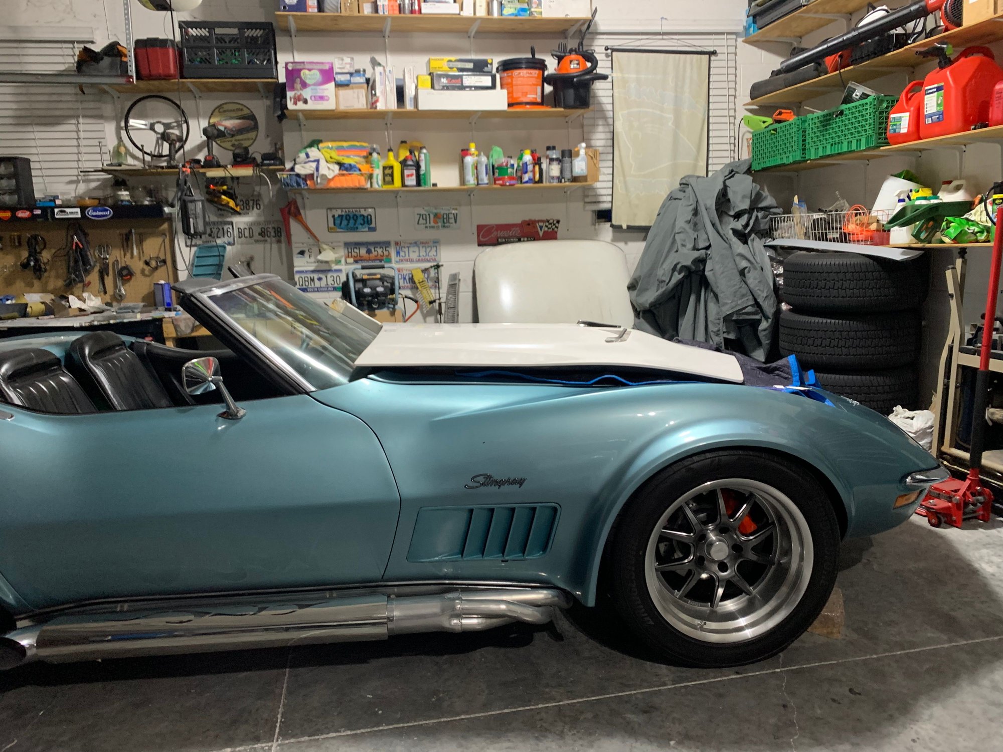

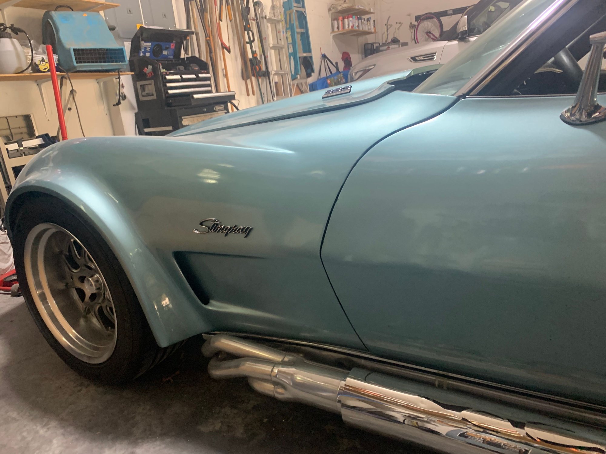

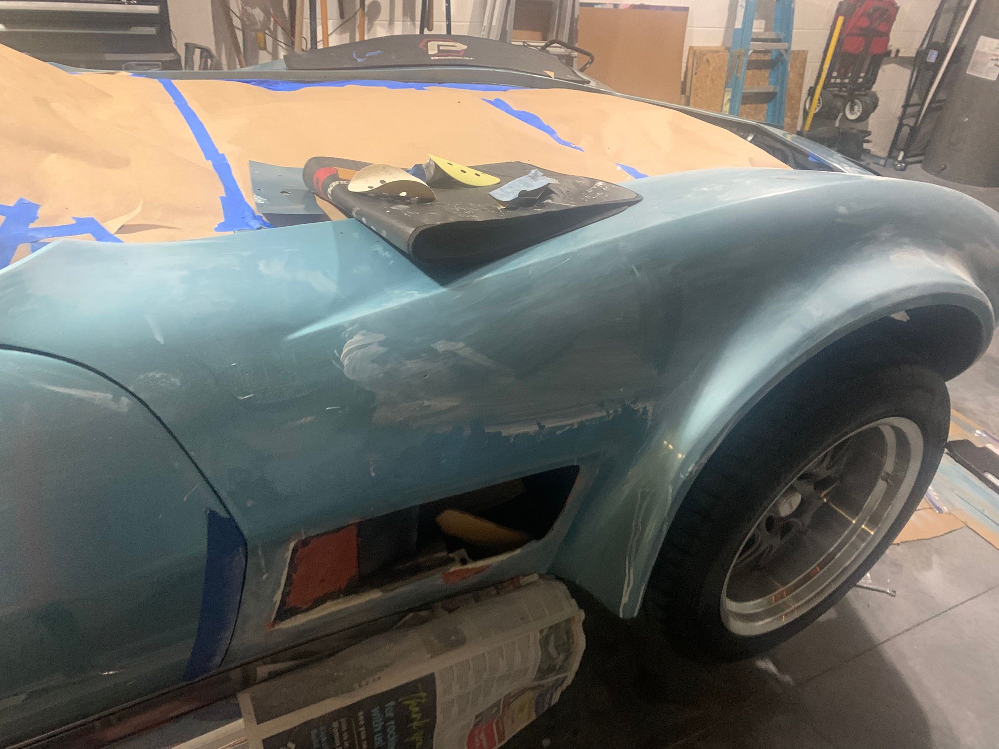

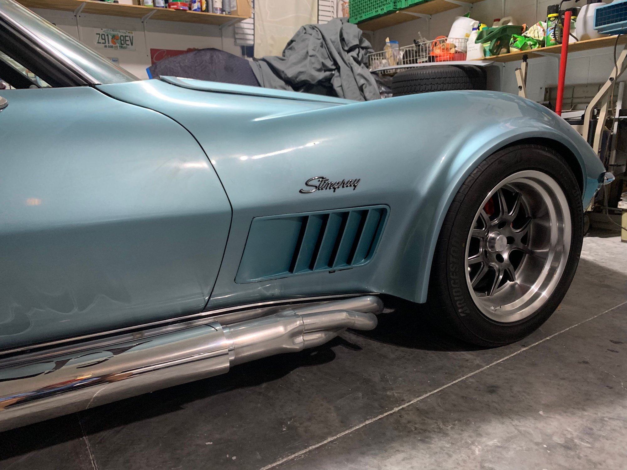

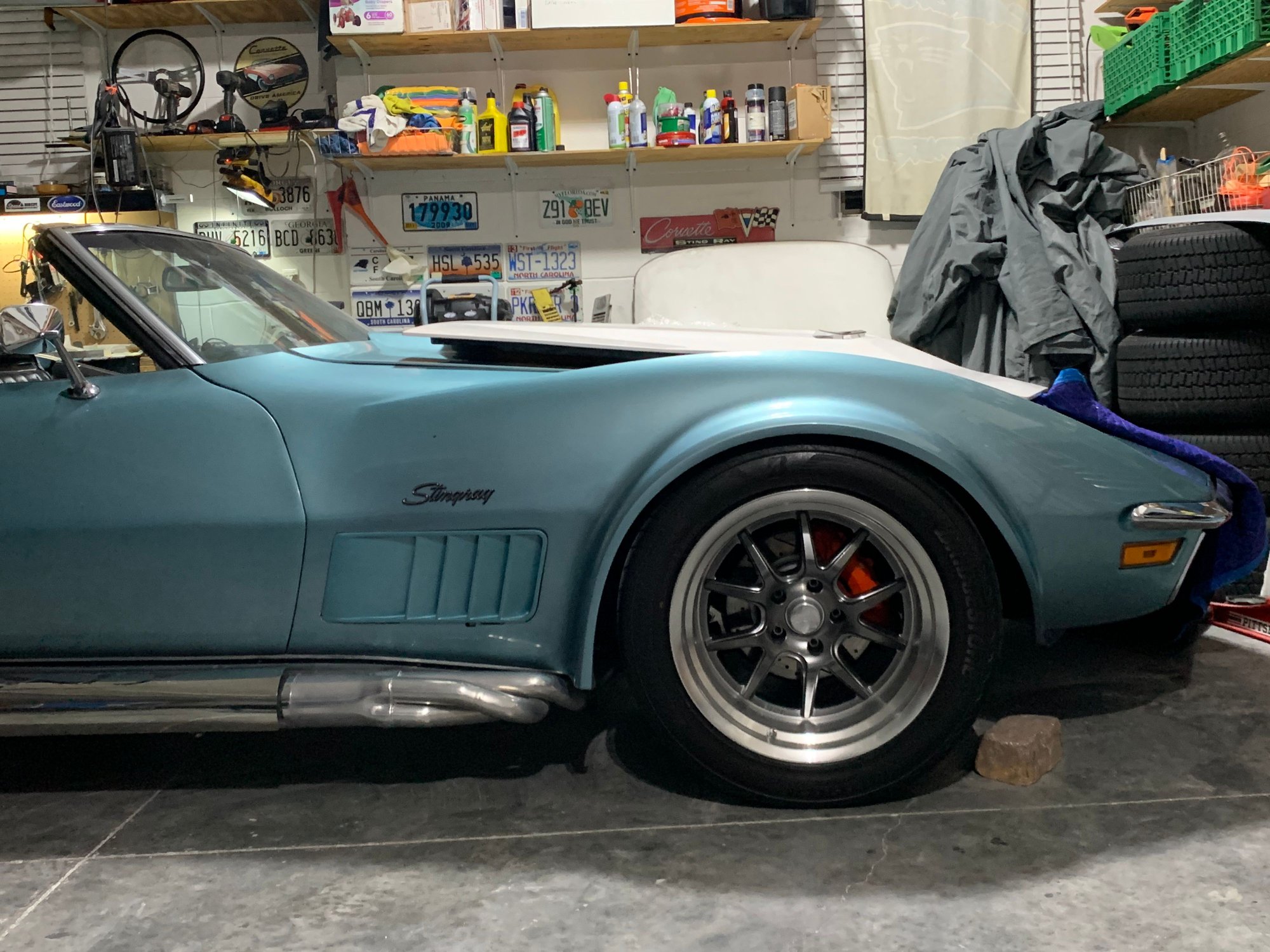

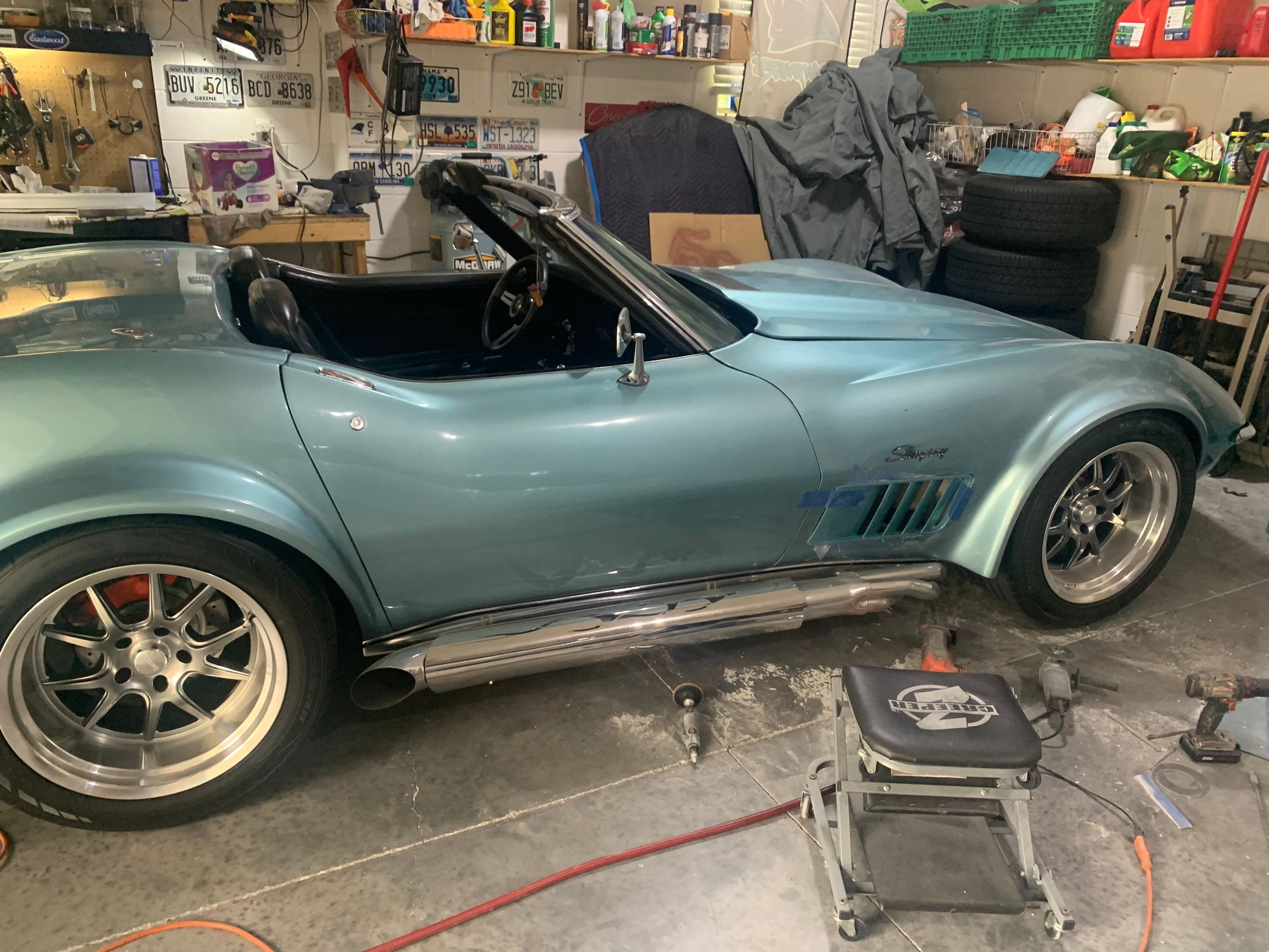

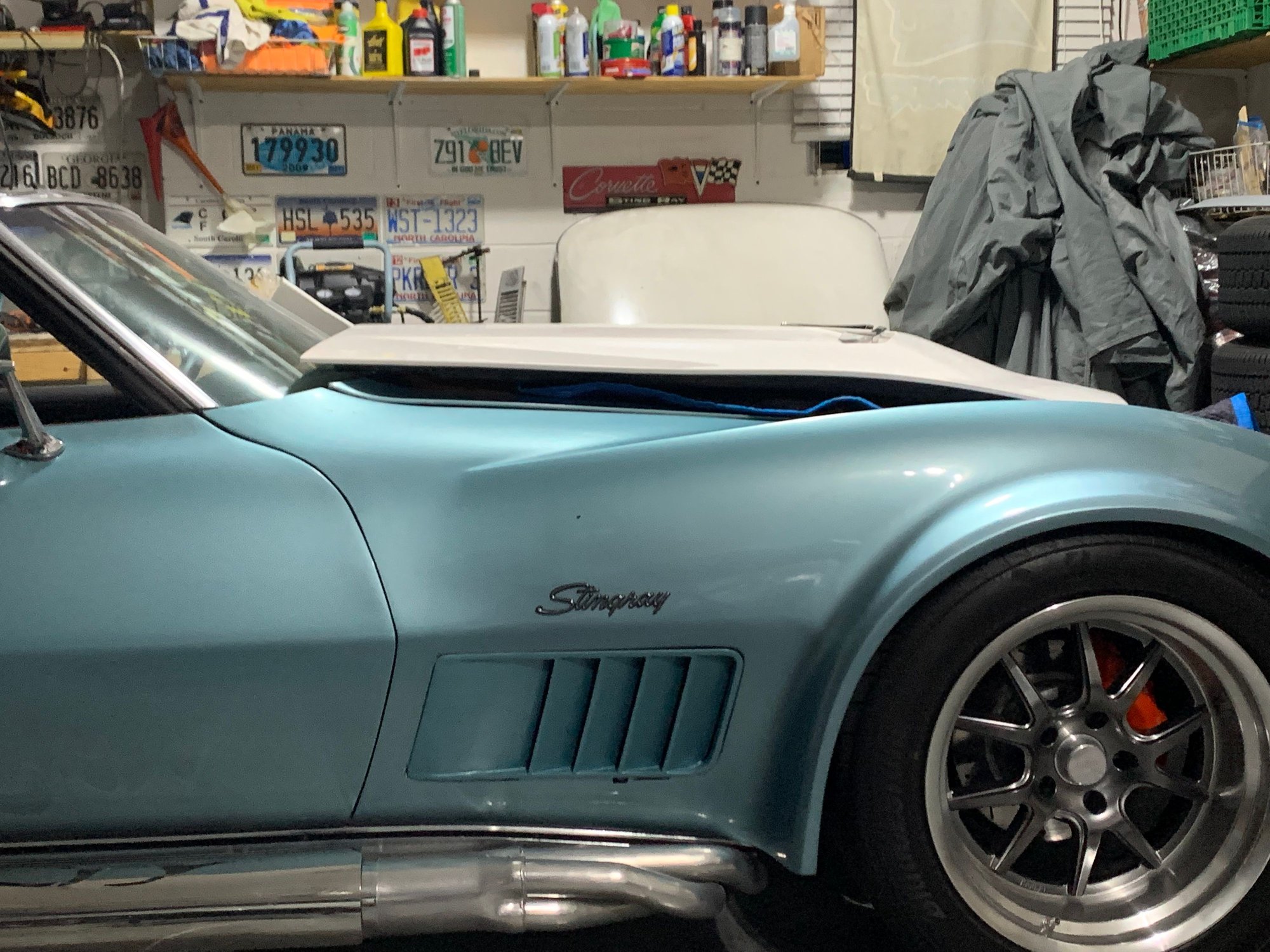

Cut one of the glassed in vents the po put in. Got the modified vent mocked up. Just need to clean up some body work in the fender and find a way to affix them. The po cut off the holes for the 2 screws and stud. I’m really happy with the look.
As the po glassed in the old crates and how I got the car.
Another as is shot.
With the modified vents mocked on.
I think the look is killer!

With no tape holding them up. Lt1 hood coming soon.

Good work....looks sharp....easy access when inserts are removed.
(I had to rebuild missing/broken fiberglass tabs. brackets and such from previous owner "mods" .I always used overkill by adding thick sheetmetal supports=then fiberglassing over the sheetmetal to hide/blend-in the new tabs/etc. per other members suggestions)

I agree. The modifications are very tasteful. Are those Fikse wheels? If not, would you mind telling me what they are? Those are sick!

Rocket Racing Rims

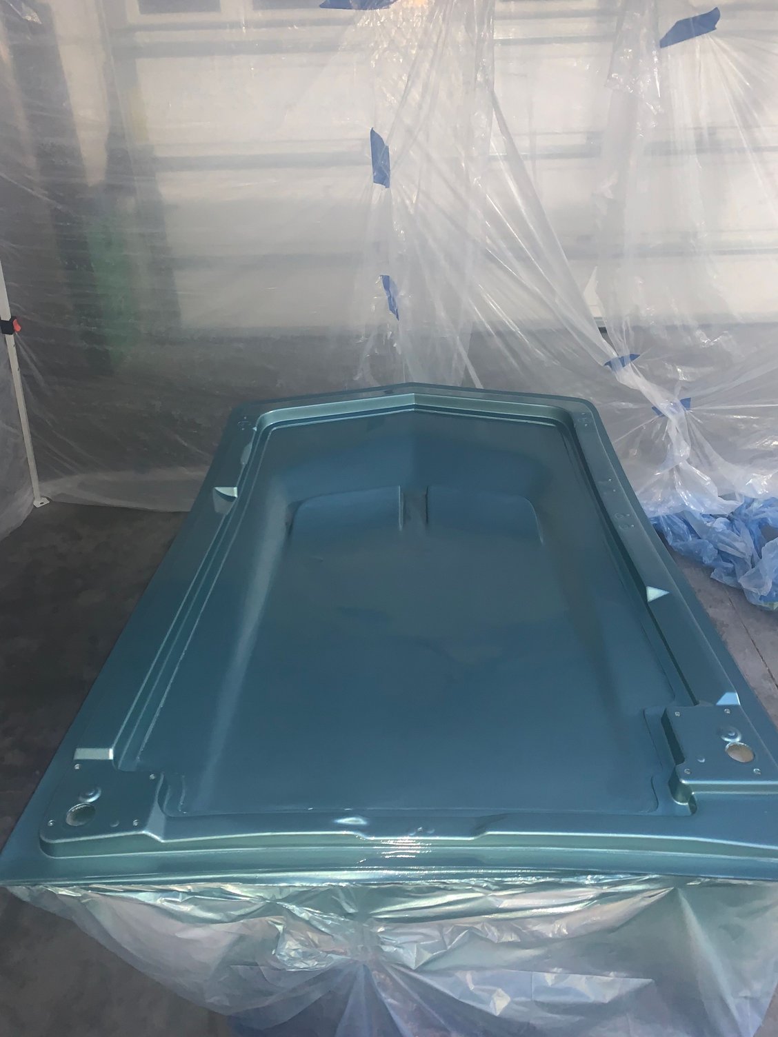

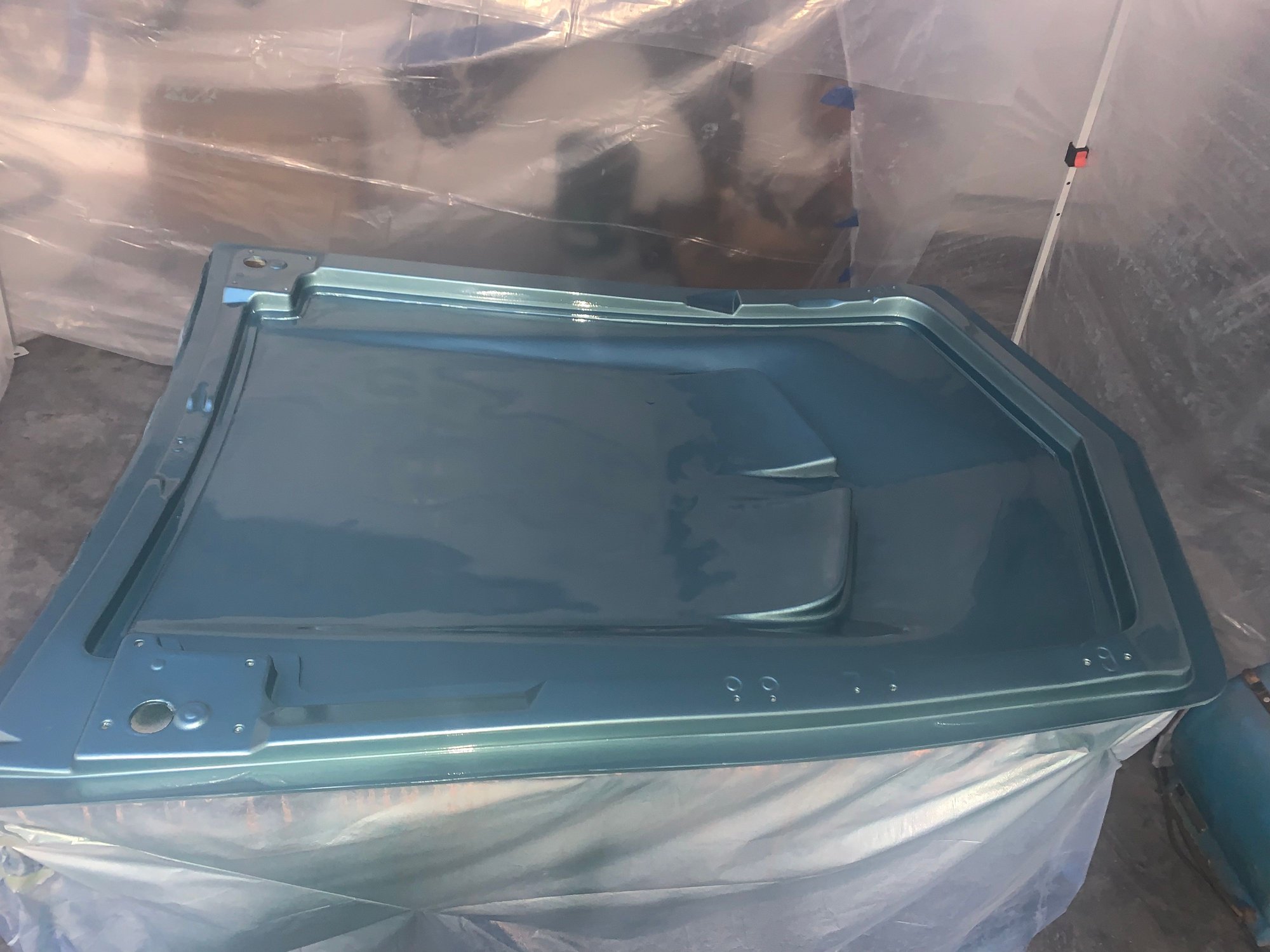

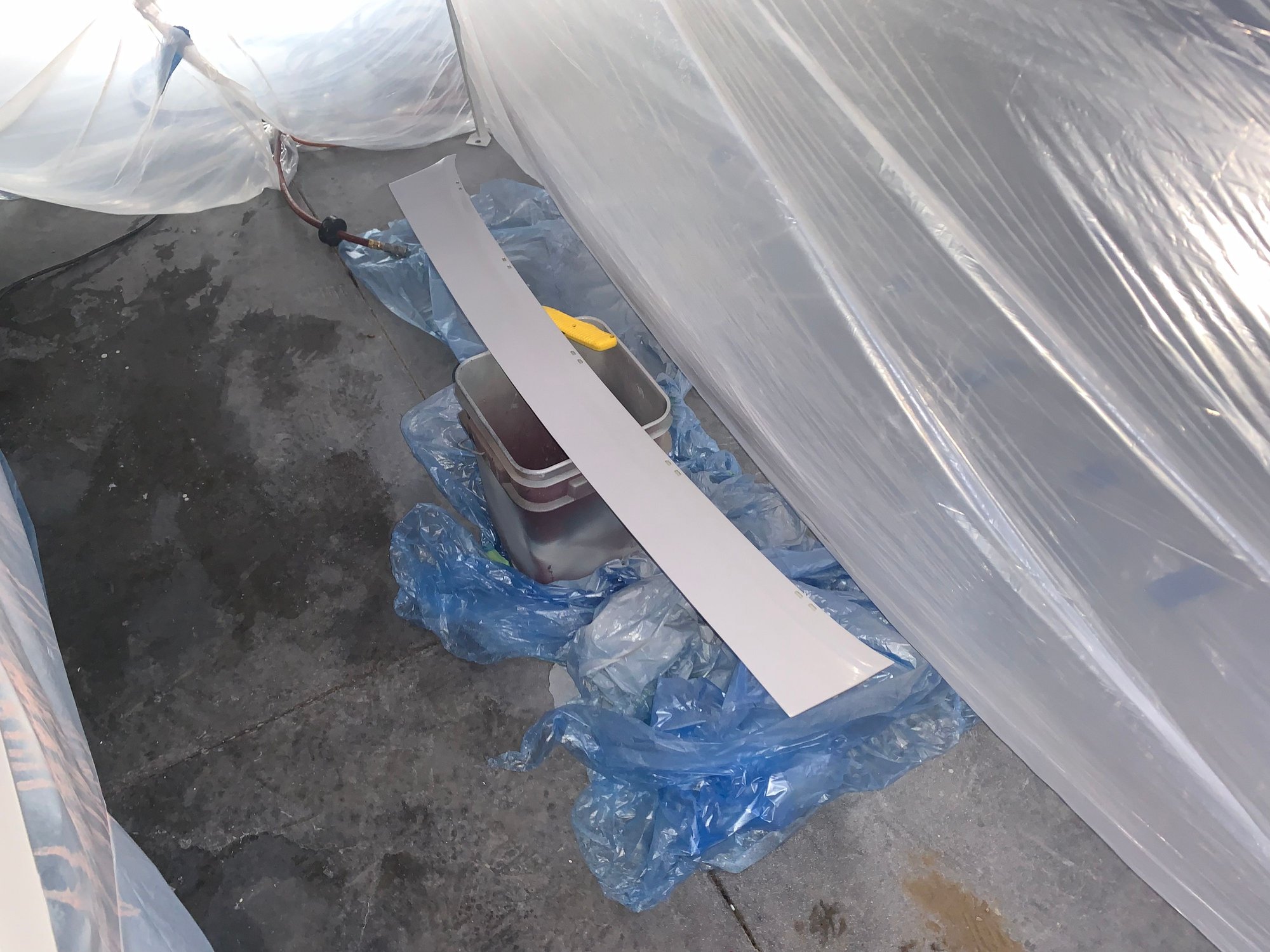

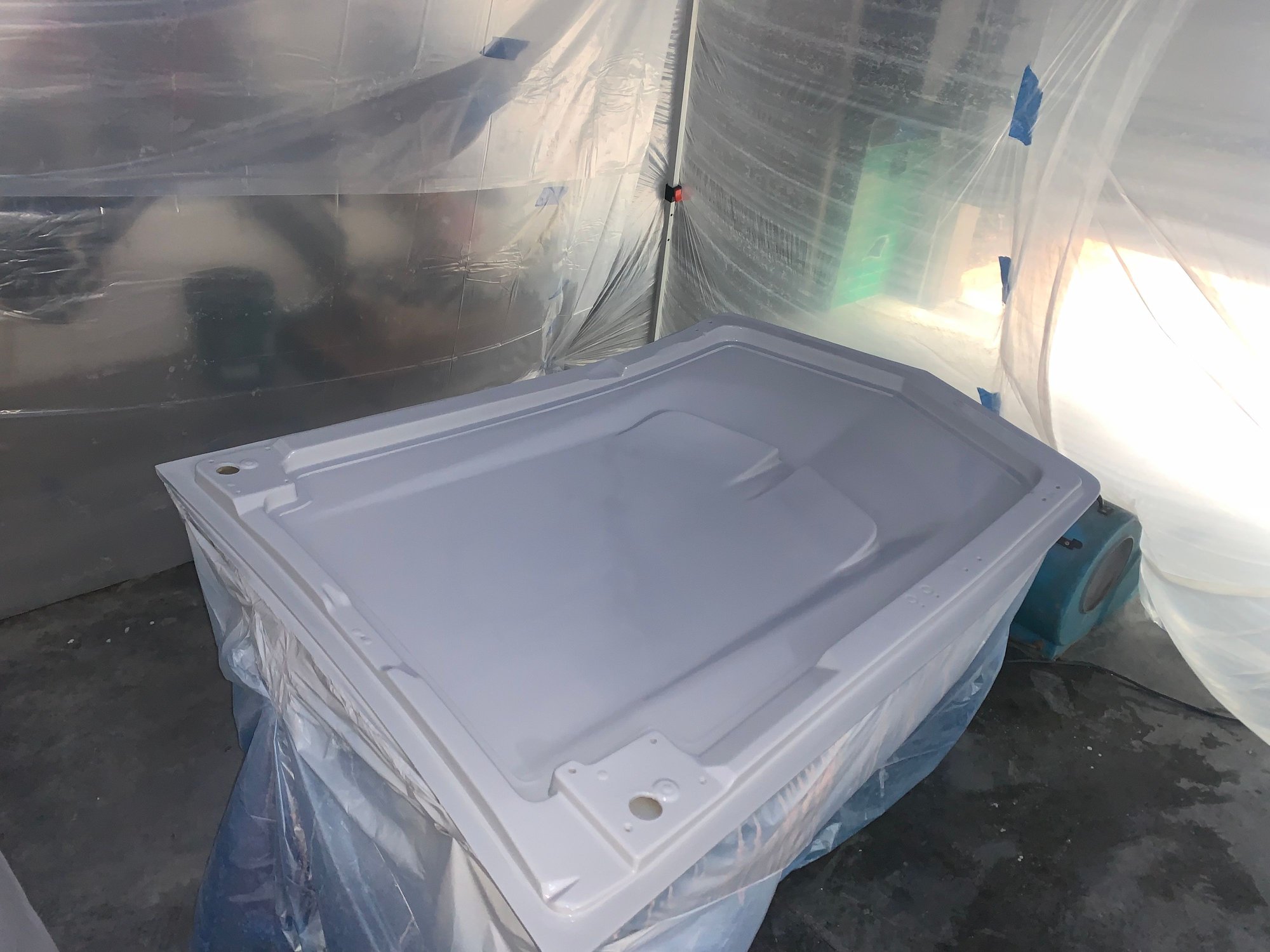

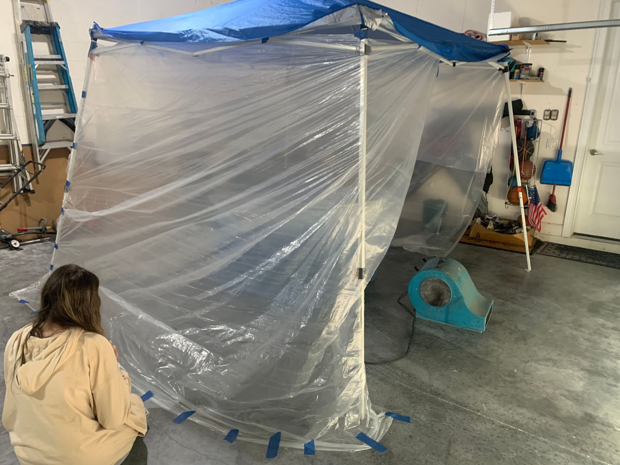

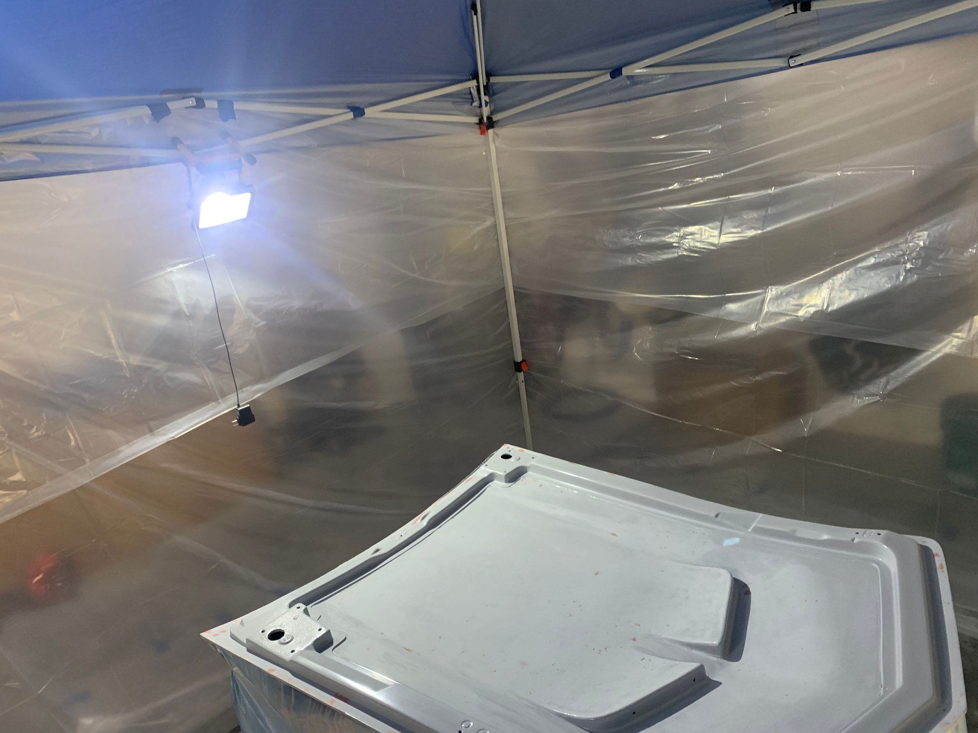

Got the underside of the hood done to gain experience. I’ve never done body work before so I wanted to start with this. I wanted the underside to be finished the same color as the car. A LOT of body work went into the underside of the hood as it was made with a rough fiber glass finish under underneath so I had to spend hours smoothing it out with filler and sanding

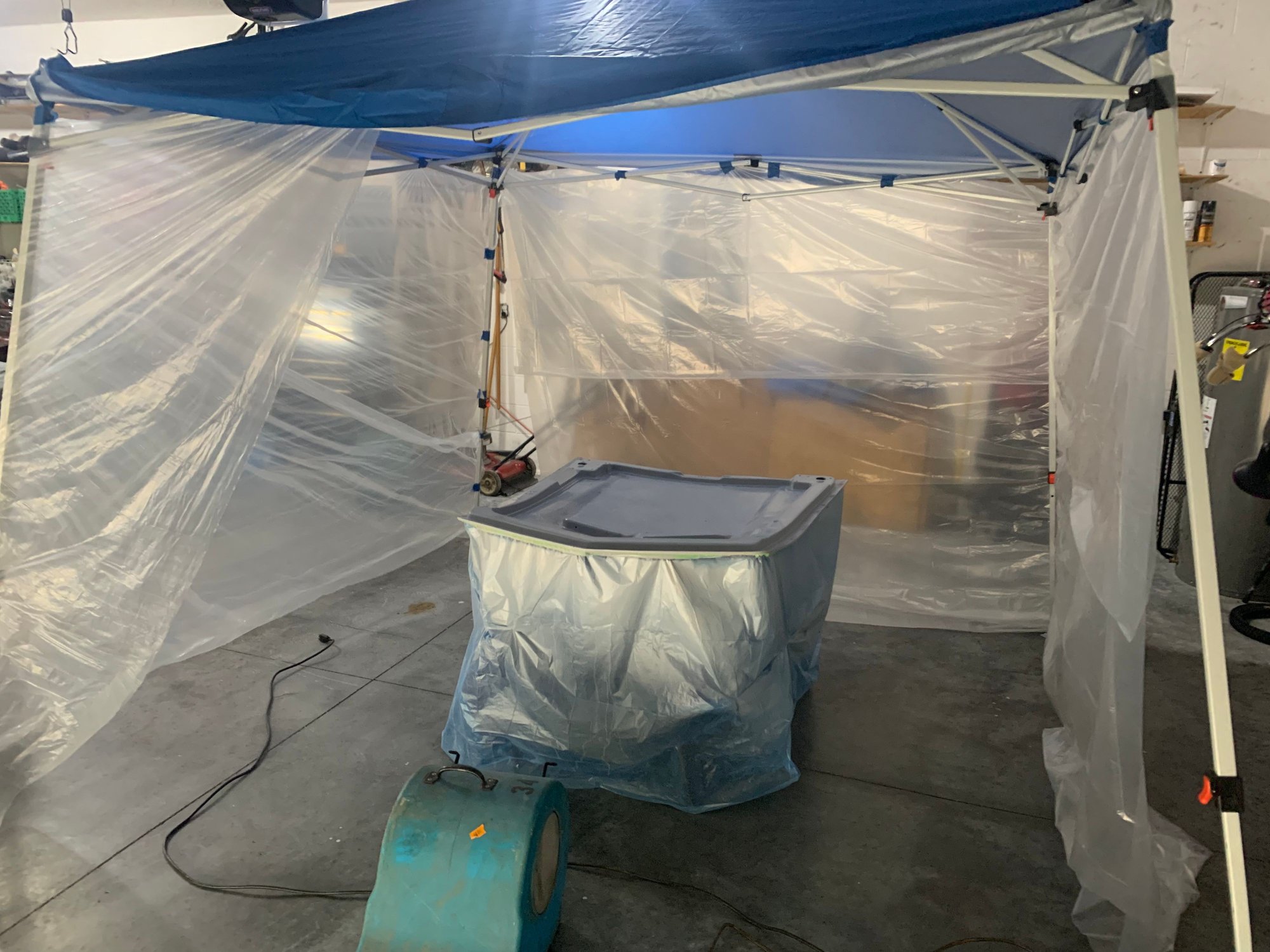

Setting up the home made booth
Use a blower fan to create a vacuum environment
Right before the primer-sealer coat
After primer
Wiper cowl after primer
After 2 basecoats and one clear coat
With 2 clear coats

Been about a million years since I did bodywork for a living, but we used to wet the floor of our spray area down, to keep dust/dried overspray from being blown back up onto the paint surface.
Old Nov 27, 2022 | 05:24 PM
nwav8tor's Avatar
nwav8tor
Old Fart Pilot
Joined: Apr 2010
Posts: 1,920
Likes: 990
From: Spokane, WA
Nice little booth set-up with the exhaust fan. What, if anything, did you use to filter the air intake into the booth?
didn’t have one for intake. But honestly didn’t get many issues at all. Used tack rag between coats and turned pretty good for first time. I am going to sand back down and respray. I didn’t like the color match so much.

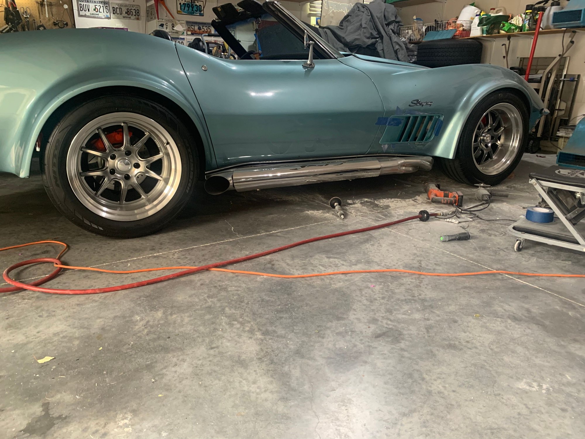

No pictures to show but I’m still working the body. One panel at a time. Then I will sand with 400 then primer. Then sand again. Then sealer and base/clear. I’m doing this in 4 parts. I’ll post pictures as I get through all this.

I’m also going to try a intake fan with a filter duct taped to it to improve on the booth set up. Does anyone know if the intake fan should be set up high or can it be on the floor? Should there be a stream of air over head the panel to keep trash from falling down?
Old Dec 6, 2022 | 12:07 PM
  #36
Rescue Rogers's Avatar
Rescue Rogers
Is my vette stock?? HAHA
Joined: Oct 2015
Posts: 20,211
Likes: 9,350
2016 C3 of Year Finalist
I would put it up high since any dust and dirt will already be on the floor

Good idea. I wonder if it even makes a difference and if I should just keep using exhaust fans only.

The professional booths I'm familiar with exhaust air out. They are completely sealed except for where the air comes in, and that intake is filtered. There are also filters right before the exhaust fans.

Good to know. I think I’ll try another fan opposite the exhaust to bring ajar in and have a filter on it.

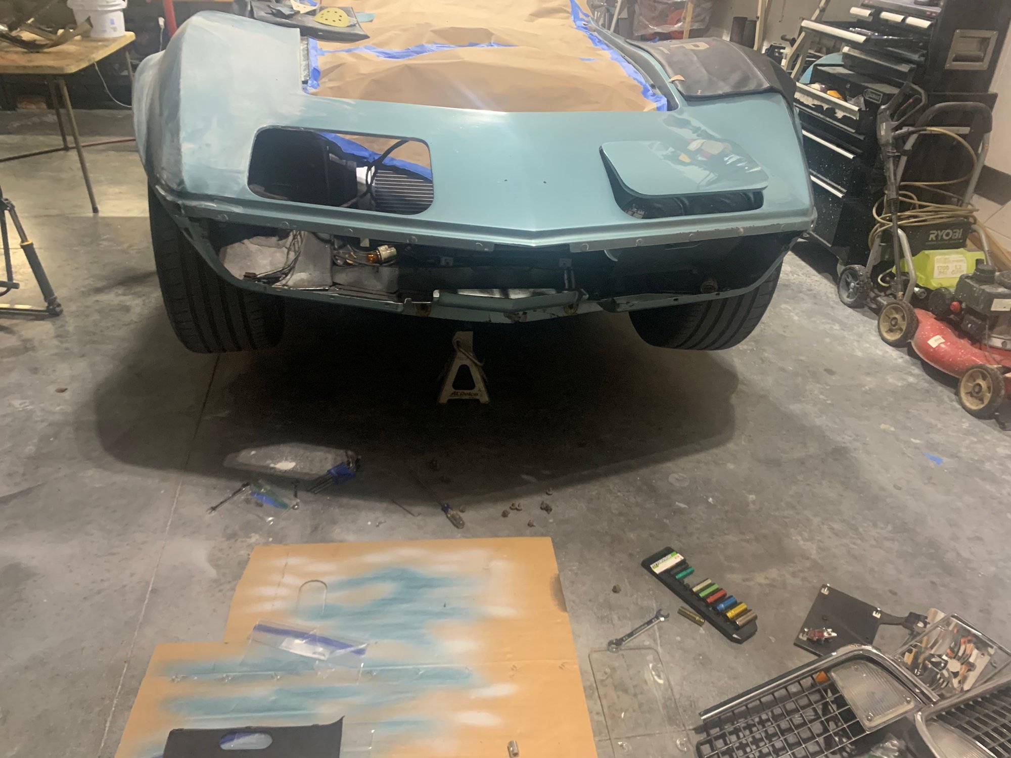

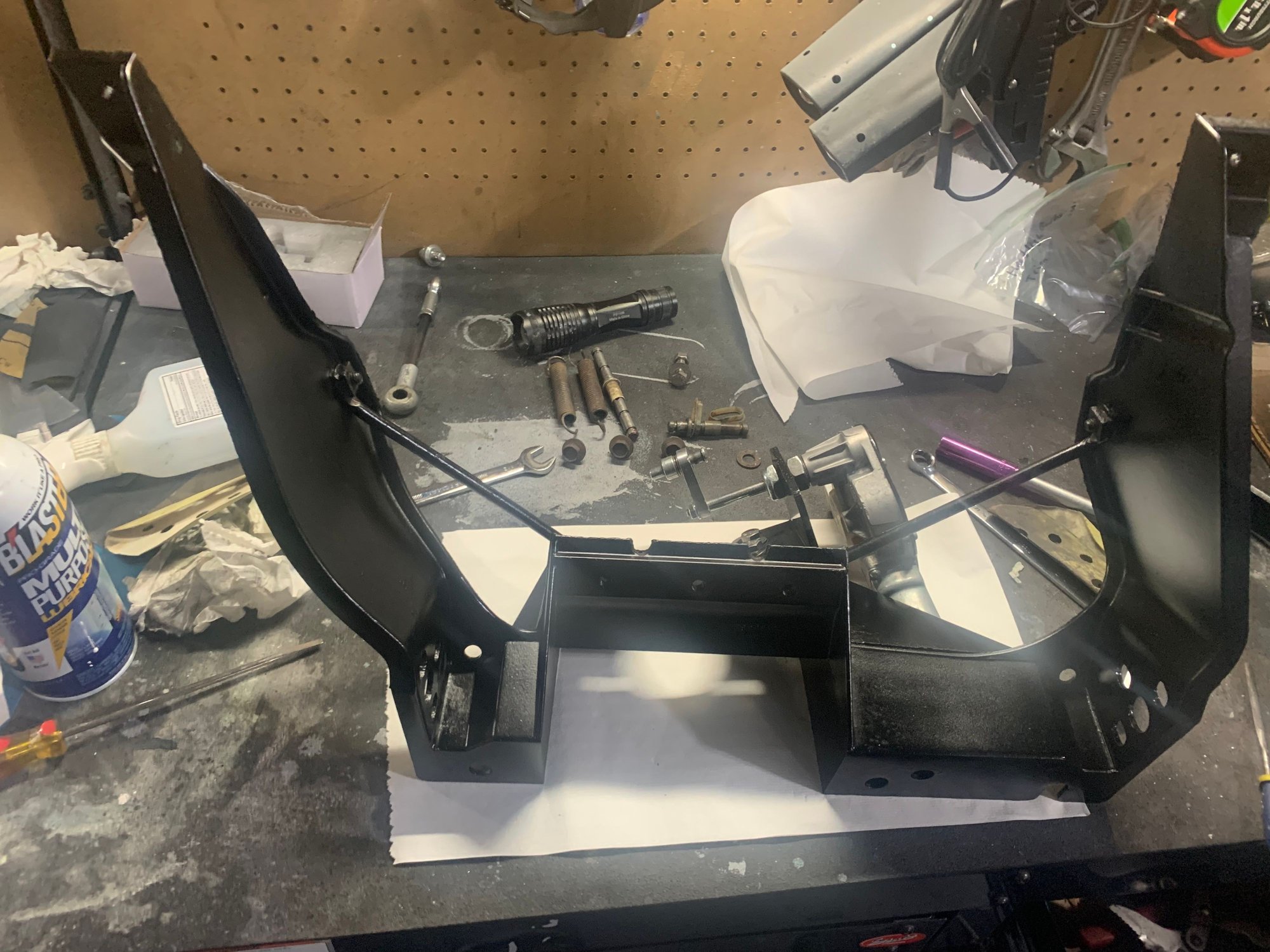

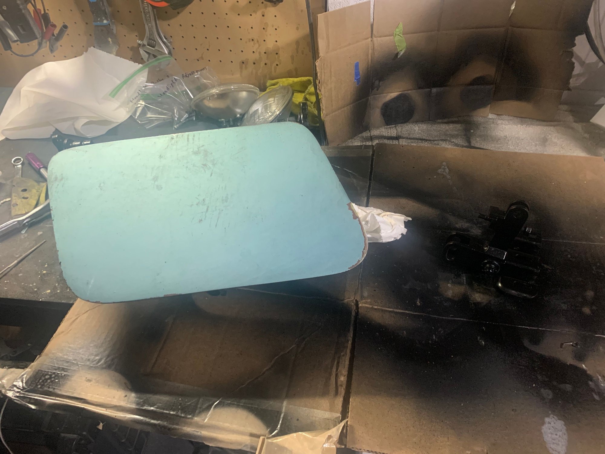

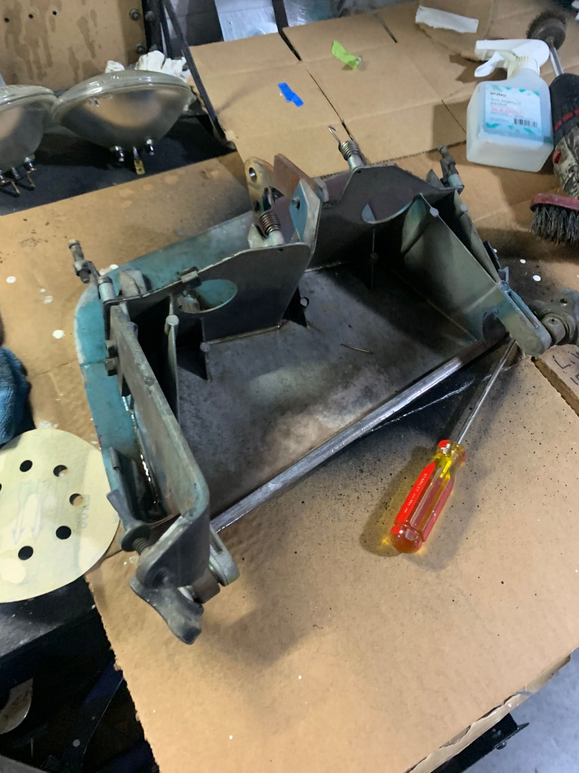

Working on the respray. Cleaning up and refreshing the head light assemblies.
