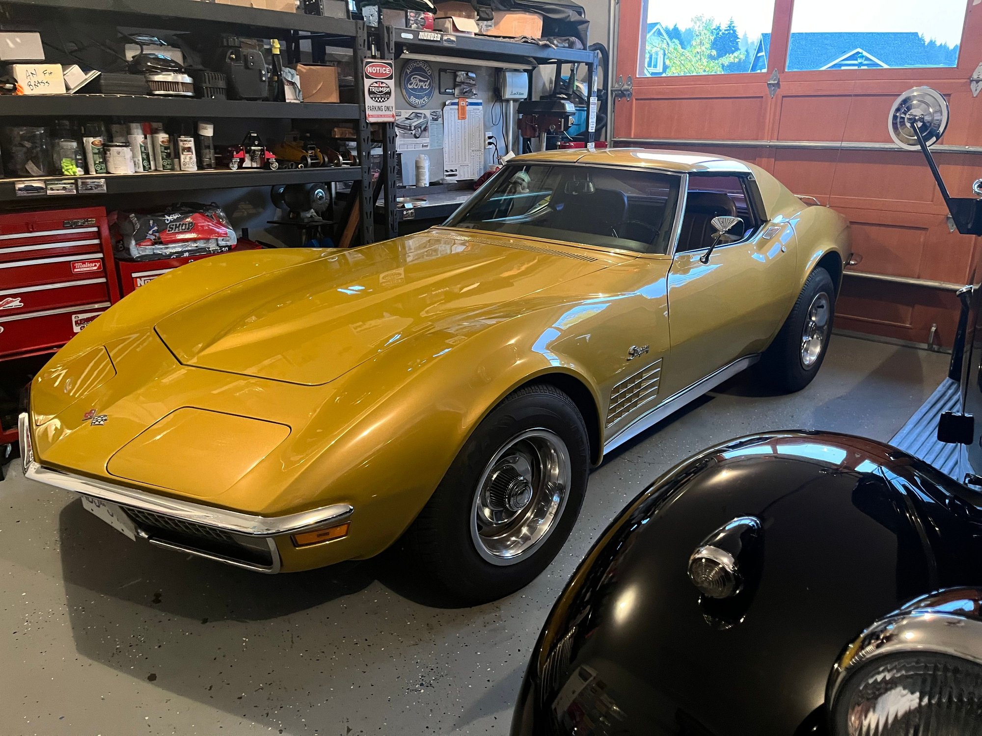

Nice!
Warbonnet Yellow?
I love that color, but I’ve never seen one in person so I didn’t paint mine that color.
Instead I went with Safari Yellow
Now that mine has just come home from the paint shop, I’ll see several this spring and wish I would have painted mine in Warbonnet.

Nice!
Warbonnet Yellow?
Yup, war bonnet yellow with a saddle interior. Depending on the lighting it varies between yellow and gold.

Beautiful!

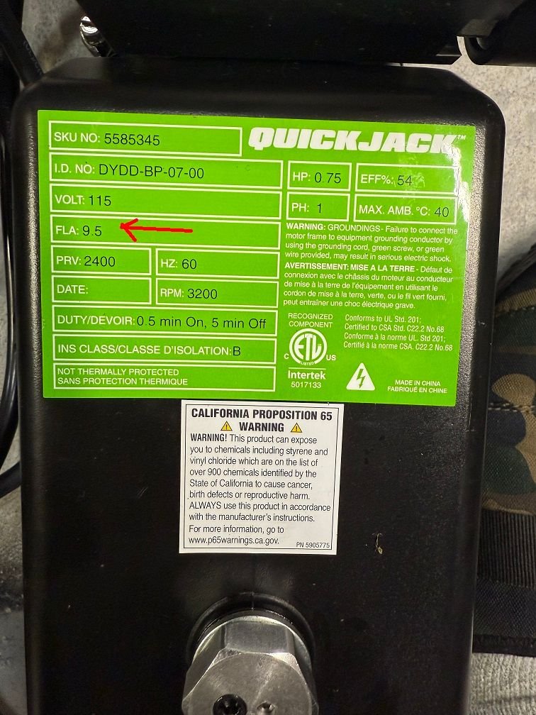

I just got my 5000TL and am in the process of putting it together. It has a standard NEMA 5-15P plug on it and the Full Load Amps is well within the range of a common 15 amp circuit. A 125V 30A plug is physically different as is a 20A. Maybe you have a different model? IDK - that just sounded strange to me.
The directions tell you sealant is adequate but also tell you that using it with tape is fine and they show you how to do it and why. I lurked and read all the problems about leaks and when my turn came I used common white teflon with their supplied sealant, being very careful to keep both off the first thread of the fitting. Having a HALT: WAIT 24 HOURS before proceeding is just silly, they should just send you the hoses assembled, seems like it would have saved everyone a lot of hee-haw, themselves included.
They'll be dry enough to use later today. I won't be dry as I am getting together with some friends and beverages and won't be fiddling with hydraulic equipment today.

I pondered about the fitting also....but what I wondered was --- why not?---- instead of pipe fittings requiring sealing, not just use AN fittings (or generic equivalent) ..... those fittings sealed wonderfully without requiring anything more than "normal" tightening.

When I ordered my 5000TL directly from Quick Jack, they asked if I wanted it with the 120vac 15amp plug or a 220vac plug and I went with the 120vac standard plug.
The reason I received a total of 4 boxes with my order, is, I also ordered the truck/suv adapters which were packaged in a separate box.

Ah, just to clarify, I wasn't referring to Quick Jack. I was referring to this other lift by Capital Automotive Equipment that was interesting because it has a much higher lift and you just drive over it. But, CAE were the ones that said their pump needed the 30A circuit or a 220V 15A circuit. Right now, that's kind of deal breaker for me.
You're right, 30A would definitely need a different plug:

No issues whatsoever running it off 120. I don’t really see why you would need more.

I’m sure 120vac will be fine.
They just offer it for both 120 and 220.
Maybe their commercial customers prefer 220???
