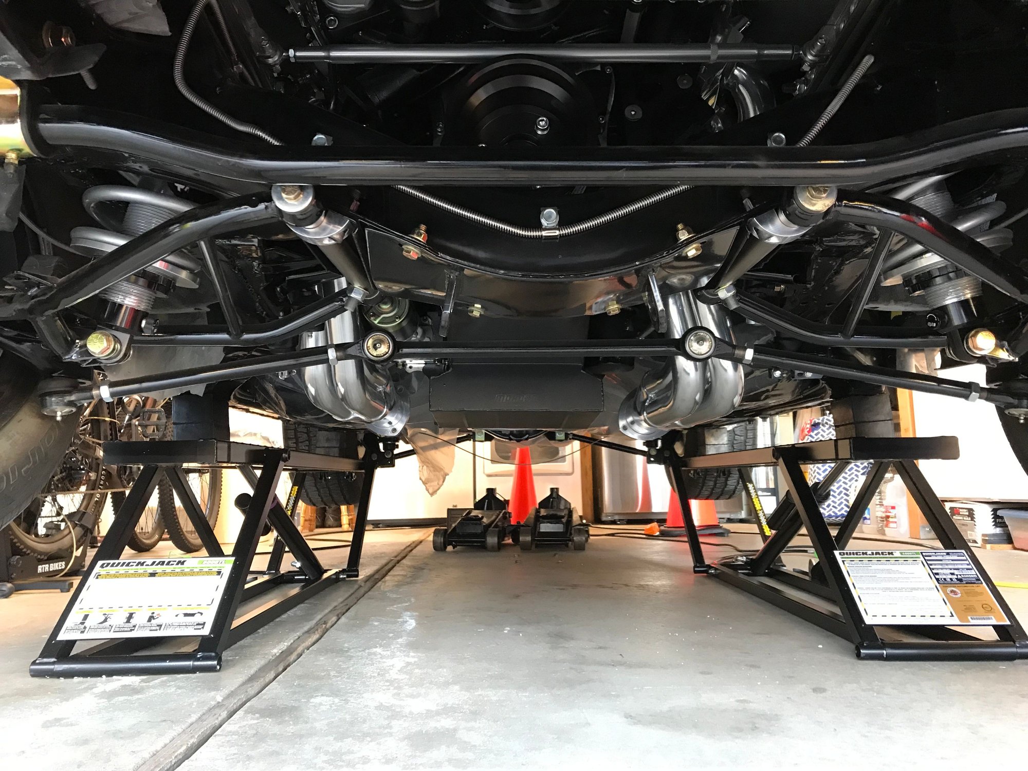

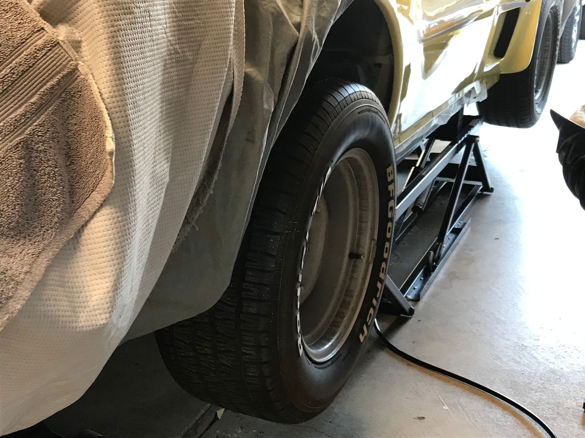

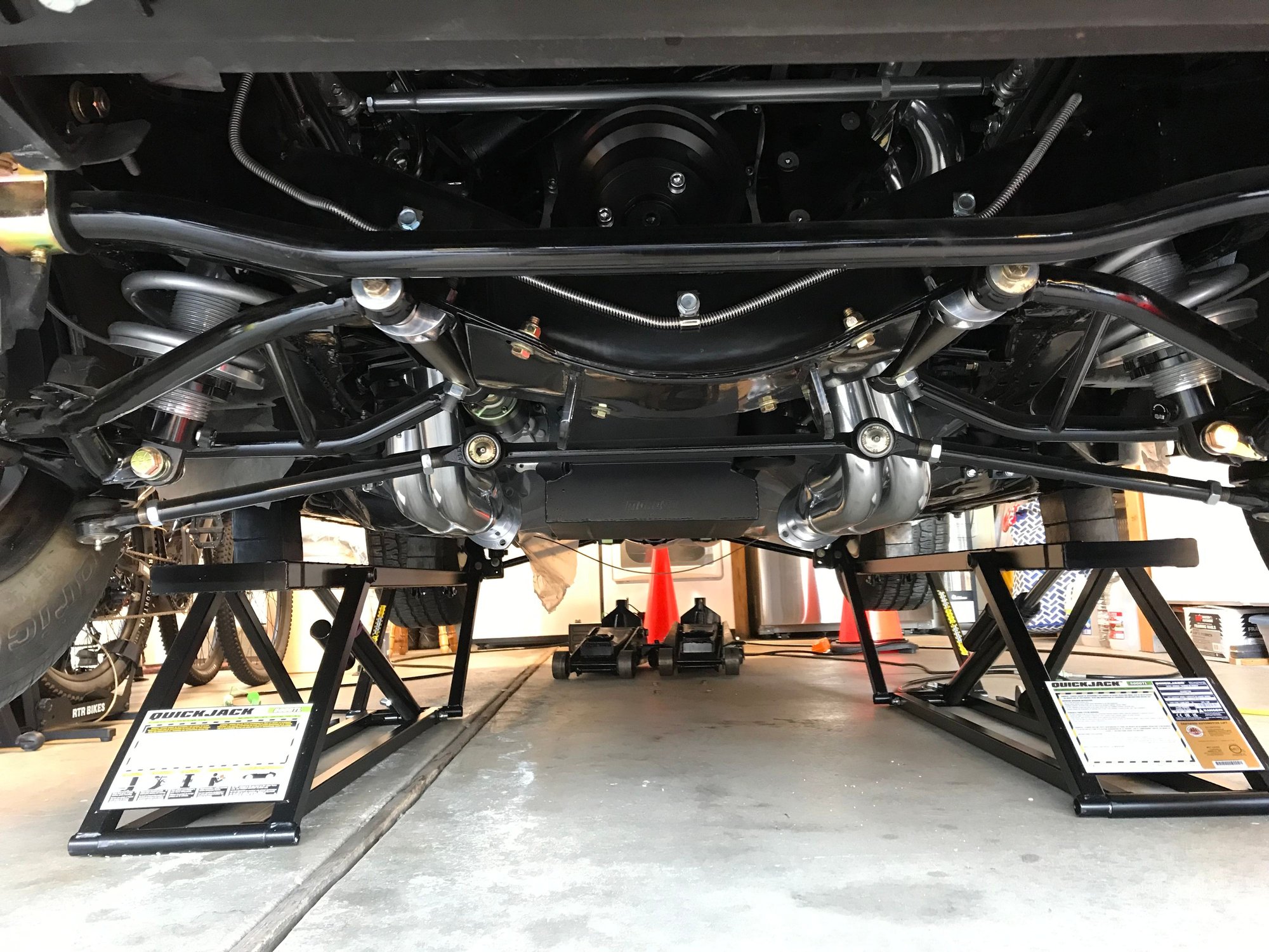

It took me a few days to put it all together and test it all out.
First I had to move our road and mountain bikes that have been hanging over the top of the car for needed overhead clearance.
Today I slid the frames into position, adjusted the blocks and did the maiden lift of the car.
So nice, easy and smooth.
I only raised it up to the first position and found there was lots of space.

Do you have the rubber blocks "double stacked"? It seems that way. I would not do that after viewing youtube videos where the come flying out.
Kinda surprised you can even squish 2 in there! I do NOT think my car is lowered but I would not be able to squish 2-stacked in there.

After doing it I could see where they could pop out.
If you notice in the pictures you can see how they are not straight.
As soon as I saw that I dropped the car to the ground and thought never again.
I had the car on wheel dollies when I lifted it and removed them when I lowered the car.
I could not remove the front blocks double stacked, so I had to jack up the front with a floor jack to remove the blocks.
Another reason to just use one single block.
