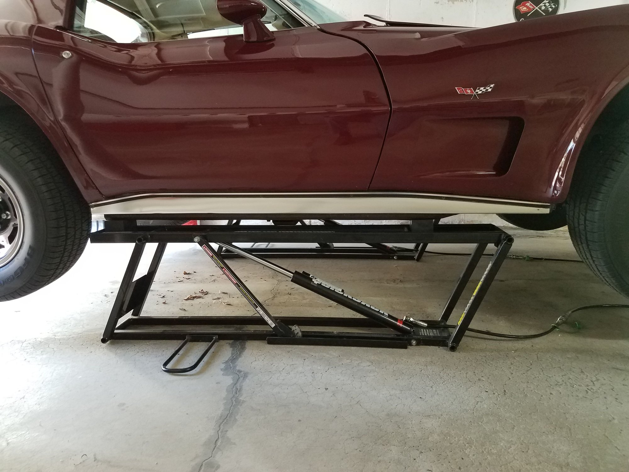

I’m getting ready to start the assembly of my Quick Jacks.
Are you using Teflon tape and sealant on the O ring fittings or just on the fittings without O rings?
Has anyone tried just using Teflon tape without the additional sealant on top of the tape?
What about the two -an 90 degree fittings?
It’s always been my understanding that you never use any type of sealant or tape on those threads.
Old Jan 3, 2025 | 07:47 PM
  #74
carriljc's Avatar

The AN fittings do NOT need any sealant.....just ensure the seating surfaces are clean.
My suggestion:
On the Non-AN fittings use both Teflon Tape and Sealant let them dry for ~24 hours....... no need to re-invent the wheel and have to do it over again. Don't specifically recollect if I used the tape & sealant on the O-ring fittings...... I can you look if you want me to...I suspect I ended up using both.....

I don’t believe I did, just the ones on the hoses

I used tape and the supplied sealant being careful to keep away from the first thread of the fitting. I did not use anything on on O-ring side of the 90 degree ORB fitting.
The supplied directions made those things clear.
I did use it on the other end of the ORB fitting because the directions make no mention of it. I didn't think they needed anything because again, it was not mentioned but I did anyway. No drips, leaks, problems whatsoever. Easy to bleed, lifted evenly, it all worked just like it's supposed to.
My impression is that there have been multiple revisions of the directions - mine was very recent - so they may not have made things clear in the past, wouldn't surprise me. People like to overthink things and make trouble for themselves. The directions also say that many of their warranty claims stem from contamination of the hydraulic system with tape, goop etc from misapplications which is probably why the current rev of the directions is so specific.
I have read about problems with those quick connect fittings. No problems there either after I lubed them with the ATF I used and paid attention to the lock orientation - again made clear in the directions

^^^^^ Yup, what you said about drying fully. Something else came up when I did this and mine got more than 24 hours. I brought them into the heated basement to dry also.
The directions have a big STOP that tells you to wait 24hrs. Kind of silly IMO.

My '69 has side pipes. The rubber blocks aren't tall enough to let me position the jack properly so I ordered their SUV adapters.

I've been using my Quickjack for years. I assembled it exactly per the instructions (at that time). I used teflon tape, but no sealant at all. No leaks.
