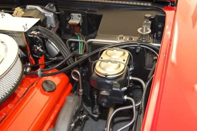

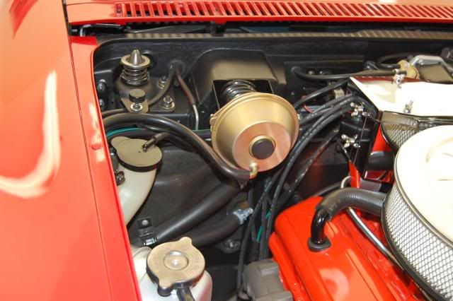

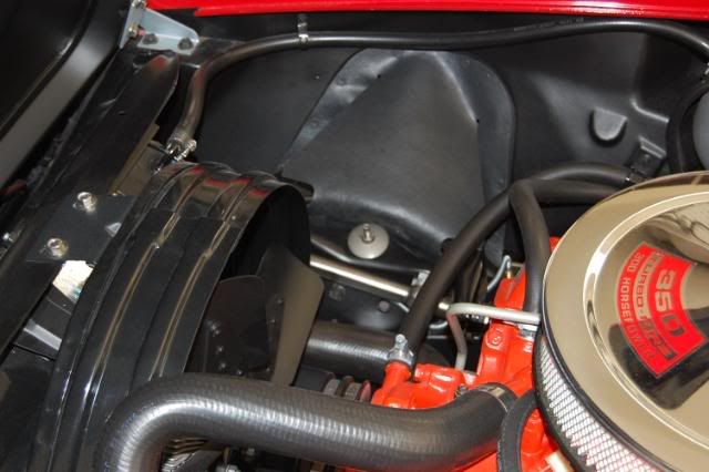

Hi Bill,
I, too, suggest you buy the NCRS 70-72 TECHNICAL INFORMATION MANUAL and JUDGING GUIDE.
In the manual you'll find lots of information about what was painted, (and what color), what was plated, (and what type of plating), and what parts were left 'natural'.
The Eastwood catalogue has a WIDE variety of paints and finishes to duplicate the original finishes. So call for one of their catalogues too.
Here are a couple of pictures to encourage you.
Regards,
Alan
Regards,
Alan
Alan....i'm so jealous! I'm **** and retentive, but I don't think I could ever get my engine compartment looking as awesome as yours! Thanks for sharing!!

Alan: Thats a work of art...& love

Alan, Do I actually see two things not correct on your car?
You've got a full shielded distributor cover and open element air cleaner.
I know you car is an early 71 but the change over to dual snorkel air cleaner and distributor cover top only took place late in 1970 on all small blocks except LT-1. At least I thought.
This is not meant as any disrespect but I could have swore your car was correct down to the caps on the valve stems of the rims.
Your car is a roll model regardless.

Alan, that is absolutely beautiful !! Is the heater box painted ? It looks "natual", but almost shiny like it's brand new. Is your firewall painted. looks the same way. Any help is appeciated.

Hi qlw,
You're very right.
I ran a open air cleaner and 70 distributor box for years because I liked the look of them so much better.
Starting last fall I've been getting it ready for Flight Judging this Fall in honor of it's 40th birthday. Right now it does have the 71 air cleaner and ignition shielding on it.
I'm getting used to the look but will probably go back to the 70 parts after it's been judged.
Regards,
Alan
Thanks very much for the VERY kind comment.
