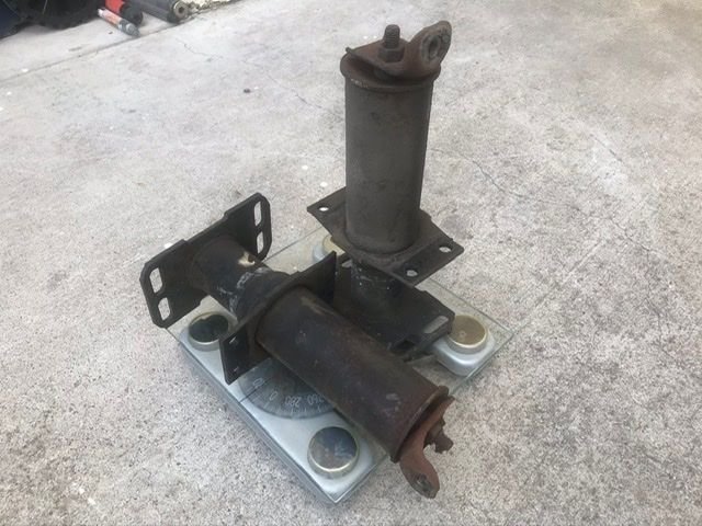

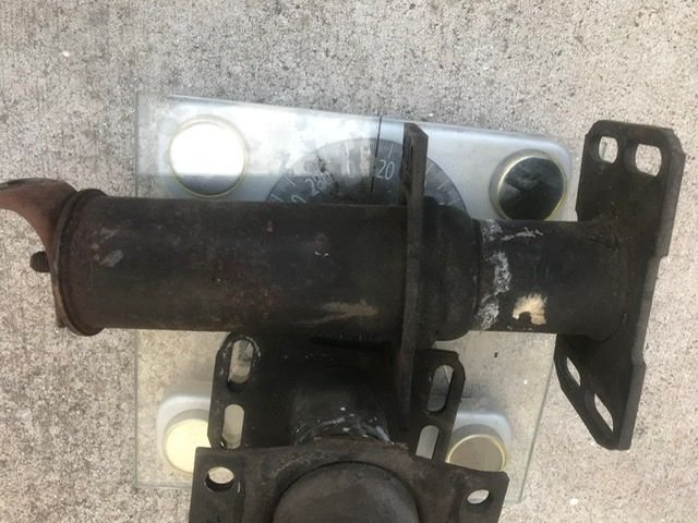

I just shed another 13 lbs. I removed the bumpers for my paint job, that’ll be another thread. But before re installing the rear bumper, I finally removed these 2 1/2 mph rear bumper shock absorbers. I replaced them with some aluminum brackets and tubing. I also chickened out on the plexiglass rear window. I hadn’t heard many good things about them on the street.

Good to know. Lightening the rear is still on my to-do list. What did you see that was negative about going with the plexi rear screen? I've been seriously considering that myself, it has to be a good chunk of weight, and up high too.

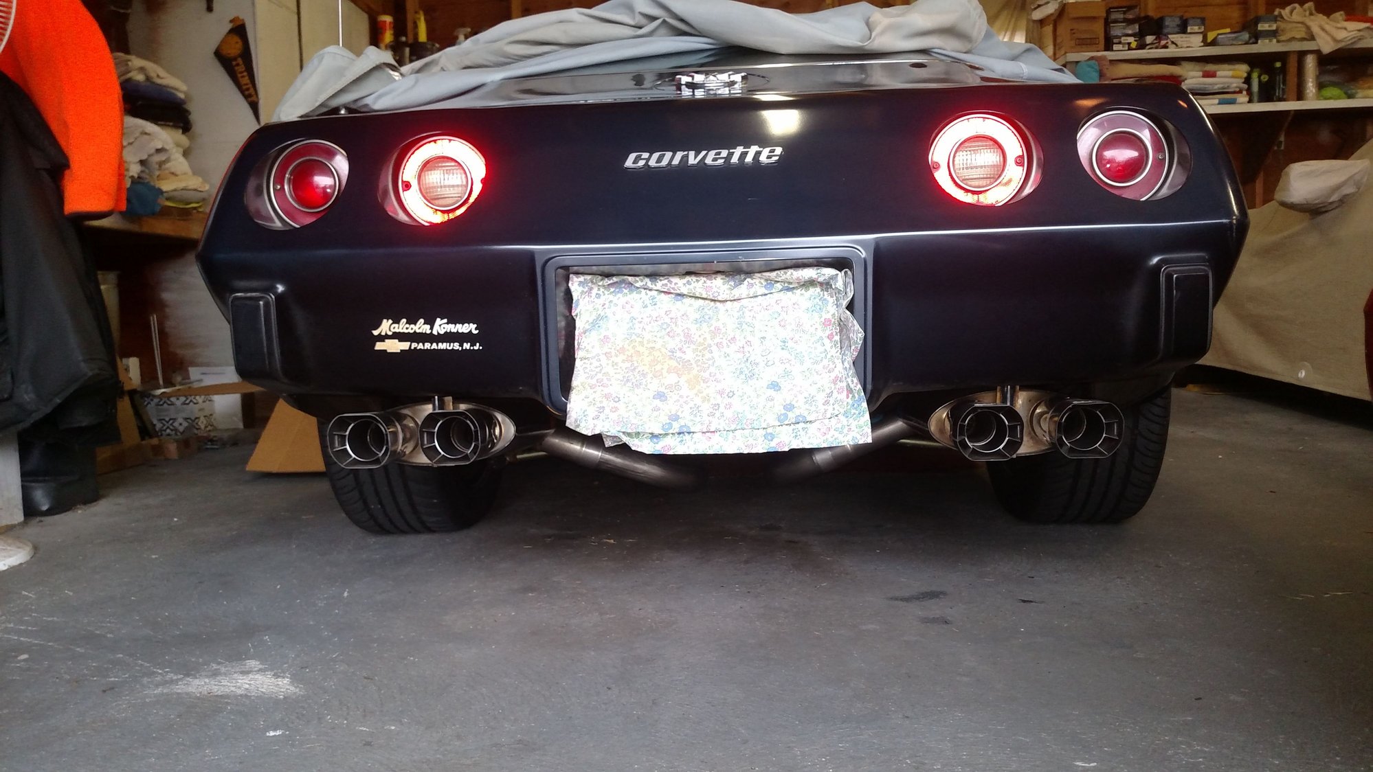

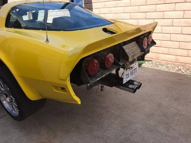

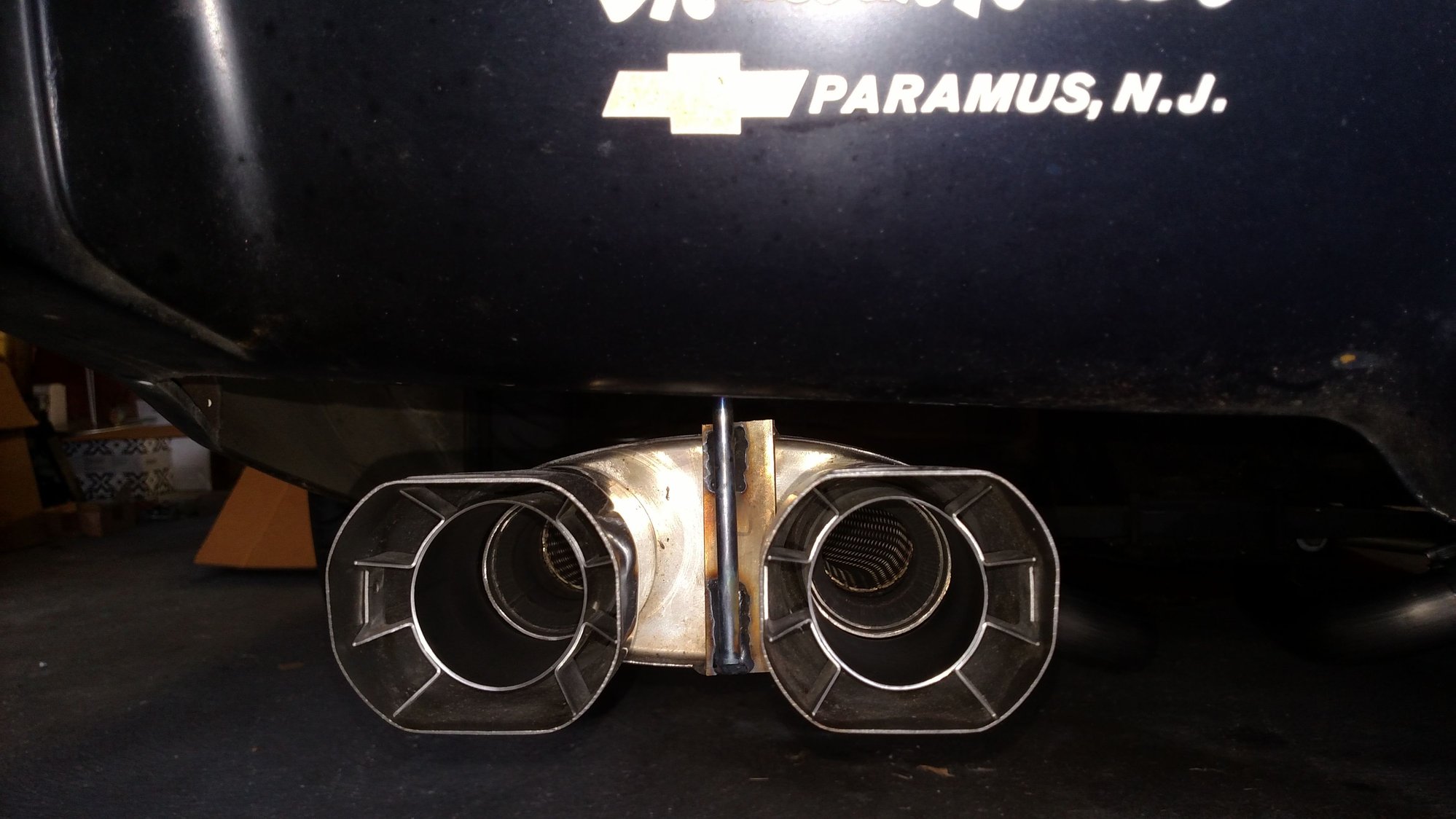

Bee Jay,
I noticed you have a single muffler on your 79? Looks like a Monza turbo which used to have on my 78 which are very restrictive. I have these C4 Borlas now which are simply the best:

Originally Posted by jb78L-82
Bee Jay,
He has the magnaflow typically used for trucks that has 2 inlet/outlet that meet in the middle creating an xpipe.
