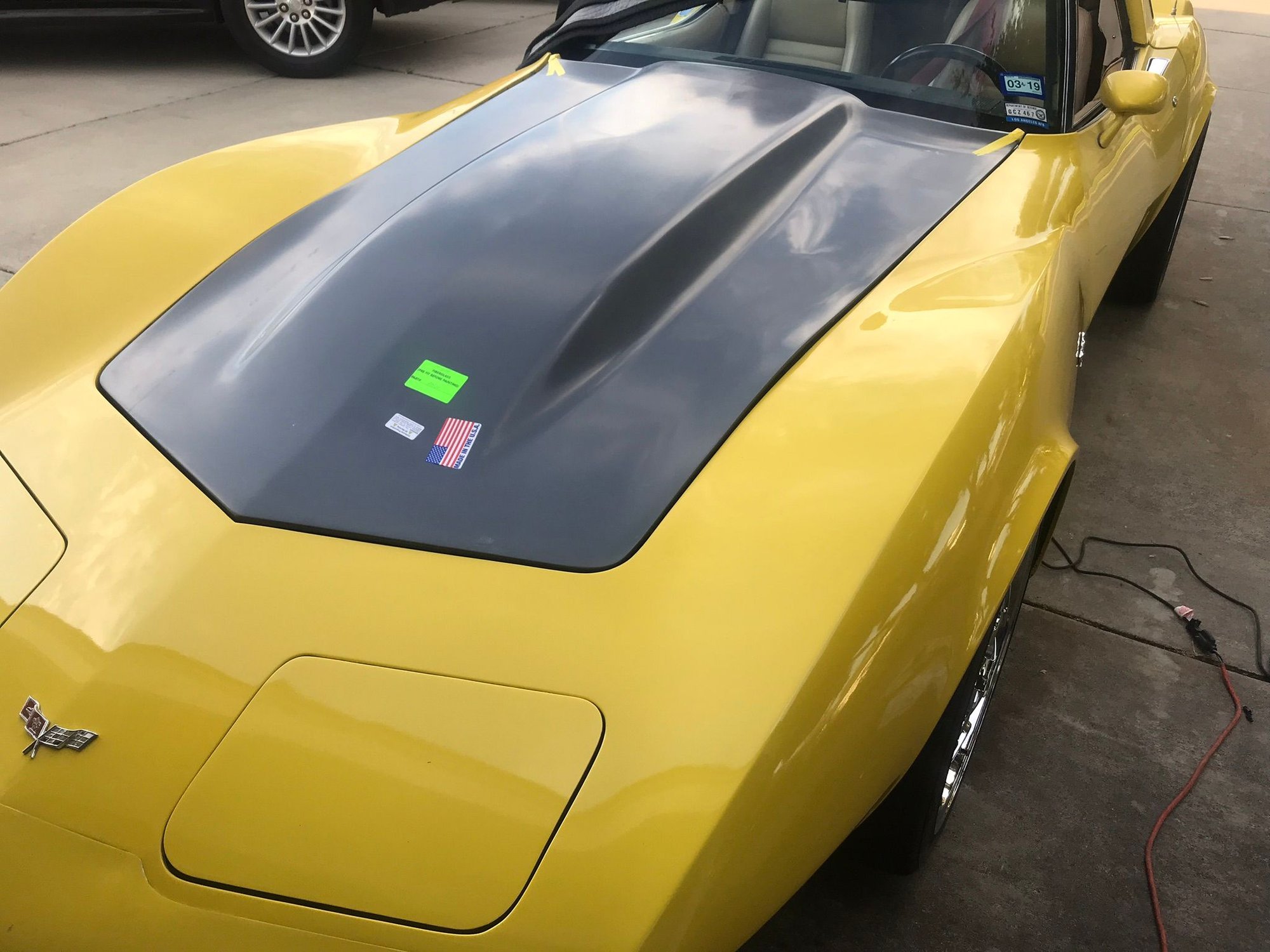

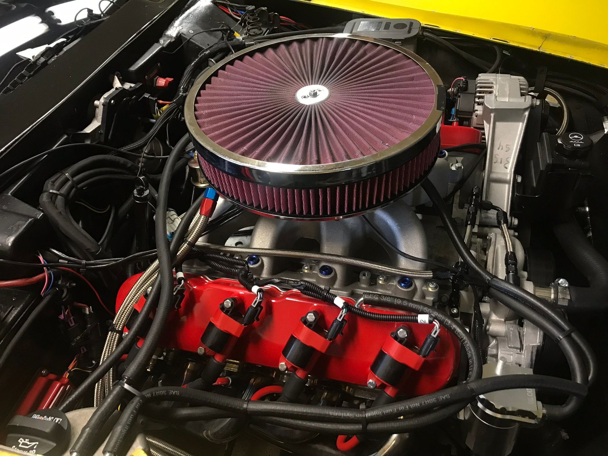

2940 lbs
I just completed my LS7 swap, including a new hood. 427 cubic inches, 100 more horsepower, 100 fewer pounds.
If anyone tells you that an LS swap is cheap and easy, punch them in the mouth. Hard. Make them bleed, and take their cell phone so they can’t call their mamma.

Awesome! I was wondering how you'd come out weight-wise.
I knew that you'd lose some weight with the aluminum block, but wasn't sure what you'd gain with the new hood on it and the dry-sump tank in there.
... And yeah, the LS swap can be a costly pain in the rear, but it's so worth it. I'm having a blast with mine.
