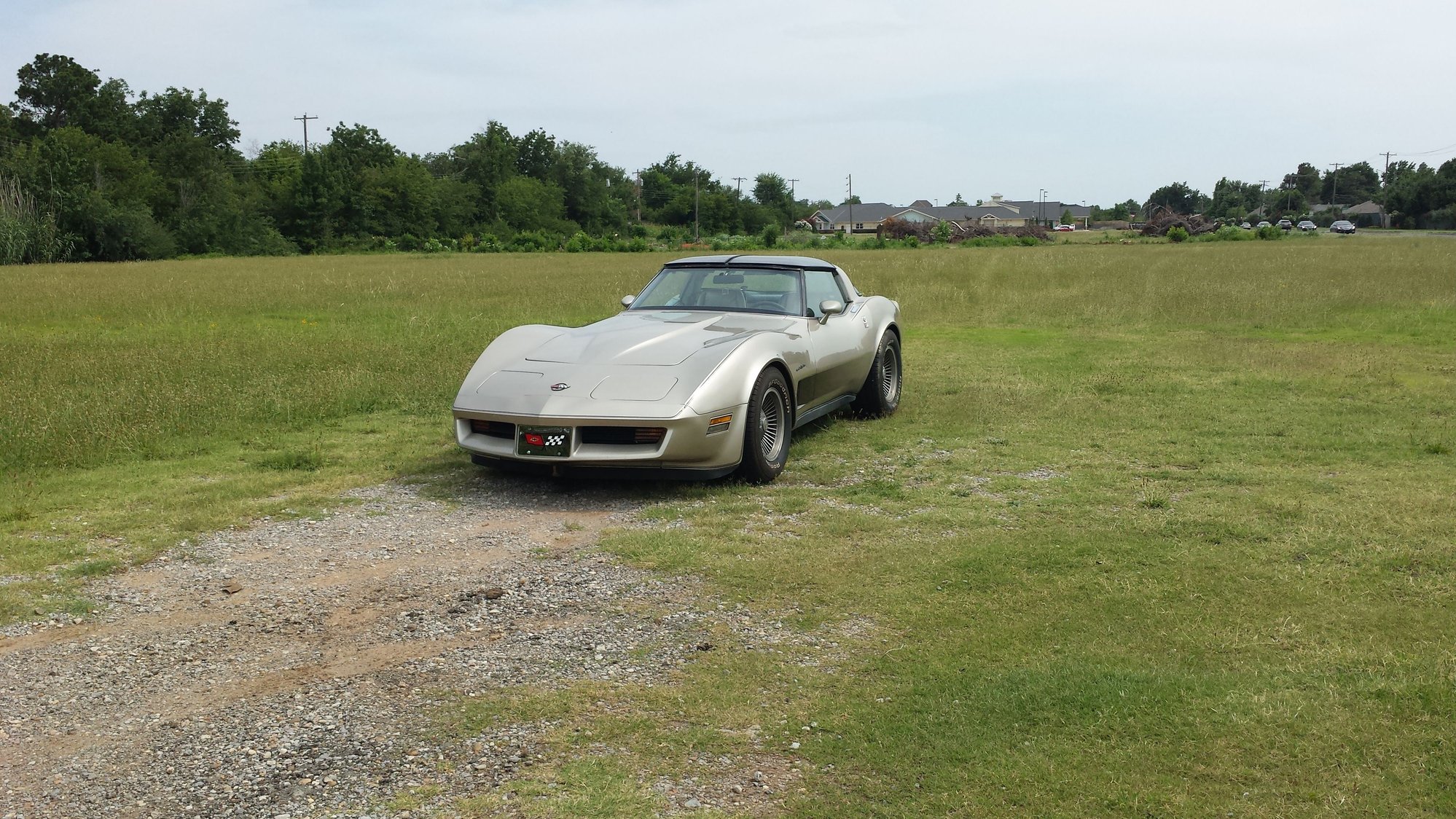

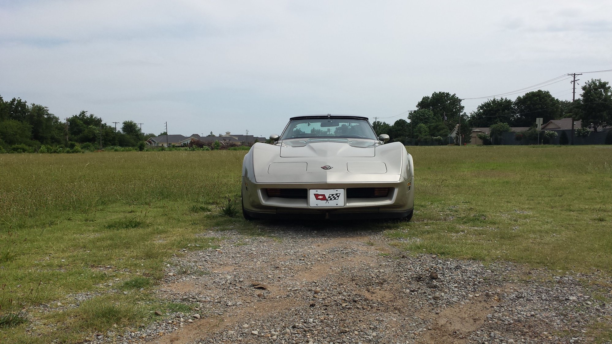

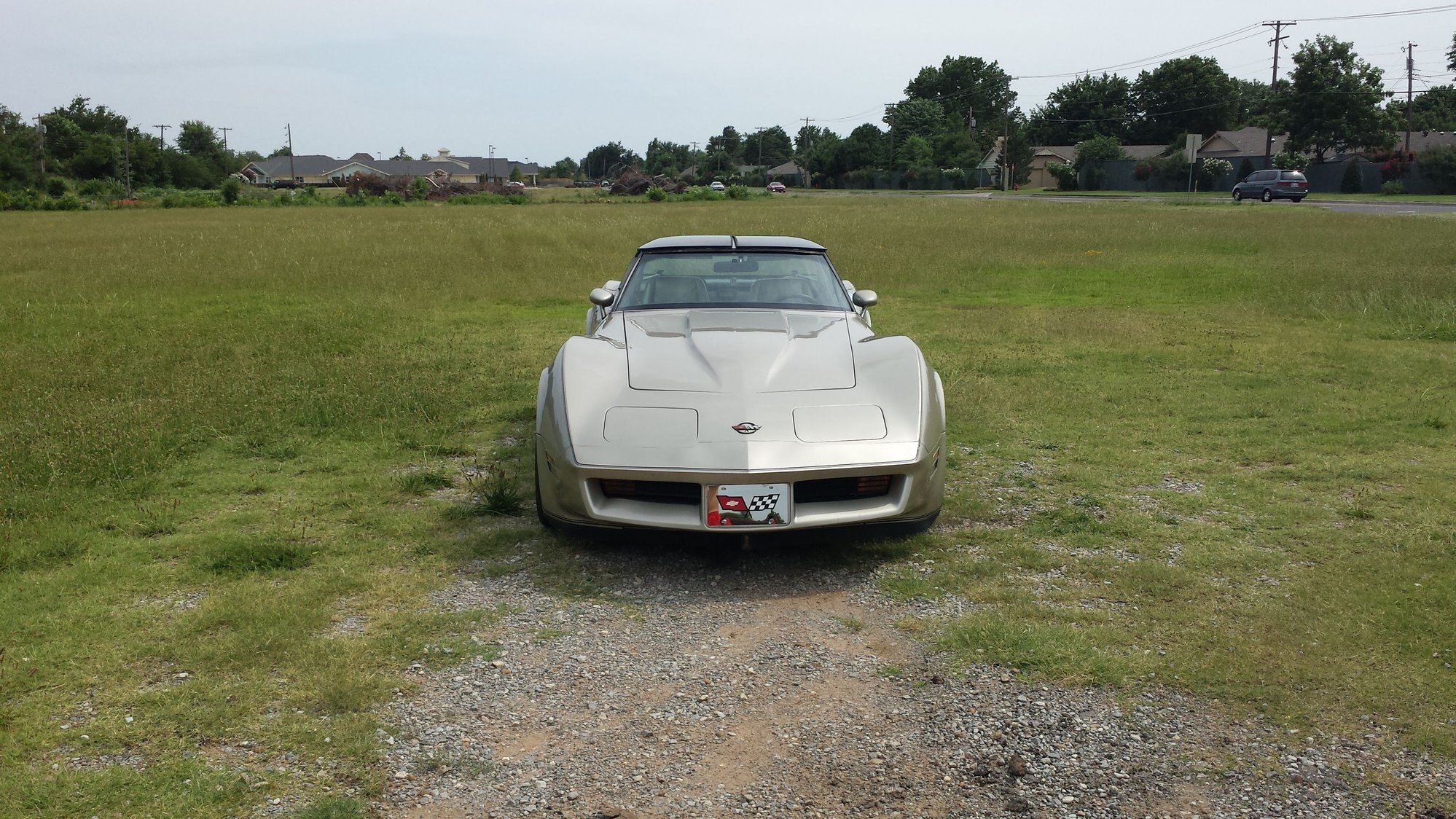

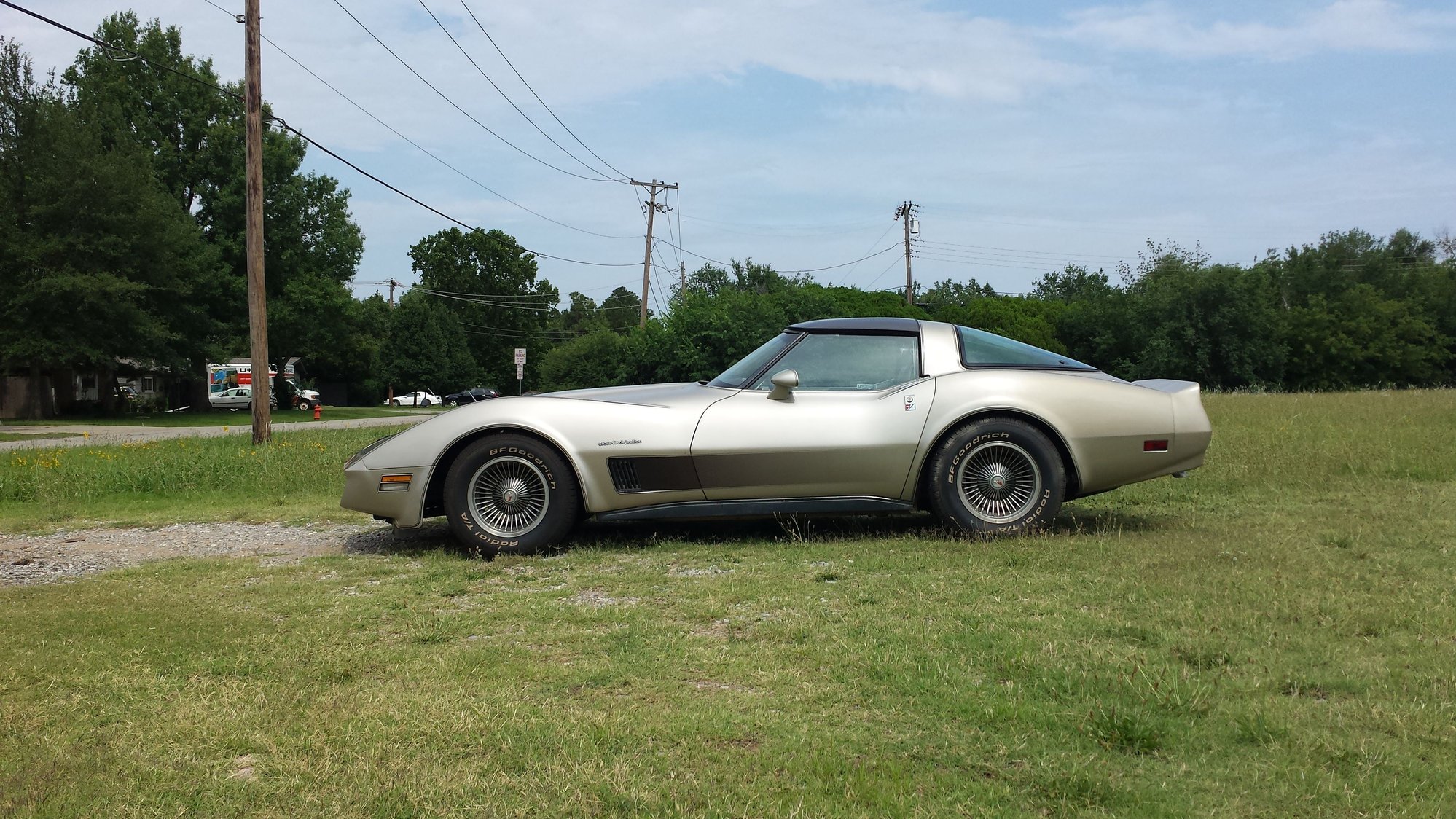

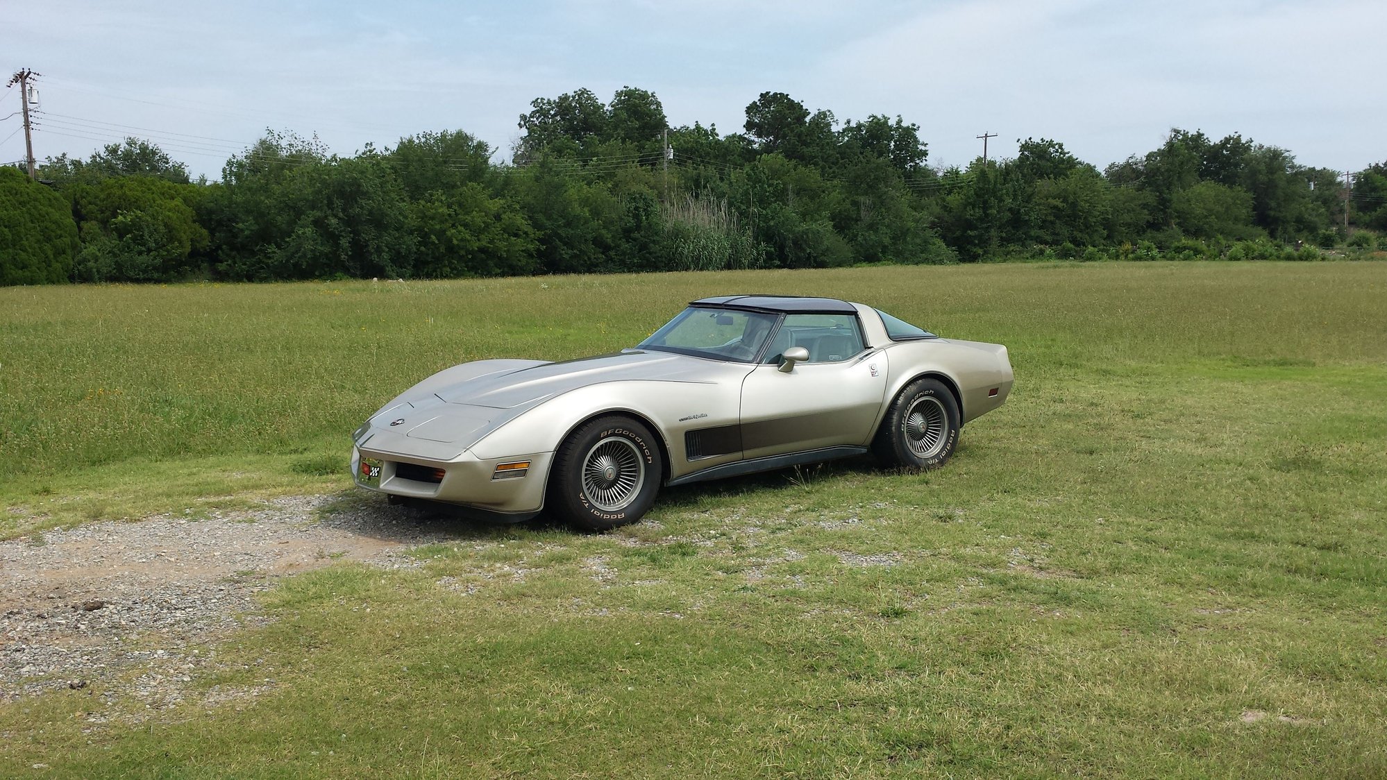

So... it's been nearly a year and I thought I would put an update out there with some pics. Since the last time I posted up I've done some suspension and steering work. The most major mod was just recently done and it was putting on 550lb VB and P front springs. It lowered about an inch and a quarter in the front. I also removed the ferrules on the rear window.
Here are the pics:

Looking good, how does it ride with the new front springs?
Are you happy that spring rate, or would you prefer to go a lower spring rate?
The stance looks great....enjoy..............Tom

I like the ride of the springs. They are noticeably tighter and provide a more direct feel to the road but I would like them softer. I prefer comfort over stiffness but I can definitely get by with these. I was planning on cutting the front springs which would have stiffened the car up anyways.
VBandP states that this will lower the car about 3/4" to 1" but I got about a drop of 1 1/4" to 1 1/2". I'm glad to get the front lowered and to get a more sleek slant.
Thanks again for all of the help!
