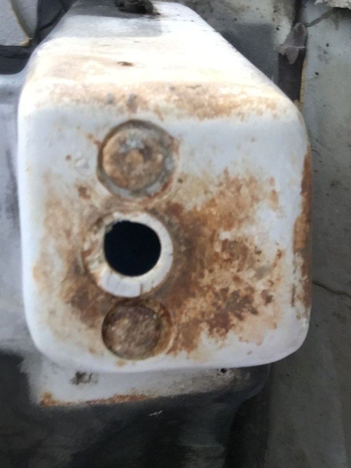

Thanks for all the feedback. In regards to the cage nut, do the two rivets on the bottom of the fiberglass belong to the cage nut or are they for a diffferent purpose
Cage for the cage nut. Some after removing them use the many different fasteners available, or you can rivet them.

Is there any issues with using heavy duty aluminum rivets to secure the cage nut?
Don't know why there would be, it's not going anywhere. But that's just my opinion. I actually will have to repair both my #4's in the near future.

No issues using the aluminum rivets by the vendors. Large flat head 5/16. You may have to snip them shorter if needed.
Pop rivets can be used to hold the retainer for the large square nut. Becasue the p[op rivets is not holding a part of the cars structure.
BUT..I would use the solid aluminum rivets for the other areas that hold the gusset plates on due to they are considered a part of structure.
Granted there are people out there that will use machine screws and nuts...and they can do as they wish....and some use nothing but pop rivets.
DUB

Related - I suppose? Sorry if I'm hijacking. In need to remove the #4 cage nut - just drill out the rivets?
FWIW, I'm just about done the passenger side structural on my body-off, I just need to figure out what to do with that #4 and the seat belt support. The #4 reinforcement is completely missing (like, not anywhere, not even remnants)- and the seatbelt support is shot totally- so thats my "august" project. I'm expecting the same crap on the driver's side too.
david,
thats what I did, used a 1/4 bit drilled off the heads and used a punch to remove the old cage nuts. I’ve heard of some people reinforcing this areas and not using the metal reinforcement plate but that open the body up to breaking leading to an unsafe condition. I got my reinforcement plates on eBay for a really cheap price like 35$ each. Best of luck in your project

Drilled from the bottom up, right?
And yeah- I'm gonna have to either fabricate or buy reinforcements. At 35 bucks, that's a steal.

If the outer mount plate is needing to be replaced due to bad rust.. Buy new ones.
AS for needing to use the cage and square nut...that is up to you.
I will make my own square washer that fits down in the pocket out if 1/8" thick steel and then either weld a nut to it or not weld it on. The thick steel washer will transfer out more of the pressure evenly when the bolt is tightened that the large square nut GM used. The only reason the cage is used was for fast assembly on the assembly line. And I can install the bolt and then the nut on the inside even if the nut is not caged all by myself with no issues.
