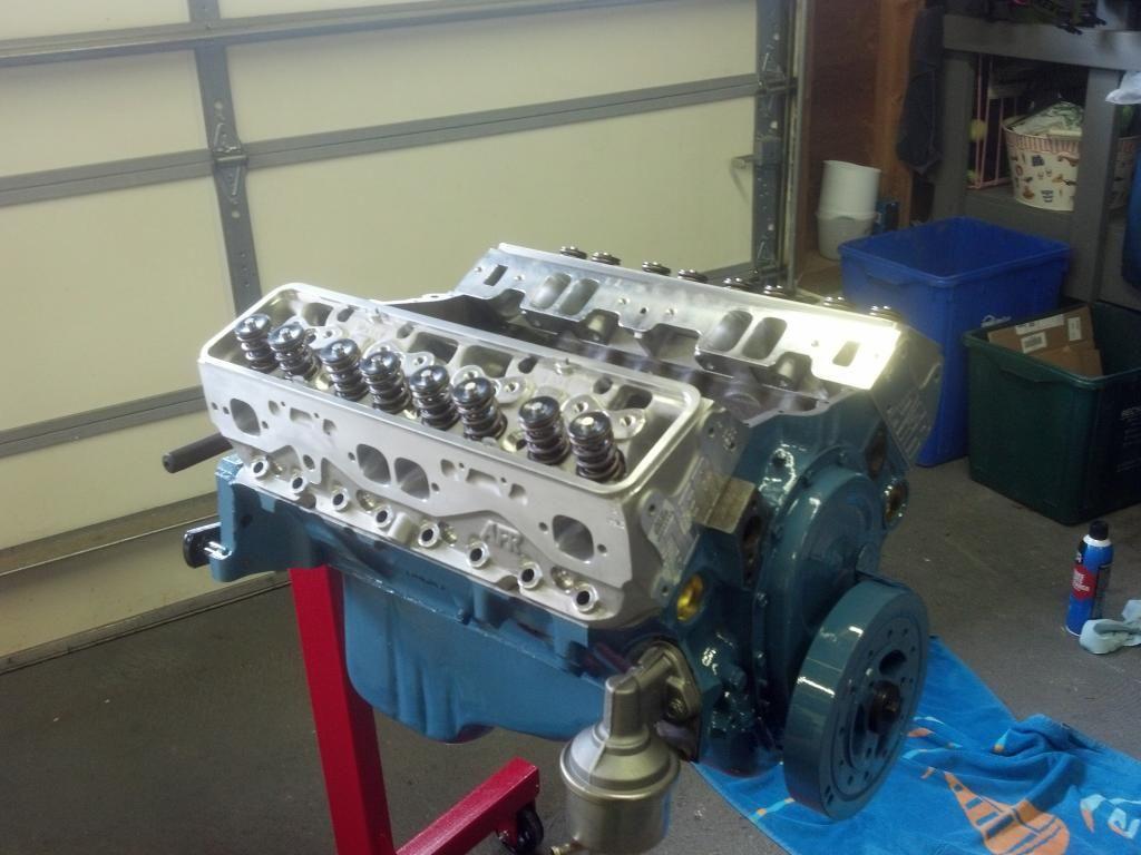

Replace the heads, roller cam, everything else stock-no one will know:

I do not plan on replacing the camshaft; but the thought of advancing the camshaft and replacing the heads with maybe AFR or Summit aluminum units which are 50 state legal sounded entertaining. I figured the power band would be moved down (500 rpm) into a more useable area since I am limited to three speeds (auto) and better heads would still enhance the upper rpm band (5,500 rpm). Higher compression should also help all around. Do you think it would be still advantageous even though I am stuck with a 2-1-2 exhaust system (Flow Master with Magnaflow Cat Converter)?

Yes I think that changing the stock heads will always help. I have read good comments about the Summit aluminum heads. I don't think I would go AFR's without a combined parts replacement plan. As far as the 2-1-2 exhaust, it can made decent by what you have done with a high flow cat and free flowing mufflers but it will never match 2.5 inch true duals. There is a forum member out in your neck of the woods who has a 78 with 2-1-2 with 2.5 inch head pipes converging into a single 3.5 inch straight pipes where the cat is located and a 2.5 inch split pipes out back. This system will flow quite a bit better than the stock Y pipe and exhaust system. I think you would be very happy with the increased power.
