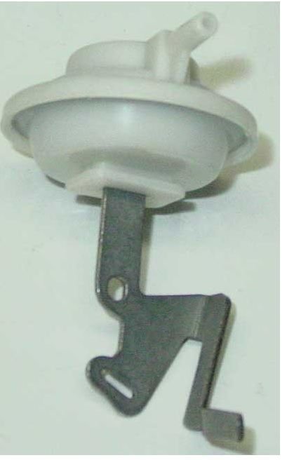

Hi 71,
I'm looking for one that has this appearance.
I believe it's one year only.
Regards,
Alan
