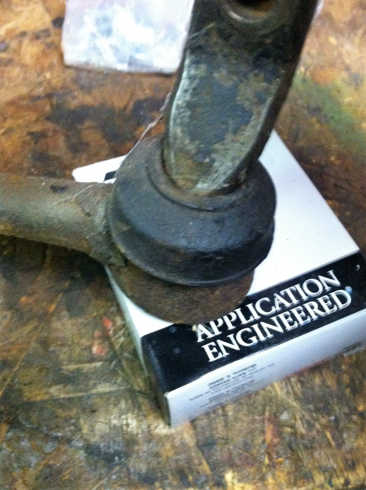

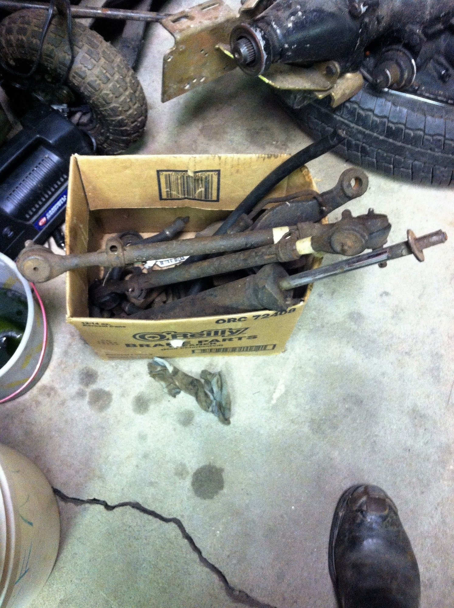

Ok went to my box of power steering conversion kits parts that Dad bought for $50...

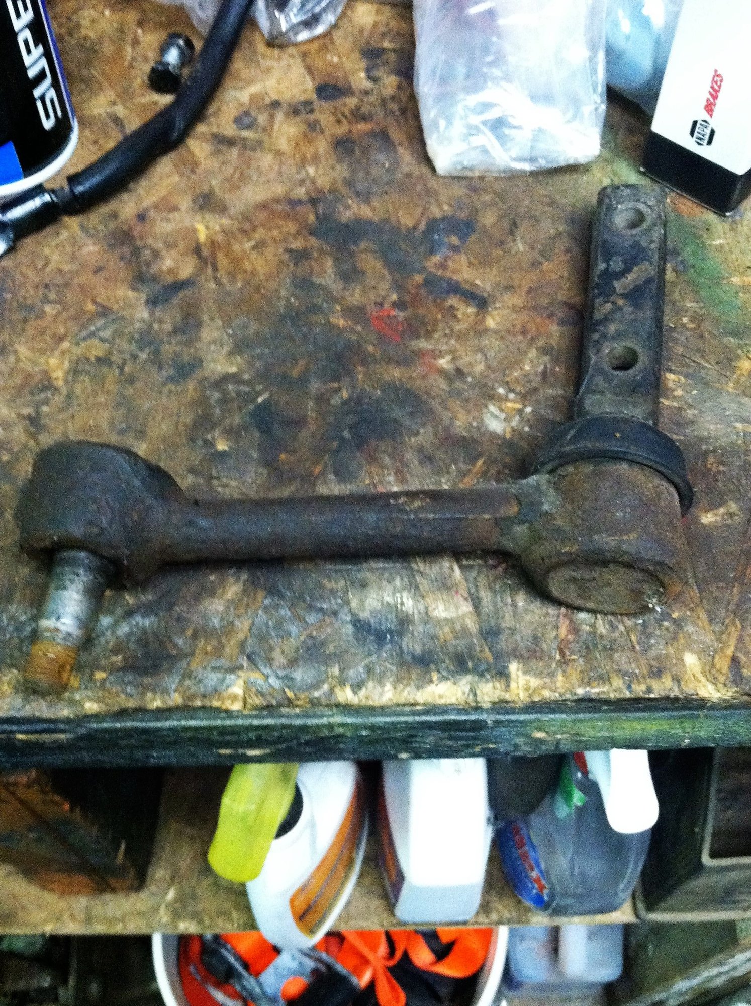

...and since I am working on the passenger side, I pulled up the idler arm for my next part to prepare for cleanup, paint and installation. It does leave me with questions (being a rookie on this, I have a ton of questions!). So here we go!

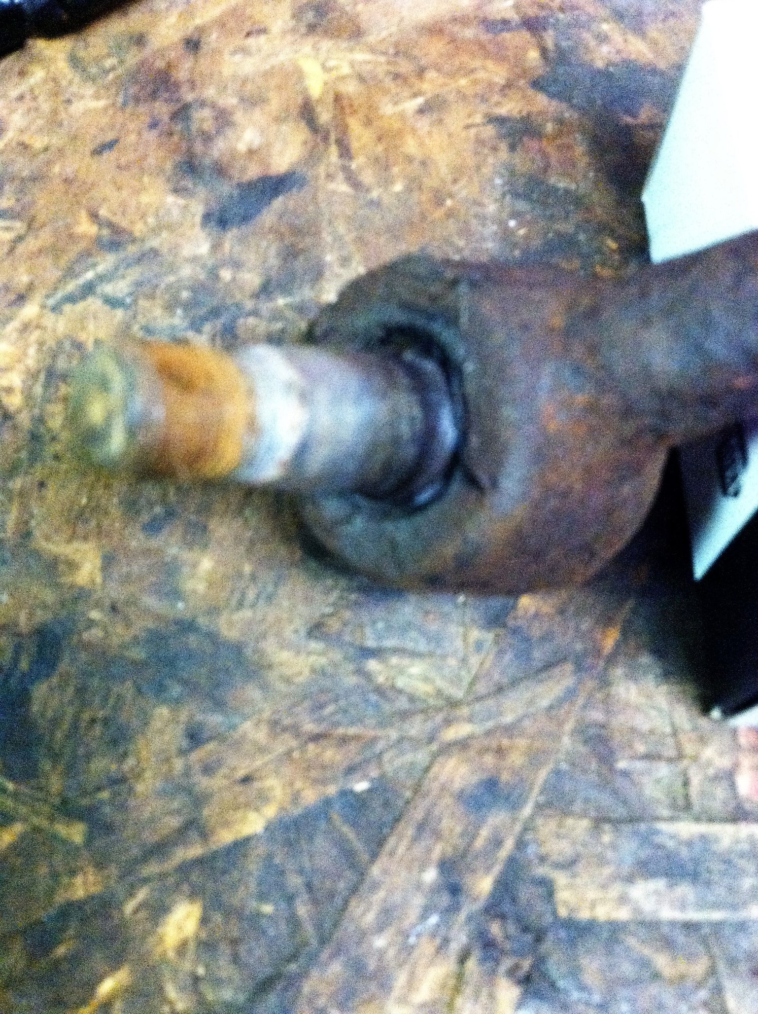

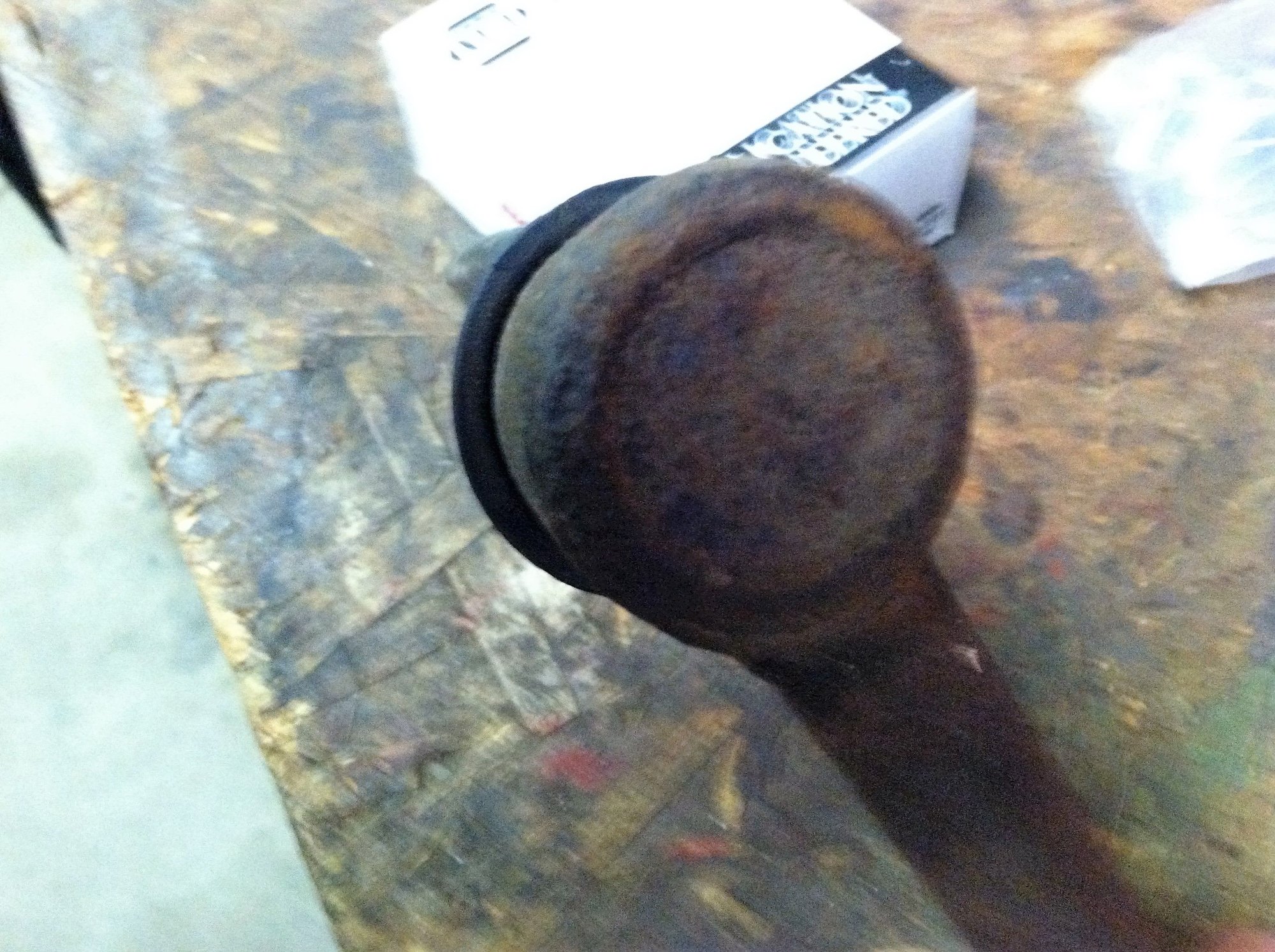

OK, this is the overall view. Holes seem fine, not wobbled out. Big question - Can these wear out? In all my years messing around cars I have never replaced one nor do I recall anybody else replacing one. Maybe I just missed it. It is very stiff and doesn't seem to move but I have not put it in a vise to check for certain. Are they supposed to move?

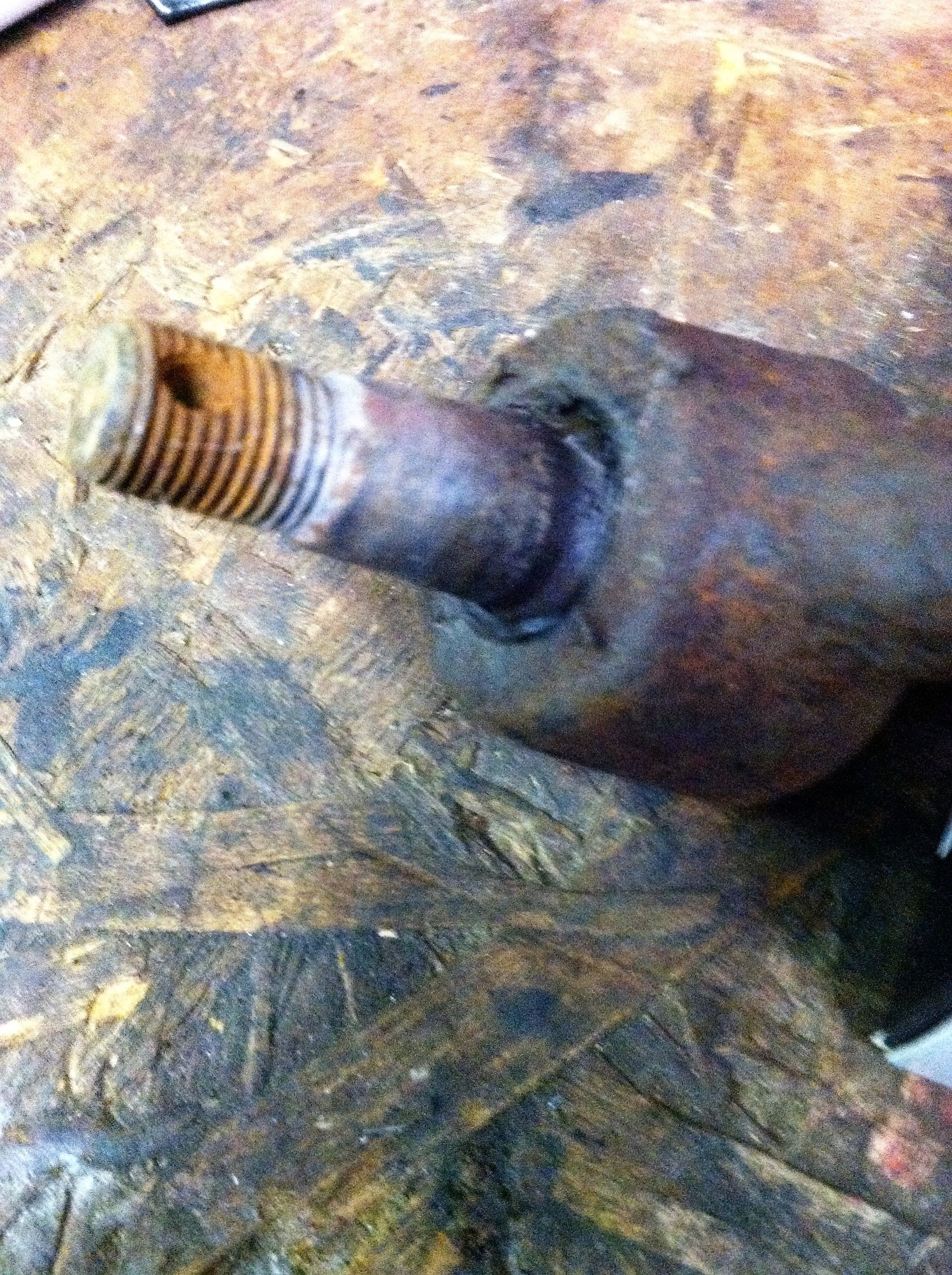

This is of the end that connects to the relay rod. It too is very stiff and doesn't move much. Is it supposed to? Thread looks good, but not sure about anything beyond that. I don't want to be just a parts changer, but it appears there is nothing to rebuild? want to save the moola where I can but don't wanna be cheap and not do what really needs done. Also, I have been heat treating my rattle can paint jobs at 200 degrees for half an hour. Would that adversely affect the rubber boot on it? Any thoughts or insight are greatly appreciated. Just in case you don't know my car is a '68 Coupe, not numbers matching with a BB. The frame is not original to car, probably a '69. It is in frame off status right now. Thanks for chiming in.

Sorry pics got out of order!

Yes, they do go bad, both ends are known to go bad and for the price I'd just replace it.

That looks like an original idler arm. OEM idler arms didn't have a grease fitting, while most aftermarket ones do.
You've got everything apart part already, and you can buy a new idler for about $50, so does it really pay to put a 40 year old "wear" part back, on your car?

What wears out on these parts are the joints (knuckles). It's difficult to know how worn/loose they are in a 'free' state. For the money...and the amount of trouble they are to change out...I would recommend that you replace them with new, QUALITY parts. Getting the low-dollar parts from the 'Zone' is NOT the way to go with parts on which your car and your LIFE depends.

Yes they do wear out, but if yours is tight at both ends, it will work as well as a new one.
So, it depends on your financial position and how much you care about the aesthetics (this one is rusty/corroded and really ugly).

Rust can be wire-brushed away and metal can be painted. But, that rust can be into the knuckle which could make it appear like it is 'tight'...until it gets worked when under load.
You can remove the rubber dust boots and get a better look at the joints. But, then you have to decide whether using old parts (maybe OK, maybe not) is a good option...or not.
If you are this financially frugal when dealing with simple (and relatively inexpensive) steering components, what will happen if a major component bites the dust???

Like most rod/joint parts, if you keep them well lubed and don't abuse them, they can last a LONG time. Nothing wrong with using parts with 'age' on them, if you can determine that they are still viable.
Like I said, the choice is up to the owner.
P.S. Idler arms go bad with about the same frequency as the other jointed parts. And, since it is the 'grounded' part in the system, it usually sees the worst shock loading.
